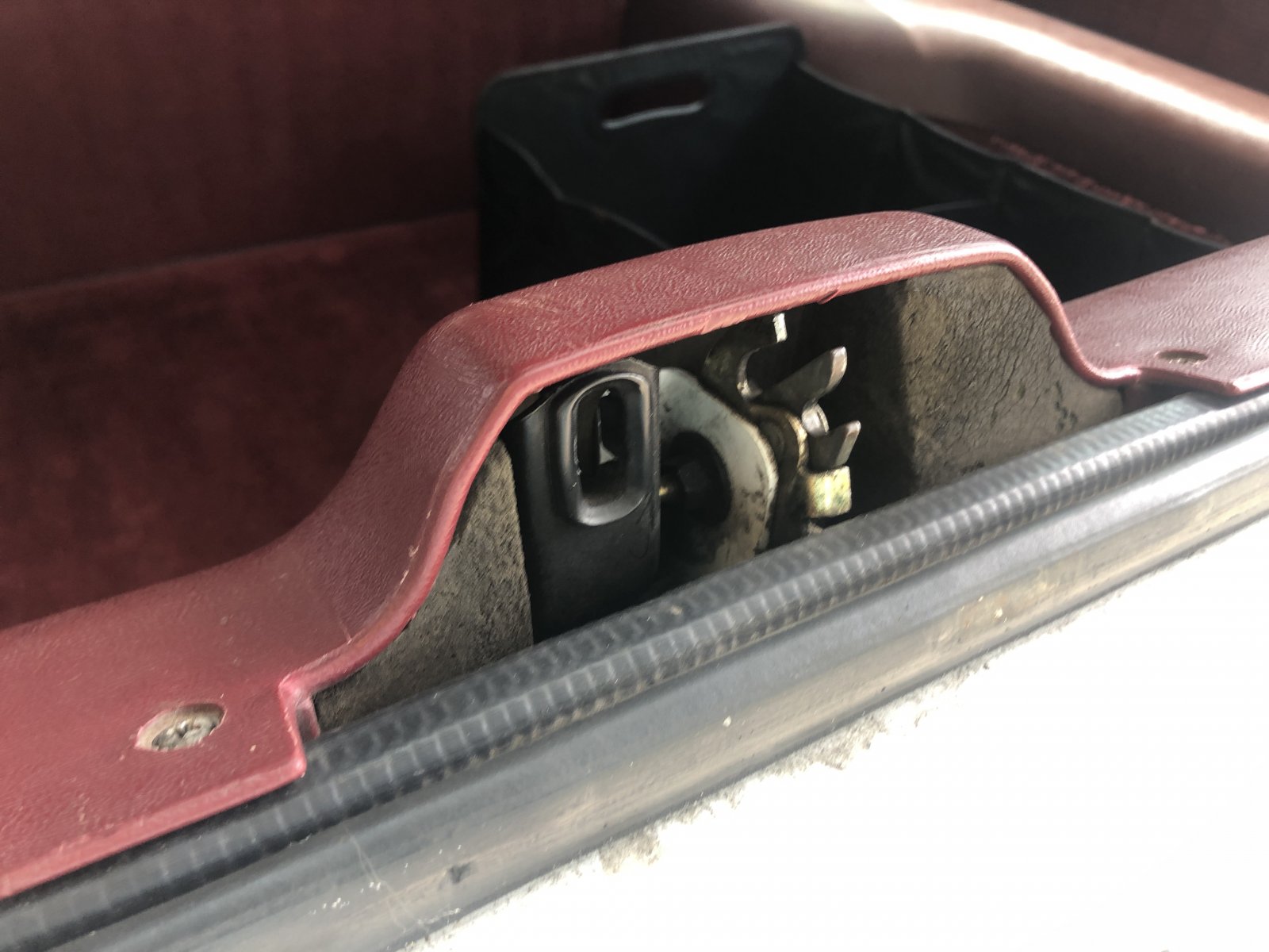

When you say a second person helps, do you mean that when you unlock it and you hear it unlock, that second person pulls/or lifts the glass a little? When it unlatches, the glass should move away from the latch or the latch should not push it away or the latch stays unlatched. The latch may be lubed but the latch hook itself may not be moving far enough away from the glass striker. Is there any binding in the glass hinges?

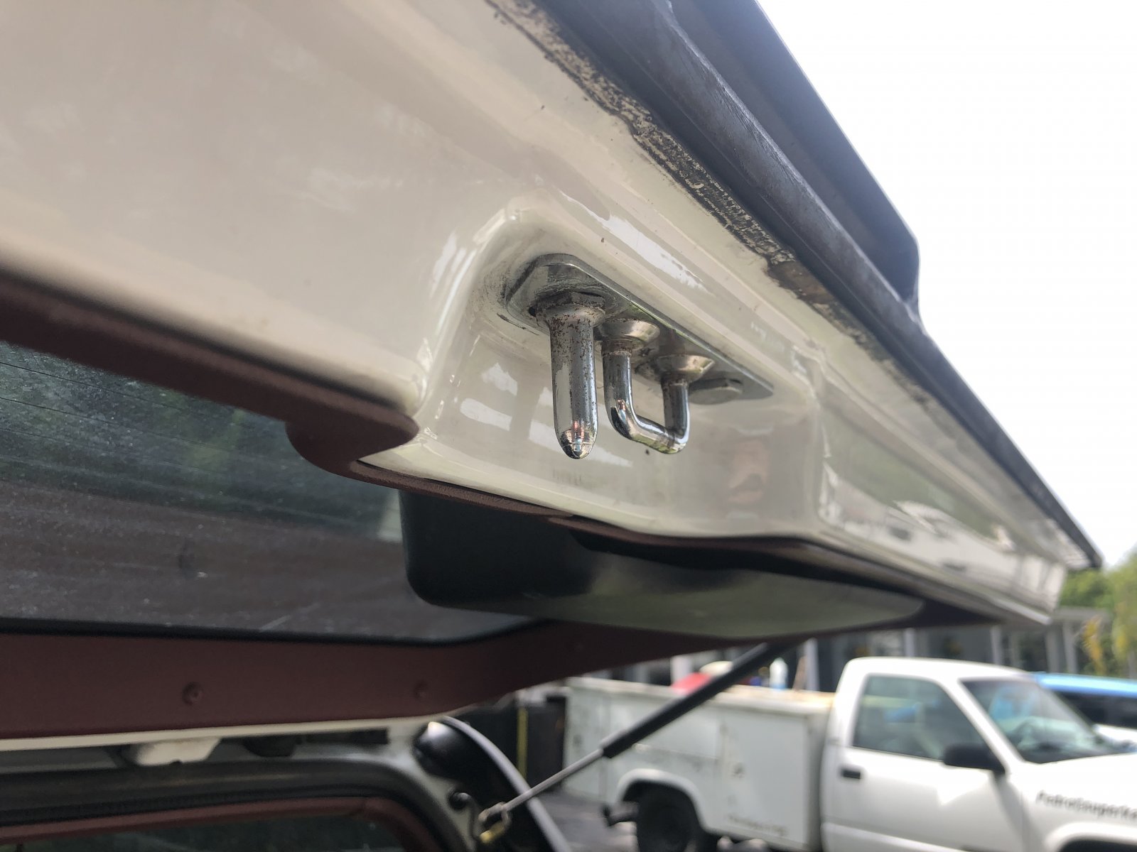

is there a bend in the glass striker bar? its not supposed to be bent and if it is it can actually pull on the glass enough to hold the latch from releasing enough to let the glass pop. learned that one with a wife that likes to shut things hard enough to pop ear drums.

Thanks the replies. A second person is needed to just gently lift the glass when the button is pushed in order for it to open. Same when using the key- I can turn the key but I have to keep it turned while I use my other hand to lift the glass before I release the key. It literally feels like there is no “pop” to get the glass/catch off the latch.
