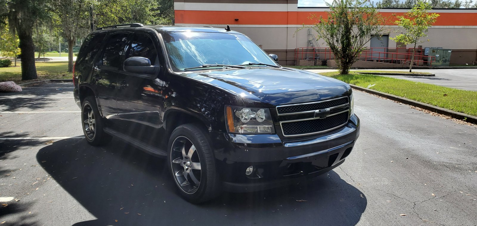

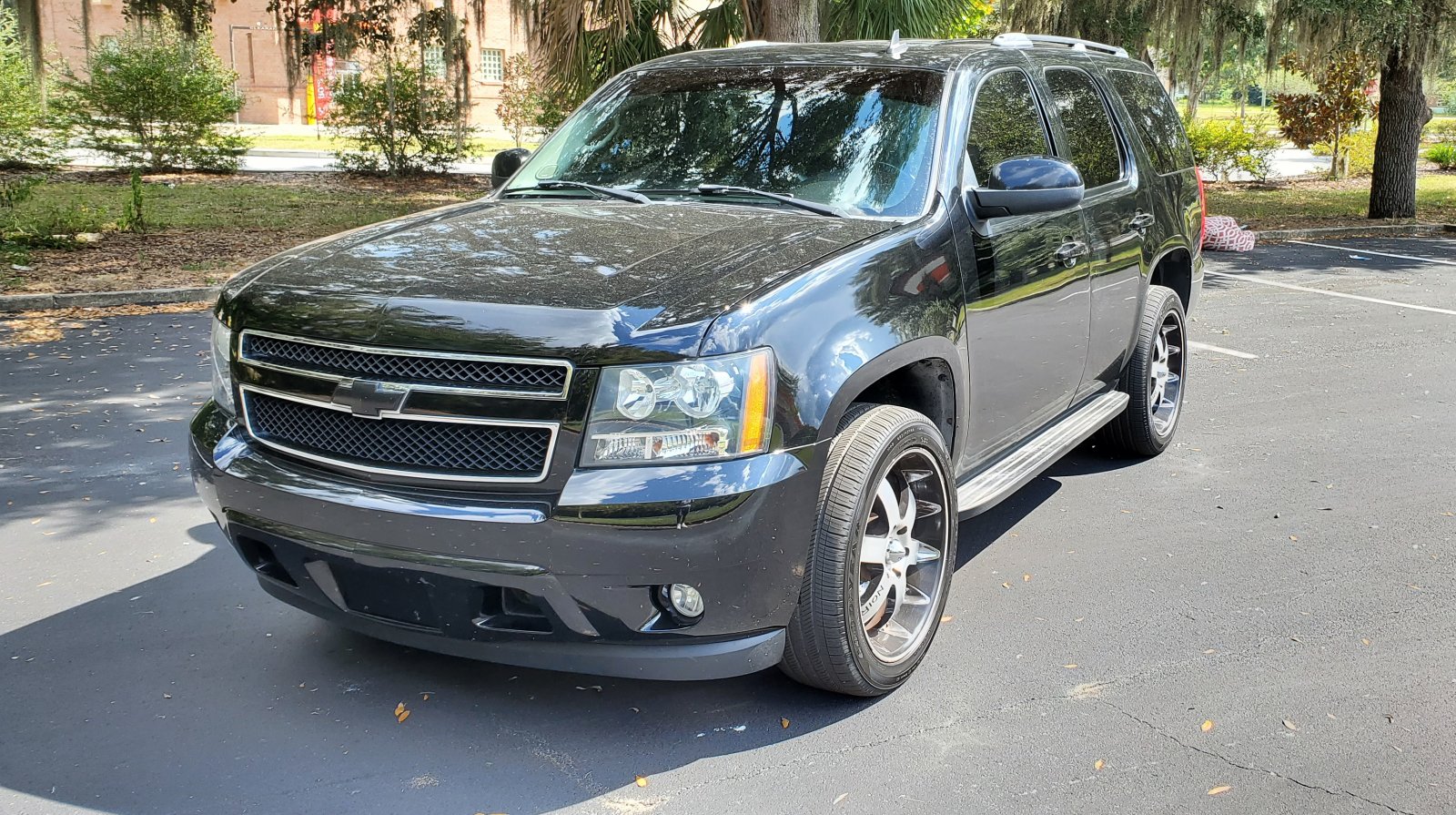

Hello people. Just picked up an 07 with 206,000 miles. Being the biggest vehicle I ever had it's been an adjustment getting used to it but I'm loving it. It actually fits me the best since I'm 6'2.5 215lbs.

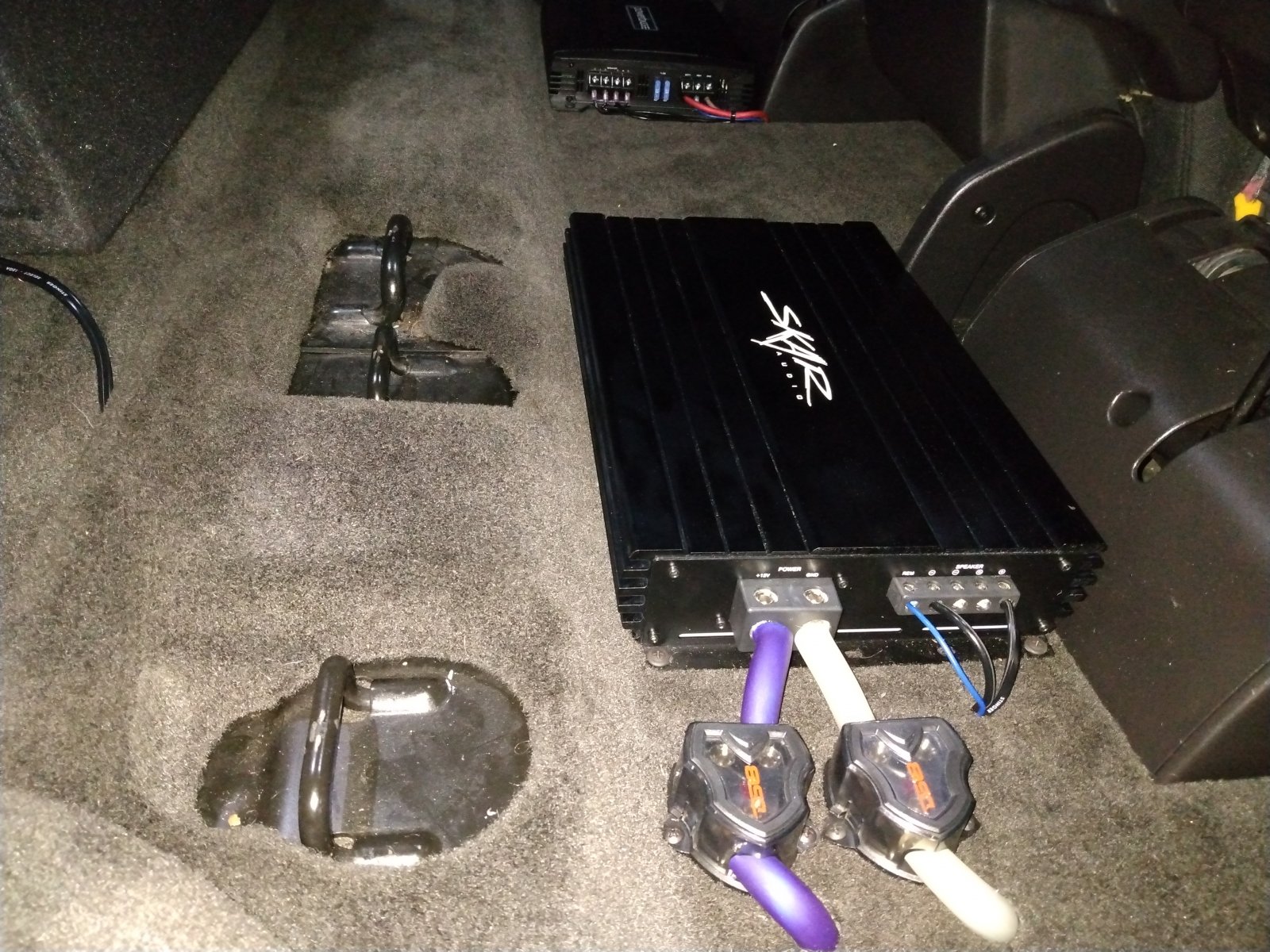

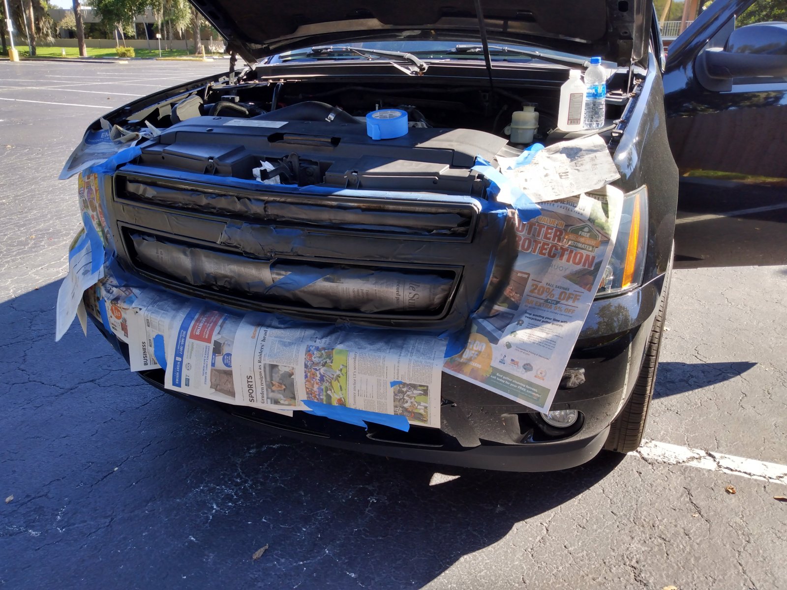

I got it with a few mods already done. 22 x 9.5 Noir wheels, debadged sides, color matching all around, black bowties, some kind of exhaust upgrade as it sounds louder and deeper than stock, high flow air filter, and led lights inside and out. Things done by me so far are a new set of tires and complete 3000 watt stereo overhaul. Will be blacking out the trim of the grill except for the trim around the bowtie next.
Only issues so far are a sporadic check engine and stabilitrack off lights. From my research they seem to be related to a loose gas cap (which I already replaced) and the maf sensor. Besides that the ride is a little bumpy and I'm not sure if it's something to do with shocks since it was happening before and after the new tires and two balancings. Reminds me of a car lowered on stiff coilovers. Not a huge deal just kind of annoying. Will see how that goes.
All in all looking forward to learning from and sharing with the community. Peace
