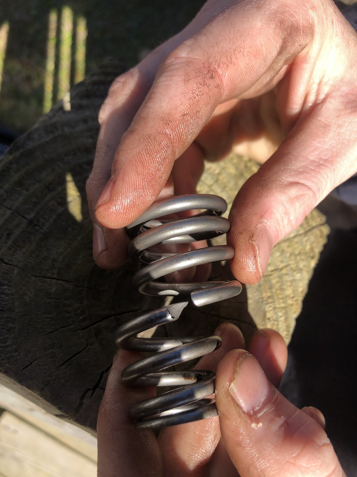

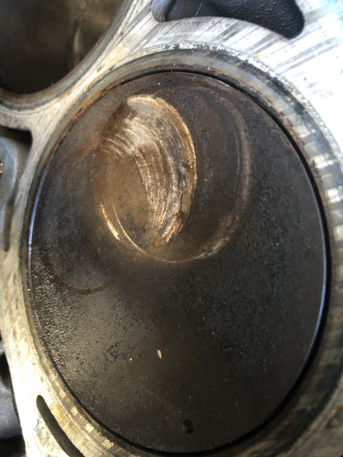

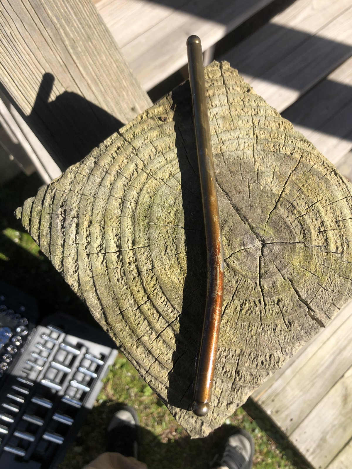

BEWARE please inspect your Brian tooley springs super well like with a magnifying glass type way mine came with super small rust pits you couldn’t see by looking at it normally and ended up having a faulty spring which broke in half and trashed my head lifter spring and pushrod along with cracking my head I would highly suggest getting springs from Texas speed or somewhere else just from that experience they did give me a top end rebuild kit but I had to supply my heads myself and reuse my cam Because they wouldn’t warranty that…

How long were your btr springs in there before one broke? I’m running btrs on my 2012.

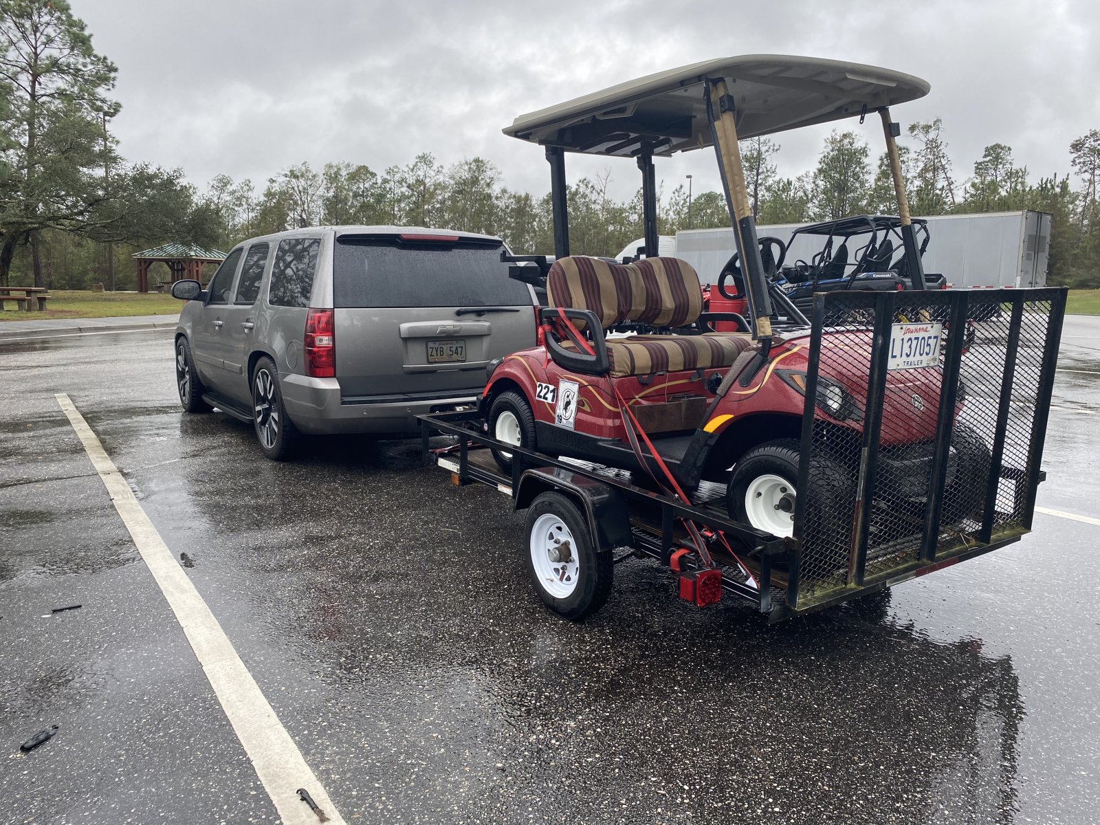

As for towing- pfft. You already know that's nothing to really watch. I only have two experiences with towing. One is a ~900 lb. electric golf cart on a 5x8 mesh-bottom trailer from Tampa, Florida to Baton Rouge, Louisiana. Averaged 17-18 MPG at 70:

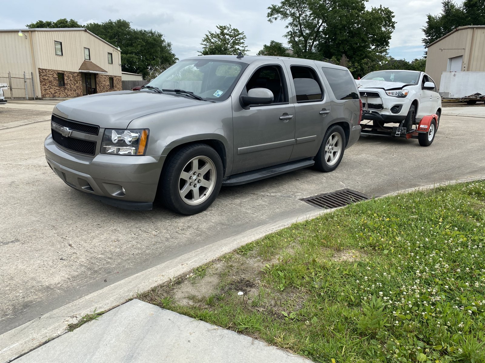

The other is a compact 4-door (Mitsubishi Outlander) on a tow dolly from New Orleans to Baton Rouge. Averaged 19 MPG at 65 and 18 MPG at 70:
Lasted 3 days before it broke btr said they may see it happen once or twice a year and you ought to know I’d be one of those people…
I’ve always liked Brian tooley racing I’ve just had the one bad experience with them that’s made me weary on certain parts I guess or again it was just my luck they were ls7 springs but the btr brand and not the blue Gm springs like I should’ve got however the new set I got ain’t give me any issues so far.

Lasted 3 days before it broke btr said they may see it happen once or twice a year and you ought to know I’d be one of those people…View attachment 384066View attachment 384067View attachment 384068
Gotcha. I have about 20k on my set so far. They’re the btr springs designed to handle .560 lift so hopefully they’re a good grade of steel.

They should be fine a bunch of my racing buddy’s were surprised and one was worried because he had the same set in his truck.
If you got 20k miles already they should be fine again they told me it was a rare once or twice a year type thing and Just my luck i was the one who got em I had less then 500 miles when mine broke
Sounds like you got the same set also just be careful I have tested the new set only once doing a big burnout bouncing off the limiter and put maybe 2500 miles if even on it since the rebuild since I’m still waiting for my tuner I only drive it short distances locally until I get it dialed in just right but runs and drives great however I already had the tune for my mods minus the cam and head swap
Thanks for the details. Very helpful. I won’t worry about them.
