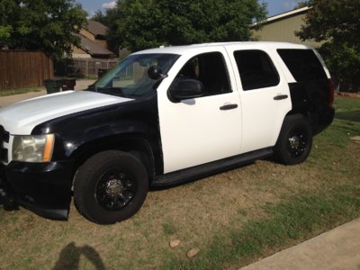

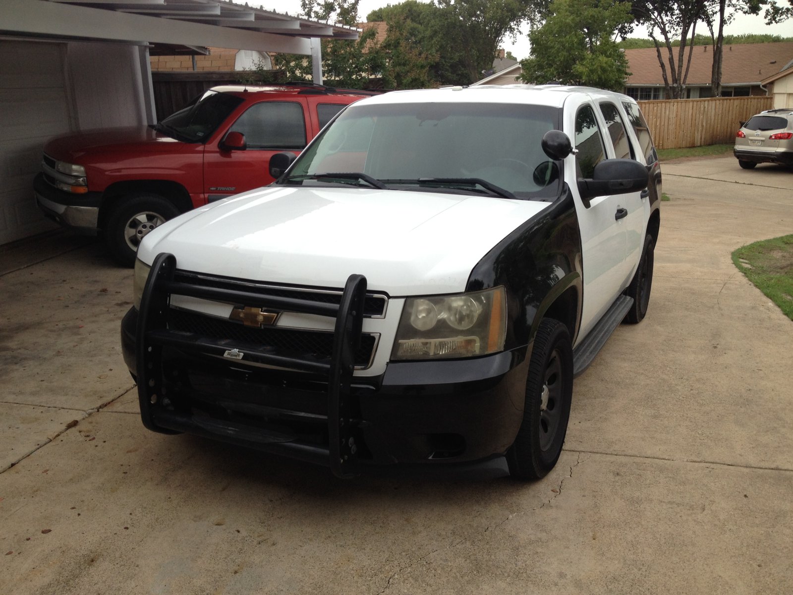

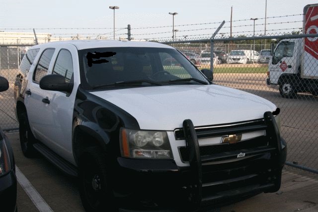

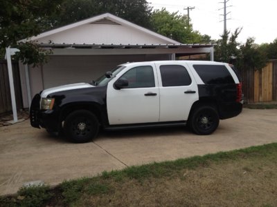

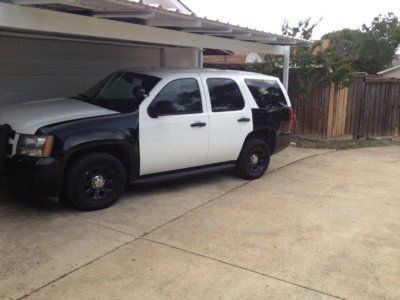

Just bought this on Friday.
I have always wanted one.
Has 81,000 miles
Holes in the dash, headliner has finger prints and a few rips, driver door has crack at the lower hinge and hangs bad on the fender when opening, might need a new hinge or to have the door repaired, no oil pressure but runs good and is nice and smooth sounding.
Only has the driver and pass front seats, no console or rear seats. The rear seat studs have been cut off so Im not sure how I will resolve that, possibly just drill out the studs and install some grade 8 bolts.
Should be a fun little project to take on.

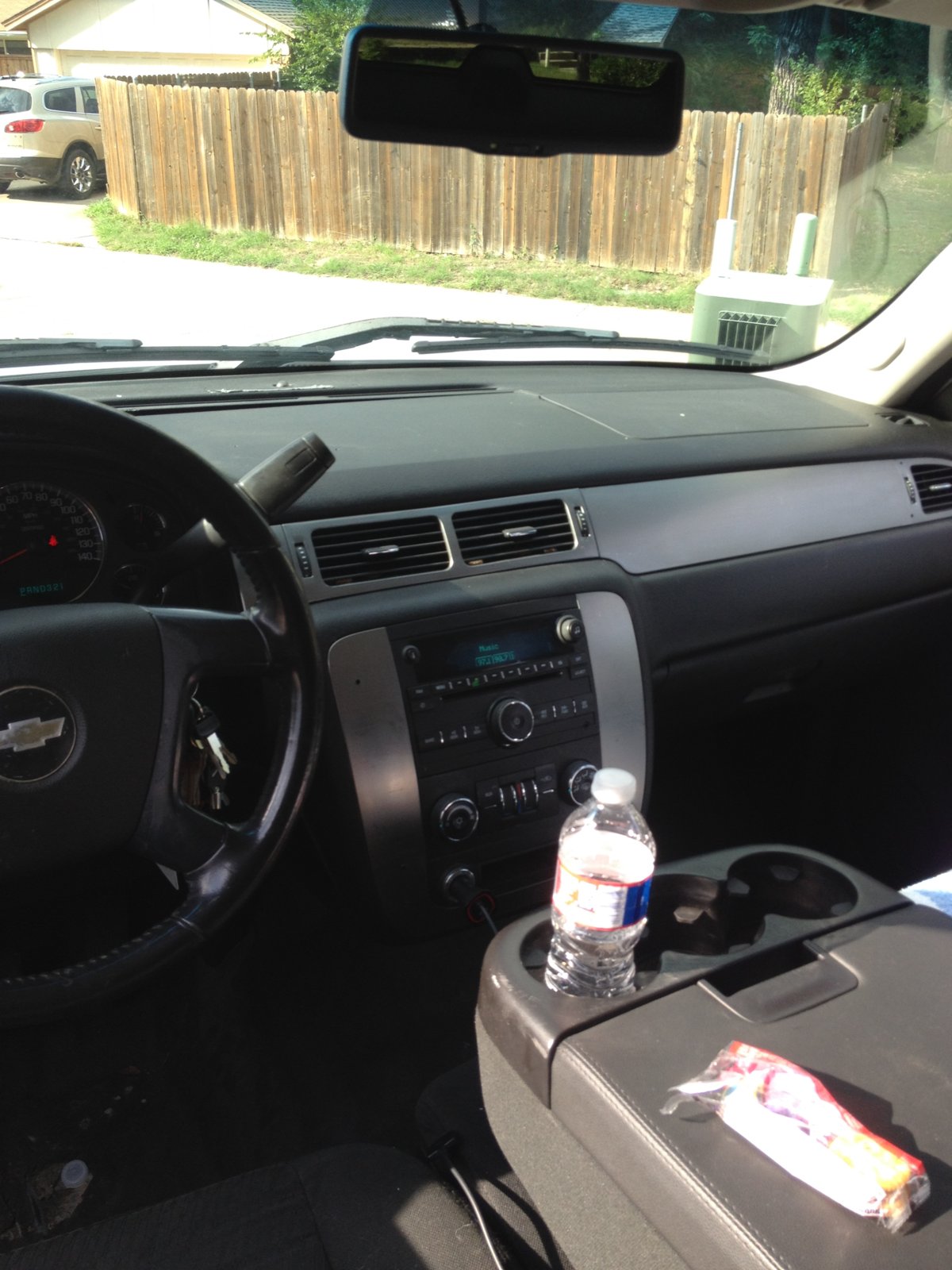

Got a center console for it today and its installed. So nice. Now I dont feel like im about to fall out of the seat.
Ordered new ac delco upstream o2 sensors and changed the oil on it today.
Its pretty nasty on the inside, Im sure it would light up like a firework show with Luminal.
The motor is so smooth. Cant even tell its running.
