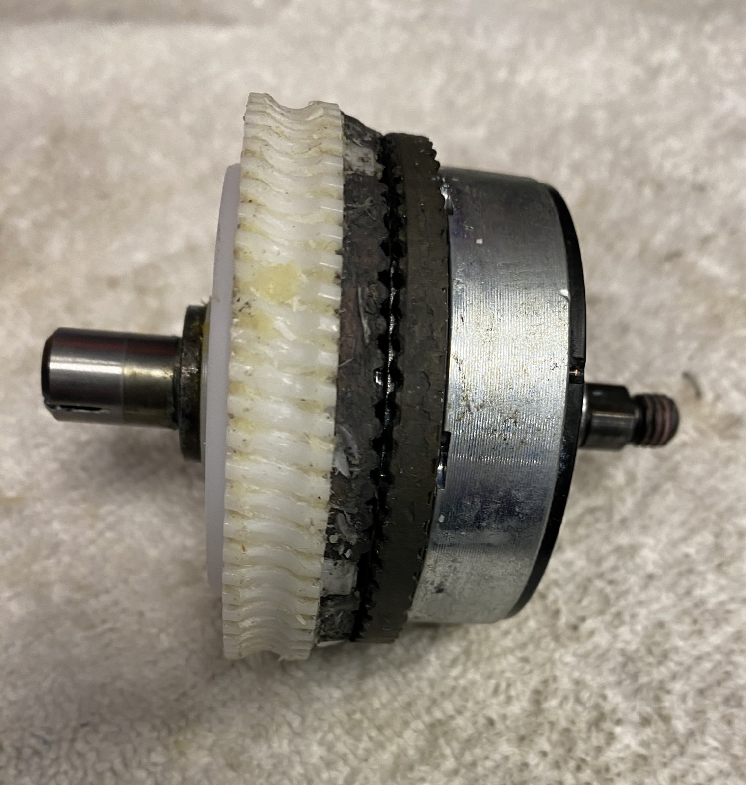

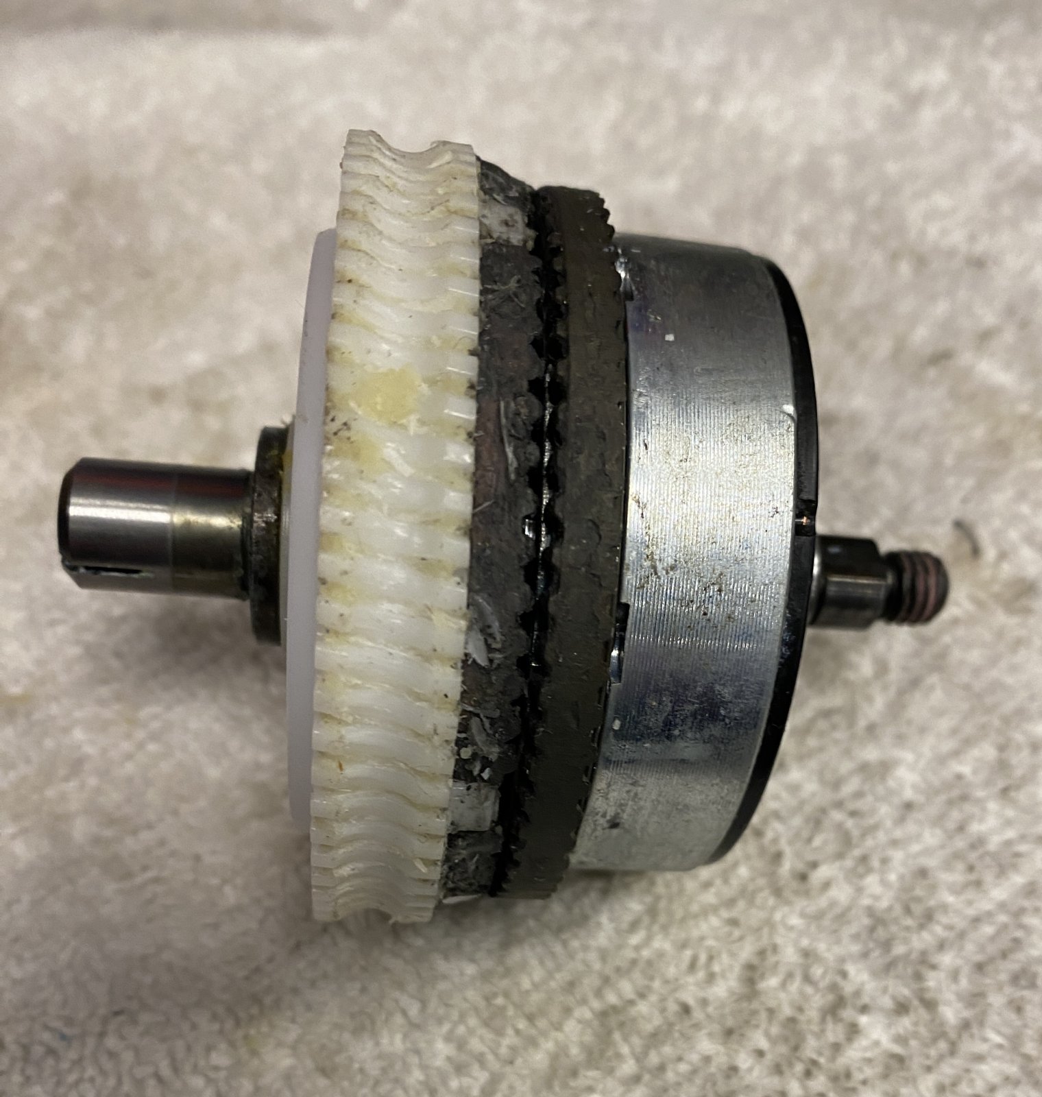

so if understanding you correctly I need to calibrate, now when I changed the “solenoid gear” in my liftgate motor. The gate close but won’t ope, I can se the motor starting but shuts off.

Got it. When I had that happen, it was the latching mechanism that needed to be replaced.
I changed this. And now it will close but not open. So I guess I need to have it calibrate.

I changed this. And now it will close but not open. So I guess I need to have it calibrate. View attachment 398605
This is what I’m saying. I replaced the exact same gear, and had the same issue you are describing afterwards. It doesn’t make sense, but replacing the latch mechanism solved the problem for me.
