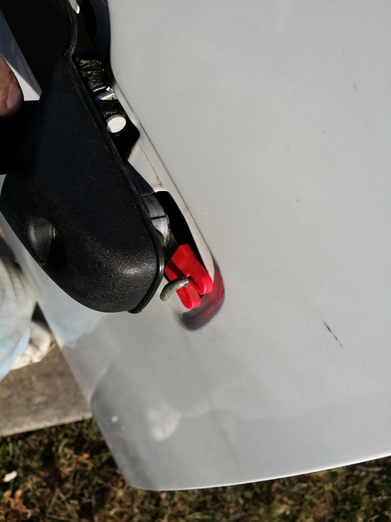

1. Use flat head screw driver to remove clip in lock button.
After removing clip pull straight up to remove.

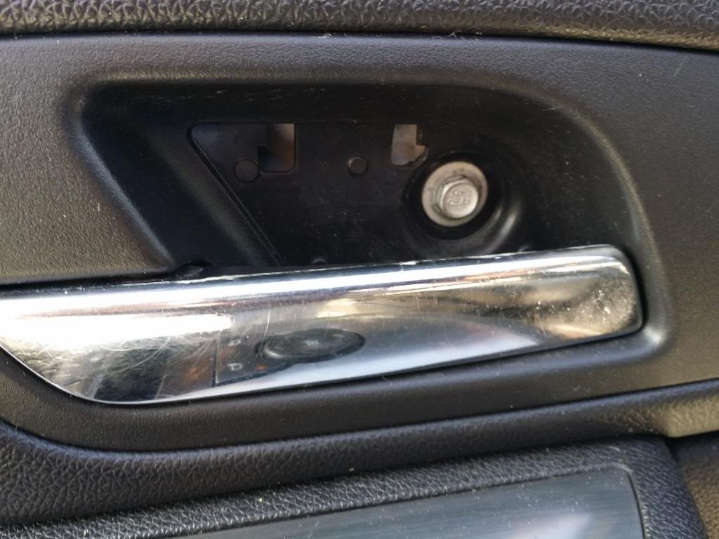

2. Use a flat head screw driver to remove panel behind inside door handle and pull handle.
3. Remove the 3 10mm bolts behind the panels you just removed.

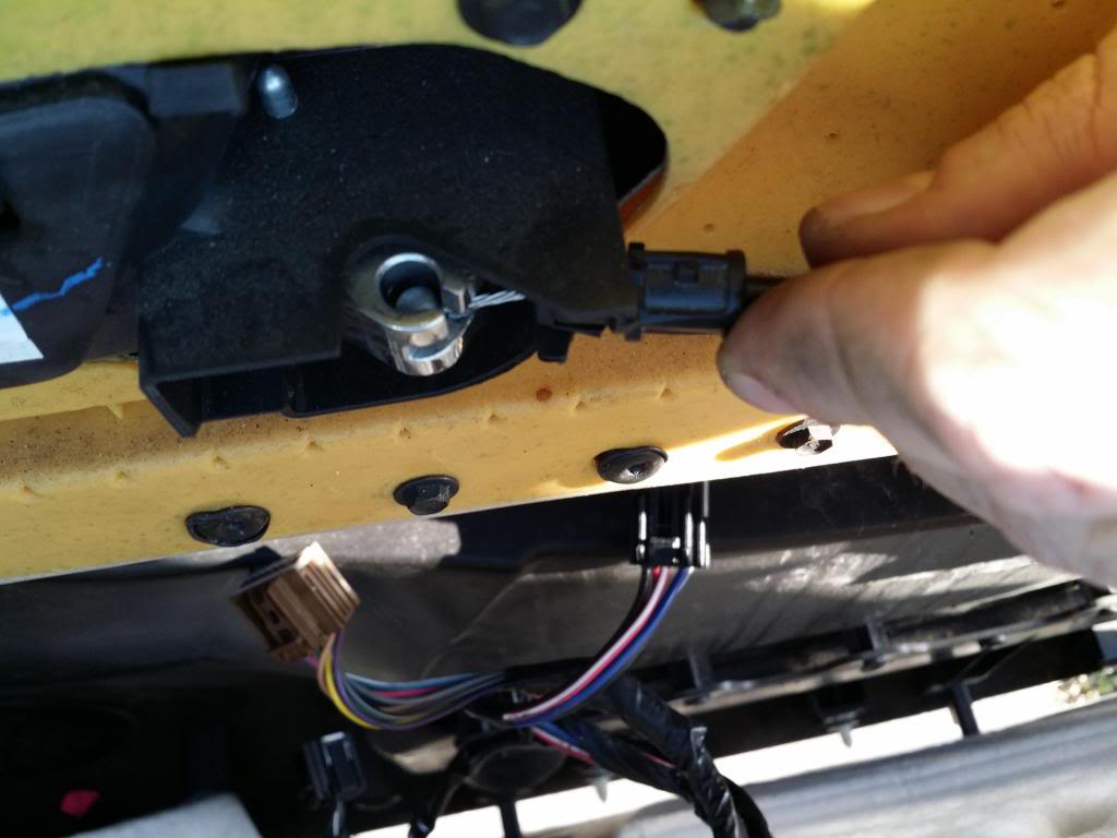

5. Remove and unplug power window/lock switch with screw driver or trim removal tool.(be careful if using a screw driver)
6. Remove the door panel (it is easier to start under the mirror)
7. Disconnect the inside handle after removing the door panel.

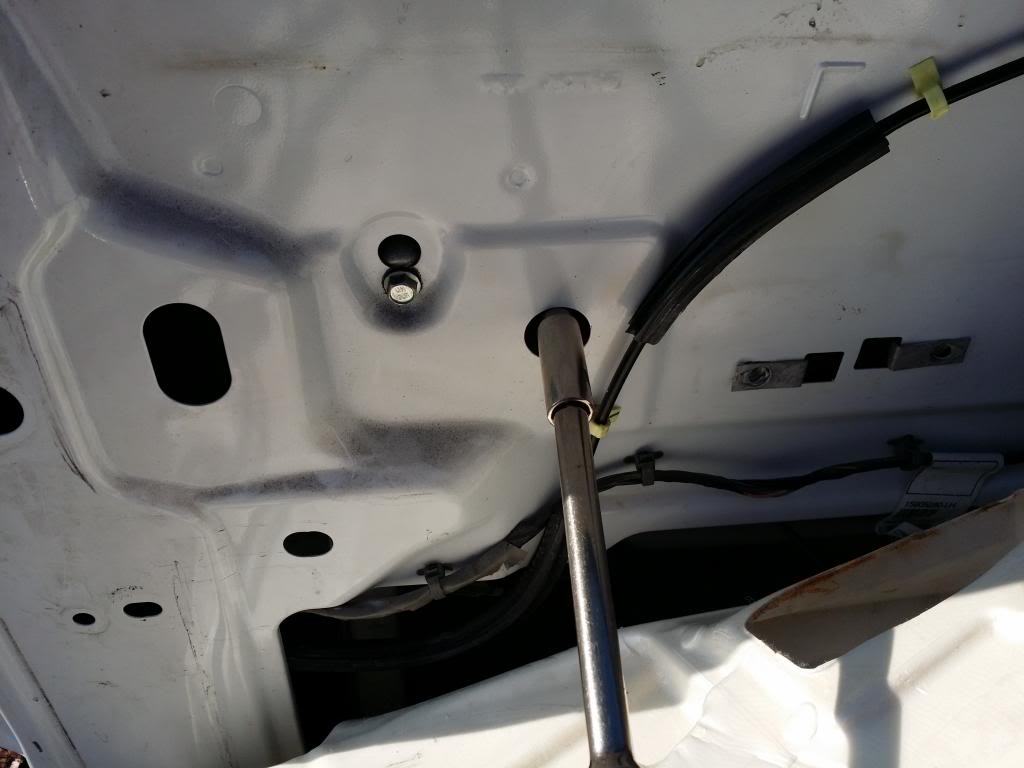

8. Remove the lower plug in door to access bolts in door handle.
9. Remove the 2 10mm bolts for outside door handle.
10. Move the door handle out to access the lock and handle rods. The GM manual says to remove inside the door but I found this way to be much easier.

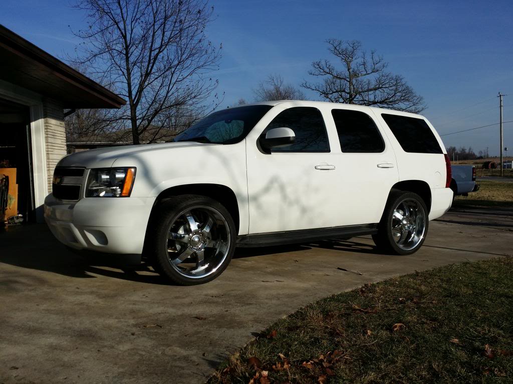

Before
After
