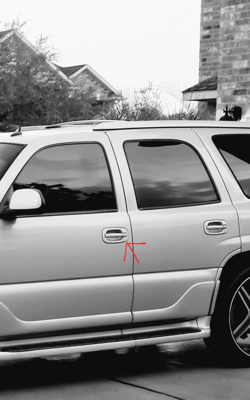

My 2004 tahoe was broken into when I let my mom drive it. They only took her purse and not the truck. They left a deep cut in the keyhole of the drivers side handle. I want to know if I can easily install a passenger side door handle to the drivers side to prevent people from just messing with the lock and breaking in.
I did that to my yukon several years ago and has been like than since. Don't recall if I had to modify the rear handle.
