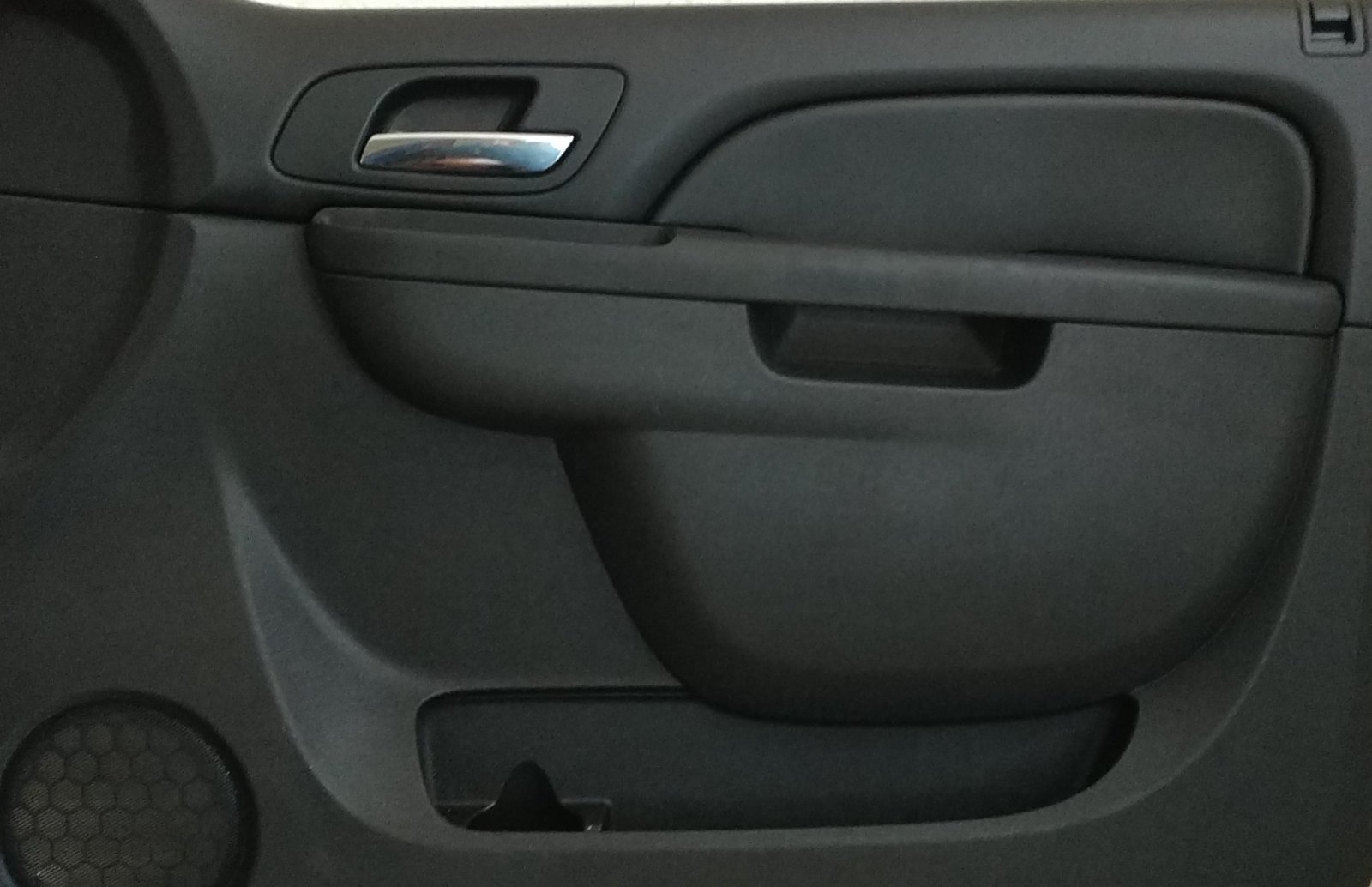

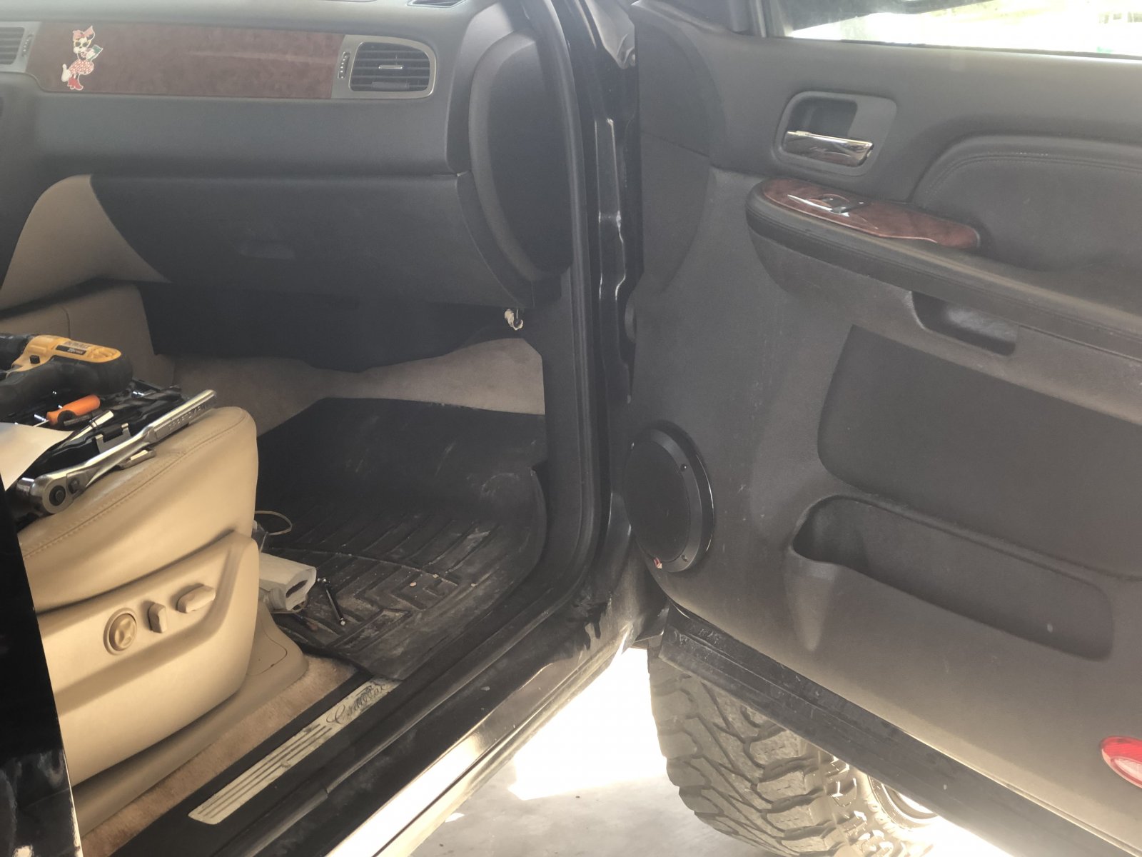

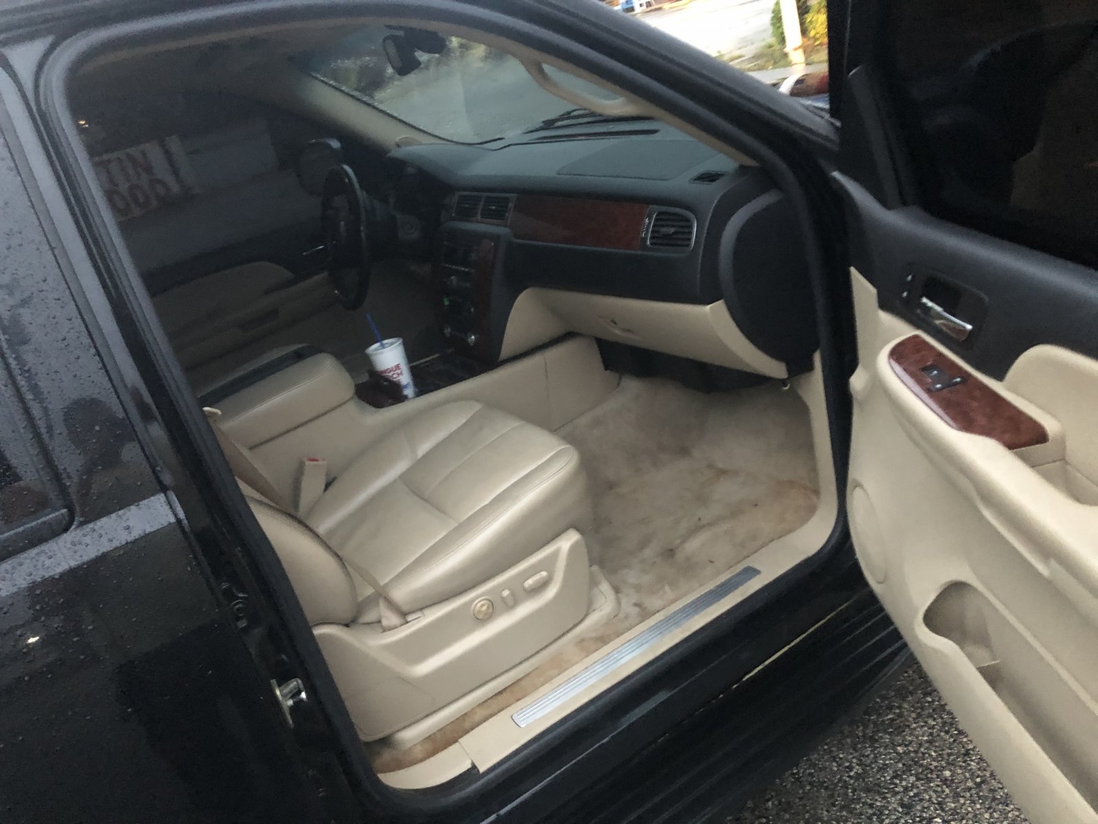

The silver bezel is the 10-14 style. The wood is the 07-09 style. I learned this through first hand experience having to replace a crap 2012 panel for a Tahoe.
here are how the panel styles changed. That big bulbous thing is just more stuff that can break on the backside of the panel. Plus it reduces the amount of leg room you have under the arm rest. If you have big balls like me it's nice having that extra space to open your legs. All joking aside you won't even notice the difference if you only swap one side that failed and I doubt anyone else will notice unless you point it out.

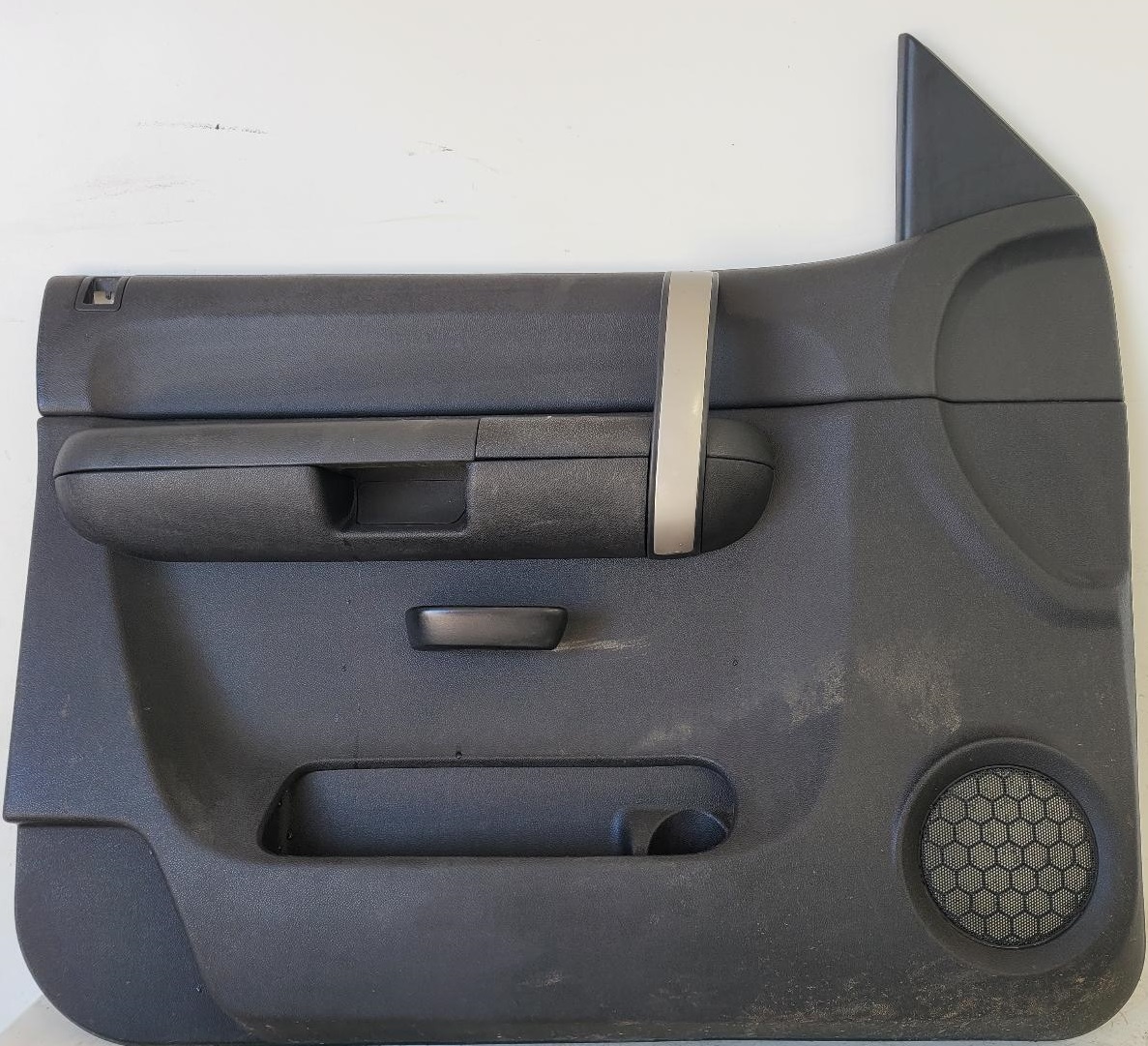

If your sierra / silverado has a door panel like this, a tahoe/yukon/escalade panel will NOT be a direct swap. The trims won't look right nor line up, you will lose out on one securing bolt and I don't think the master switch can be swapped*. There is also the matter of the cable to open the door. You'll need a longer one.
*Perhaps the master switch won't need to be swapped if the plugs on the tahoe/yukon are the same as the sierra/silverado master swtich, but I am unsure.

If your sierra / silverado has a door panel like this, a tahoe/yukon/escalade panel wil NOT fit.
Actually you can convert it over by swapping over the cables on the door handles off a ltz if I’m not mistaken? However without swapping to a ltz dash it lines up funny and the dash swap is a way more tedious project then the Somewhat simple door panel swap
You touched on the main points for sure. It could possibly be converted over.
I don't consider it a swap though, due to the trim not lining up, changing out the cable, the door not looking the same as the rest of the interior and missing one securing bolt in the process.

No. If the Chevy or GMC has heated and/or ventilated seats, you cannot use Escalade door panels. The Escalade has the seat buttons in the HVAC control head and the opening for the inside door handle is smaller. The driver panel only has the driver 1/2 buttons and the passenger panel has no buttons at all.
I used them on my ltz but your correct I swapped my window buttons out so it had the plug for my heated seats and my redneck ass ran the heated seat button behind the triangle trim piece where the mirror bolts on at
So when someone rides and asks how to cut the seats off I just tell em to look behind that cover lol

Looks like you have an extended cab since it has the indention for the seat belt retractor so you’re going to need the extended cab panel. If you had a crew cab, the panel would be the same as a SUV.
Bummer. Thanks for the info though. I’ll narrow my search.
