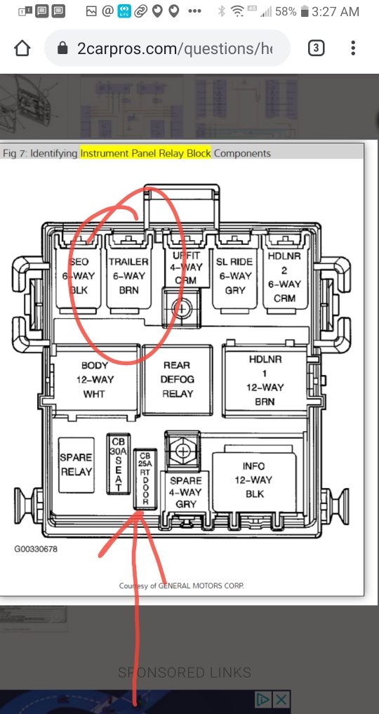

They worked all summer it's now cold now and there is no lights coming on for heated seats neither sides .. like no power ...you know I thought of this issue when I fixed all rusty grounds ya everything getting more power now so it probably burned out front seat heaters [emoji849][emoji15]

I never worked on the seats at all .. but fixed grounds under outside and to hood about 2-3 months ago . But heaters worked just till today ..maybe a fuse ..need to find it though.

About a month ago I installed a trailer brake controller. All I did was push and wiggled the relay on bottom a bang heated seats worked again . RT infact seats are even heating better is that RT for the heated seats or am I just chasing fuses and relays with tarnish on them? I really like heated seats in minnesota. It's a must have ... lol ..
Or could be the 30a one next to it I wiggled ..I think 30 a control seats and other power ajust pedals and stuff. Someone might know more about it than me.

Correct, that controls the memory control module under the seat. I had to replace mine after everything stopped working.

So was it really the 30A one ?? That caused the seat heaters to stop ?? Or the 25A .. I just will buy new one because the relay might be having issues . Another thing I was seeing was these relays could easily get kicked under dash also even though it has a plastic little guard . Thanks for the reply ..

Sorry I wasn’t clearer. I had to replace the control module. All of my functions including pedals, seat movements, and heat stopped working. Both of my fuses were fine.
