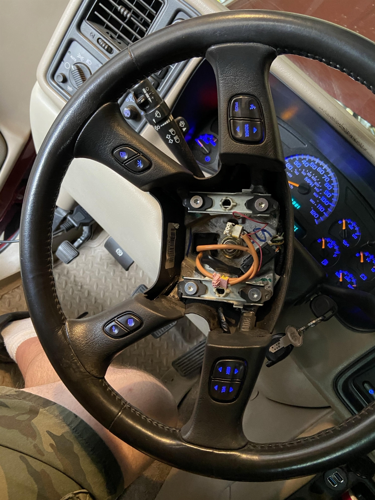

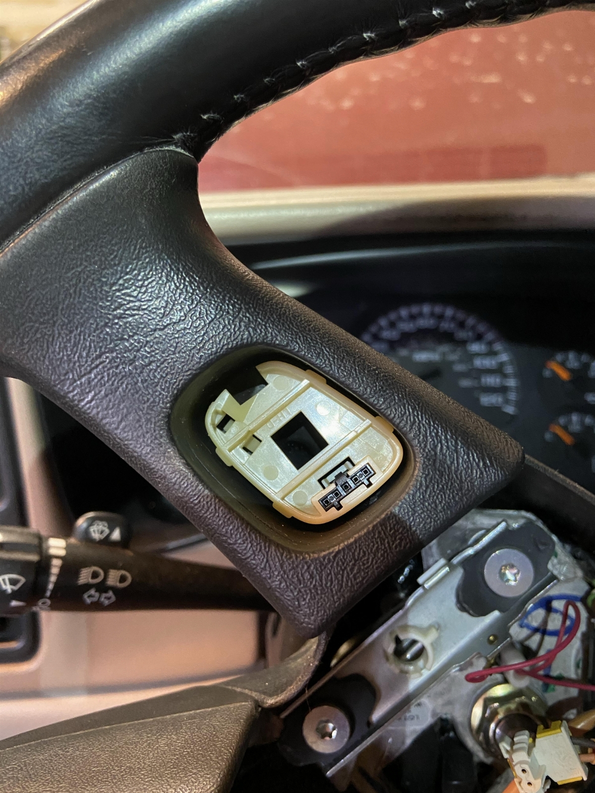

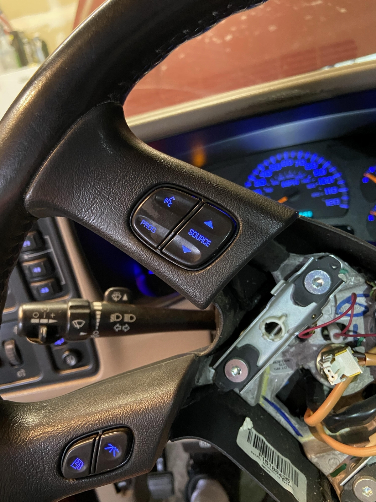

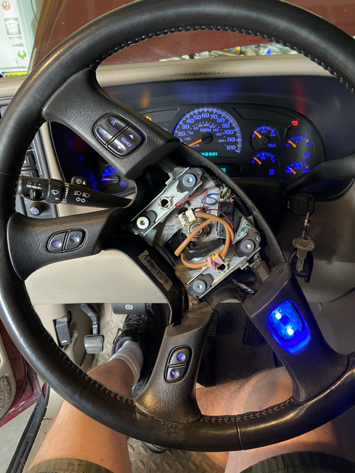

I purchased new buttons. Easiest fix.
I went with Dorman ones. The wire in the steering wheel is very short, makes it a bit challenging. Had to remove the air bag.
part numbers 901-120, 901-121,901-122,901-123 IIRC
Yes the steering wheel buttons were definitely a challenge! Once I removed the air bag, I was still unable to get the modules plugged back in, so ended up putting them back together piece by piece while installing back into the wheel.
That is a good solution. I had to use a hooked pick to hold the male end of the clip and pressure it into the back of the buttons while pushing the buttons into place.
I tried all kinds of things, but ended up reassembling in the wheel. No matter what, expect that part to be a PITA!
