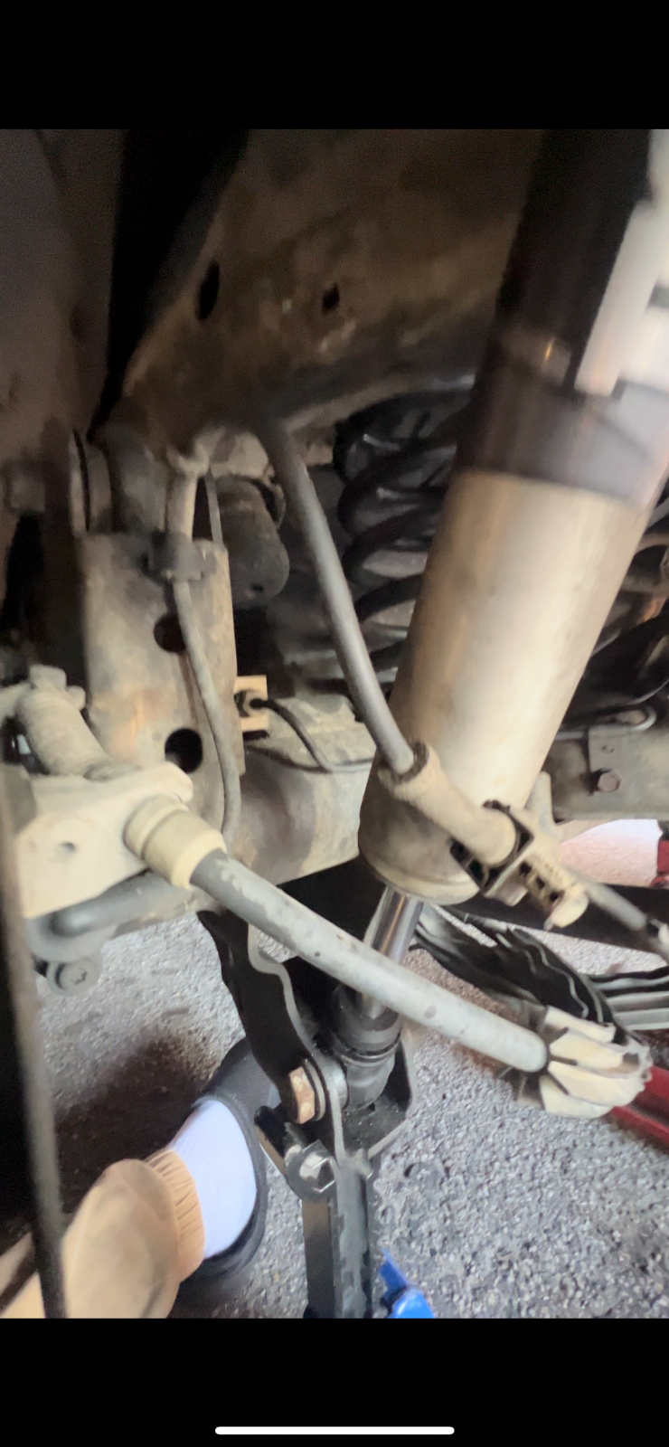

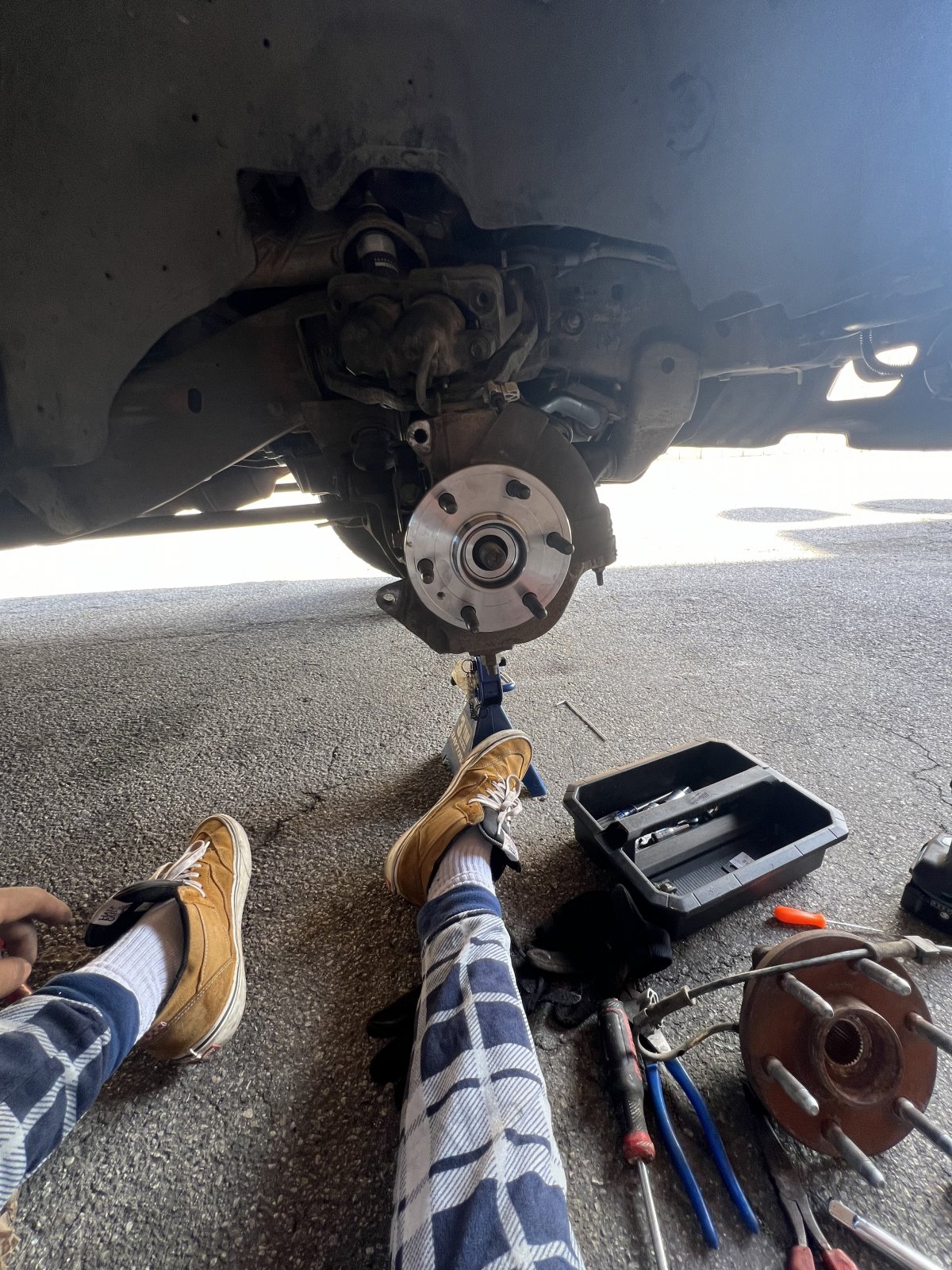

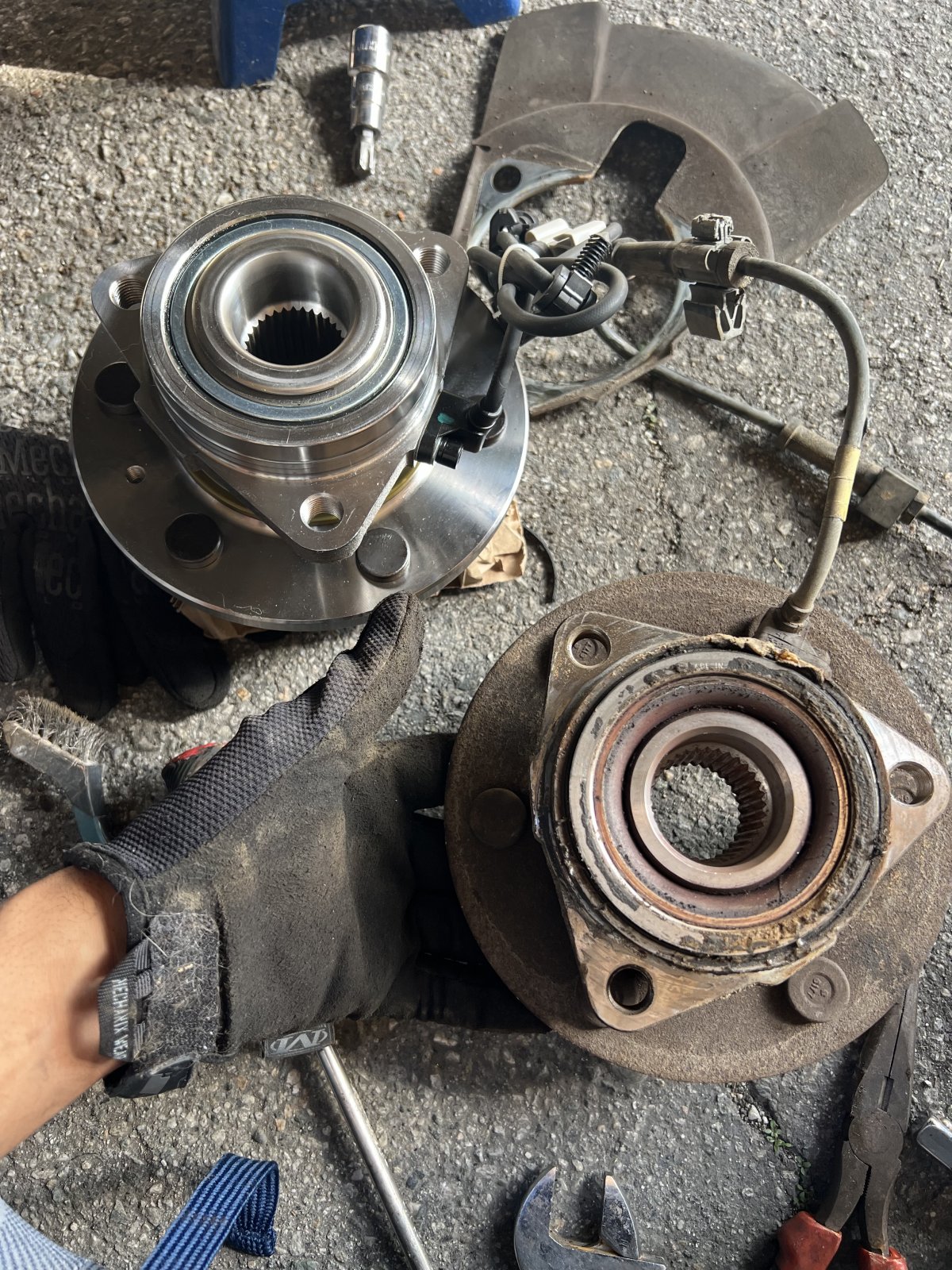

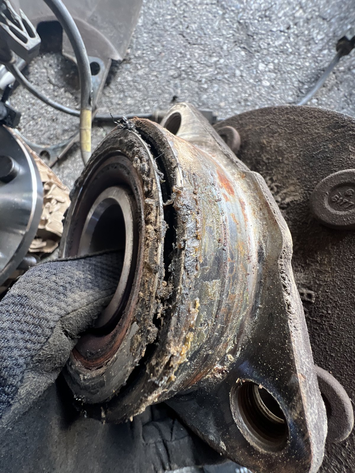

I’m having the same issue, so far I’ve changed abs sensor in the rear left tire, and the wheel hub/bearing of front right wheel.
I’ve pulled the abs fuse as well to no resolve.
My next moves were to address the master cylinder and brakebooster. If you are able to find a solution please let me know I’ve been trying to get my truck back on the road for almost a month.
If learn or find a solution I will be updating this thread.

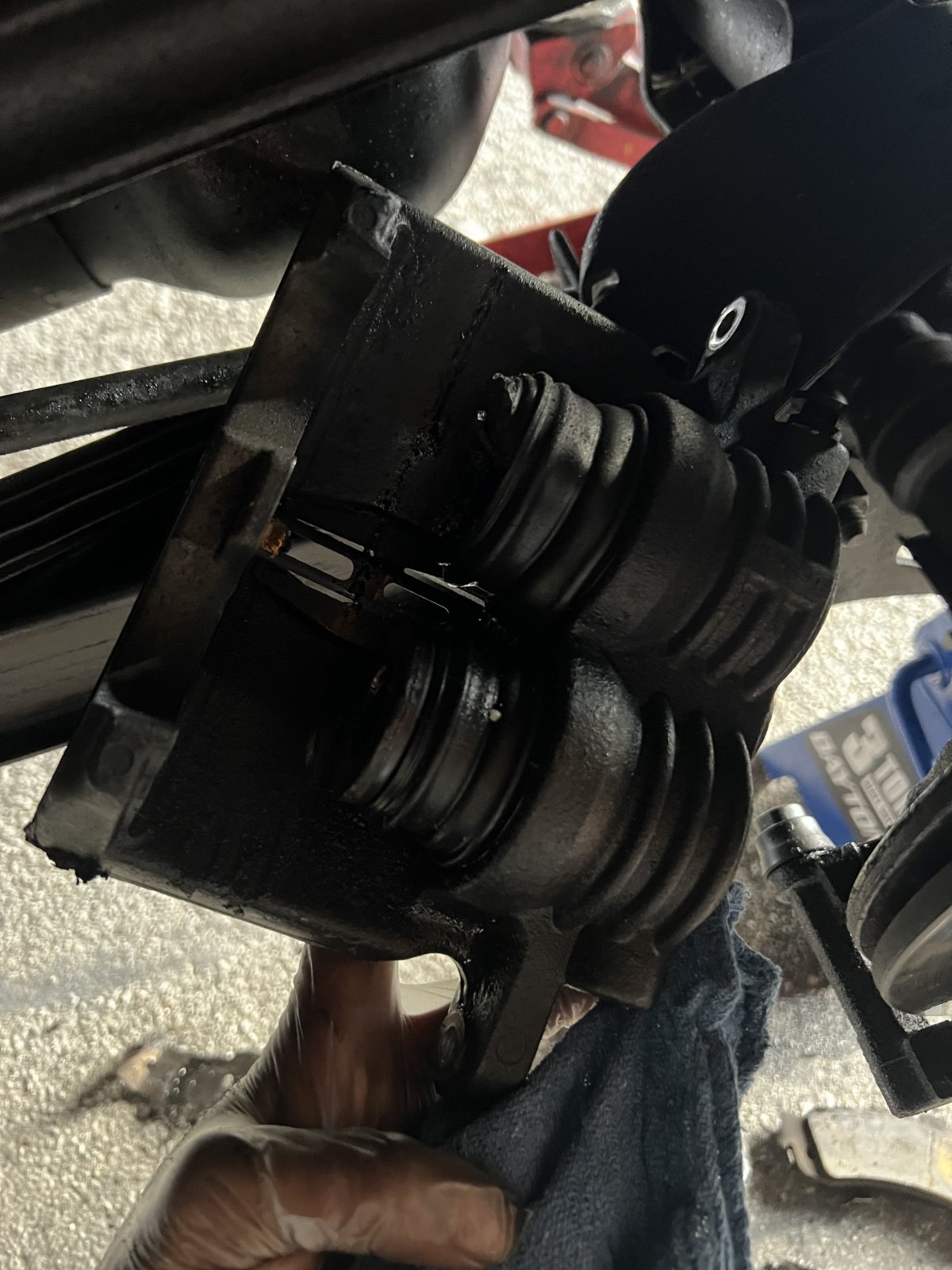

Very logical analysis! The caliper piston in the rear had completely shattered due to depleted brake pads. It release most if not all of the brake fluid. Upon realizing this I replaced the caliper and the presumed amount of brake fluid. All pads are new front and rear.
I did need to bleed each one to be able to pressed the pistons in just in order to be able to set them in place over the brakes pads.
*which I thought was odd being that I’ve never had that experience during a brake change*
Before bleeding each brake the pistons would protrude even after applying pressure to push them inward via c clamp they’ d push themselves back out.
