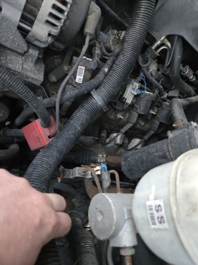

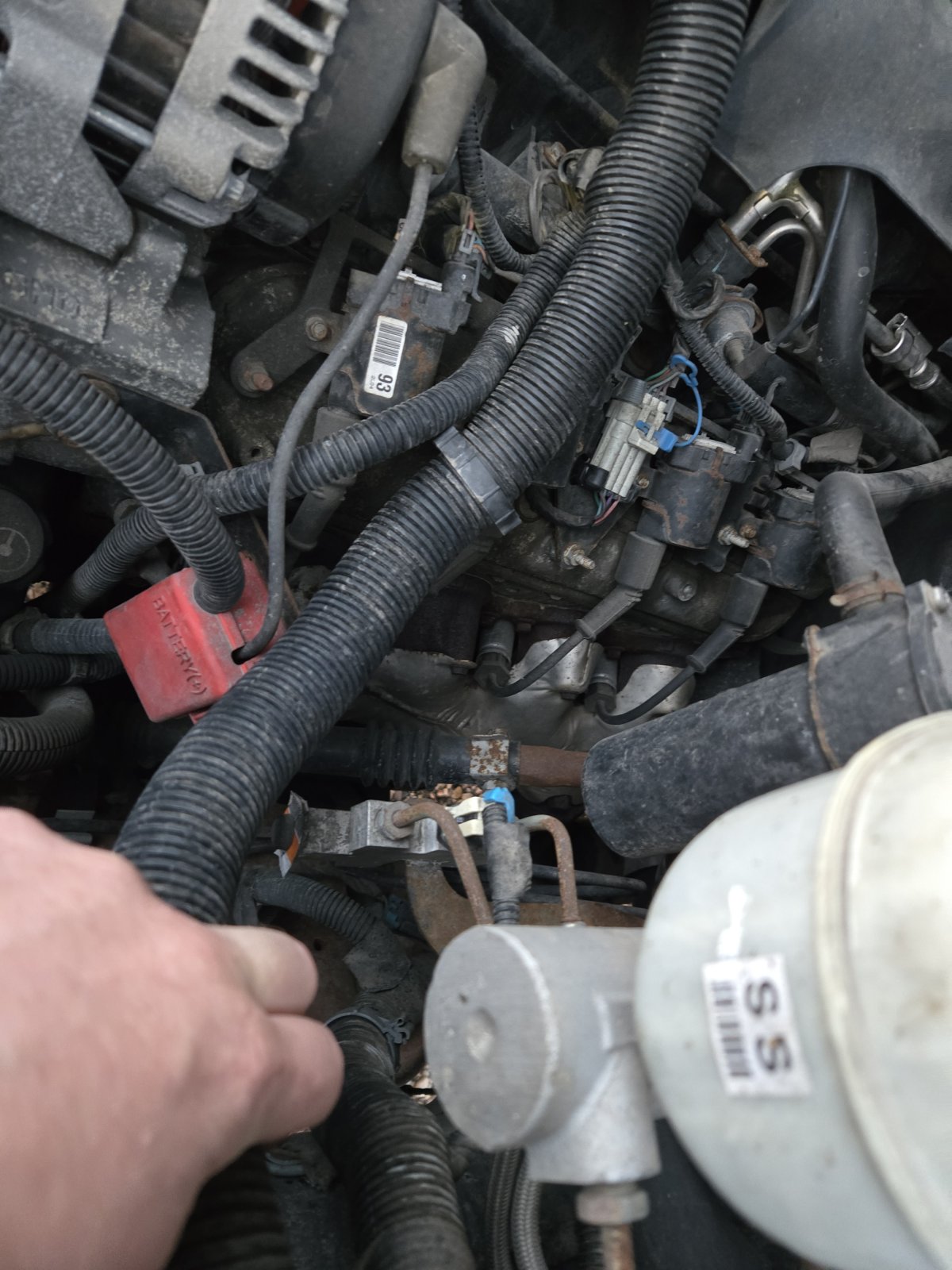

Did that about 5 times. No difference, but I did find out when I unplug this sensor for the proportioning valve it goes away. I do have a parts truck i could get it off of. Would i be able to "reset" or clean said valve and sensor? I think there is a piston of sorts in there from what research I did last night.

Update: after doing some talking and digging it turns out the proportioning valve piston was too far forward causing the sensor to read wrong. After bleeding the front brakes it brought the piston back to center and light went away. Turns out this can happen when compressing caliper pistons on these trucks.
