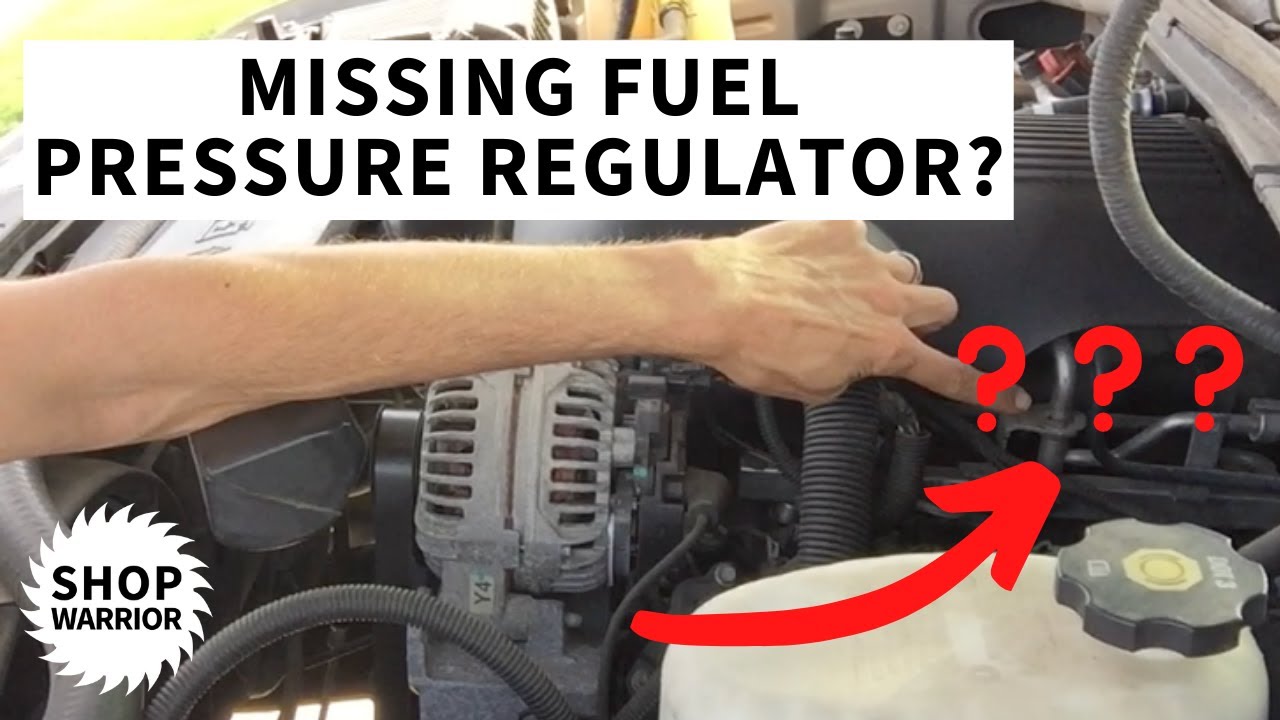

TollKeeper
Feb 21, 2010
3,564
7,485
Brighton, CO
What it would look like if your did have a FPR
Y
Yukonxljake
Jul 28, 2021
14
I watched that video and he's saying it's on the fuel pump itself, I don't think this year physically had one

I did, it is not. That's what I am so confused on how it's losing pressure with no FPR and a new fuel pump.
