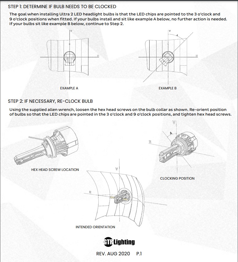

Make sure that the LED headlights that you purchase are adjustable, meaning that the LED assembly can rotate within its outer shell, so that you can properly position the LEDs during installation. The actual LED beam adjustment mechanism is different for different brands/models, but the instructions supplied with the LEDs (or an installation guide on their product web site) should guide you through the process.
Bottom line, the popsicle stick in the LED headlight holding the LED chips needs to be as close to vertical as possible, after installed and locked into place in the headlight housing, with the LED chips pointing to the 3 o'clock and 9 o'clock positions. The photo of the guide below, while not for your specific brand/model, will give you a visual sense of how these LED headlights need to be positioned in a correct alignment within the headlight housing.

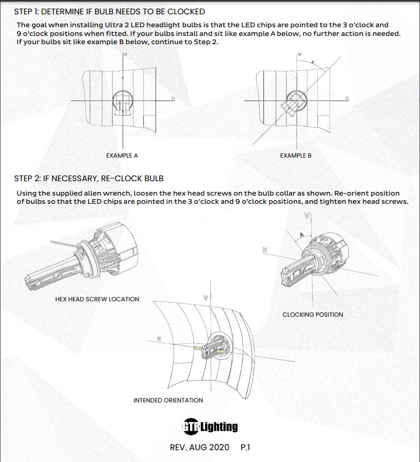

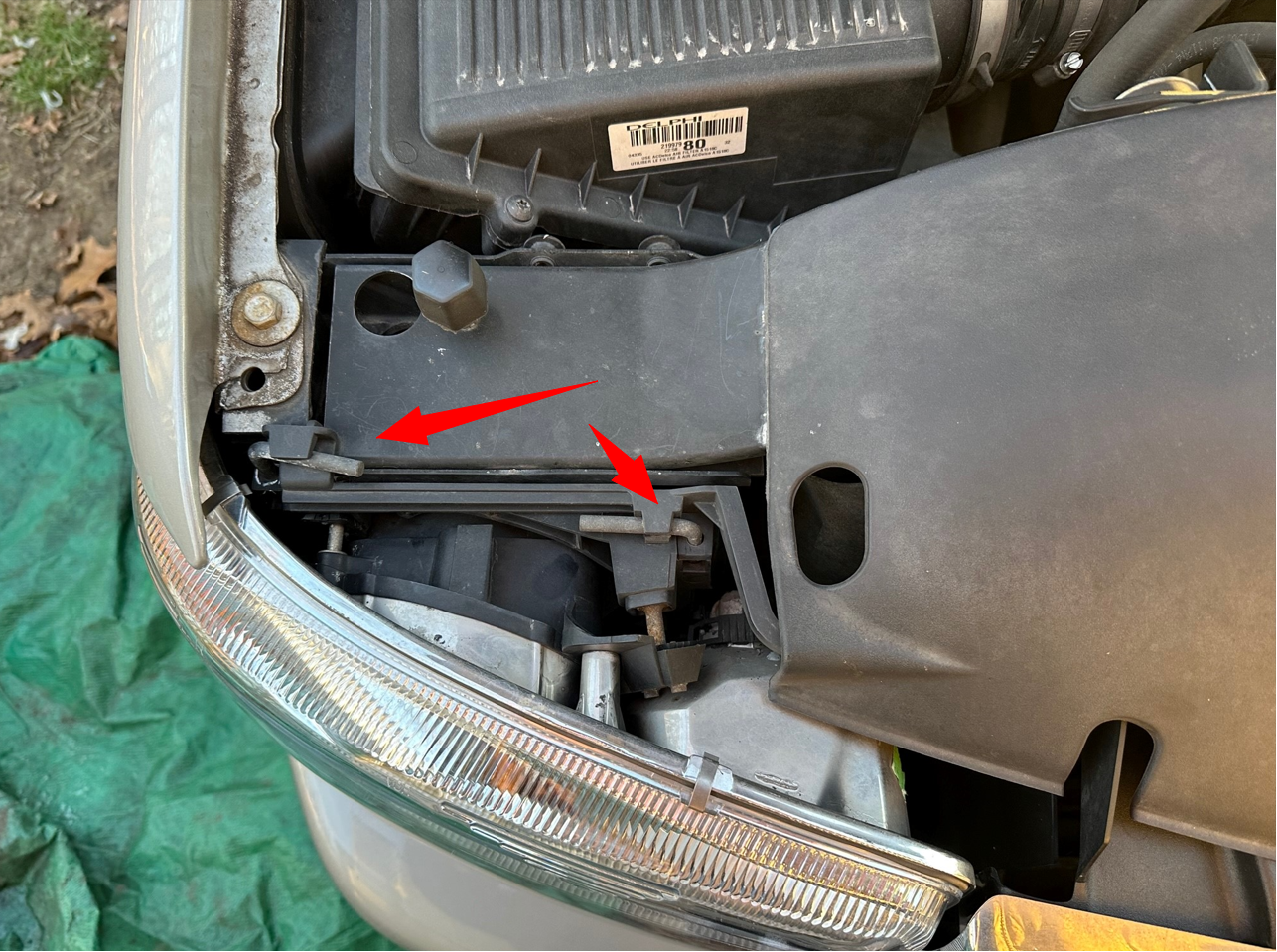

good news never i changed a bulb on this has these nifty release pins for the entire lamp!

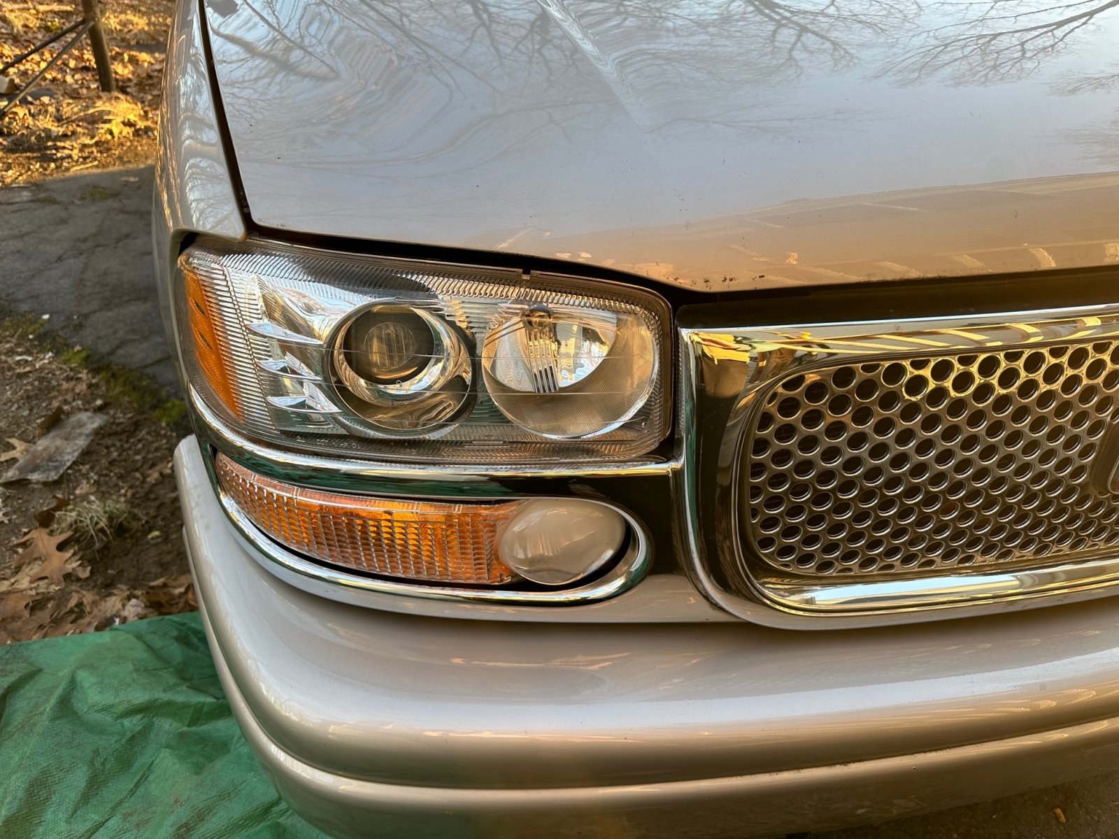

Thanks I will check them out ......the lens are original so yes they are old I'm not sure what projector head lamps are i will have to look that info up. Regardless, I want to upgrade not matter what i drive my wife's 2019 and the visibility is night and day.

Projector headlamps are what you have my friend if that is a photo of your headlamp. It should just be a matter of replacing that old projector assembly with something a lil newer. There are people who build headlamps who would know better if there are any drop-in solutions or if it will require modification.
Yes the photo is from my Denali!
Great engineering on that feature! Makes parking lot replacements without any tools whatsoever super-easy.
The pins also release the DTRL/turn signal assembly when removed. When you end up having to change bulbs...
