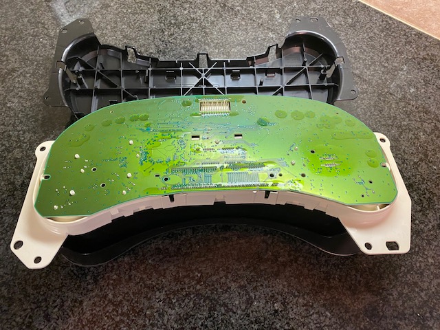

I have been reading several different threads on changing out Instrument Panel Lights on a Tahoe LS 5.3L vehicle. What's confusing is most articles say pull the dash unit and pull off back and twist and replace bulbs as needed... problem is... my particular dash doen't have lights on the board... only a circuit board... no ports or plugs for lights... any ideas or suggestions? Thanks in advance..

The lights are on the other side of the circuit board, soldered to it, as shown in the video I posted in post #4.
Back to basics, is the dimmer switch on your dash rotated up to illuminate the backlights? Do your other panel lights work (HVAC, etc.)?
EDIT: this is about what the circuit board looks like on the the business side:
The backlights are the little bulbs that are around the white stepper motors (one motor for each gauge). The tach and the speedo gauges have two bulbs, all the others have one each.

Guys, you have been most informative… 2 thoughts… if my dimmer switch is faulty, how to I access that and fix it… 2nd how did you get to the business side of the circuit board? I can take off back like I did, but I don’t know how to access the business side…

In order to get to the business side of the circuit board, the gauge needles have to be removed. The video shows that.
