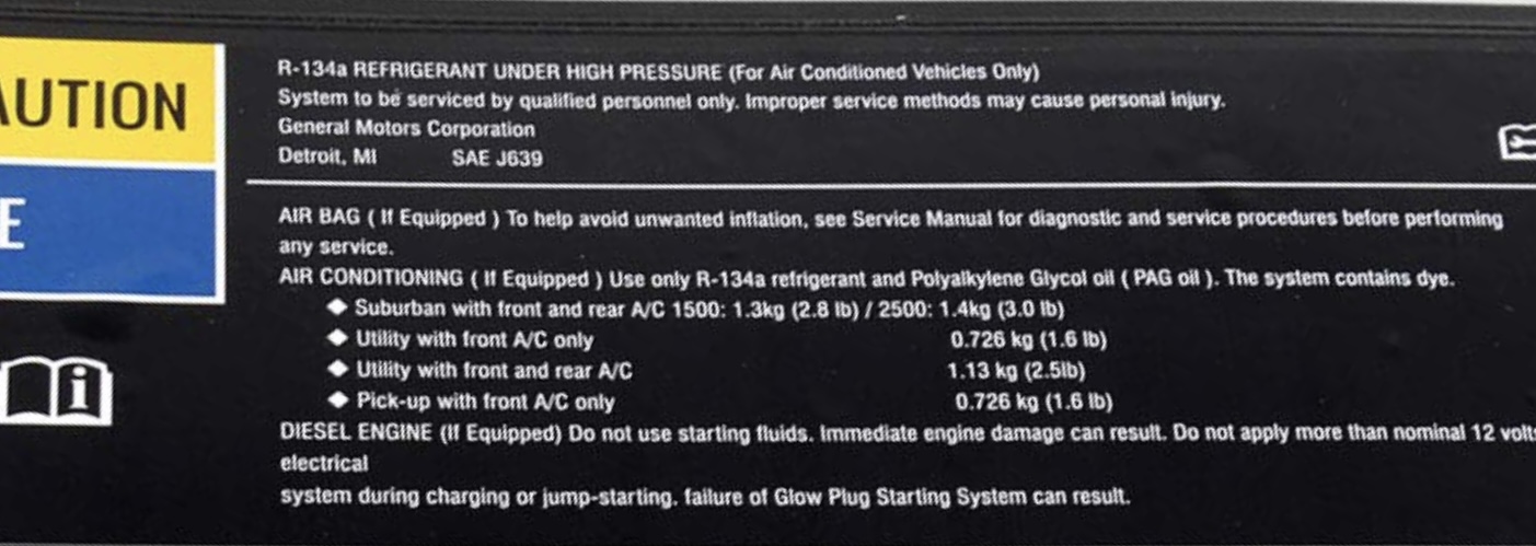

Does anyone know what the capacity is for AC R134 in this truck with rear
and without rear ac??

One of the decals on the cover of the radiator support normally has that information. 1.6lbs if you believe this random pic

My sticker on top of the radiator is not readable.
