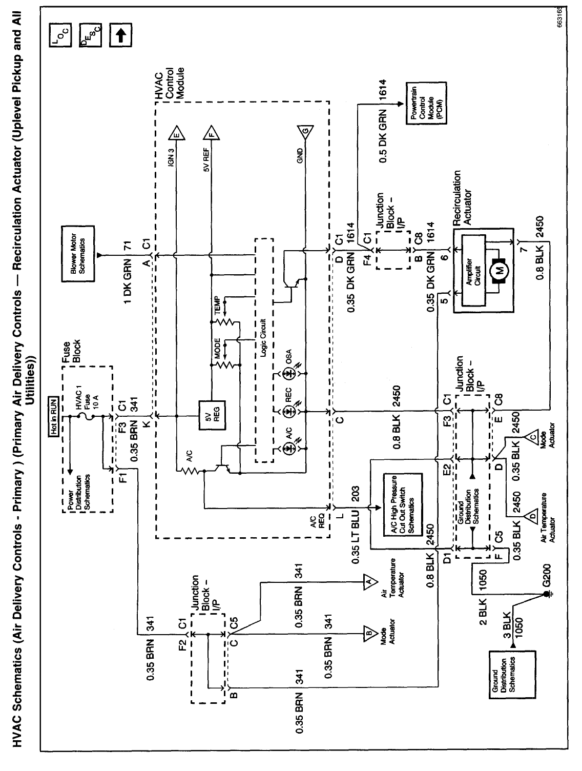

Bad relay? What do you mean by jumped exactly, your shorting the relay switch?
Have you checked the coil side of the circuit? How's your chassis grounds there front driver side. The under hood junction box / relay coil is grounded somewhere to one of those. Otherwise, there's a control line you can trace that back to the switch in the truck. Do you need wiring diagrams?

Can you send me wiring diagrams if you have them?
Thanks
Matthew Jeschke
Dec 28, 2017
2,364
1,762
Sahuarita, Arizona
These are for a 2001 Chevy Tahoe. I imagine it's pretty similar.
