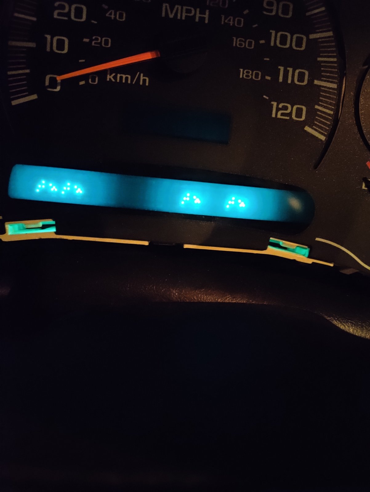

I have a 2004 tahoe I bought early last year that is now having trouble with the gauges. It's not the usual stepper motor issues (or at least I don't think so), the probelm started when I had a dead battery one morning and after jumping it off I had no dash lights, only the check engine light and blinkers worked. After driving a little and then leaving it I came back a few hours later and everything was fine. Fast forward a few weeks and this happens every time my battery dies. (I have been trying to figure that out to I have it narrowed down to the radio fuse) now the other night I have to jump it off and I have not had gauges since. I checked for power on the pins and I have good power ground and signal. All I have is what appears to be random lights on the odometer display I will try and attach a picture. I have also tried another cluster but it is of unknown condition.

No the other did the same thing check engine light before starting and blinkers work, also the back lights work
B
Billkrummel
Jan 27, 2022
Would the dic problems also cause all the other lights to stop working?

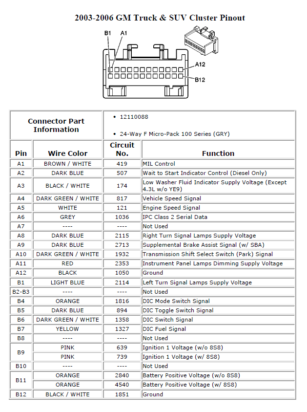

Are you checking all the power feeds to the cluster? There are at least 5, depending on the circuit. Also several grounds.

I had the battery tested, it's fine the draw is something on the radio fuse. I have tested b 12,11,and 9. I see a12 is a ground I will check when I'm home this evening that is all the power and grounds I see all the others are signals for gauges, I see a11 is for the dimmer would that cause this? I'm also picking up a new cluster today.

I tested the rest of the power and ground pins all check out fine. I tested another cluster and it did nothing as well. Any other ideas?
