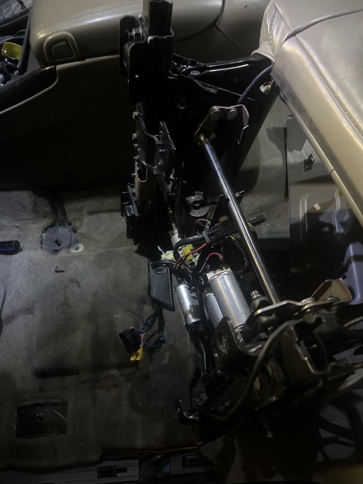

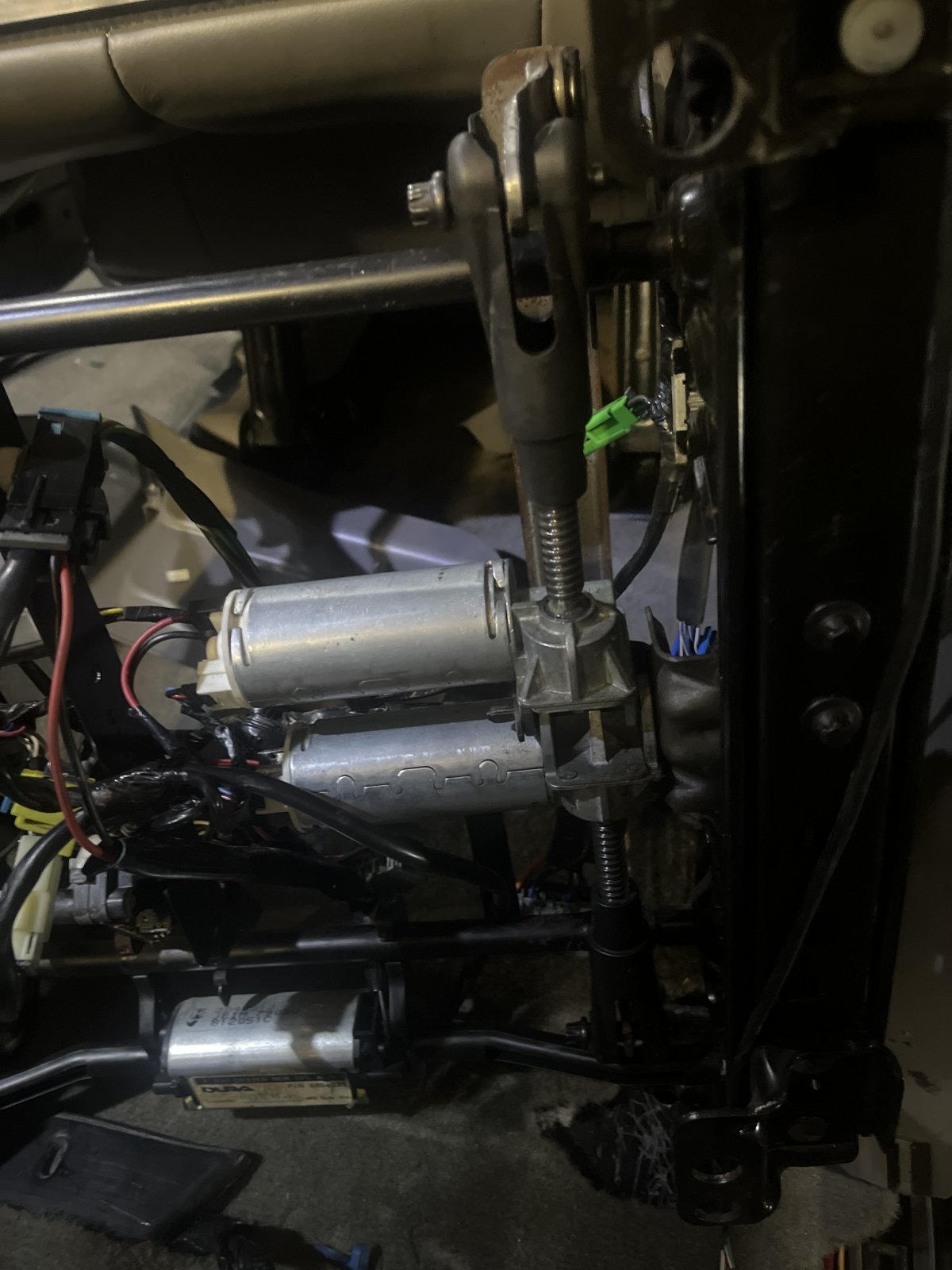

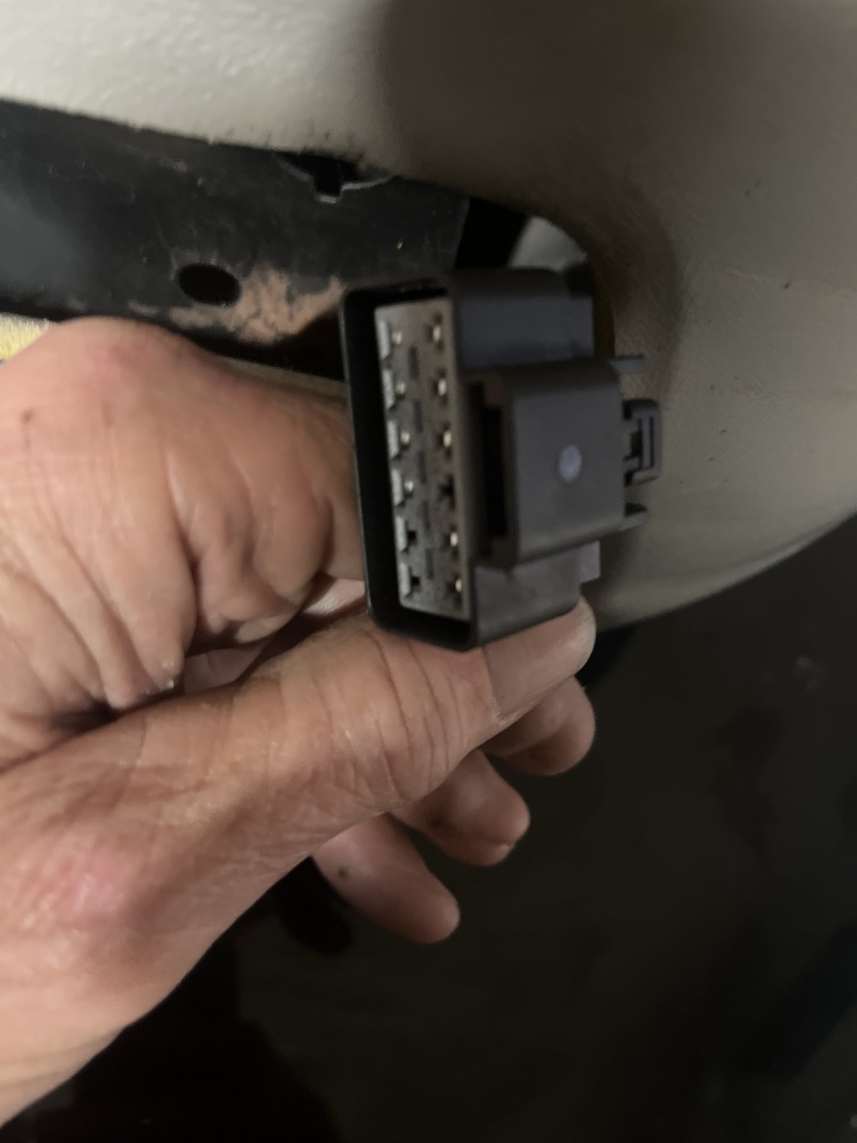

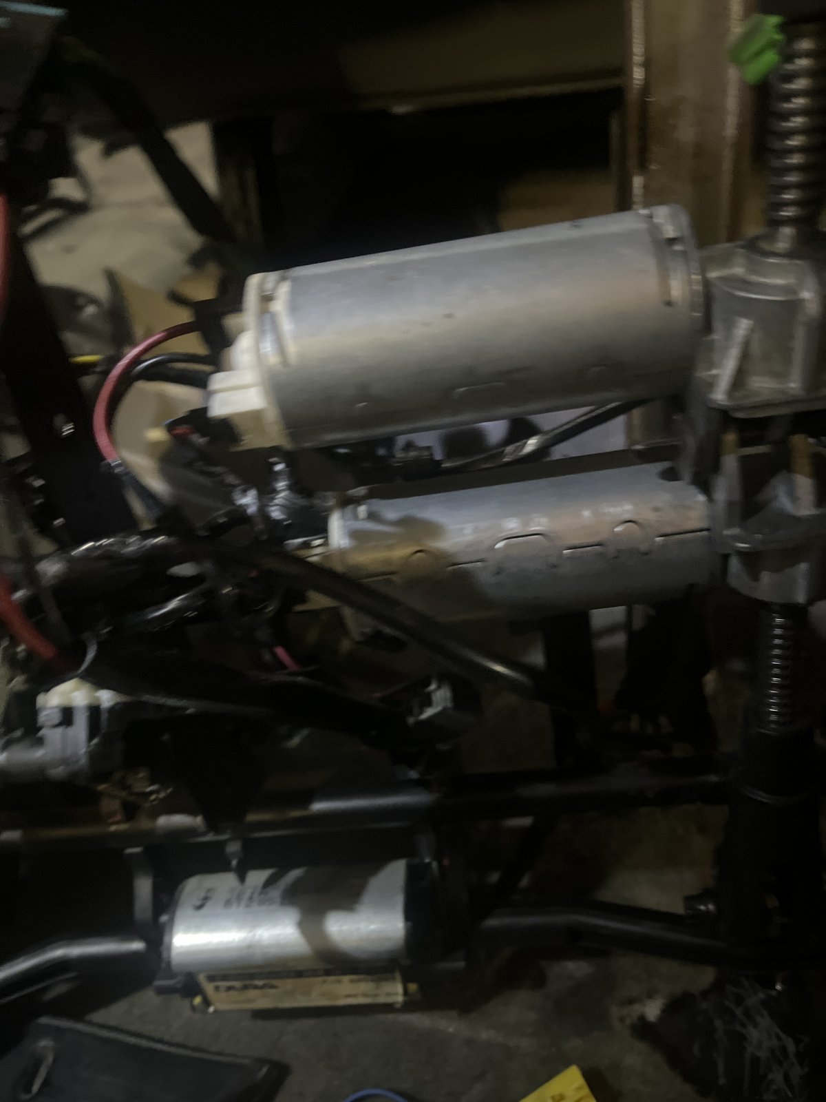

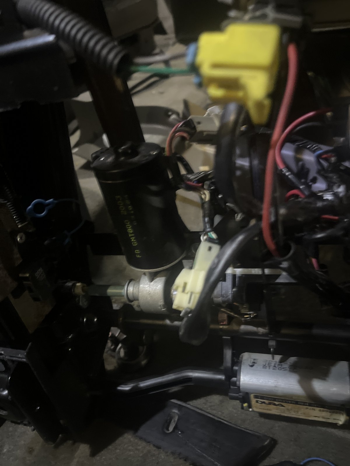

Nope. Does anyone know w where I can order the reclining motor for my 04 GMC Yukon Denali Xl and which motor is the reclining one?? I installed new seat switch I can hear a clicking in drivers seat control module but nothing on any of the motors under the seat when I try to recline the seat.
Heat to seat Fg works. Seat going forward /back is also messed up as I push new lever forward seat goes back an back it goes forward. It’s a hot mess is what I got. I can live with seat forward/back screwed up but reclining I can’t. Love this forum an help I’ve received.
Pissed in NW Iowa

Hope these help:
GMC YUKON — POWER SEAT WON’T RAISE—FIXED
GMC/Chevrolet Power Seat Repair
GruvenParts GM Truck Brass Gear Seat Repair
Chevy/gmc electric seat randomly stops working (fix)
GM Power Seat Stuck in forward or back position
Power Seat Not Moving? How to Diagnose Power Seat Motors, Switches, and Wires!
I posted several in case they help you fix your seat. That said, some of them have good pictures of the wiring under your seat. I think your wires may go to a plug, but I do not know why they would have been pulled from the plug -- and I'm just guessing.
