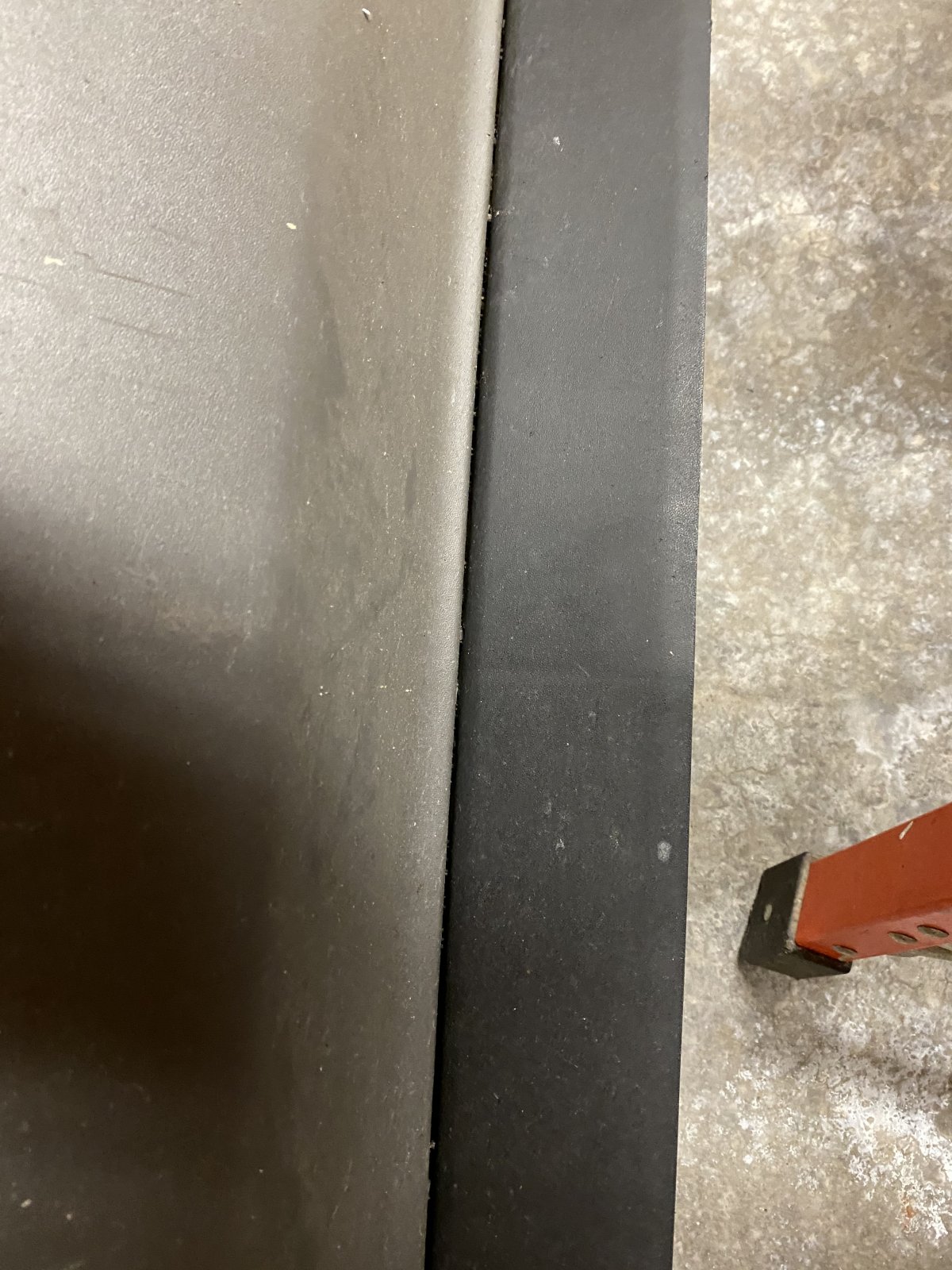

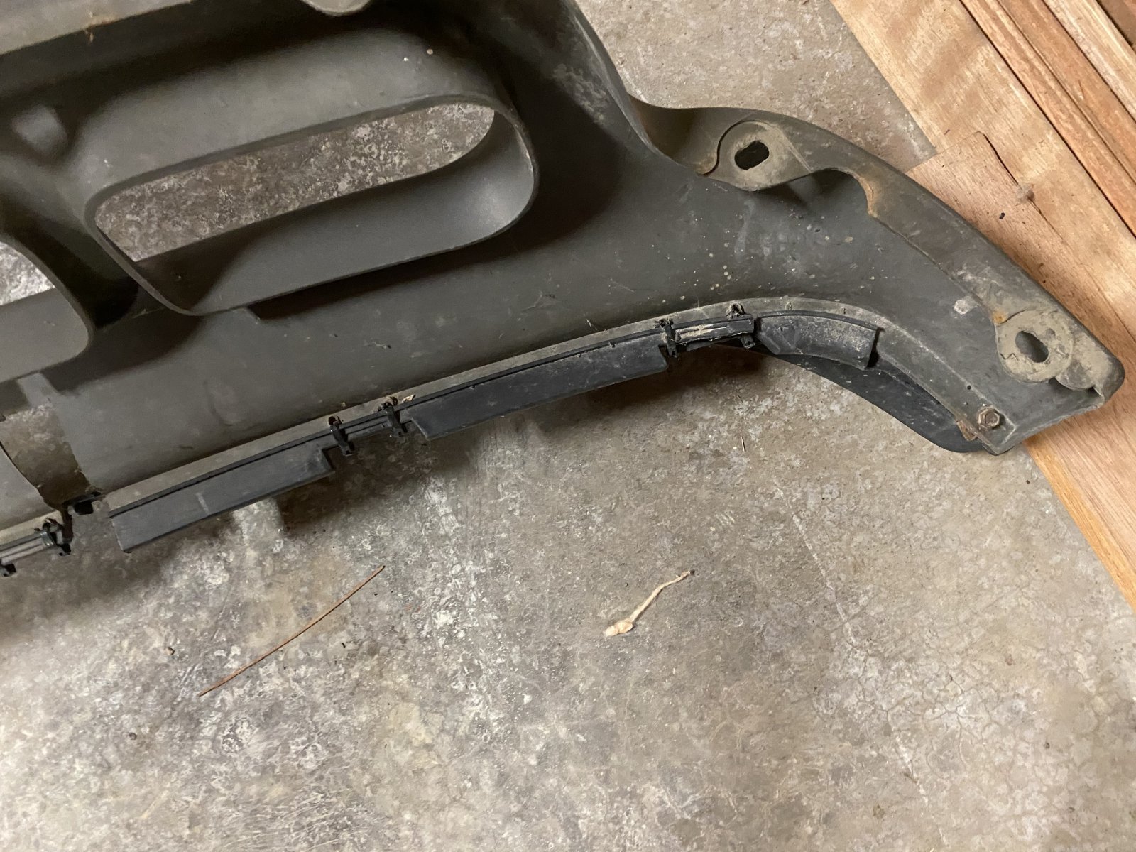

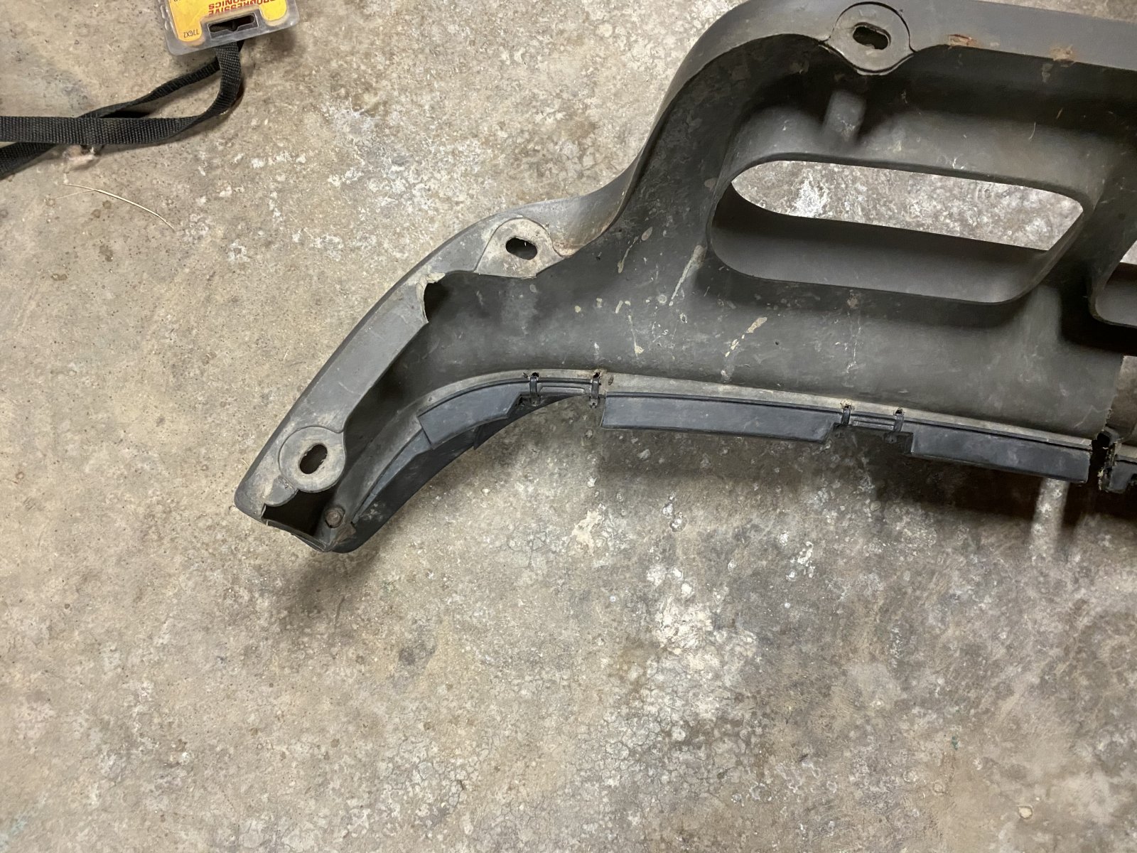

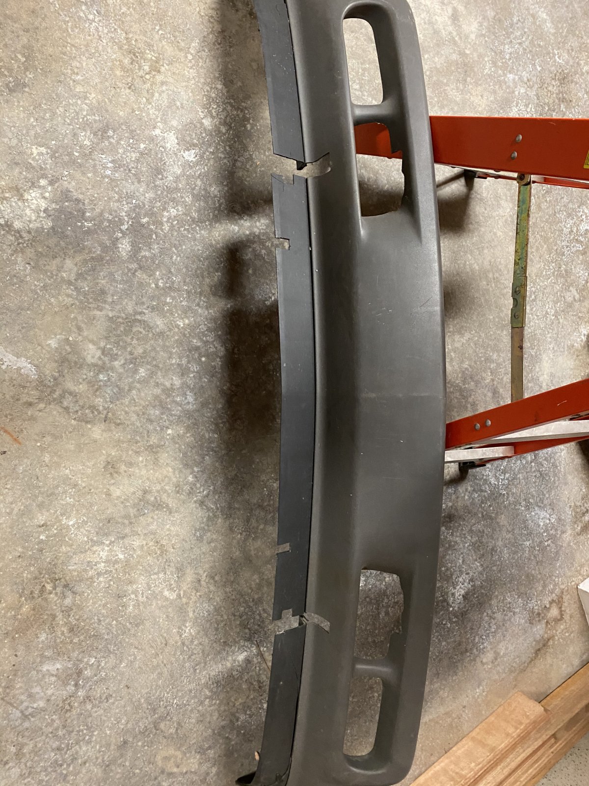

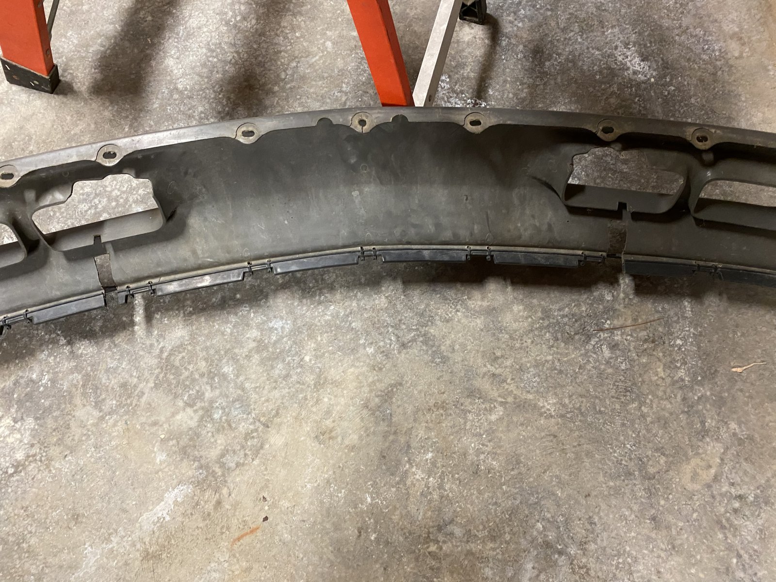

03 up had a molded ‘plastic clip’ on the return lip that goes back towards the motor and the dam clipped on then 2 screws at each fender. My 01 didn’t have the molded clips so I just drilled a few holes at those locations (backside) and a few p-ties and done. I’m not sure if you can fit it on that z71 one tho. Looks like the plastic ‘skid plate’ portion may prevent it.

For reference cutouts are from my plow..

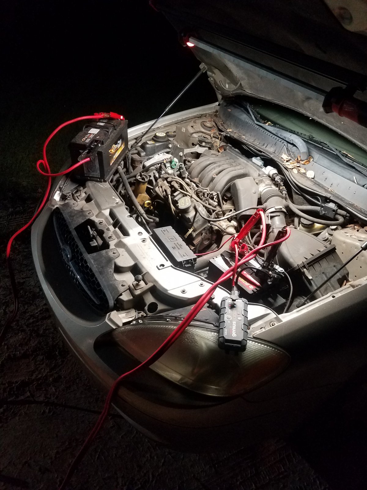

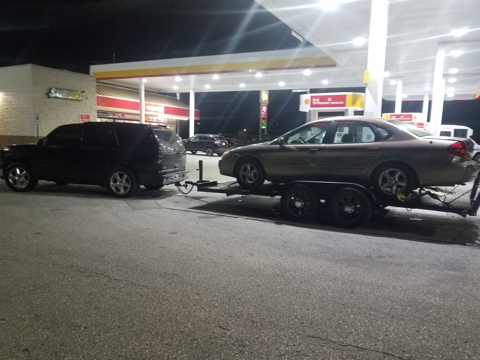

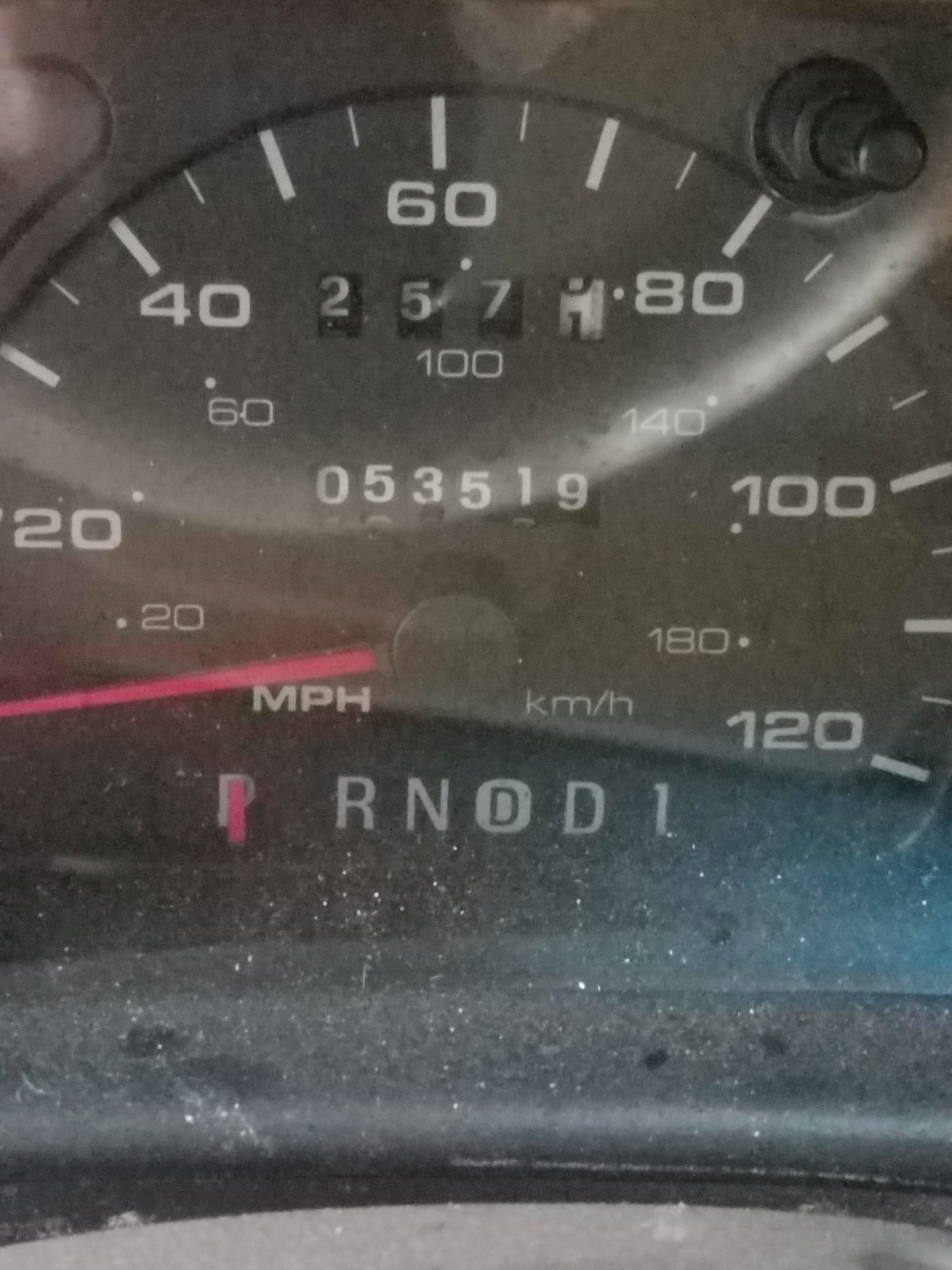

Never imagined I'd tow a trailer this much. Drug home another project, 53kmiles on a 2002 taurus with clogged cats for $500. Battery was stone cold dead as well took a 1,000cca battery and jump box to light it off. Hopefully a quick flip with just enough work required to entertain me for a week or two.
Averaged 12mpg across town mostly stop and go, glad I fixed the endlink yesterday truck feels super stable towing but would love that front hellwig.

Those are some nice jumper cables. What's that box connected to the cables?

Grandma's car with lots of short trips that killed the cats?
If you keep hauling like this, you're gonna have to invest in some load bags!

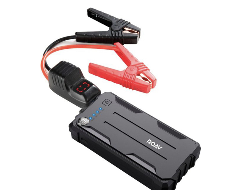

Like they said jump box but this one is shit it has let me down more times than it's helped. I got a smaller one because the reviews were great but if the battery is dead enough the starter won't click it won't help.
Looks like he needed both.... dead is dead... lol
Trying to run a 12v system on 4v :jester:
I do have a set and they help keep it from bottoming out but it still sits the rear down an inch or 2 even at 25psi. I might look into changing up springs because I think these are a little too soft even for regular driving.

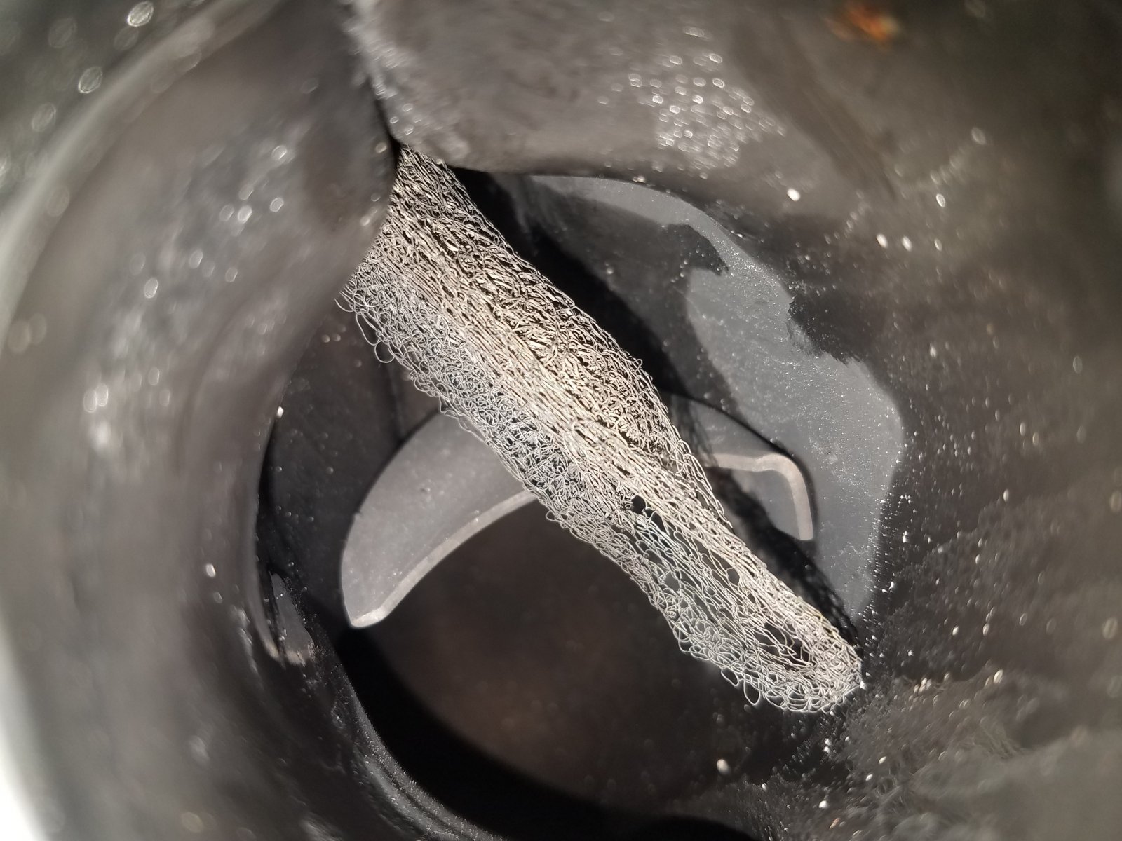

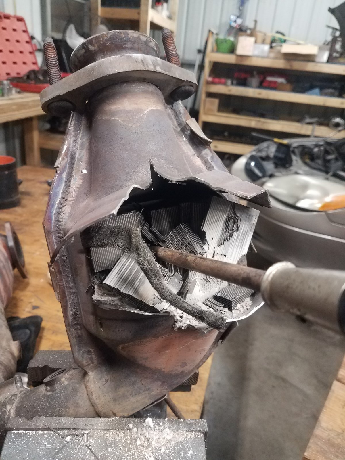

Also got some done to the Taurus, had to pull the passenger axle and a slew of other things the get the Y pipe out. Cats were totally clogged so I had to gut them like I work at a Chinese restaurant. Going to use my HPT to clear the rear O2 code and then I need to give it a good purple power ******** and put it for sale. That is if there's nothing else wrong but I don't think there is.
