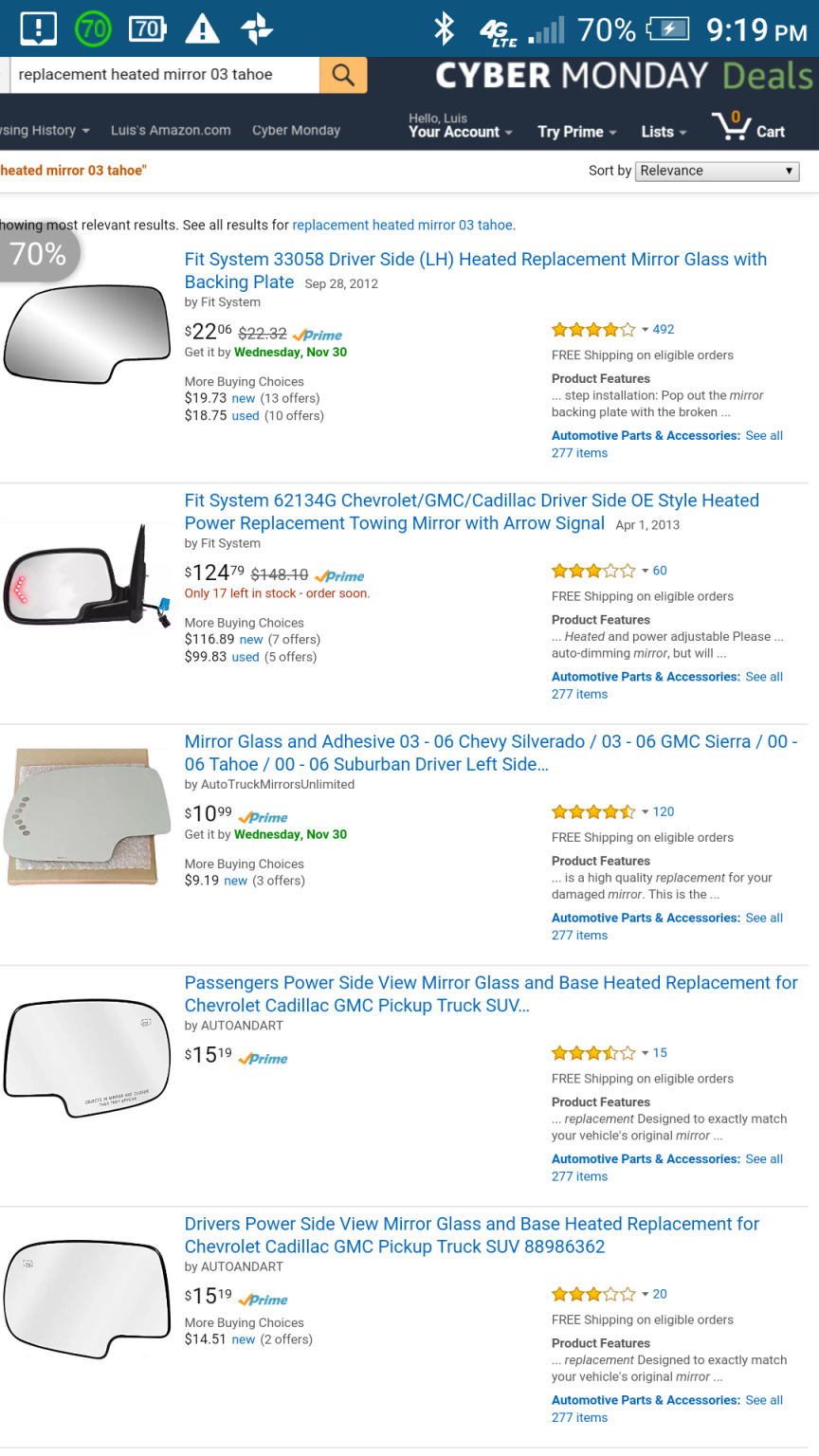

Guys,
Mine is a heated mirror that turned bronze in color. I was able to cut the bottom so the bronze fluid could leak out. Problem is, 80% of the glass is still hard to see with.
Is there a replacement (non heated) glass piece I can replace it with? If so, are there instructions posted somewhere?
Thanks,
Leo
33,199
51,441
I think it means you stick it on top of your old mirror. If that's what it is I'd stay away from that one.
Just grabbed this real quick to show you.
52,949
Yeah you want one with the plastic attached so it just snaps on. It's very easy that way.
