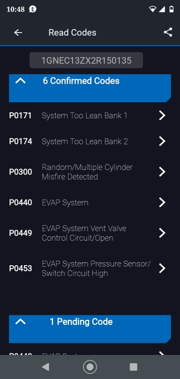

That's what I'm doing and the reason I'm doing it is because of those lean codes.
I should have everything to do it next weekend so hopefully we'll have good weather.
Sent from my moto g(7) play using Tapatalk

These are my codes.
I really need to tackle the evap issue but I just don't have time at the moment.
