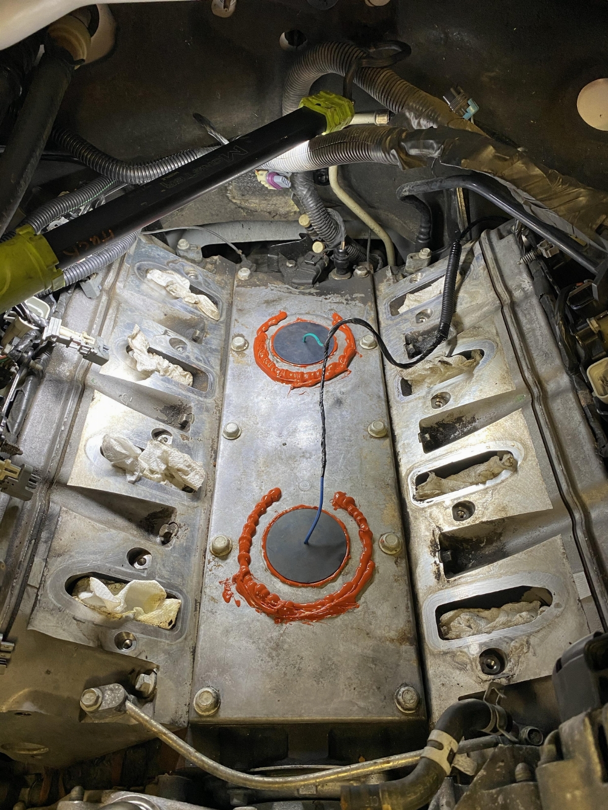

You also want to build up a small dam of rtv around those knock sensors. They have an issue with corrosion getting down into the sensor holes, so it’s a good idea to stop that next time around. Like so:

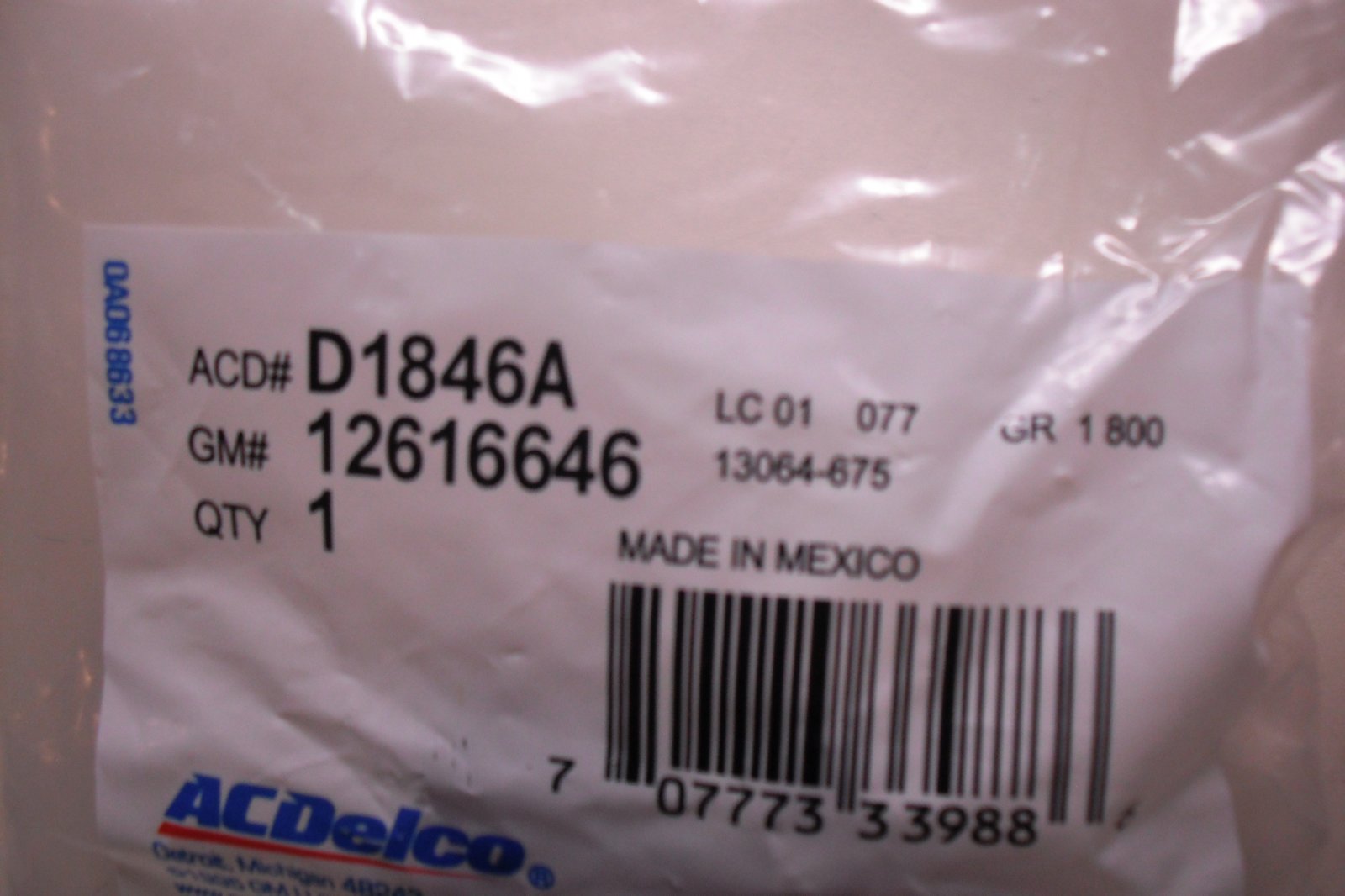

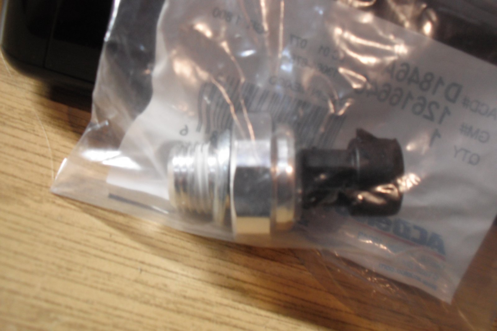

And replace the Oil Pressure Sensor that was right there in the back of the engine.
I will have to call the dealer tomorrow because on RockAuto all I am seeing is wave or standard motor products. I try to use all ACDelco on my vehicle unless there is a better brand.
