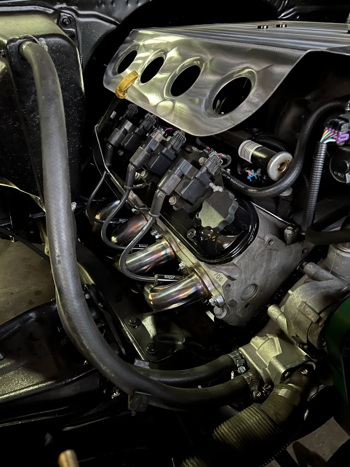

wiring was finished mainly now and ready for the first test drive.
First test drive went okay. Was getting a knock sensor code though which I was in dis belief because I put brand new ac delco sensors in.
Fully re assembled!
Thought it was about done at This point but after about 100 miles it started missing and running like shit. Ugh

Well waiting on my buddy to come help tune and diagnose cause it wasn’t running well I at least got some good pictures and switched all the lights to clear on it

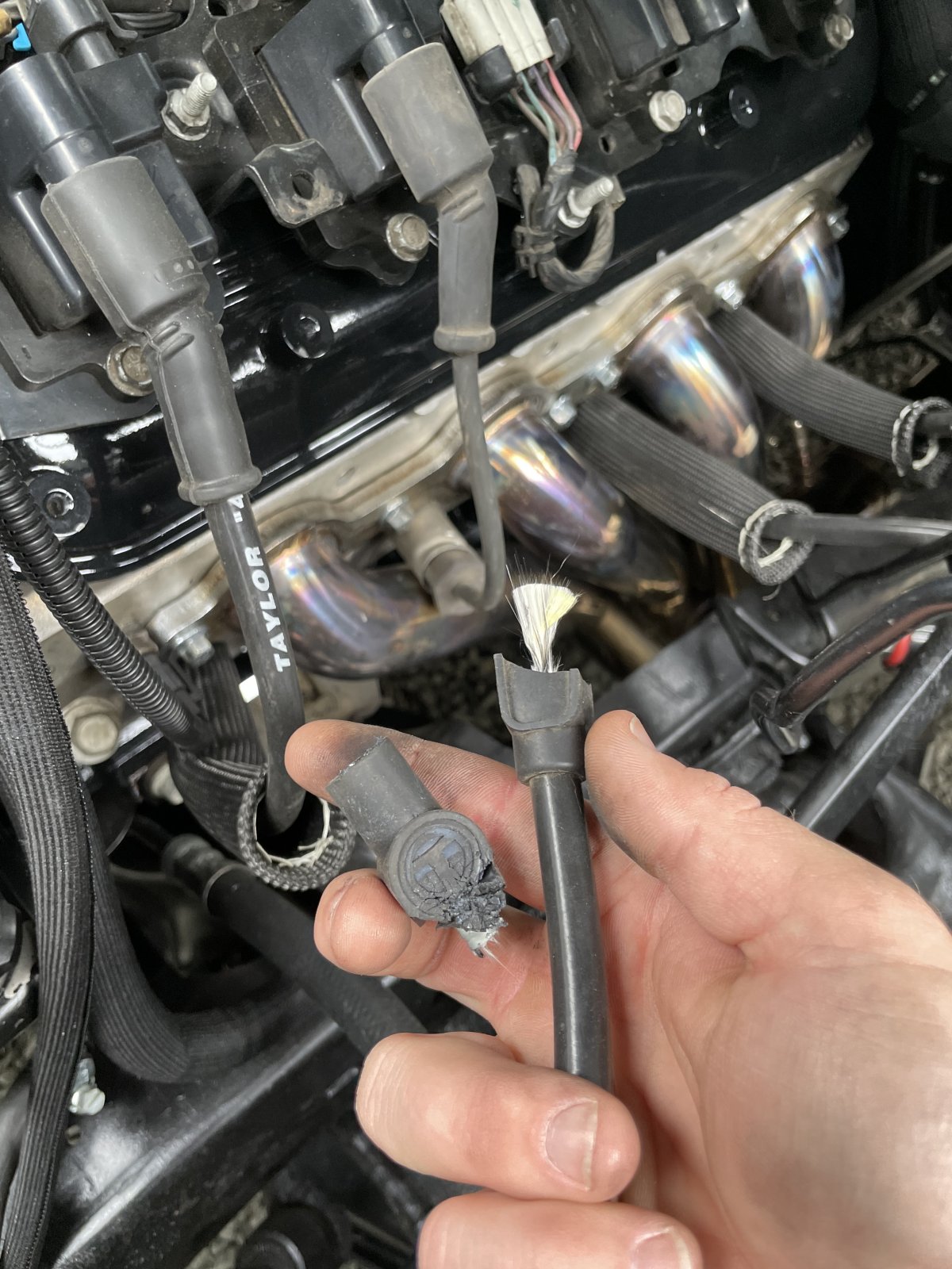

Turns out the knock sensors were bad brand new. Replaced with some lifetime warranty ones from oreillys cause it was all that was available unfortunately. But at the same time now it’s been a couple thousand miles with zero issues. Just frustrating.
Also found the misfire issue after fighting it for a couple weeks. Had those heat boots over my 100 dollar Taylor plug wires and it still burnt through. Word of advise if the plug wires are touching they will burn! Luckily had a handful of stock wires with the metal cover that fit cyl 3 and worked till my accelerated ceramic wires came in.

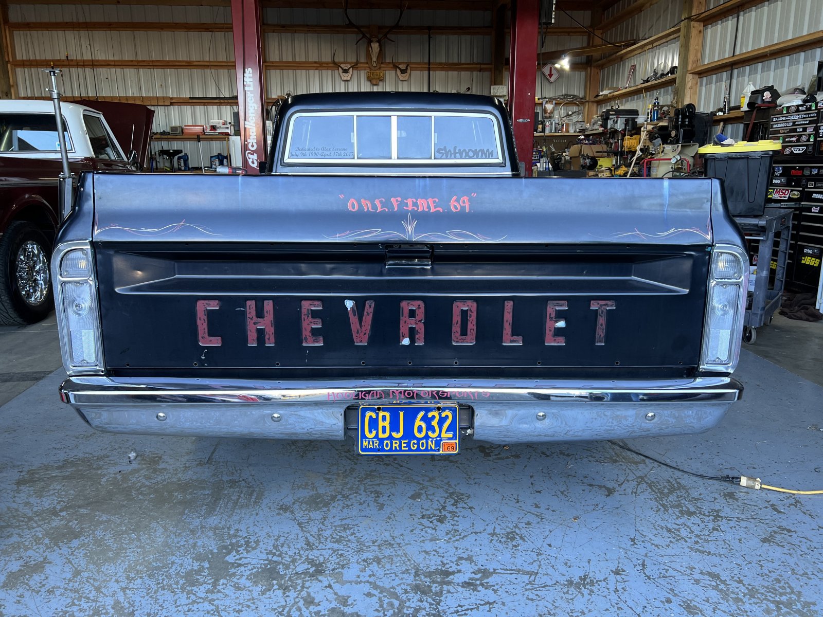

Cool thing in oregon is you can get special interest plates and if you find a era/year correct license plate you can use it instead for a classic car. I found this 69 plate on eBay for 20 bucks. Clear coated it and had the number registered to my truck.

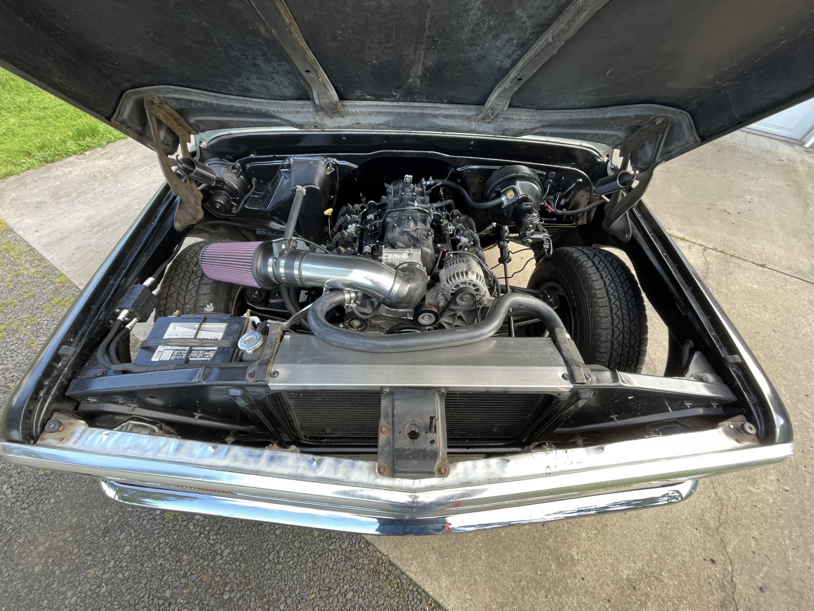

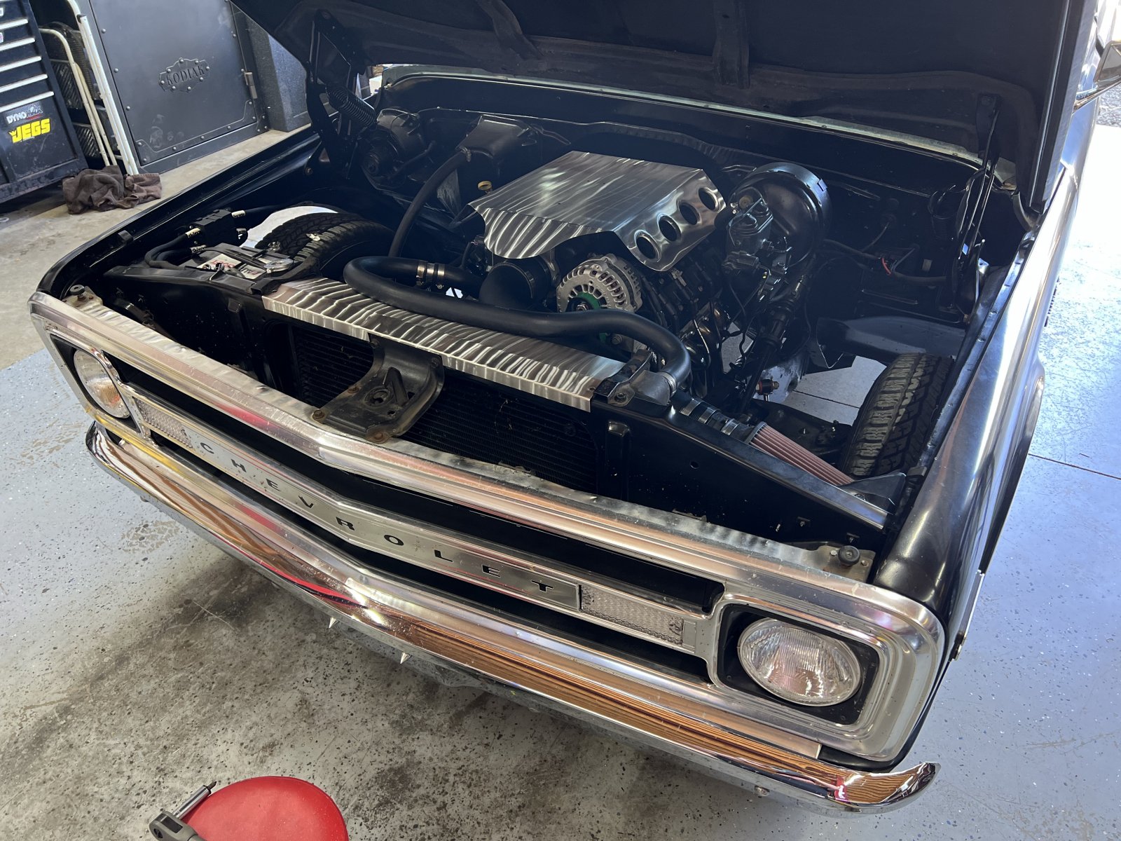

Currently trying to help my intake air temps now. Got the hold cut in the core support and waiting on the velocity stack.
Haven’t fully decided what to do with my intake manifold and rad cover. I took a flapper wheel on the grinder and made them have a matching design for now. Don’t hate it but also am not sold on it.

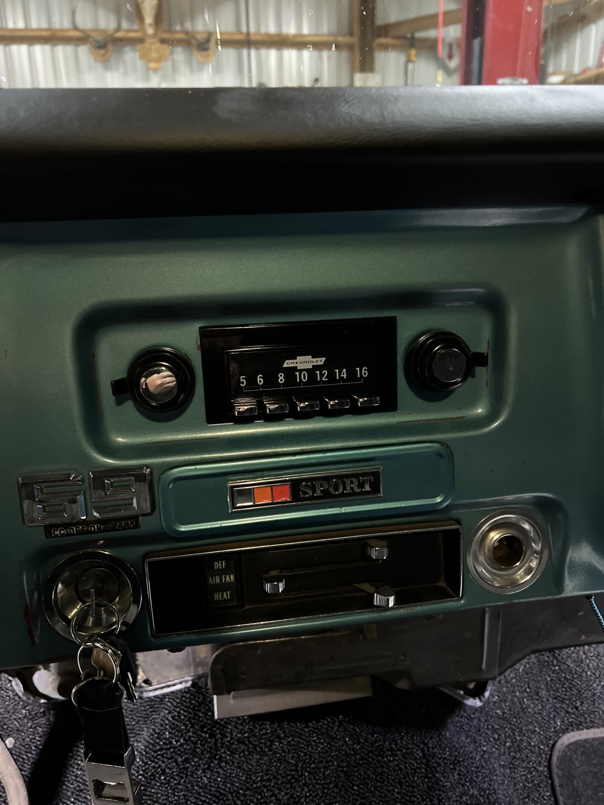

Surprisingly enough for me the stereo has been the last thing on my mind. But Ordered some 3.5” carbon neos through sky high for the dash.
Went with a retro sounds Long Beach radio to keep a somewhat factory look, when I turn it on it’s full digital with Bluetooth usb etc etc. was a little annoyed after buying a 400 dollar head unit and the first one that got to me I couldn’t even turn it up loud enough to hear with the truck running because it was cutting out.
After the typical phone calls with them arguing about how it’s install and not their unit, I had to pay to ship it back. They got it and called me saying it was good to go.
I asked what the issue was and he said nothing it works great…..well again had to argue and tell him it didn’t then he actually turned it up enough while bench testing it and apologized saying he now heard what I was talking about. They shipped me back a replacement and so far so good.

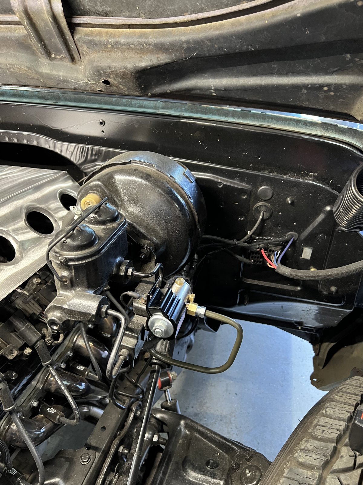

Roll control installed. Need to get my disc brake front end on though cause the drums don’t hold the truck that well currently while trying to do a burnout.
And I got the accel ceramic plug wires on. Now I don’t have to worry about burnt wires anymore. Got a set for the Tahoe as well.

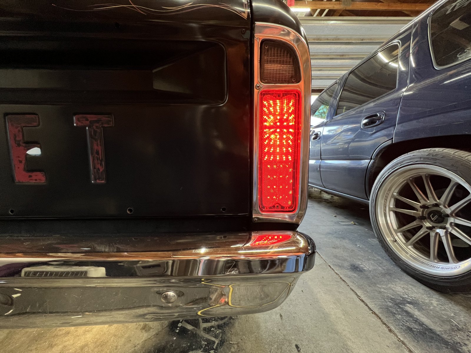

New tail lights for the pickup wanted to make sure they were bright. Love the clear oem housings and found a company that sells plug n play full led boards.
Tail lights
Brake lights

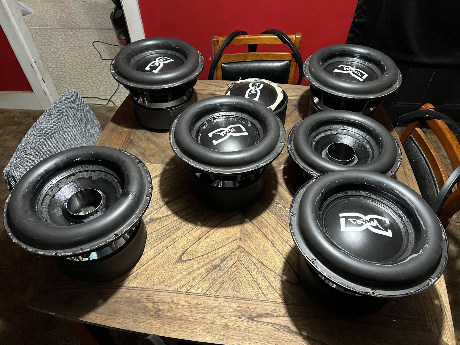

As I seem to like to do last minute everything lol about a week before our big surf city sound off audio and car show I decided I was gonna fork out the money to recone the subs in the Tahoe finally. Only took almost a year but my pickup kept me from doing that.
Subs pulled

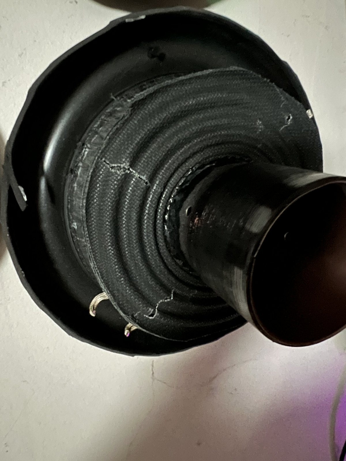

after cutting out the cones I saw the suspension ripping on the bottom. Most likely from the first enclosure being too big and letting them over exert themselves.
All cut apart
