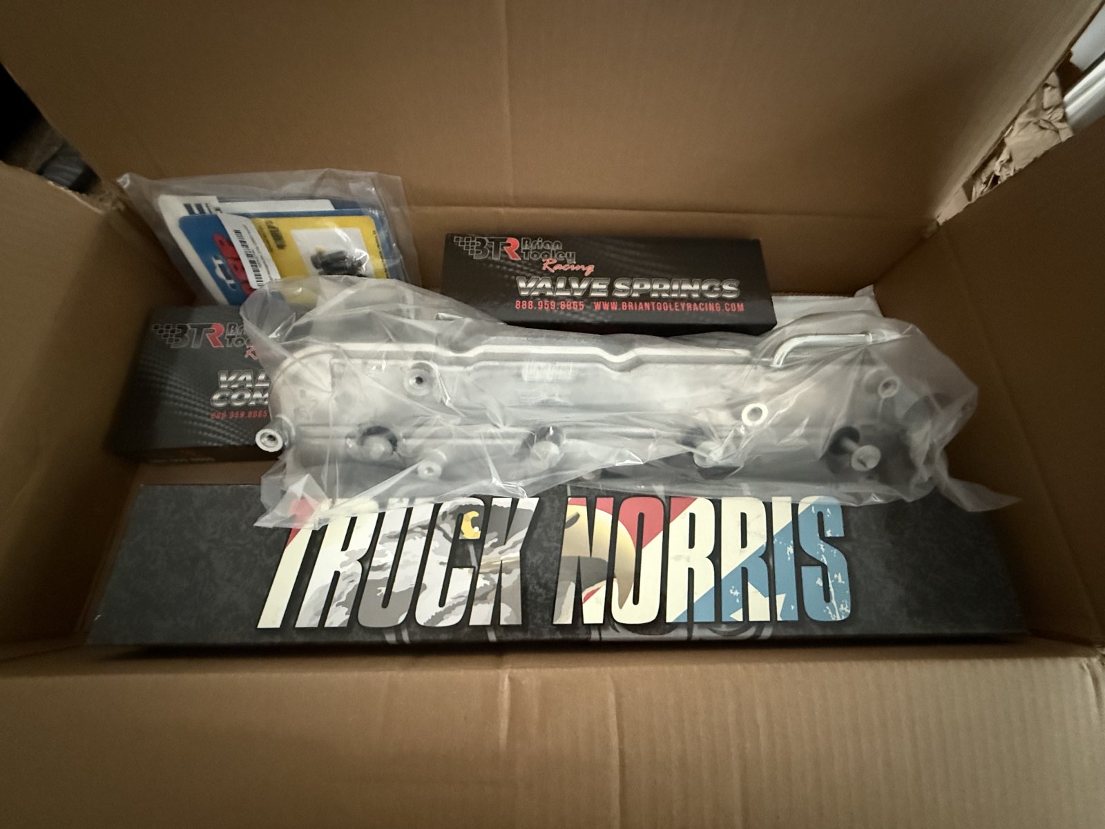

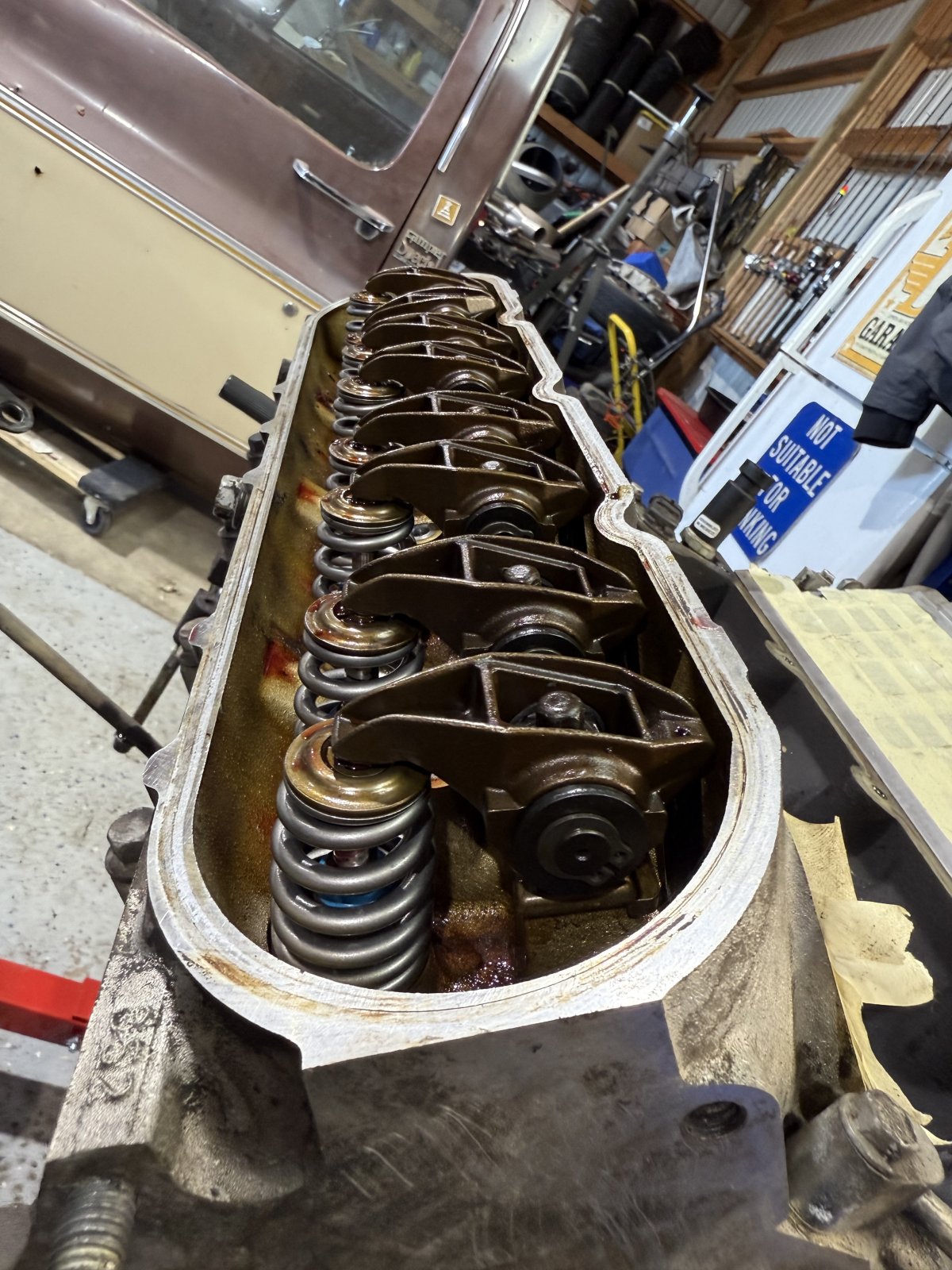

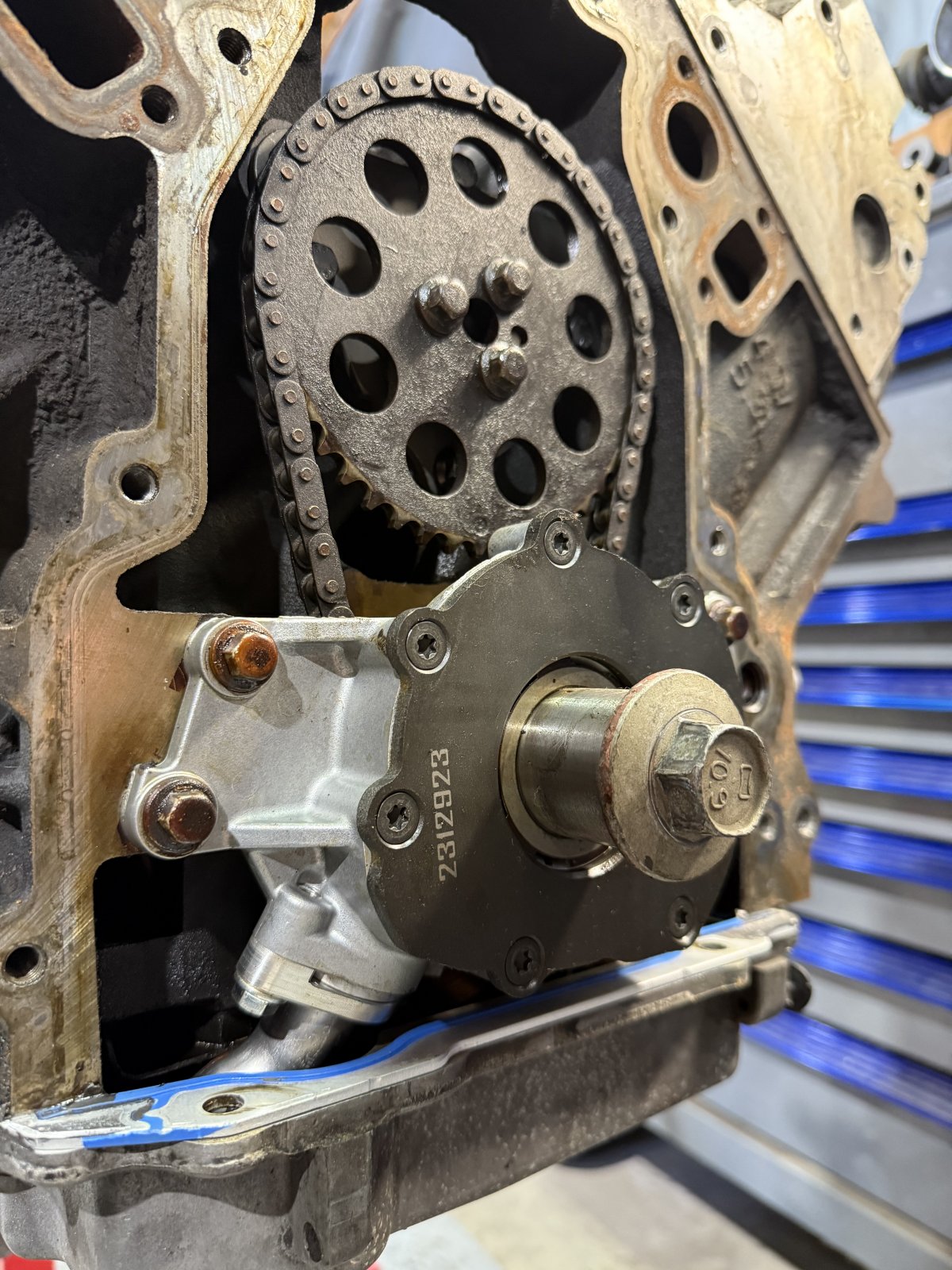

As far as the new engine goes. It’s a 5.3 with 150k miles(supposedly). Judging how the internals looked I’d say that’s about right though and it wasn’t super dirty on the inside or the outside.
Parts list:
Front/rear main seals and cover gaskets
Billet oil barbel
New pickup tube with billet brace
Melling 10295 high pressure oil pump
New oil pan gasket
New Dorman valve covers
New cam retainer plate with arp bolts
BTR truck Norris cam
BTR beehive valve springs
BTR valve seals
BTR 7.400 chromoly pushrods
BTR TK002 trunnion kit
New power steering pump
Dorman aluminum heater core fittings
Dorman metal heater core hose junction
Trailblazer vjcx converter
Need to take more pictures tomorrow

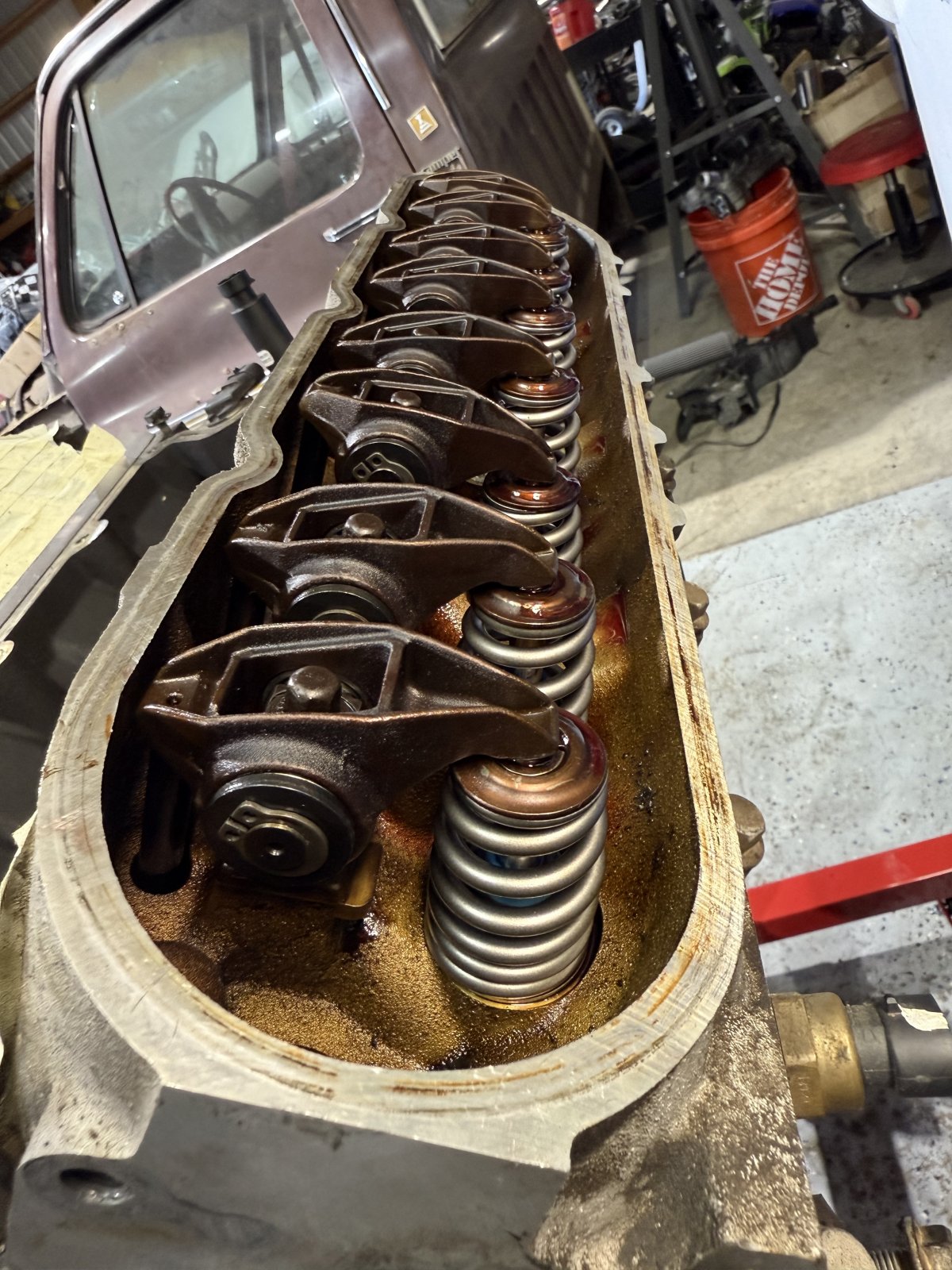

Need to take more pictures tomorrow View attachment 460998
View attachment 460995View attachment 460996View attachment 460997

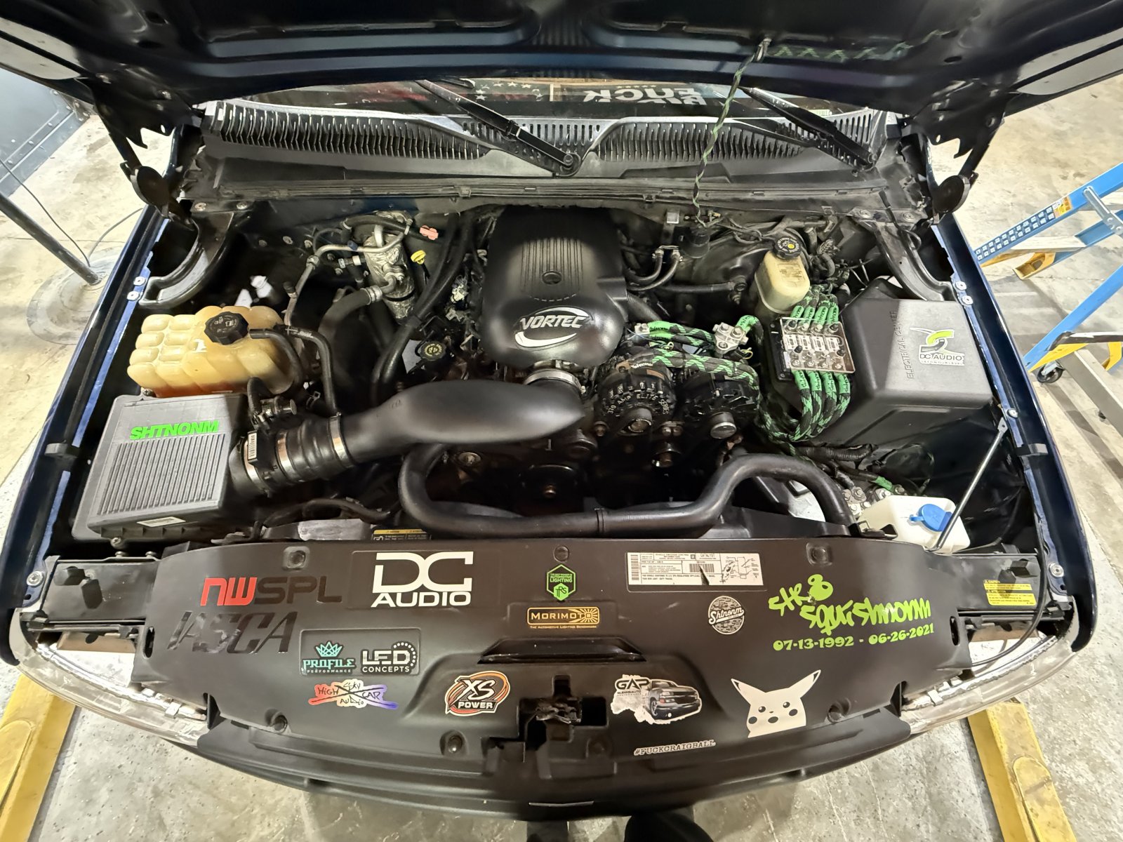

Got it fired up today! It runs alright untuned but it’s not veryhappy especially trying to idle. Was able to bleed everything and tomorrow will take it down the road to see if it’ll drive.

Well made headway today! All put back together and it actually drove half decent the whole way home. Still untuned right now so it basically just is mad when it idles but cruising is perfectly fine. I’ll try to get a video posted here soon.

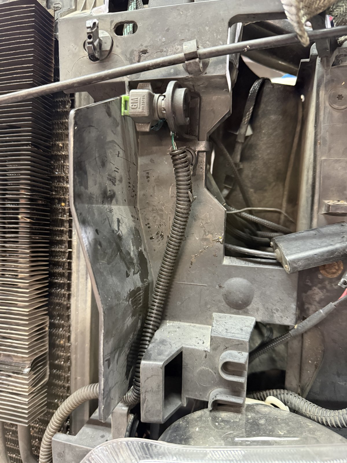

Also never was a fan of where I mounted the ambient air temp when I did the trucool 40k. It would throw off the mirror reading being under the trans cooler. so while the front end was off I drilled a hole behind the driver headlight and stashed it there. Reads correctly again.

That truck norris cam is pretty sweet, about as good as it gets for a 5.3. Wild that after 20+ years of LS cams they are still finding ways to make them better. Did you get yours tuned up? Does it have a nice choppy idle?

I agree it is wild lol. My tuner is busy right now but hoping it’ll be tuned within a week or two. I drove it last night it’s got a real choppy idle for sure. :head3:

Super curious to know what he sets the idle too. Also if he suggests a converter or not. Seen some differing opinions but I set my buddies to 800 and I personally did not think it needed a converter.
