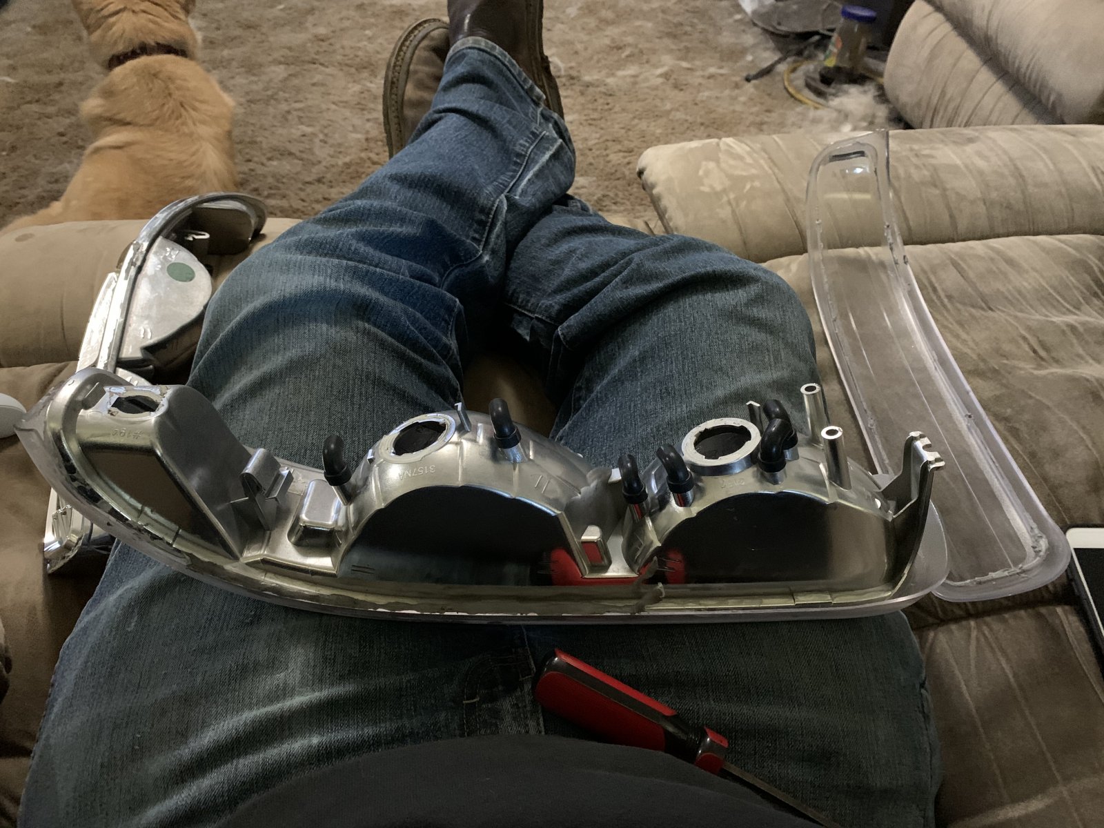

happened to be looking at my corner lights and noticed the lens was separating damnit. Upon further inspection the butyl I used from Home Depot isn’t like the morimoto retro rubber where it actually sticks and hardens up. So the butyl I used literally did nothing basically I’m surprised they held together this long lol. I pulled the lights back apart without even baking them.
Spent a couple hours clearing off all the old butyl, adding retro rubber, and resealing them. Also hit them with a quick polish and they are good to go luckily.

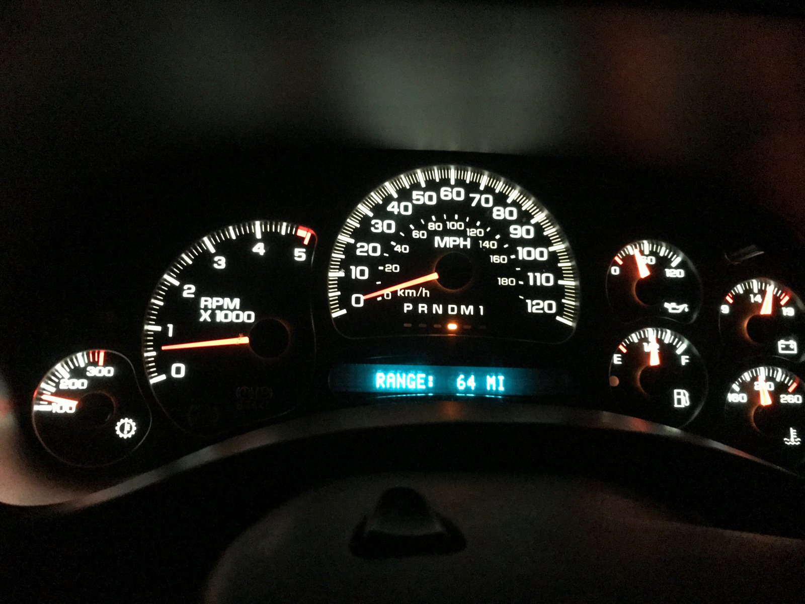

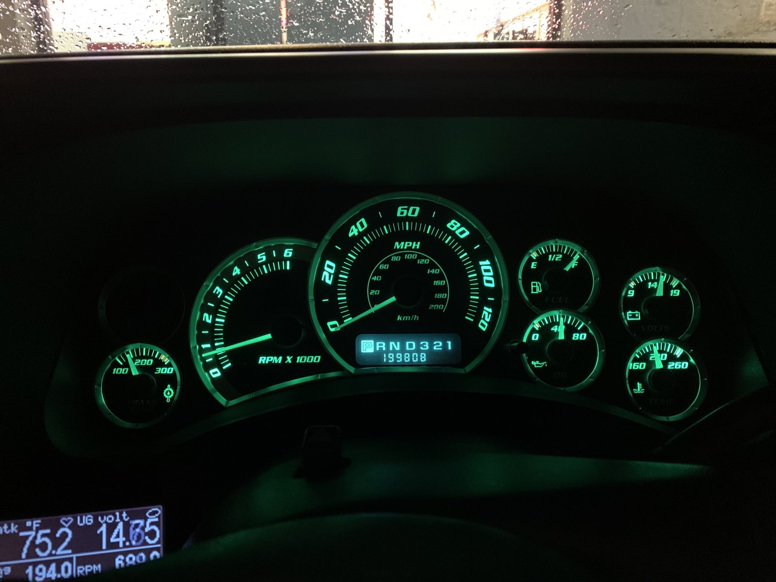

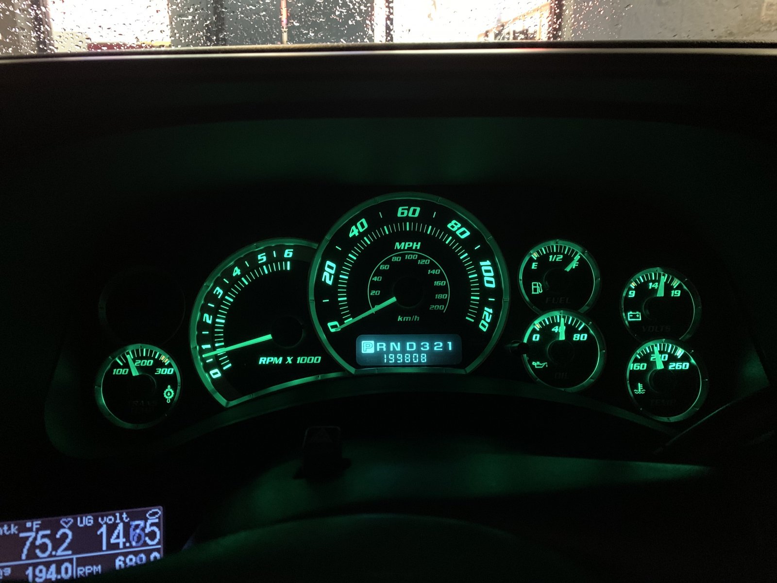

Went to the wrecking yard with the lady today. There was a 02 Escalade ext truck sitting in the very back. Gauge Cluster was still in it!!! My buddy works there so I called him and asked for a price and mileage.
He said they normally sell them for 175 but he will give me it for 125. Okay score rarely can find them that cheap. And he said the mileage was 194000. Mines at 204000. So pretty close. We got up to the front and he said He would do 100. Hell yes!! I’m stoked at this point.
Got home and pulled my HD cluster out. Swapped over the green leds. Also for anyone who has problems with 00-02 clusters acting up I found out after bass broke my hd one that the female end on the cluster doesn’t have support so where it solders to the circuit board breaks easily. Made sure to fix this one before that can happen. Just put a layer of ca glue underneath it for support and sturdiness.
View attachment 237858 View attachment 237859
got it hooked up and it’s at 199000 so only 4000 away from mine. Couldn’t have luck like that again I’m super stoked been wanting one since I bought the Tahoe. View attachment 237860

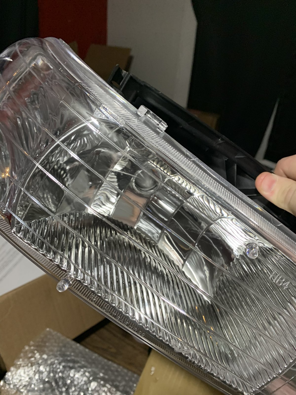

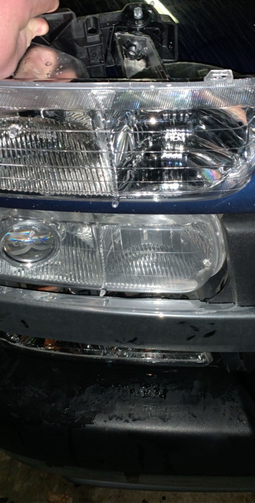

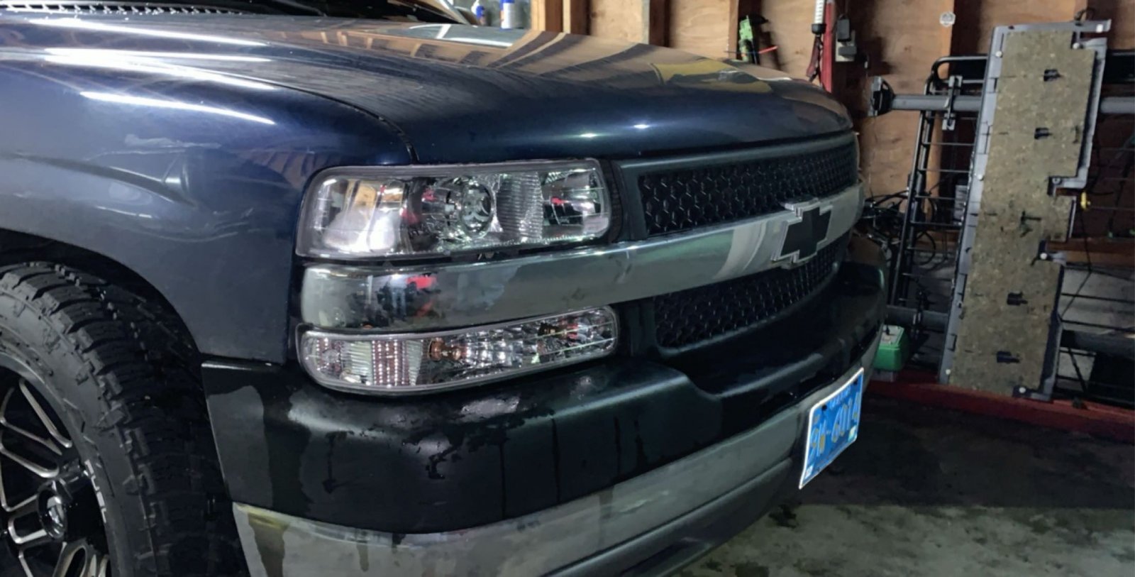

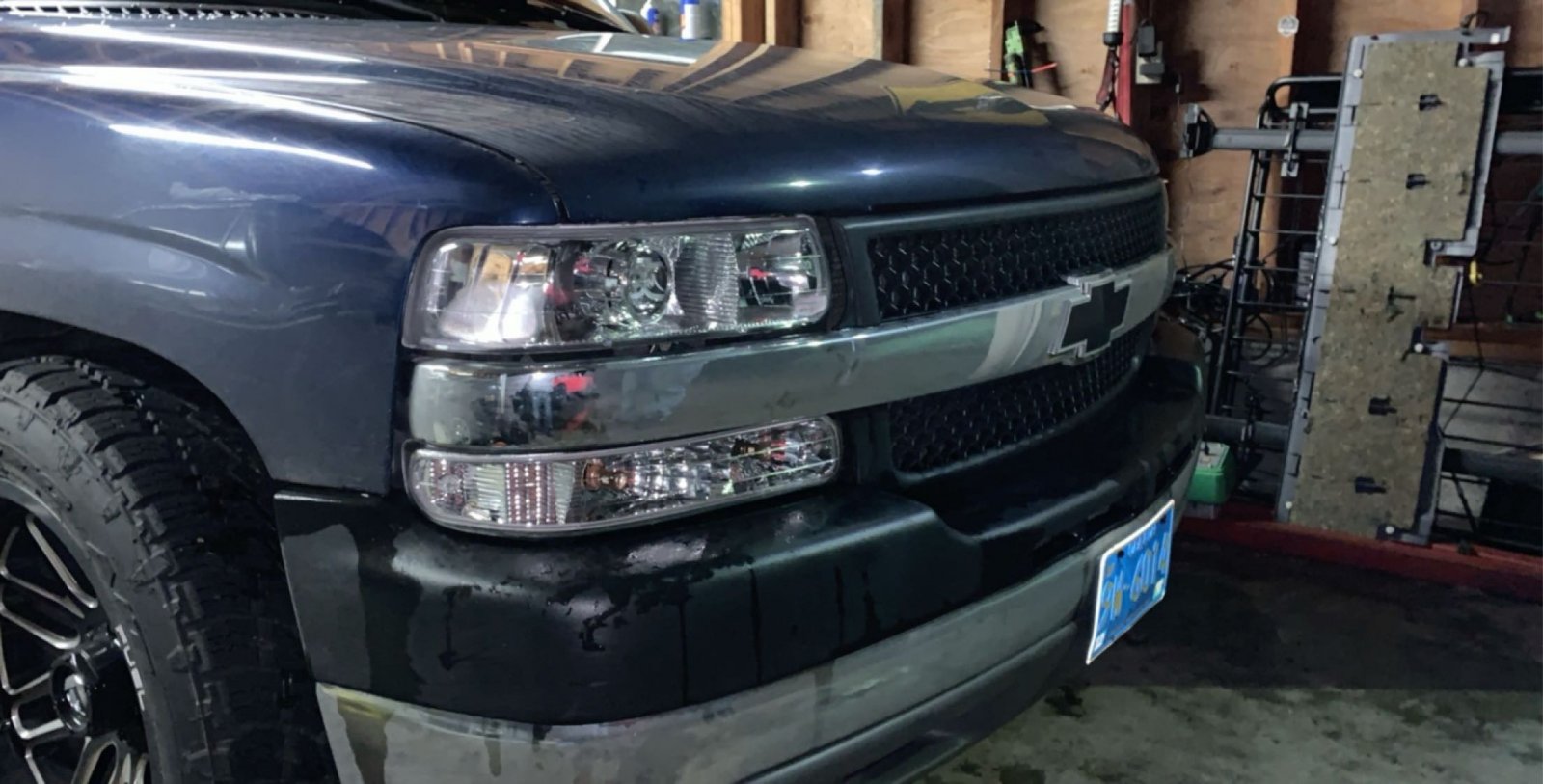

Not a big update but found a set of clear lenses locally for 40 bucks. The inside corner on the driver side where it meets the grill was cracked but when installed it’s not even visible I still will probably swap it out with another lens. And they are lightly fogging on the side where the 194 marker light is. So I gotta get on that hoping it’s just the seal around the socket if I have to bake it though oh well it’s not hard. Also was given a set of stock lights, stock marker lights, and all clear headlights in that purchase. The passenger side on the new one is deeper so I’m most likely gonna redo my retrofits using them. My current passenger side bugs my ocd how it’s closer to the lens compared to the driver lol. Gonna swap my depo lenses over though because they don’t have all the lines like the new ones.
Excuse the dirty rig. Winter in Oregon and daily driving will do that haha.

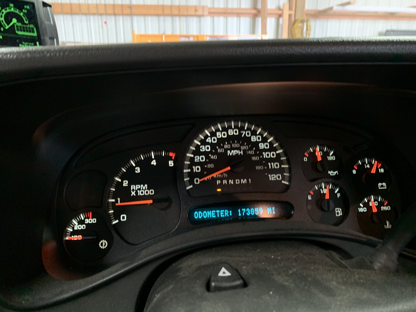

Also my buddy trusted me enough to replace all the bulbs in his 2006 lbz cluster. Never did them before but was surprisingly easy imo and made me excited to tackle all my climate control, window switches, 4x4 switches etc. need to order my leds for that now. He just replaced them with regular bulbs but they turned out good!
