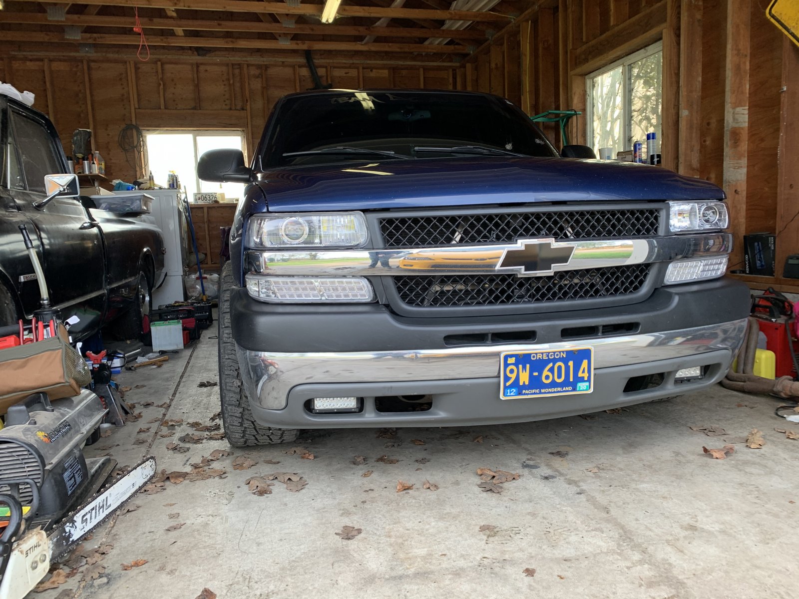

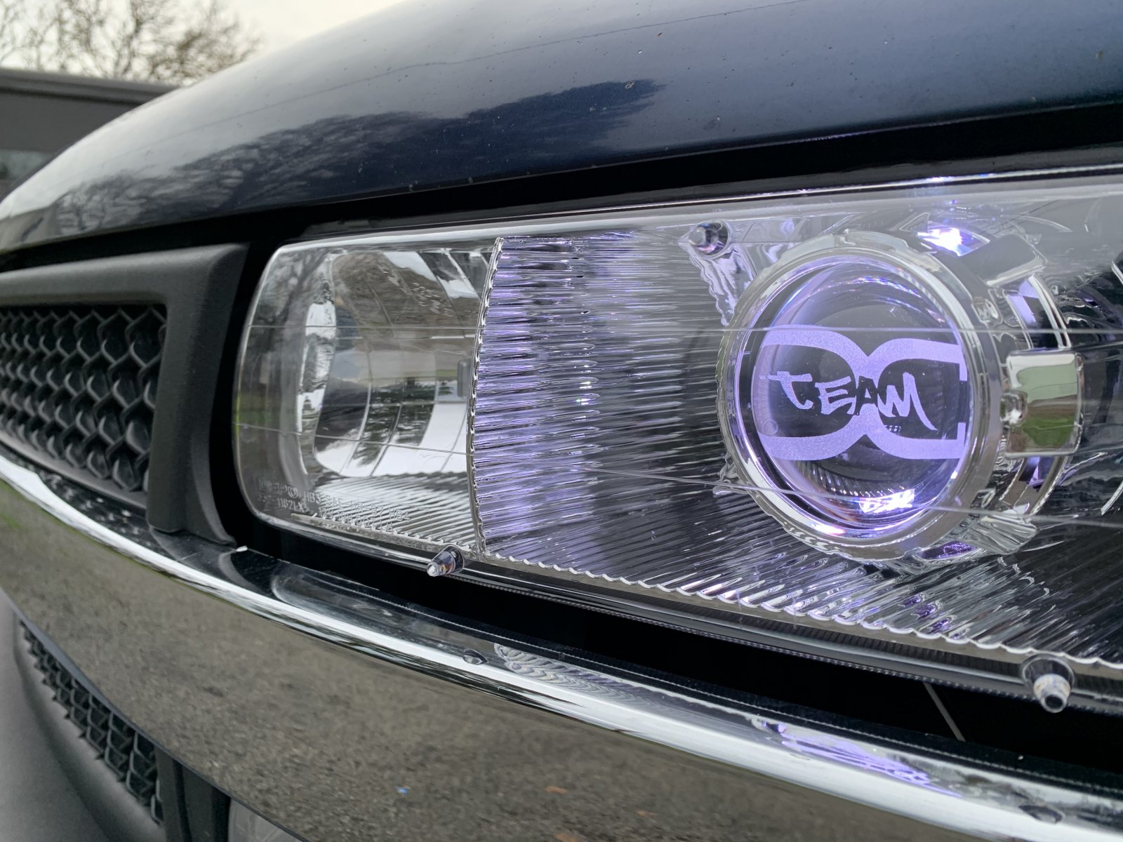

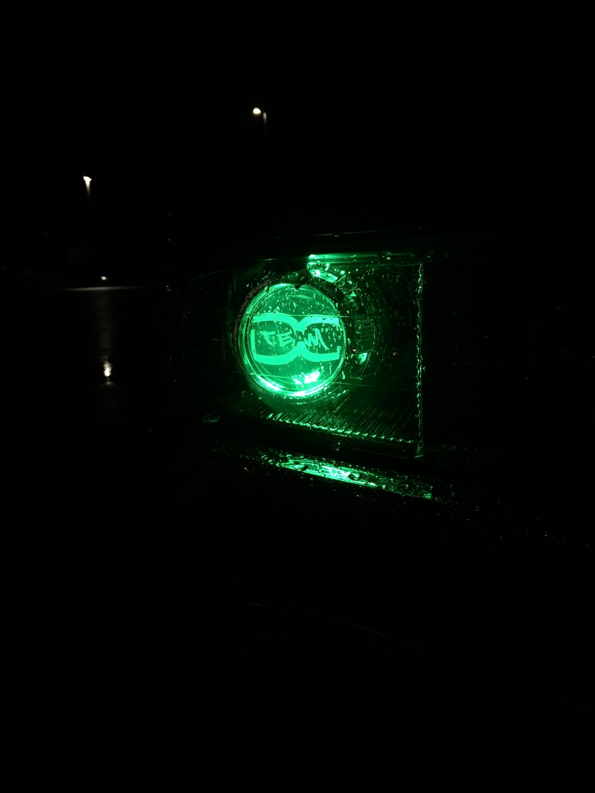

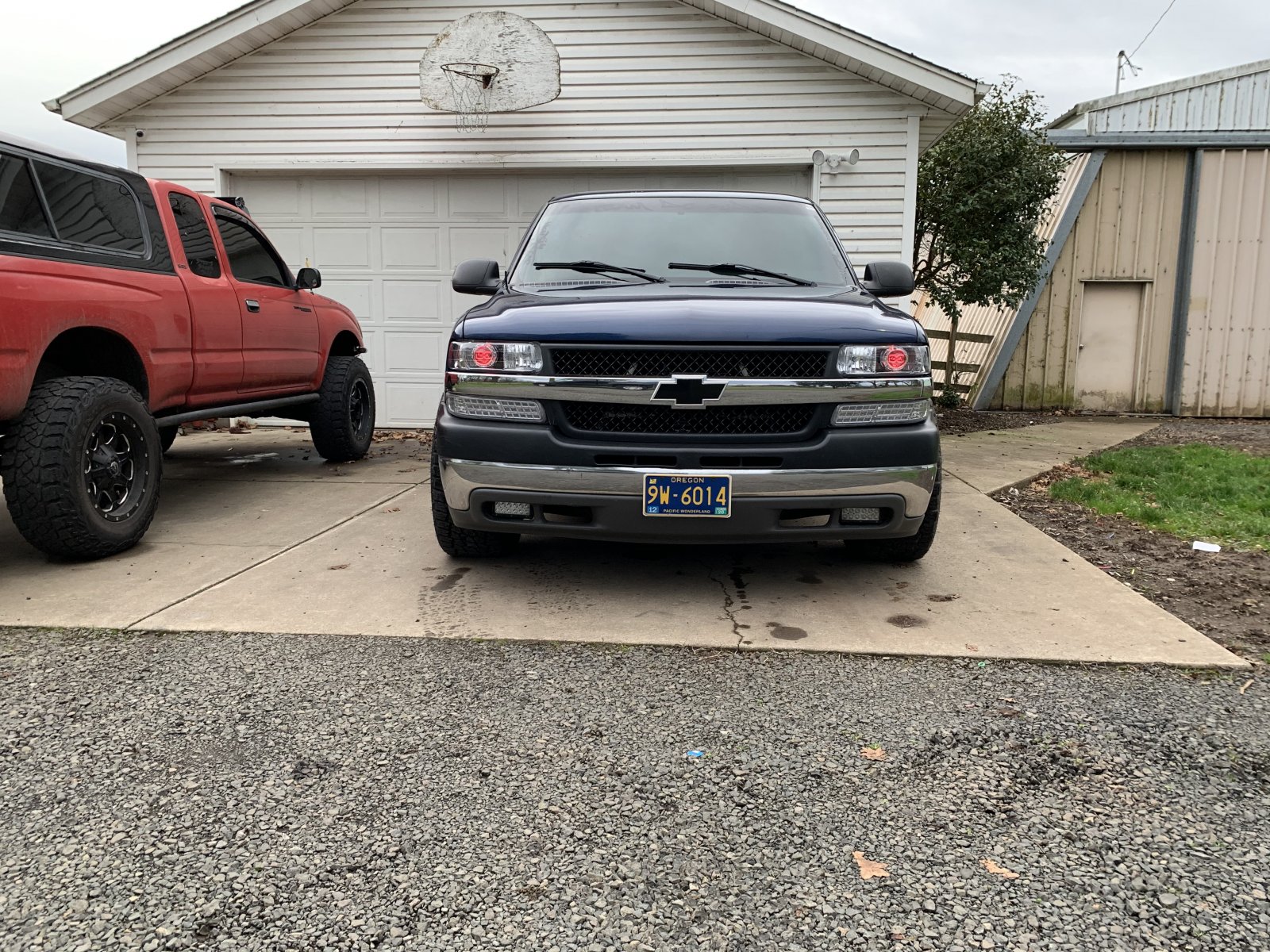

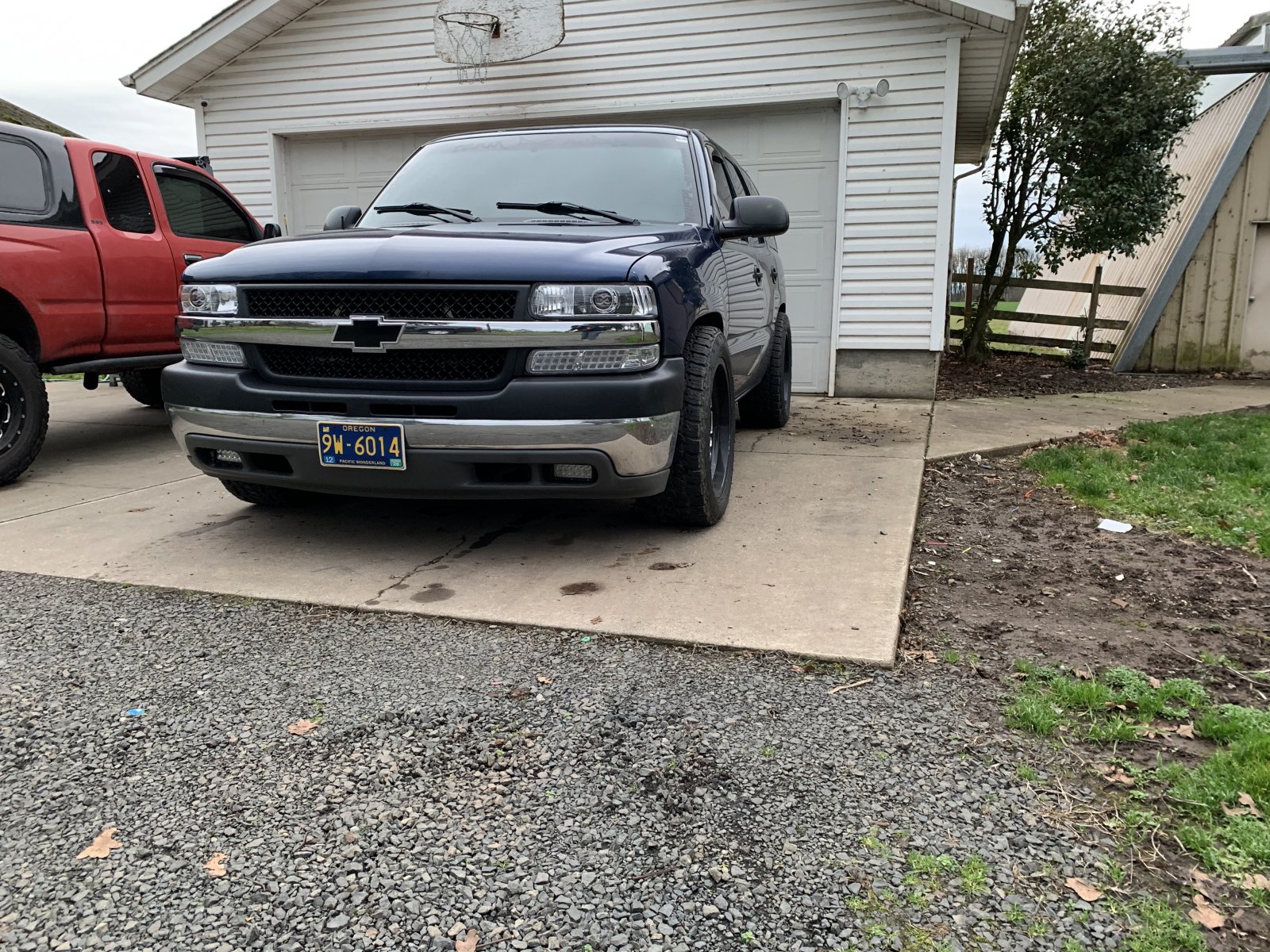

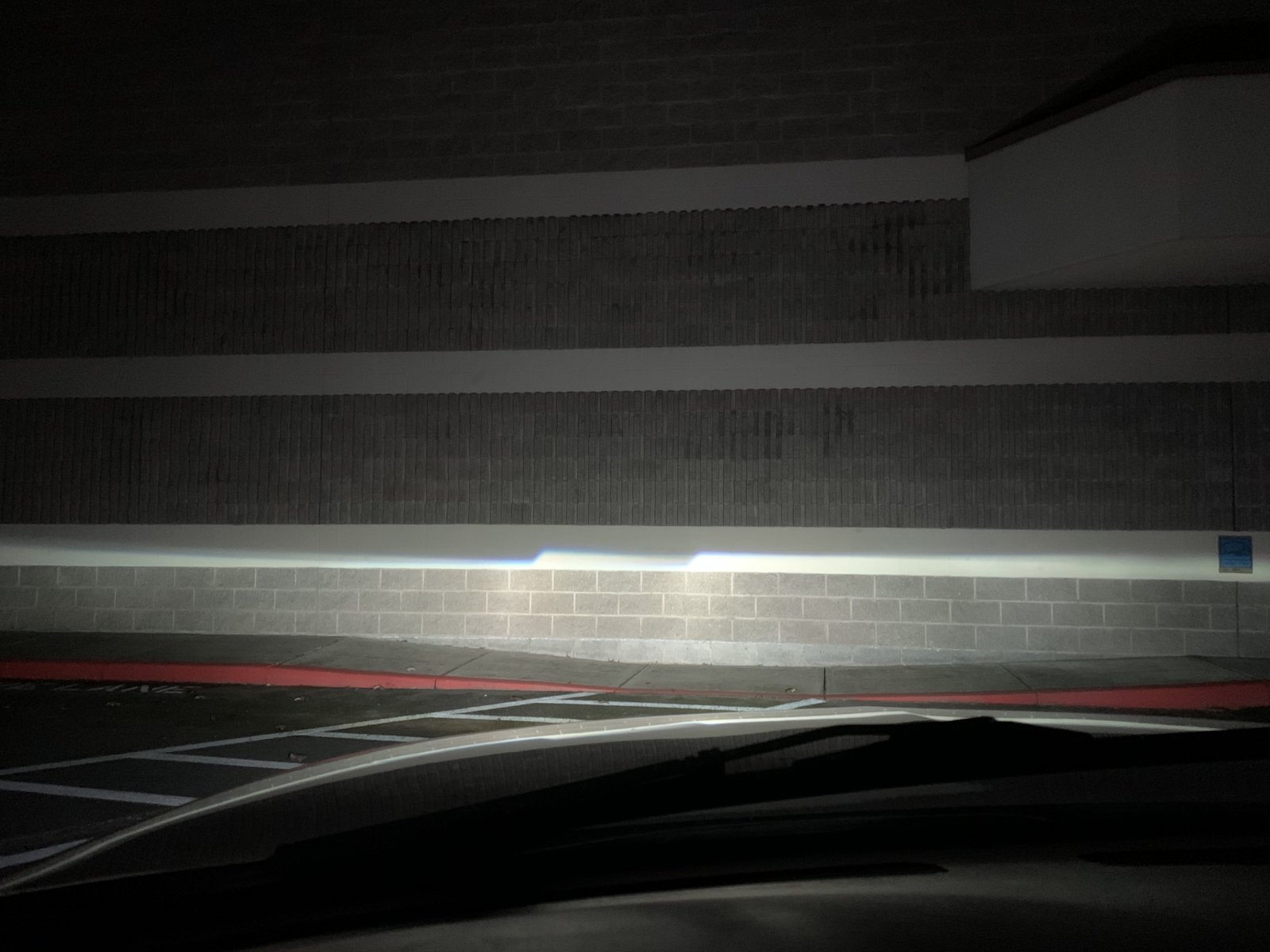

As I baked the housing and got lens back on I realized the shroud and front of the projector lens were ever so slightly touching the housing lens. :banghead:
I didn’t get a picture of it last night because I was pissed at that point. After work today I calmed down and cut the h4 adapter plate off, repositioned everything with the lens still glued on and I think it should be good now! Was able to get the projector away from the lens just enough. Now have to wait till later tonight so I can find a place to fully aim them correctly. They look killer though I’m super happy View attachment 236916View attachment 236917View attachment 236918View attachment 236919View attachment 236920
Cool AF!!! I'm liking it. Great job man. Wish I had the patience for that.

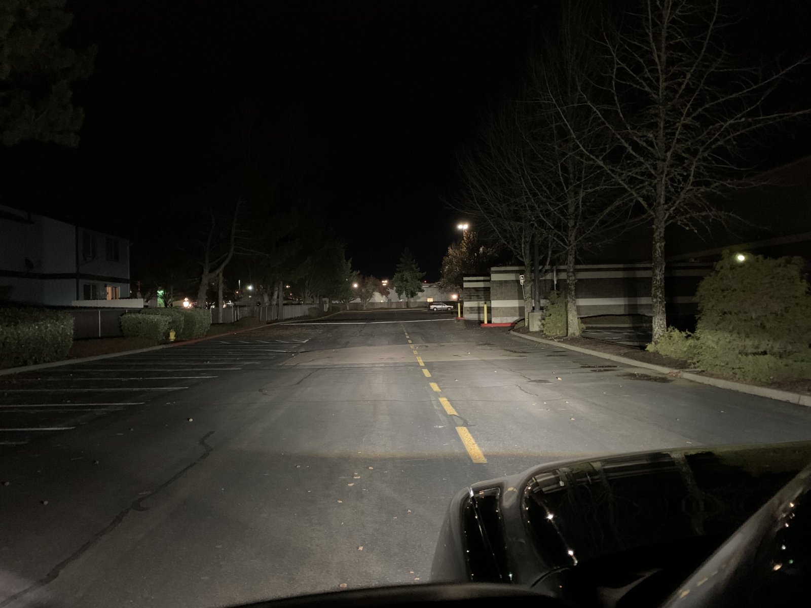

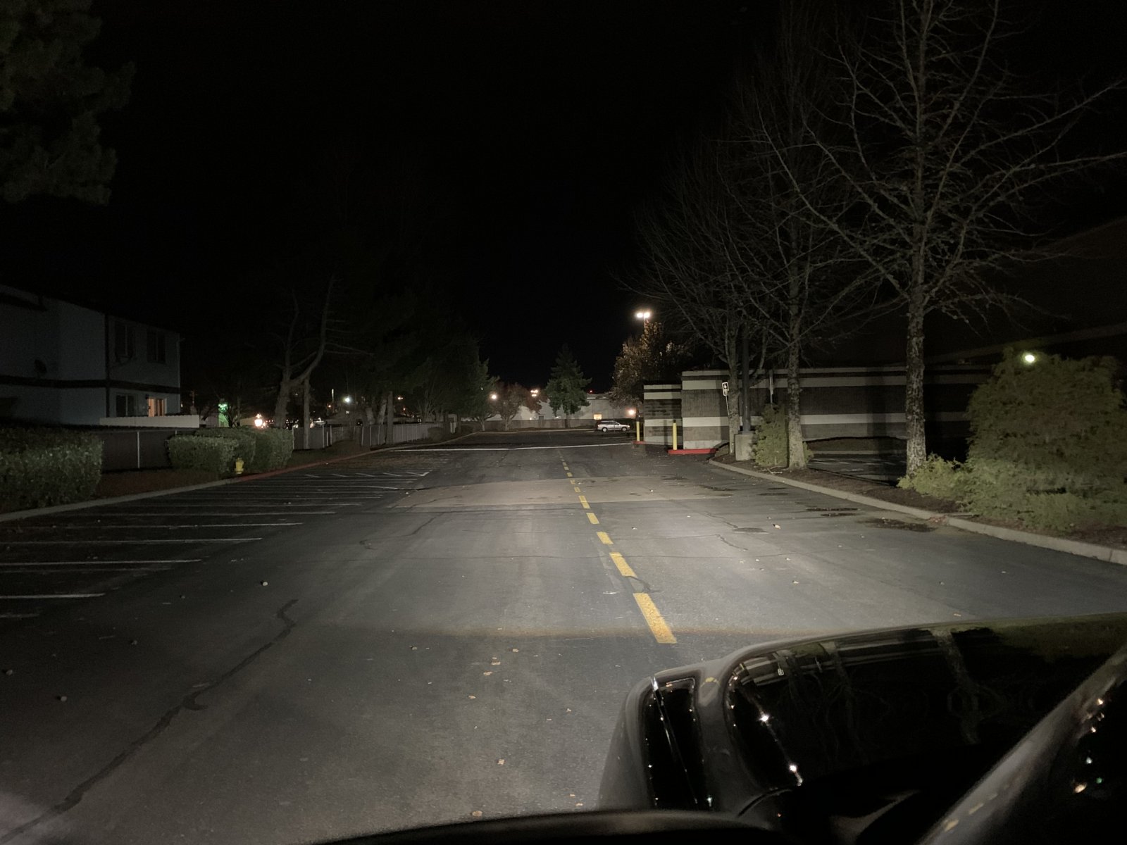

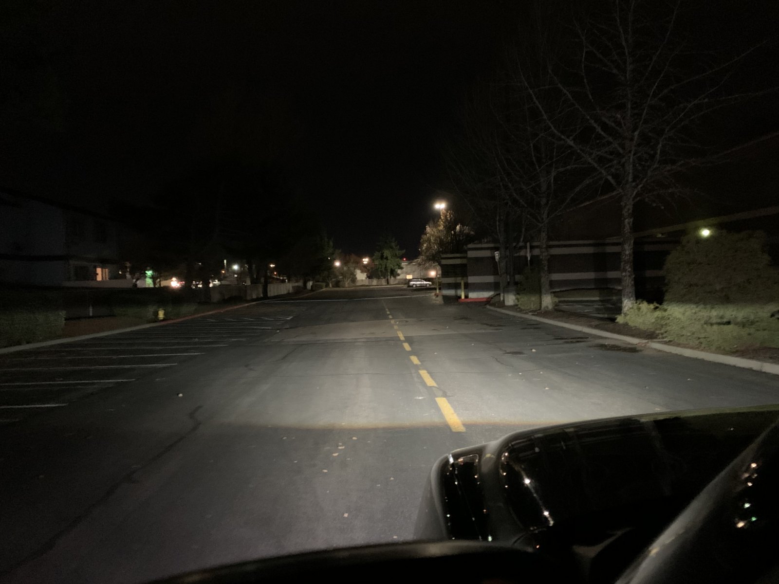

And @Sam Harris yes it was worth it after seeing the output :chewie:

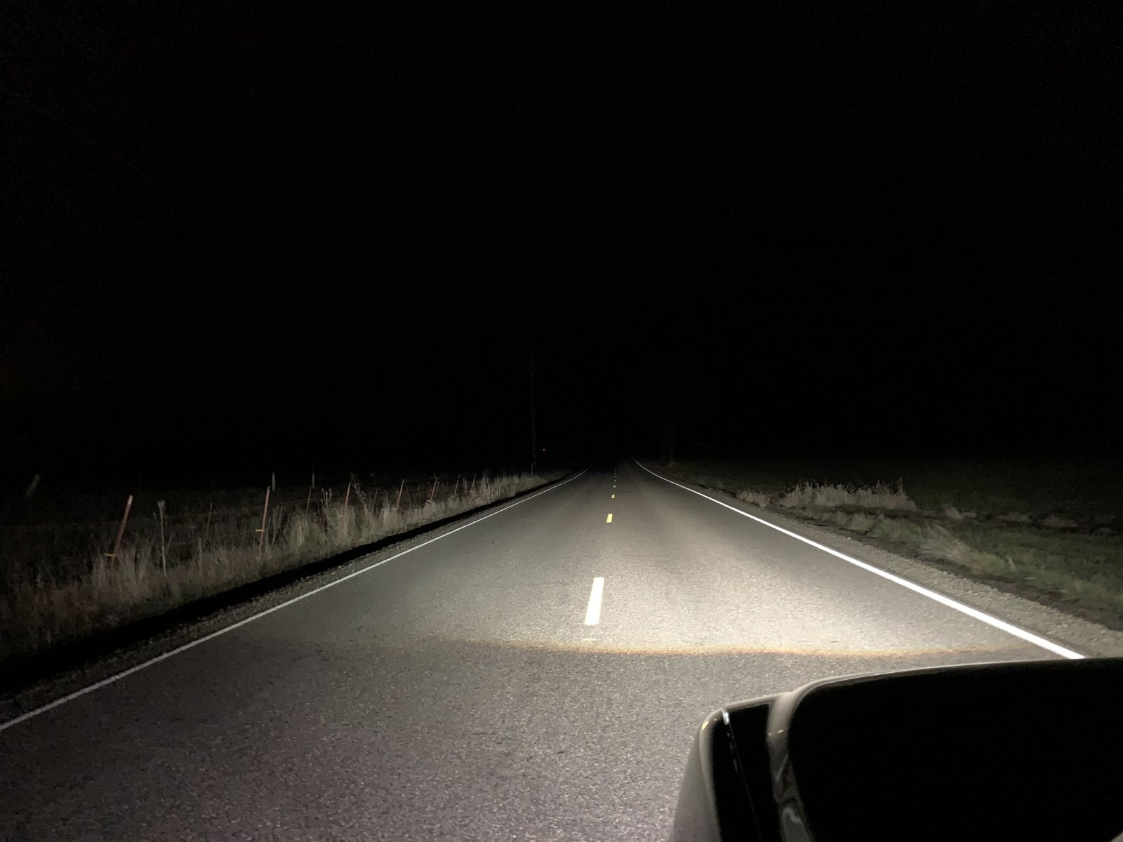

low beams in mall parking lot
High beams

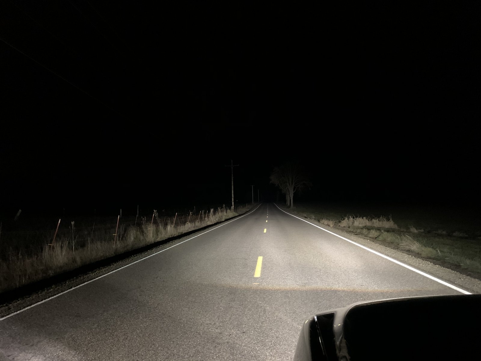

Low beams on a country road
And high beams

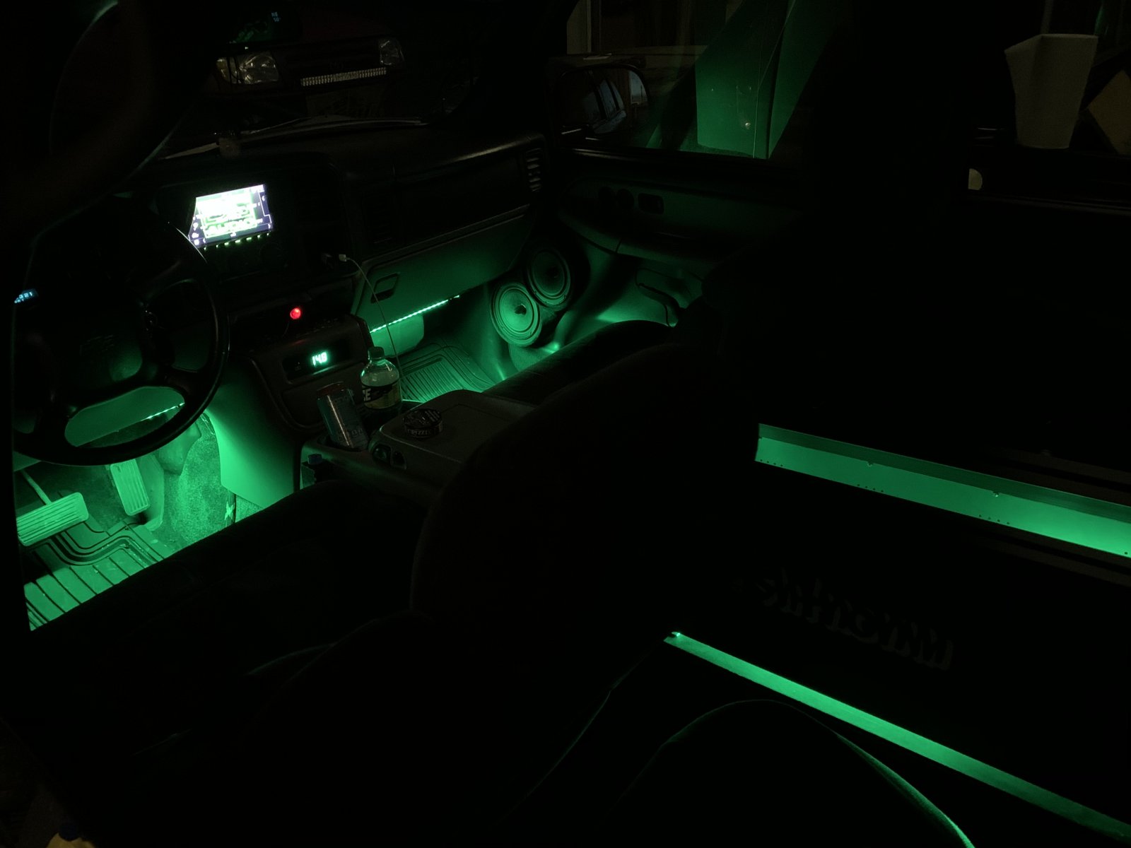

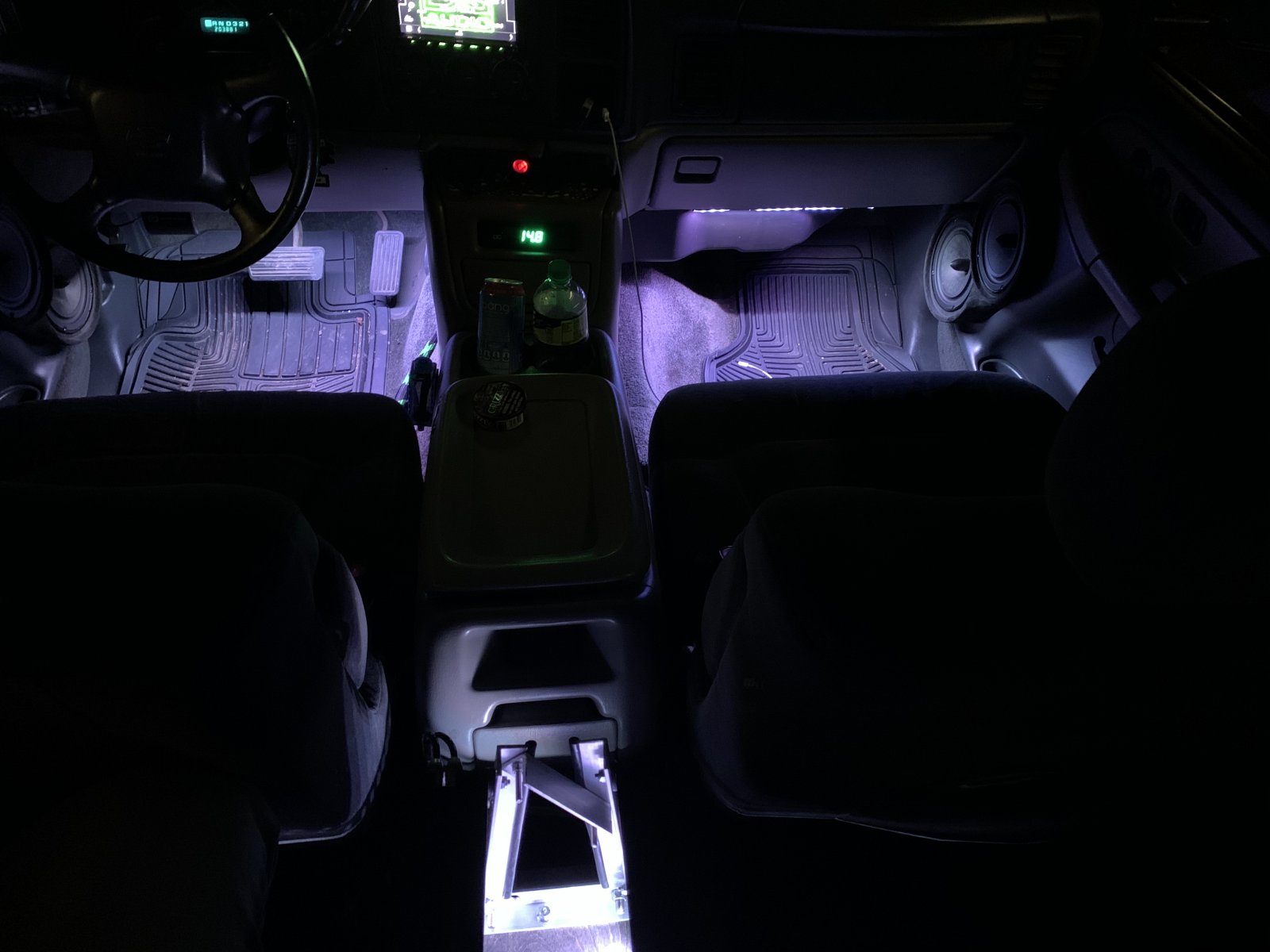

Got a interior led light setup for a early Christmas present. Strip led lights that have solid colors or a couple different light to the music style. Put two in between my amps and one on driver and passenger footwell even though I already have the factory lighting for there. They are nice for light but we will see how long they last because bass seems to break everything lol.

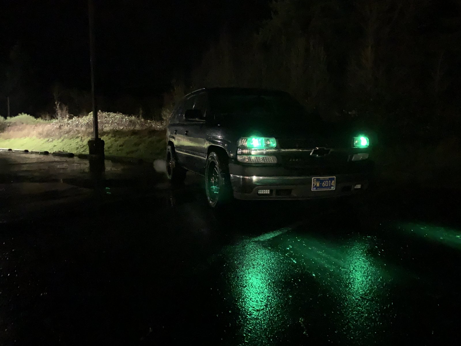

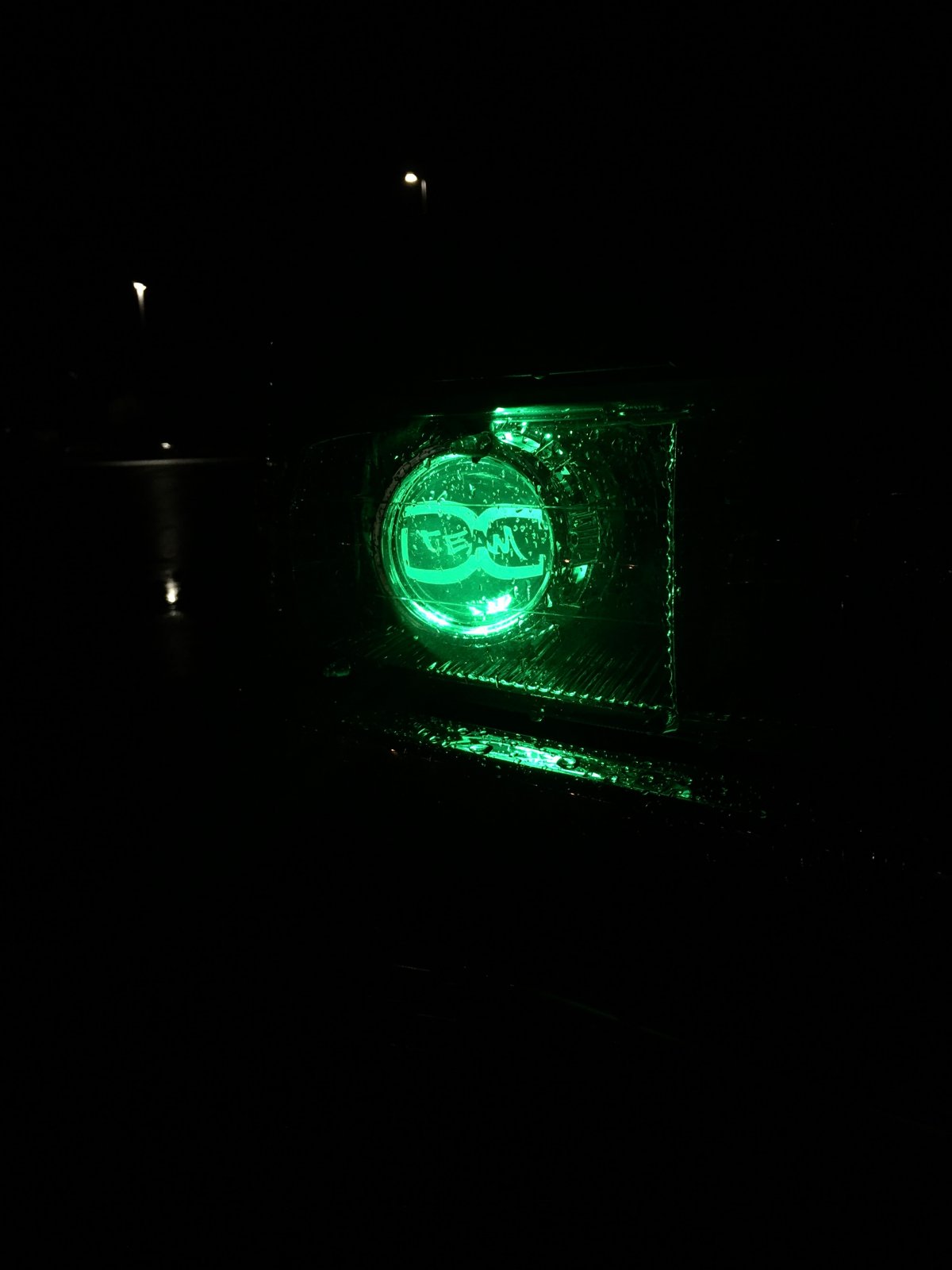

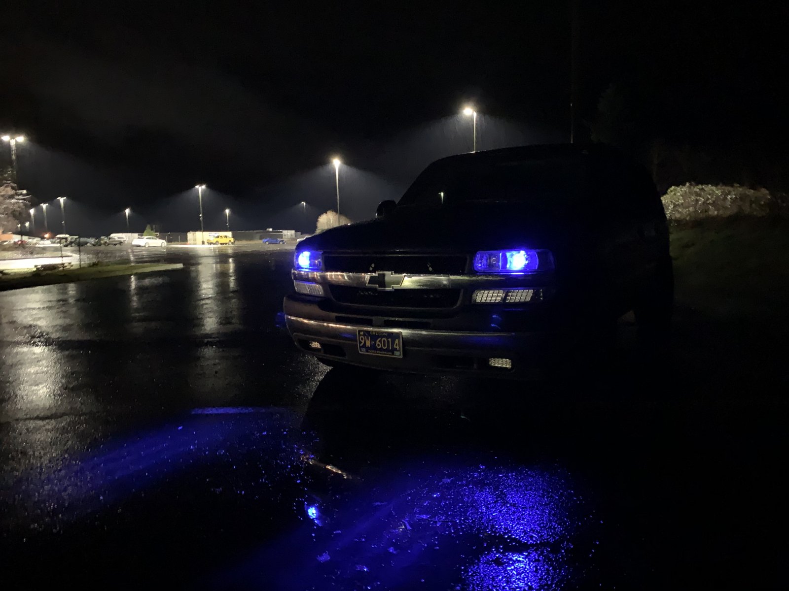

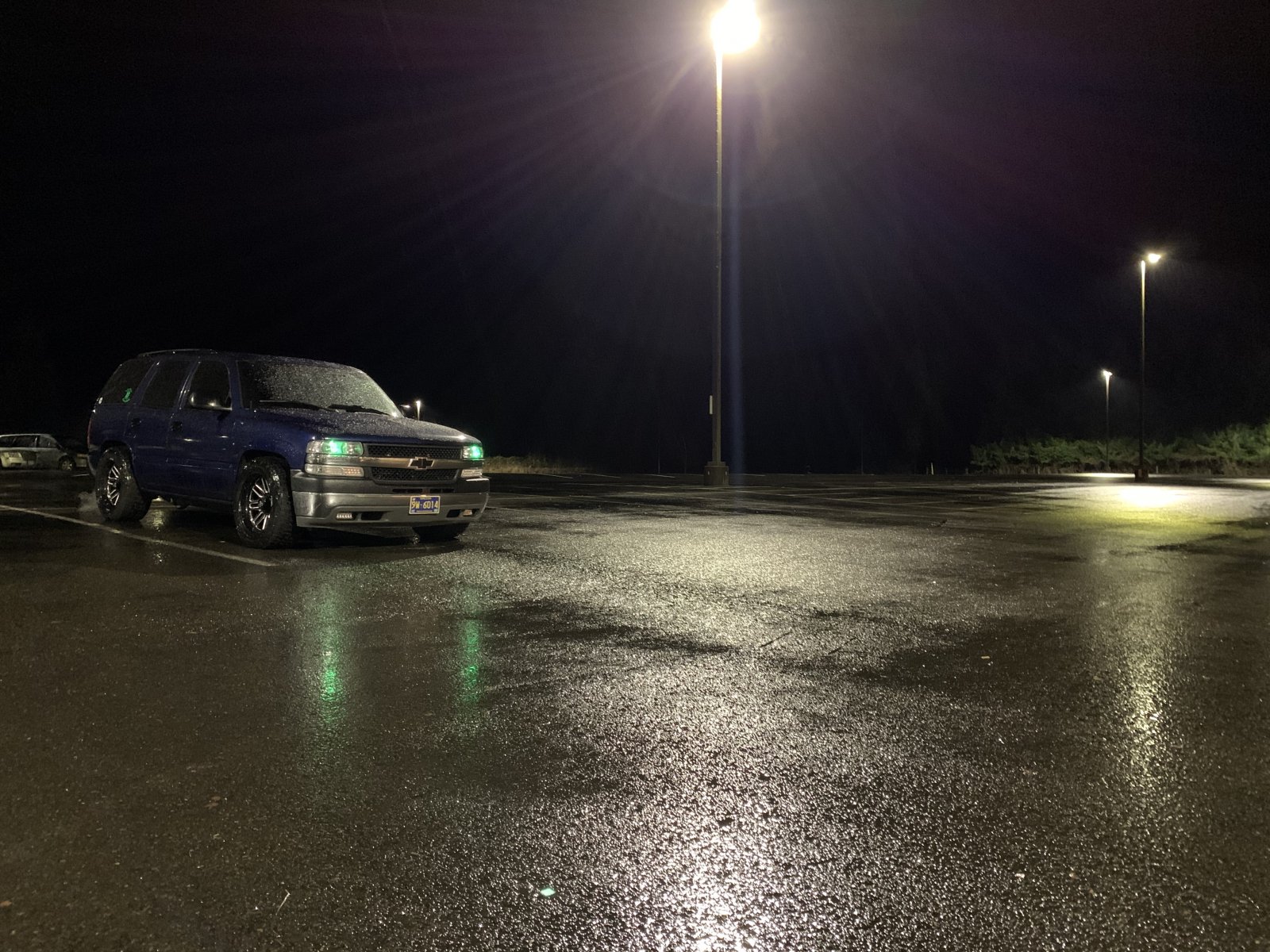

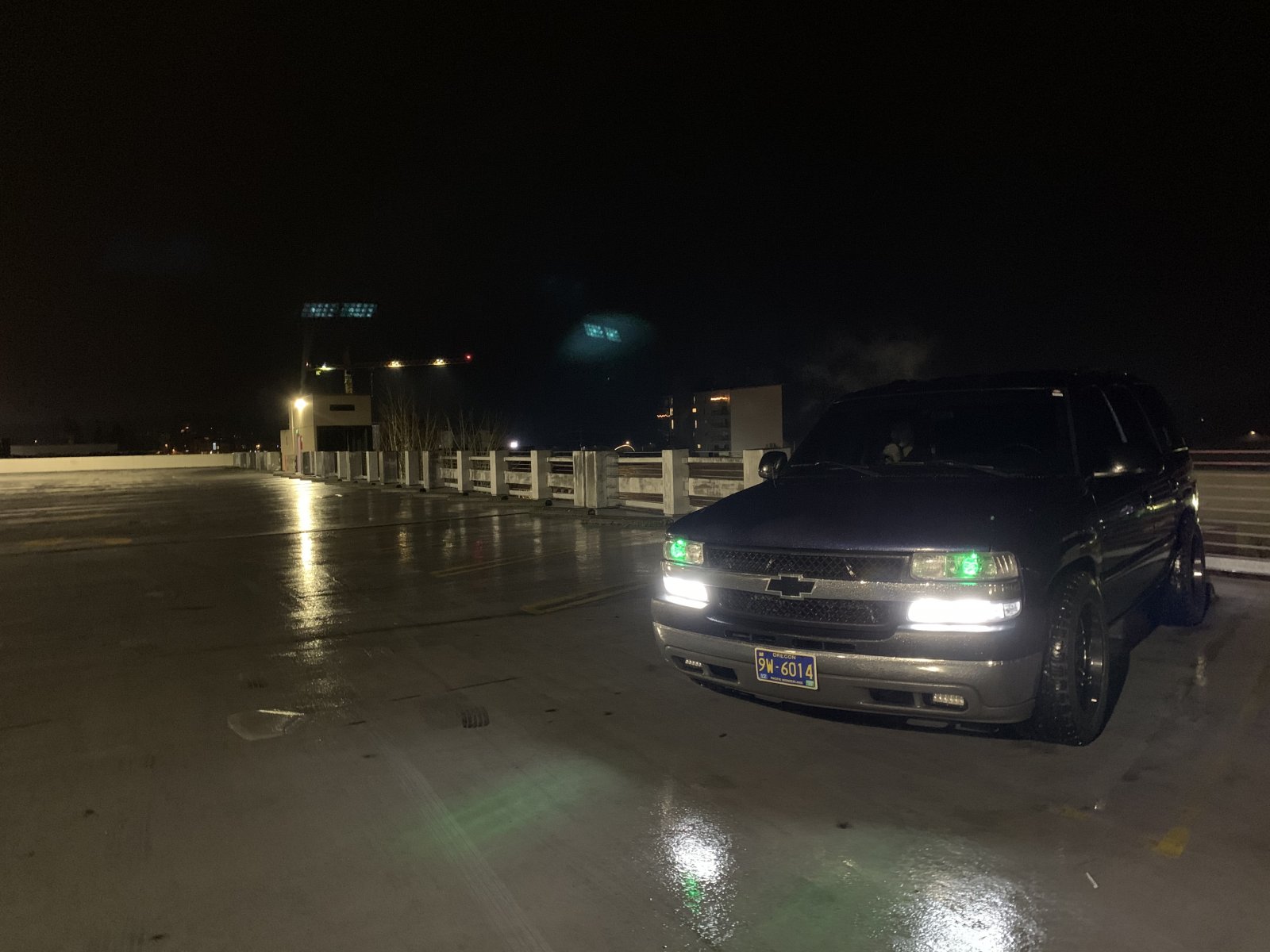

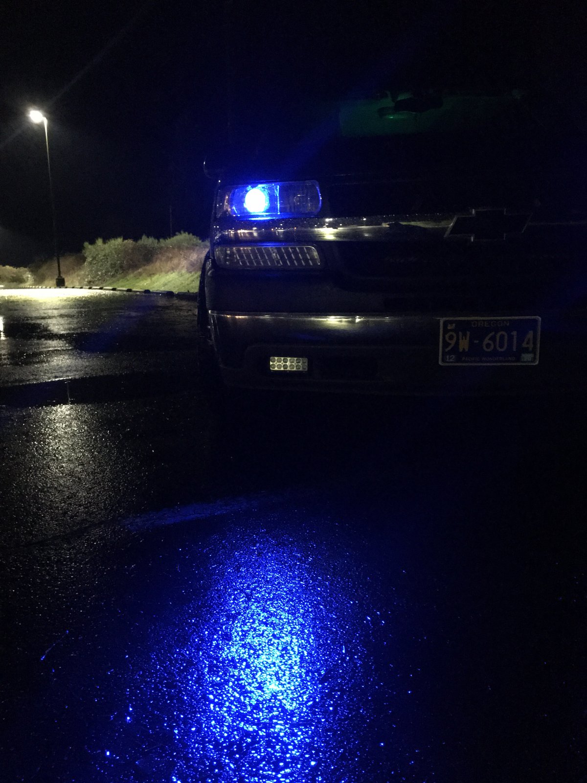

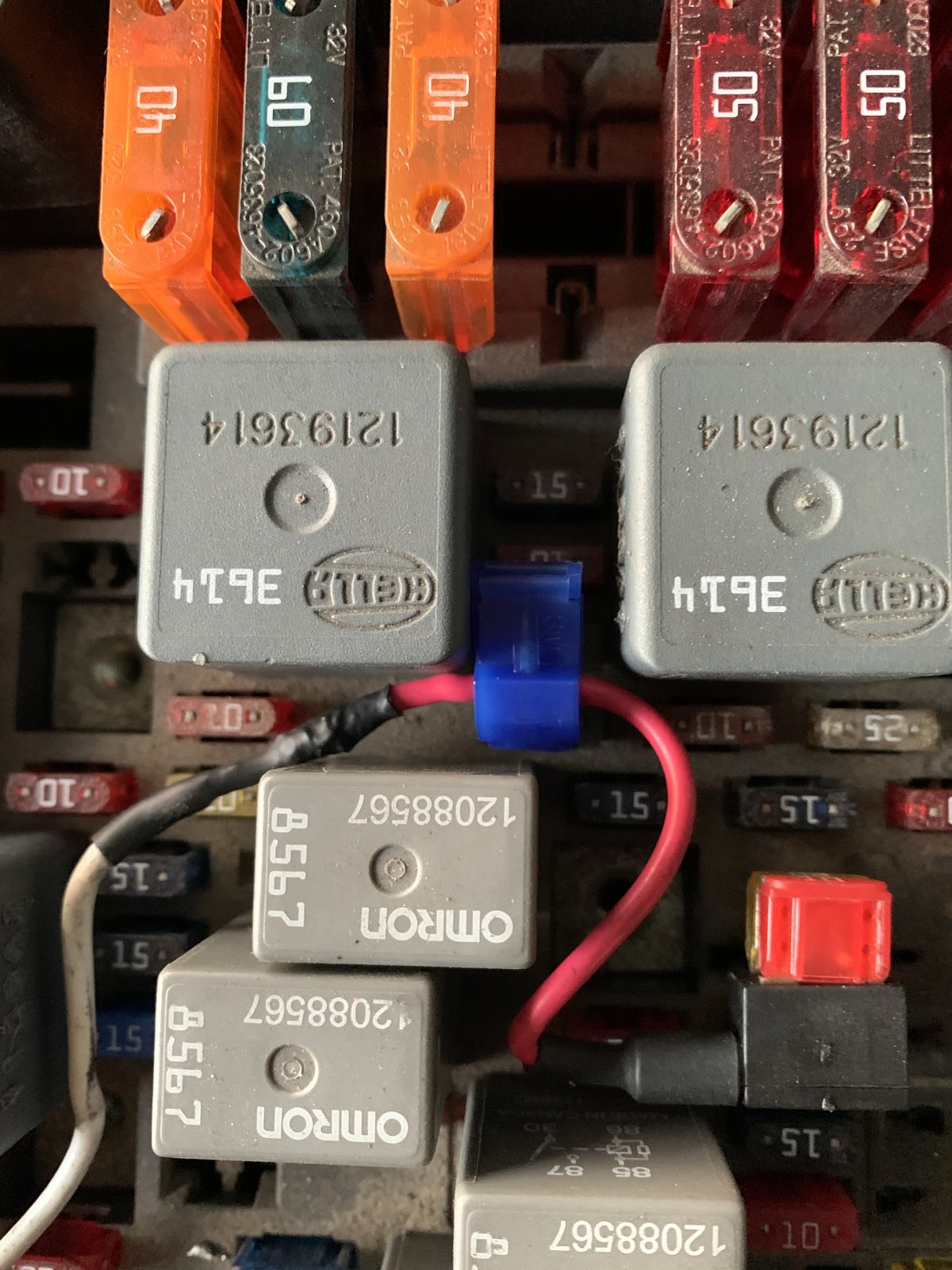

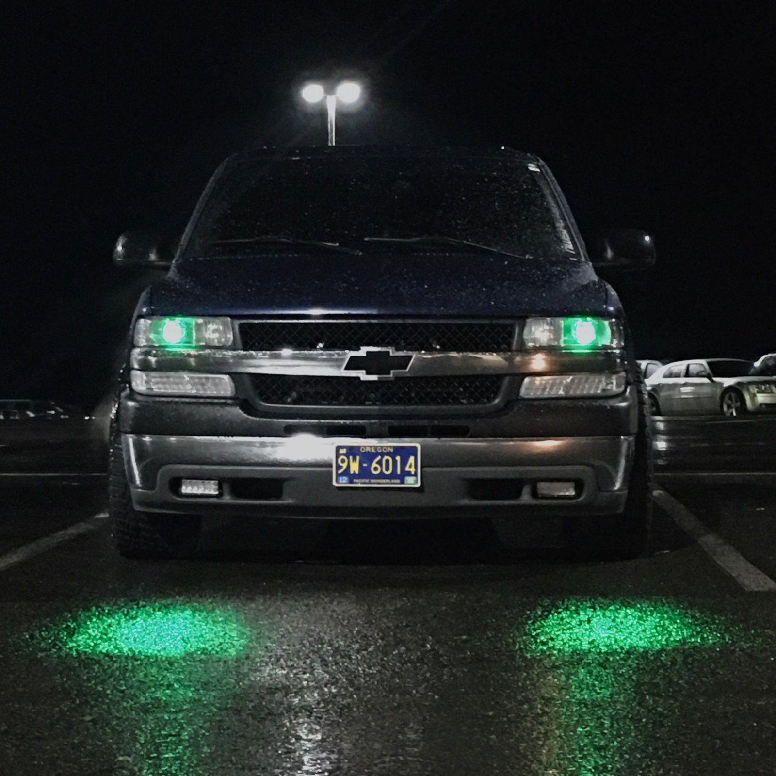

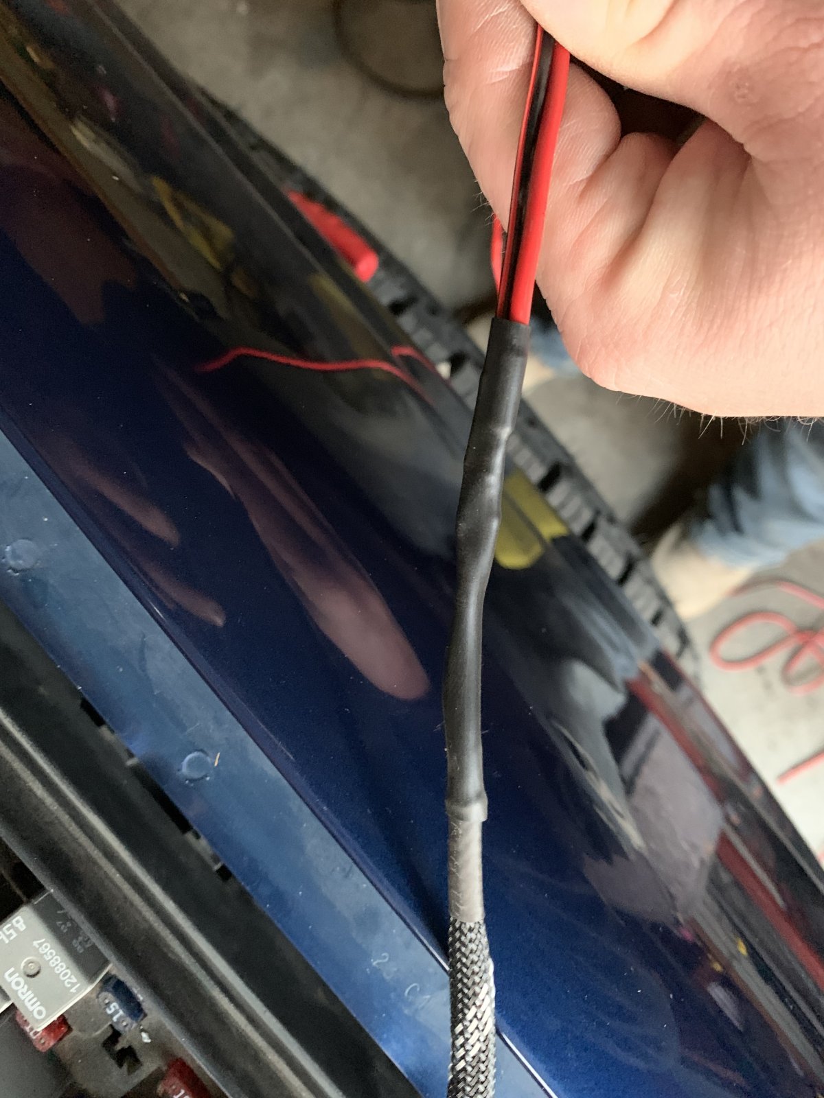

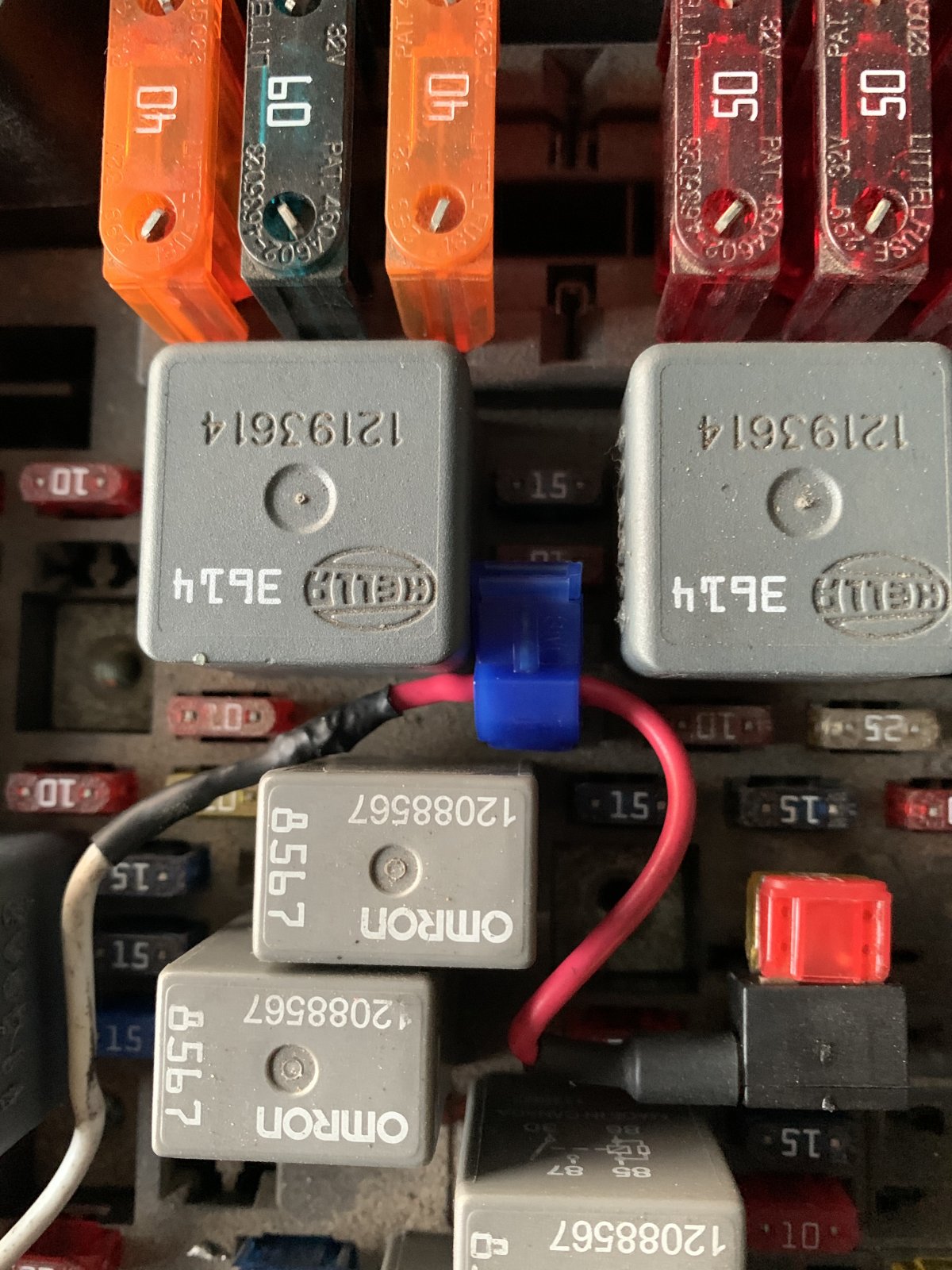

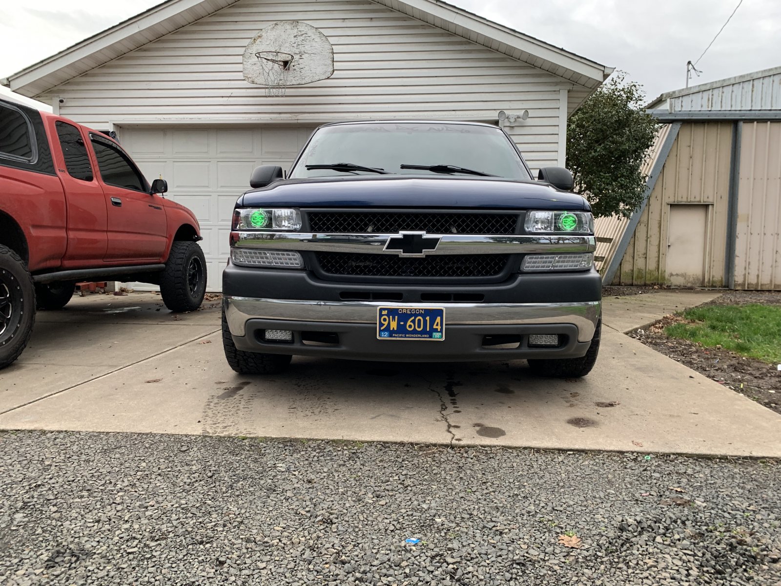

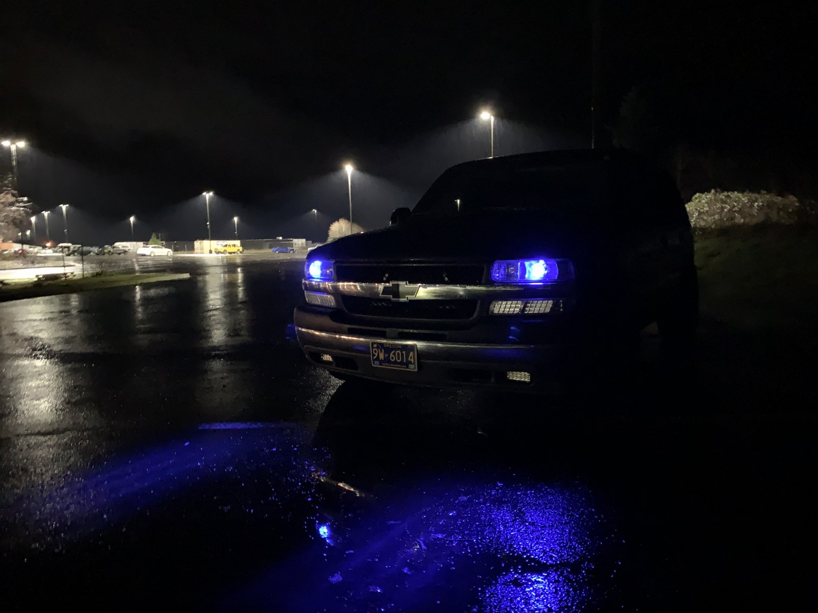

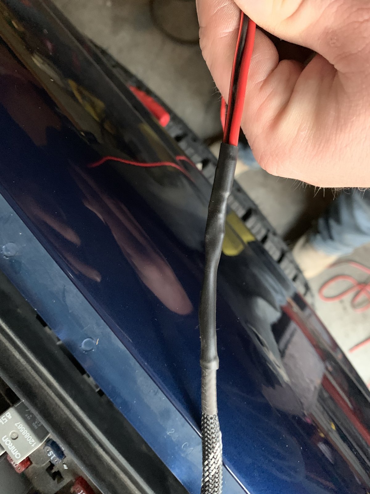

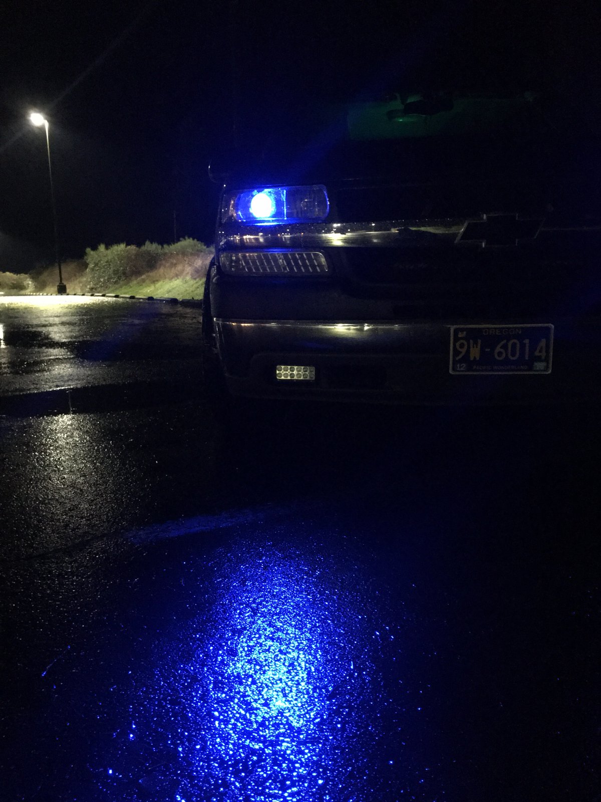

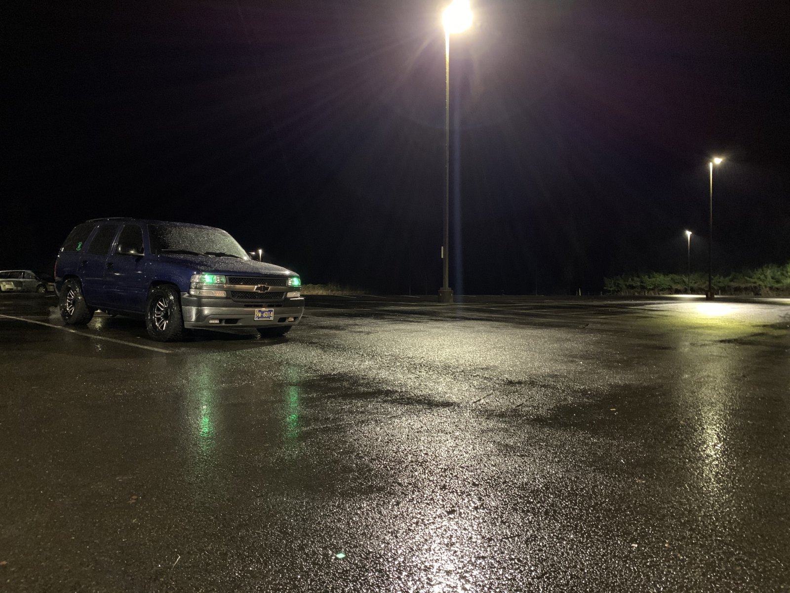

Today I made my demon eyes permanent. I had them hardwired and was just unhooking the ground when I wasn’t taking pictures. Soldered an extension onto the xbt controller since they give you maybe a foot to work with :emotions34:
Wish I still had tech flex laying around to cover that wire but that can be fixed later. I have my fog light relay harness Connected in the under hood fuse panel for my constant. And my dual alternator relay setup is directly behind the fuse panel running into the cabin to a fuse ignition +. When I’m at audio shows I’ll be parking it with the demon eyes on during the show/while I compete. I usually leave my windows down halfway and hood popped when it’s parked so I didn’t want to have my keys in the ignition for the demon eyes to work. Decided to make the positive wire have a male spade terminal and put a female t tap on both constant and ignition wires. So it’s connected through ignition + normally and at shows I can switch it over to the constant power in the fuse panel.
Also went to the casino on Christmas eve and grabbed some night shots in the parking lot and in a parking garage on my way back home.

Today I made my demon eyes permanent. I had them hardwired and was just unhooking the ground when I wasn’t taking pictures. Soldered an extension onto the xbt controller since they give you maybe a foot to work with :emotions34: View attachment 237291
Wish I still had tech flex laying around to cover that wire but that can be fixed later. I have my fog light relay harness Connected in the under hood fuse panel for my constant. And my dual alternator relay setup is directly behind the fuse panel running into the cabin to a fuse ignition +. When I’m at audio shows I’ll be parking it with the demon eyes on during the show/while I compete. I usually leave my windows down halfway and hood popped when it’s parked so I didn’t want to have my keys in the ignition for the demon eyes to work. Decided to make the positive wire have a male spade terminal and put a female t tap on both constant and ignition wires. So it’s connected through ignition + normally and at shows I can switch it over to the constant power in the fuse panel. View attachment 237290
Also went to the casino on Christmas eve and grabbed some night shots in the parking lot and in a parking garage on my way back home. View attachment 237288View attachment 237287View attachment 237289

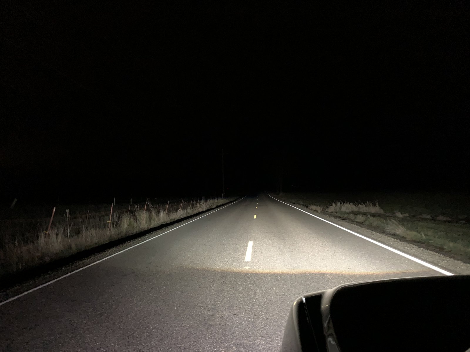

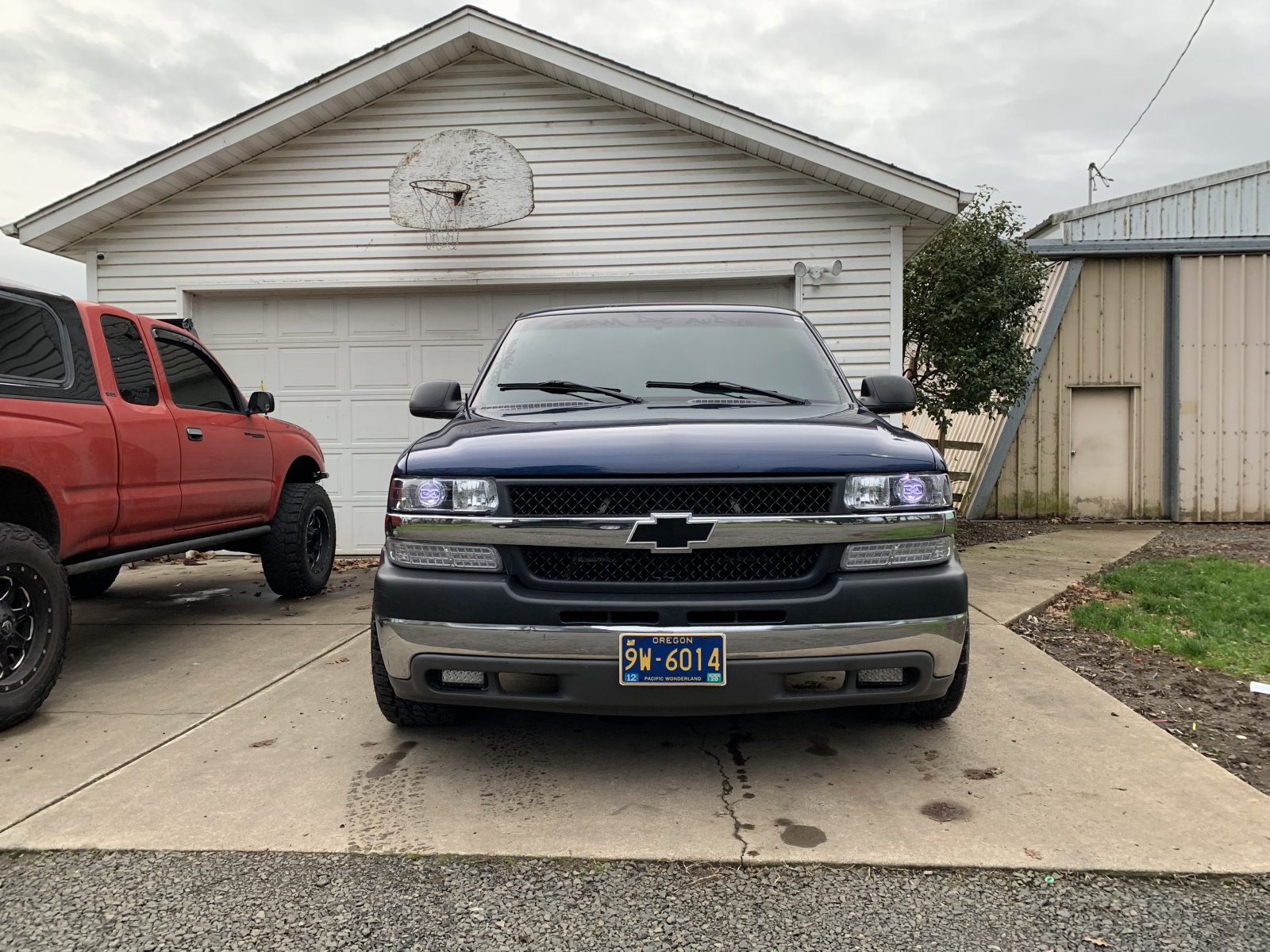

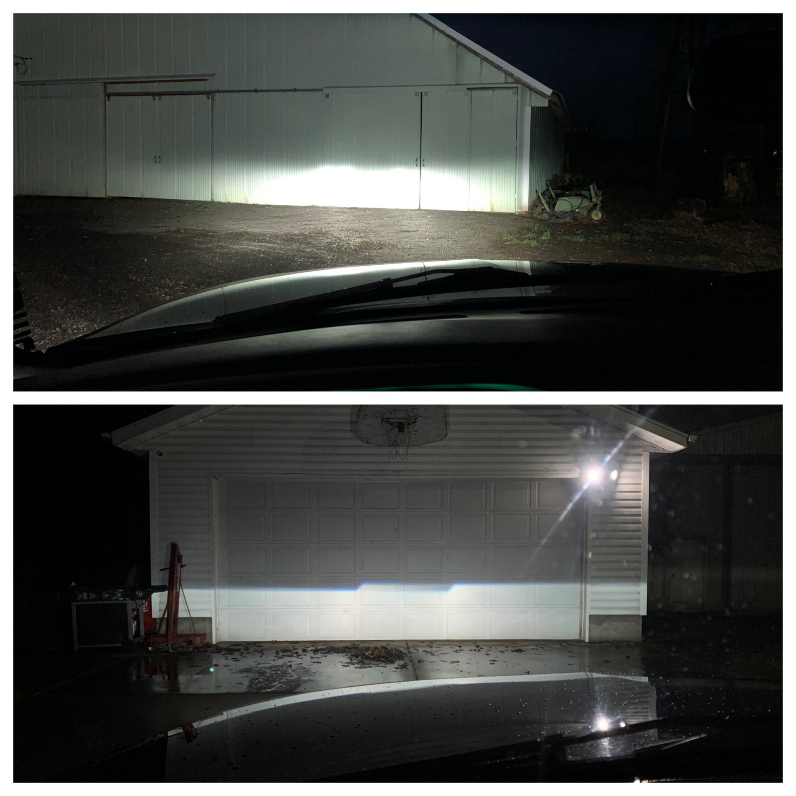

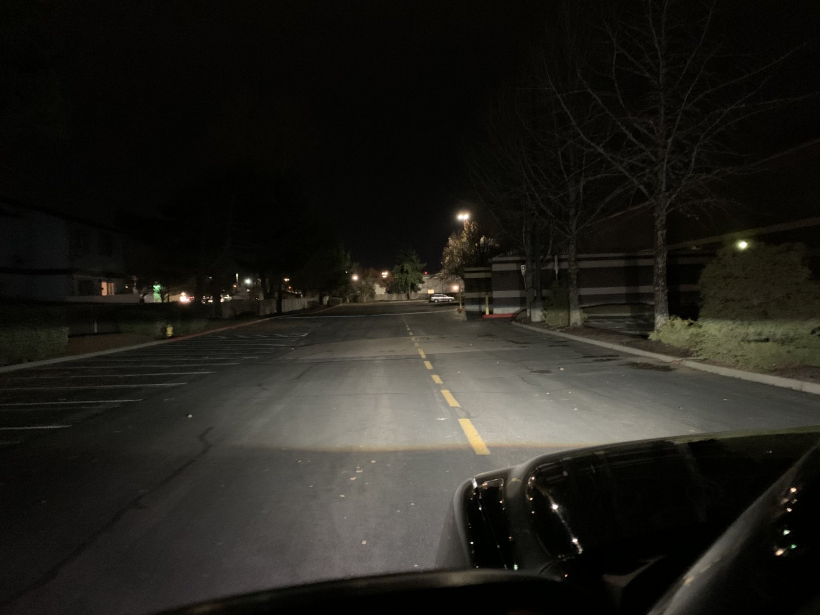

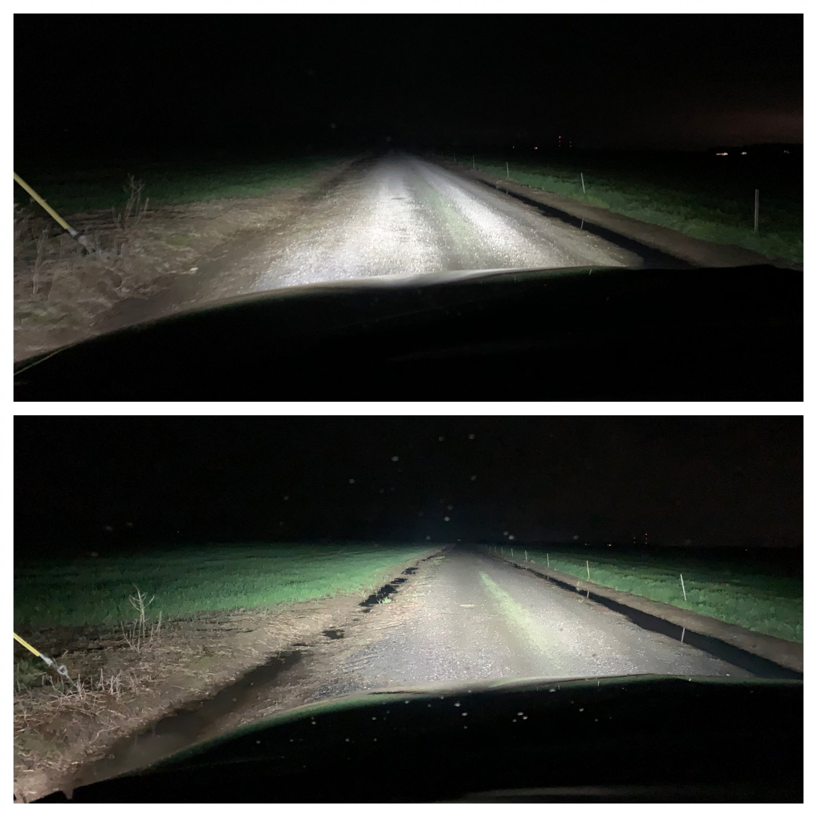

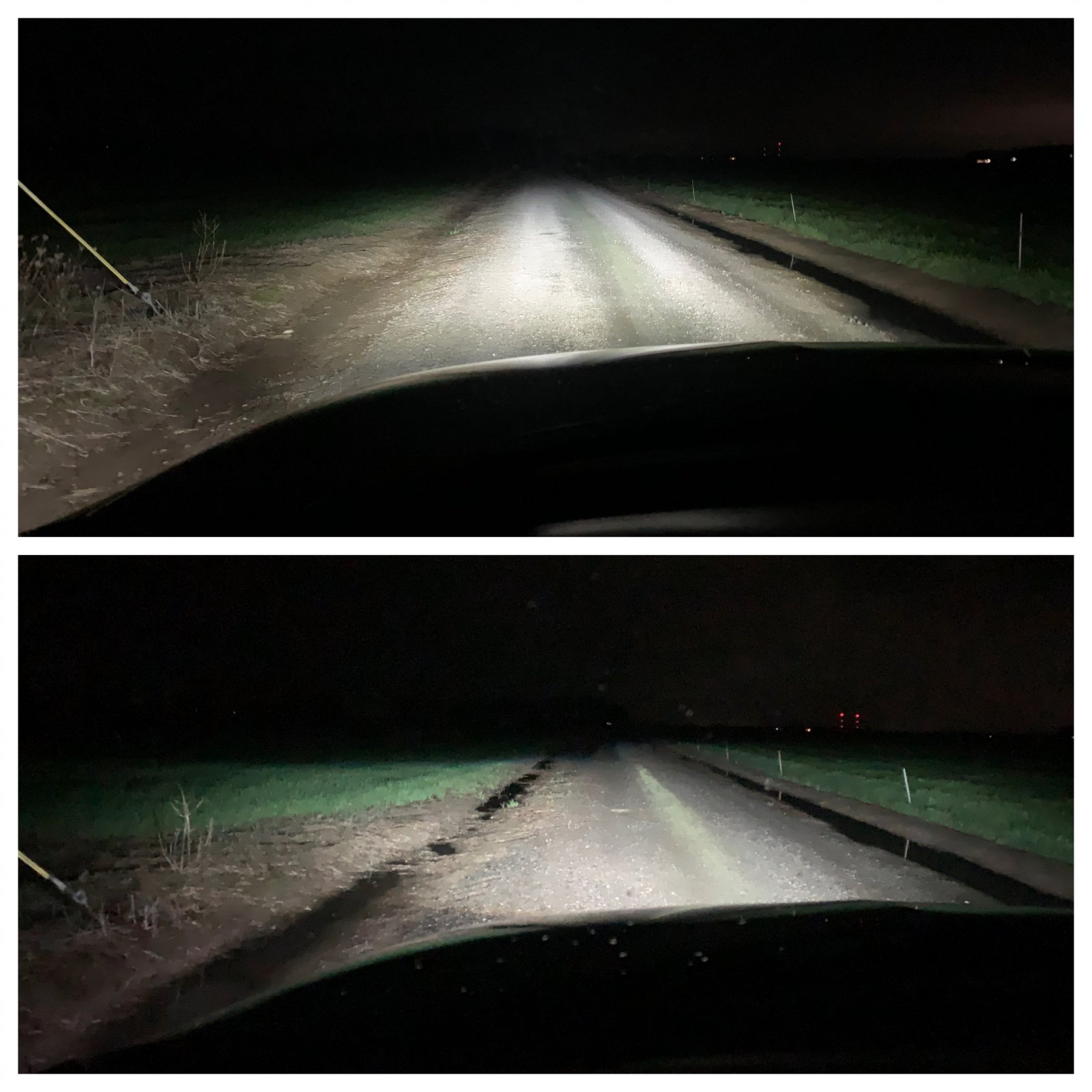

Happy new year! Finally decided to get some output comparison shots for before and after the retrofit.
All the before shots will be on the top.
Same housings I used for the retrofit in the before pics, racesport 9006 pnp led for low beam, and a similar 9005 led pnp for high beam. I re used the 9006 racesports as a secondary high beam with the retrofits.
low beams
High beams

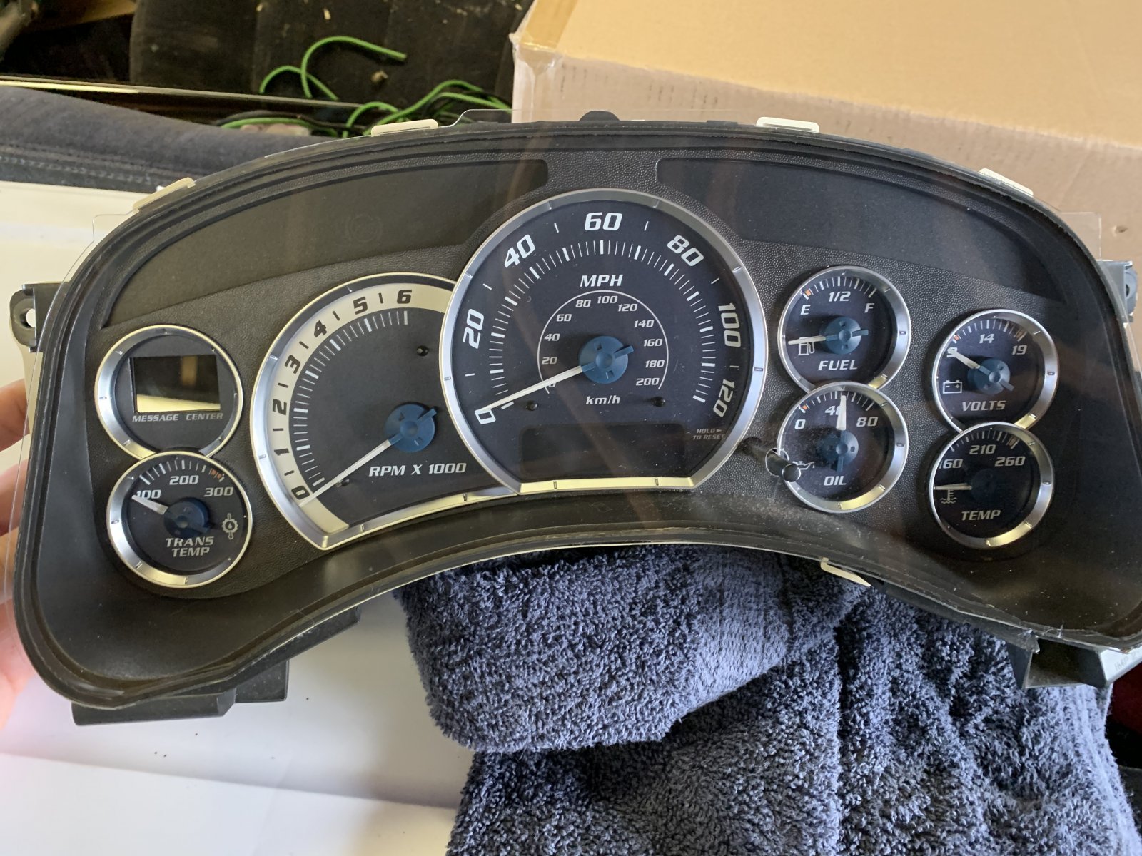

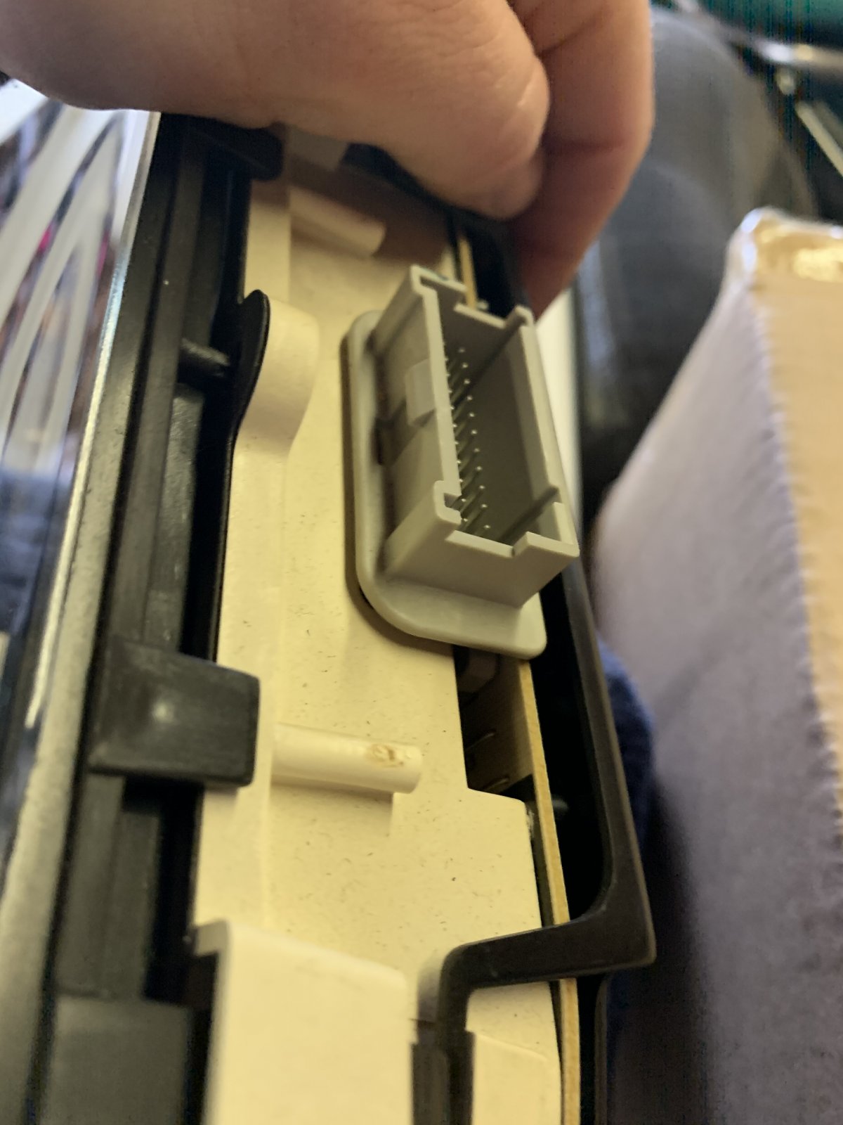

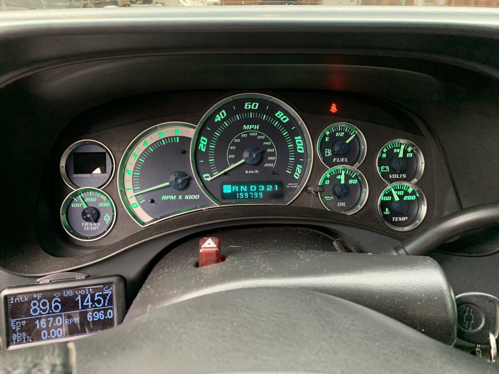

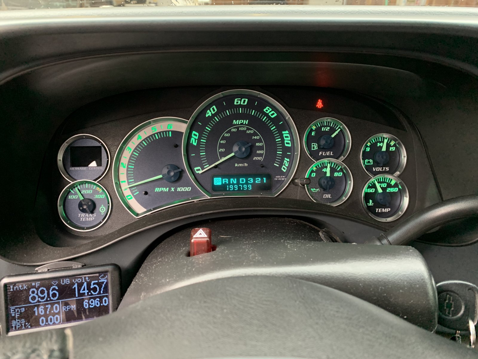

Went to the wrecking yard with the lady today. There was a 02 Escalade ext truck sitting in the very back. Gauge Cluster was still in it!!! My buddy works there so I called him and asked for a price and mileage.
He said they normally sell them for 175 but he will give me it for 125. Okay score rarely can find them that cheap. And he said the mileage was 194000. Mines at 204000. So pretty close. We got up to the front and he said He would do 100. Hell yes!! I’m stoked at this point.

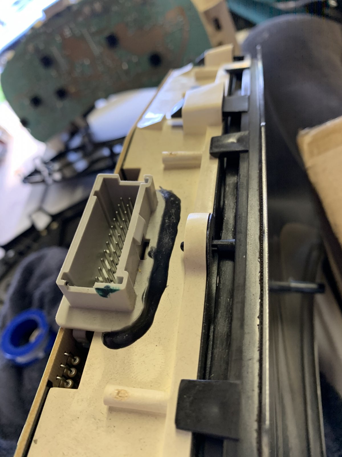

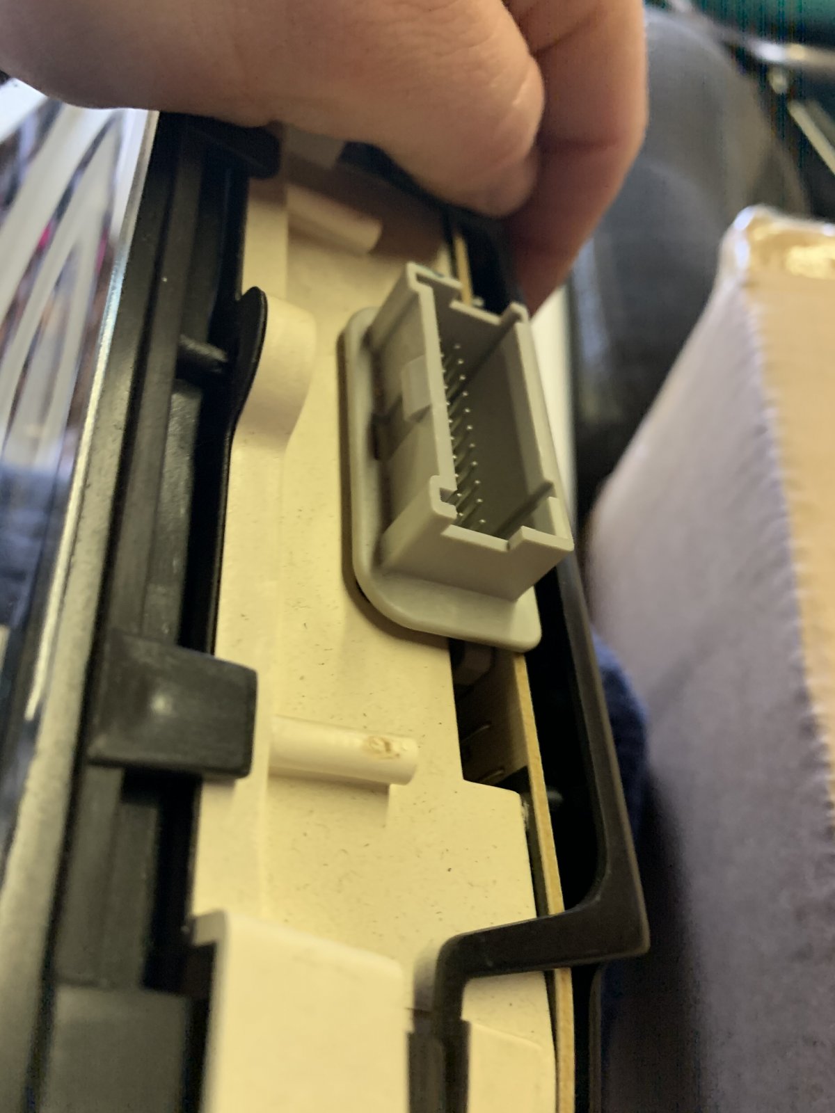

Got home and pulled my HD cluster out. Swapped over the green leds. Also for anyone who has problems with 00-02 clusters acting up I found out after bass broke my hd one that the female end on the cluster doesn’t have support so where it solders to the circuit board breaks easily. Made sure to fix this one before that can happen. Just put a layer of ca glue underneath it for support and sturdiness.
got it hooked up and it’s at 199000 so only 4000 away from mine. Couldn’t have luck like that again I’m super stoked been wanting one since I bought the Tahoe.
View attachment 237858 View attachment 237859
got it hooked up and it’s at 199000 so only 4000 away from mine. Couldn’t have luck like that again I’m super stoked been wanting one since I bought the Tahoe. View attachment 237860
I like the green.
