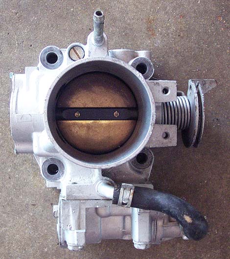

Also I would still recommend some one with the same engine chime in here. I could be wrong, but a open hole in the throttle plate just does not sound right and maybe along with old o2 sensors maybe be causing this mess for you I mean the TB, WOW.
It is like someone drilled a hole to get the engine to run faster for a high electric load or something.
I'm pretty sure the hole you are talking about is normal. I've seen it on just about every car i've owned. 1996 Maxima, 1996 Explorer, 2000 Explorer, and my 2001 Tahoe, all had similar holes. Also I have seen completely solid blades. I have read that people who are tuning their vehicles themselves will drill a hole to help with Idle. (I'm not suggesting to do this at all)
I think it just depends on your vehicle.
