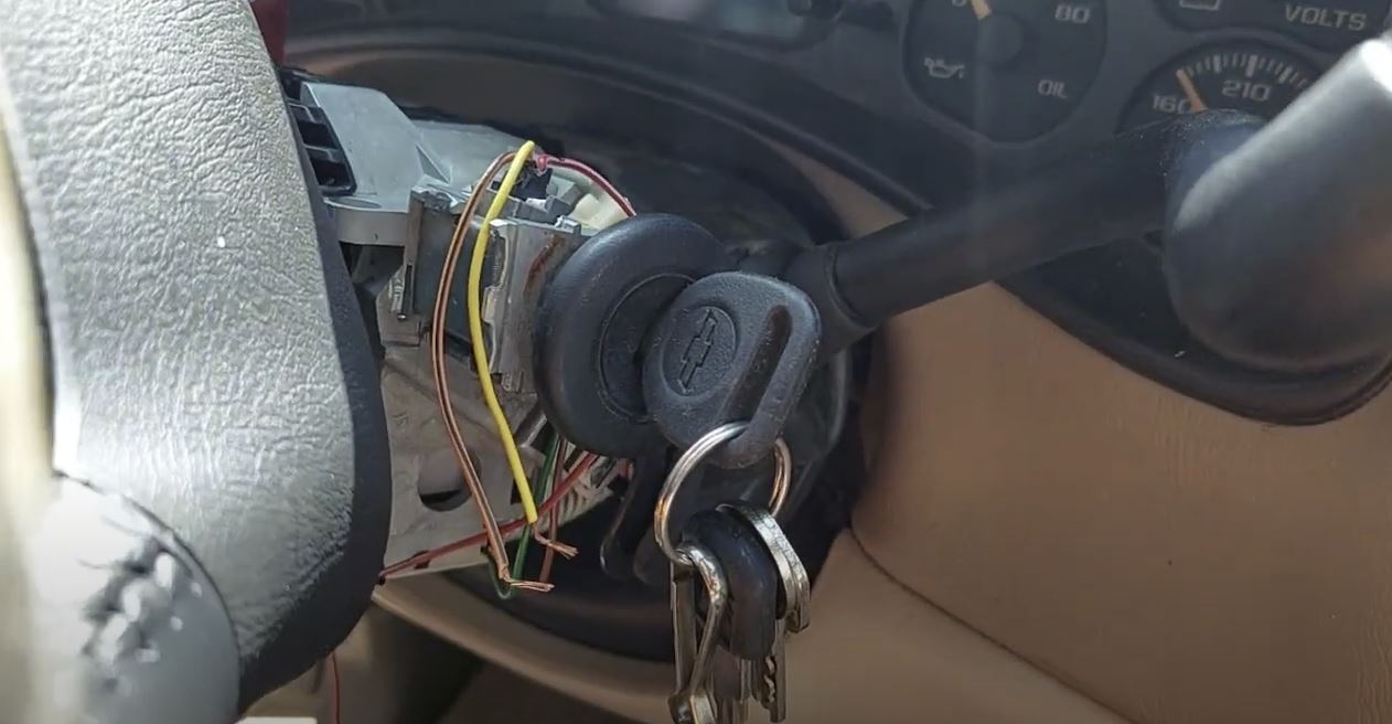

if you touched or moved the hall sensor plug while doing the clockspring that might be why, it has a small connector right above the ignition housing
The clock spring I ordered from rockauto was in my opinion a whole wiring harness. If it's the one I think you're referring to it's a white plug with 2 wires, can't rem the wire colors right off though. And the clock spring I used I had to pull that one out and replace it with the new one. And it was a little bit of a pain to get that plug out. The new plug went in fairly easily, and the "cap" on the top.of the plug popped off once before I got it all back together.

this is the hall sensor location, you do not give a year and I do not know if they changed after 02 or not
