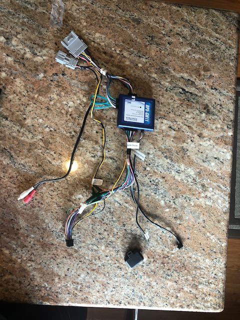

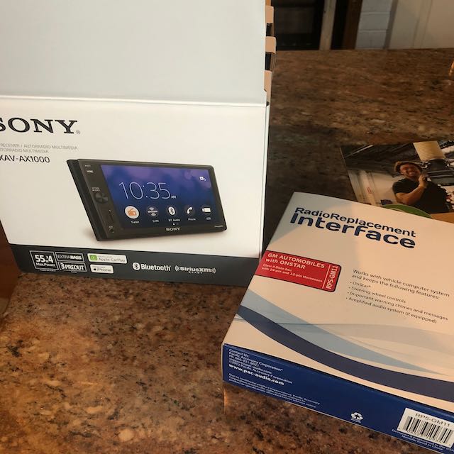

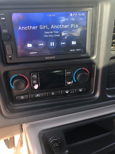

Here is my install , I also used the correct modules to keep steering wheel controls ,etc.. I chose this Sony because it is single DIN sized behind the screen which left space for the harness and adapter modules. I also put in a back up cam while I was at it.

Question about your Sony. Does it pick whatever radio station it wants for you? I have a Sony that looks the same, I love it, CarPlay etc. but the radio part (admittedly don’t use it often) is crap. It will change radio station every time I get in the car. It also tried to put words on the presets, so I never know what frequency is what. Annoying.

That is the exact same unit I put in mine. I also put the same unit in all my kids cars. Love the big screen and Apple Car Play. I also like the volume knob.
Gee thats odd... I haven't experienced anything like that with this unit. Maybe something not wired correctly and its resetting when you shut the truck off? I don't know..
