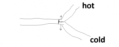

i'm sitting here wondering why no one has suggested checking the front blend door actuator? if the rear works fine that means the system is working properly, that leaves only 2 likely scenario's 1. the front blend door is not working properly. 2. possible front heater core clogged but it is much less likely.
it wont cost you any money to take off the passenger side bottom kick panel and check the hot/cold blend door for proper operation, you can even take off the actuator and turn the door by hand and feel for hot/cold air to verify

I can explain. "BRAIN FART". We talk about that all the time but wouldn't that involve a blower feel problem.
no, because the blend door only mixes hot & cold it does not control air flow, it could be getting stuck at 20% hot and 80% cold
it works like a Y both hot & cold air flow at up to 100% regardless if it is on 100% hot or 100% cold or anywhere in between
the door moves up and down mixing the air temperature
