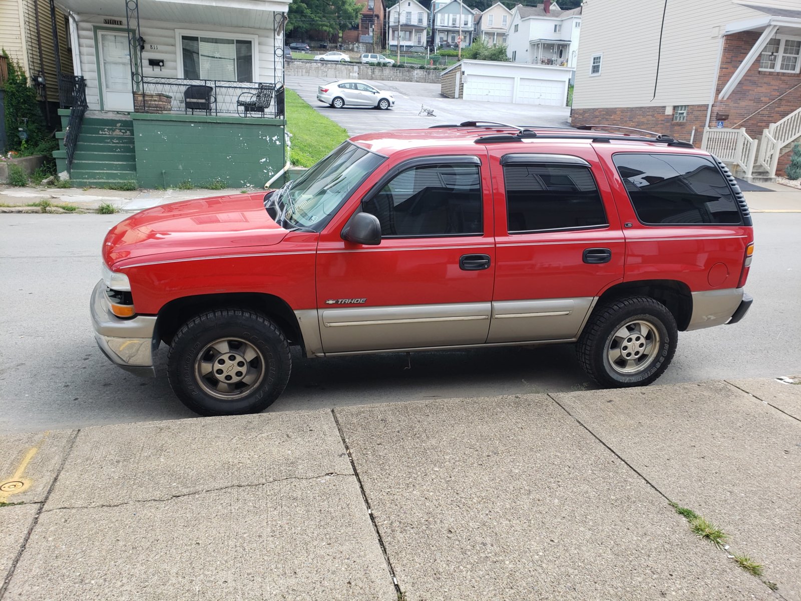

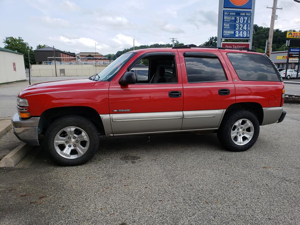

So i bought this 2000 Tahoe around April it had 180k miles and was very clean, 1 Owner and garage kept.
Picture when i first got it.

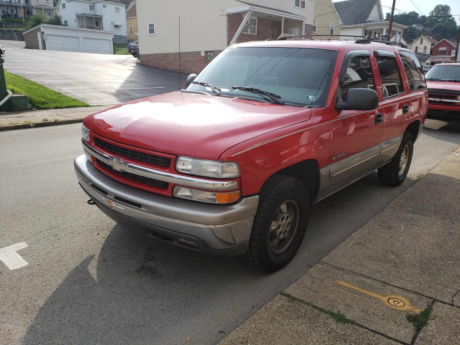

First thing i has done was remove the full length running boards, Not sure if ill put them back on.

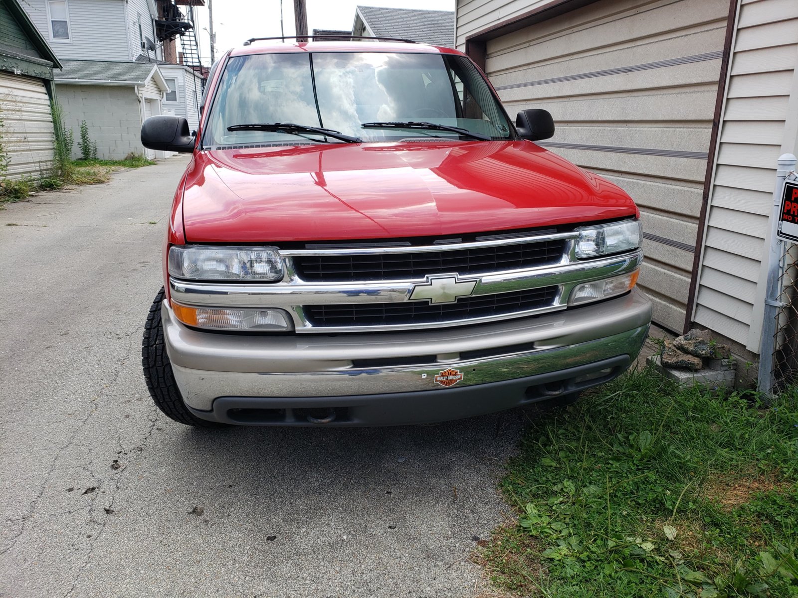

Then painted the front grill.
Before
After

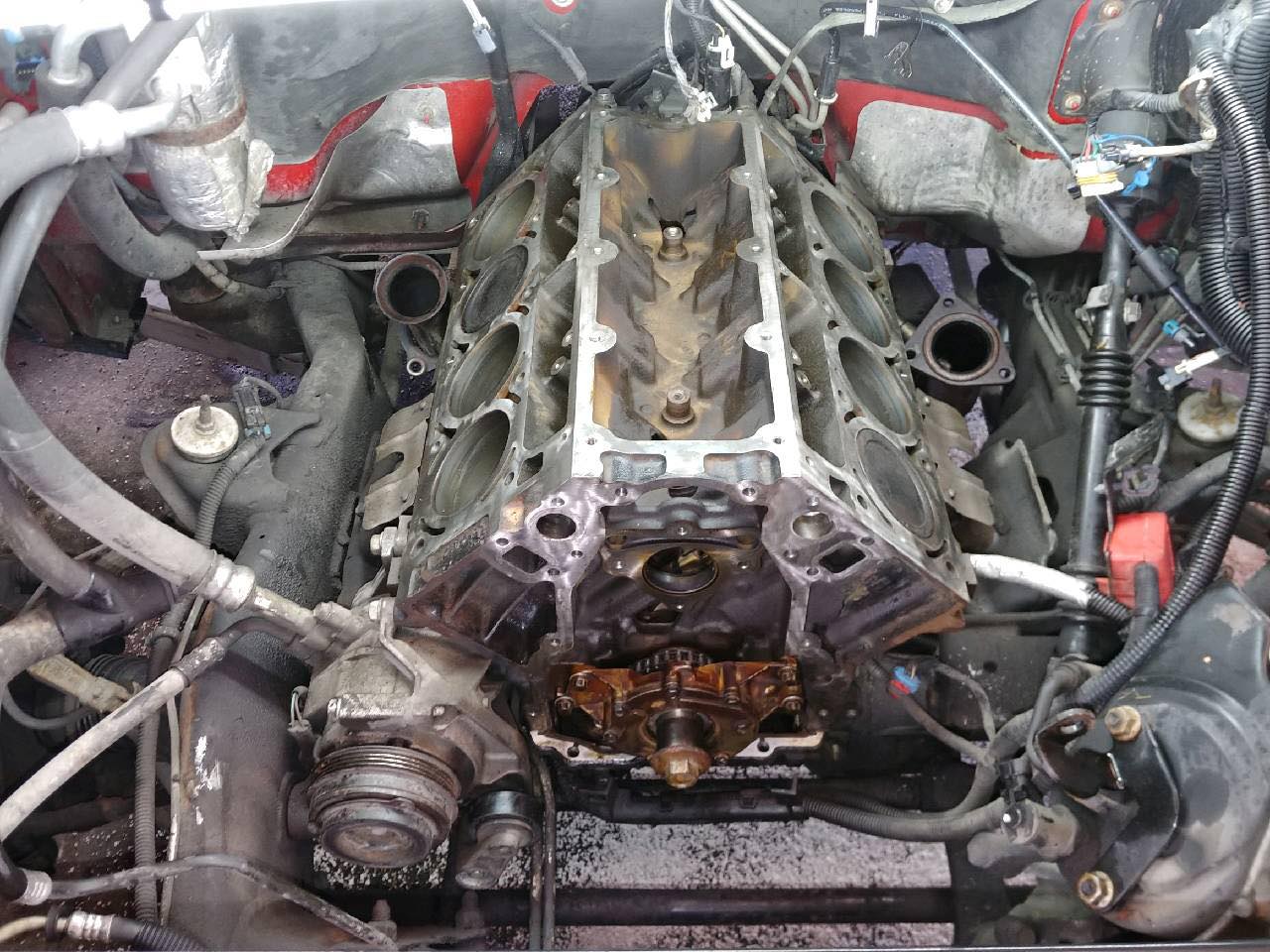

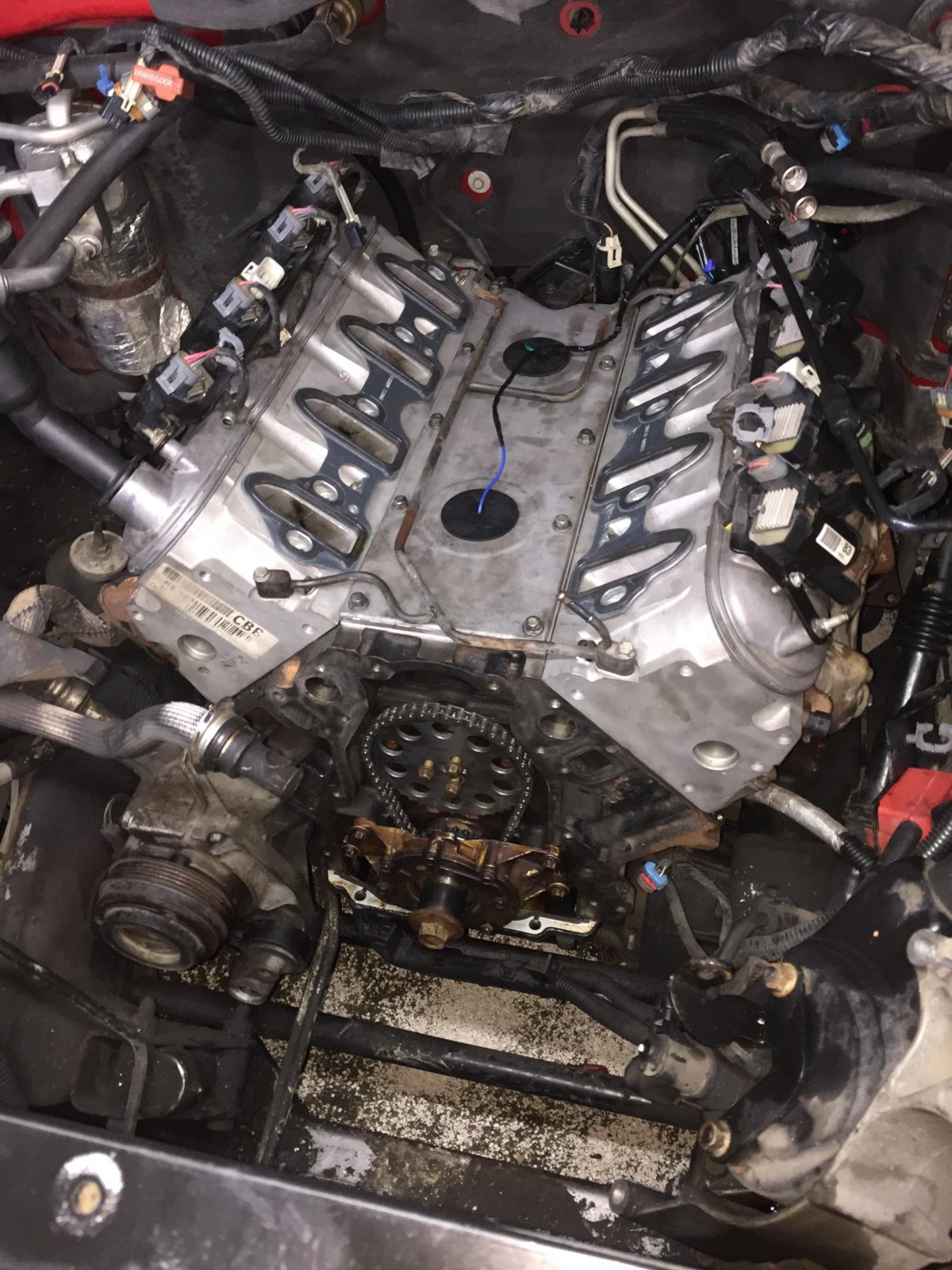

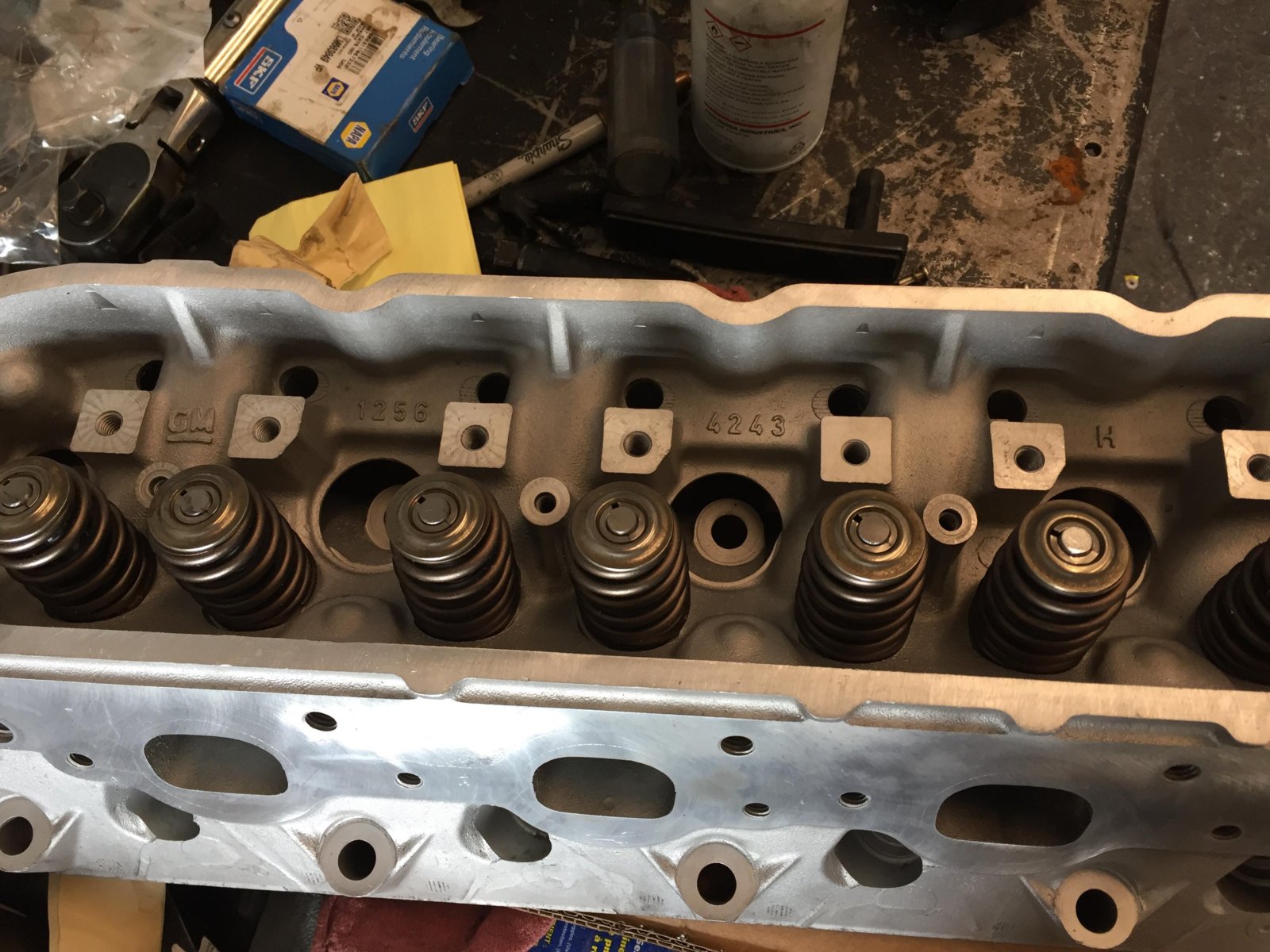

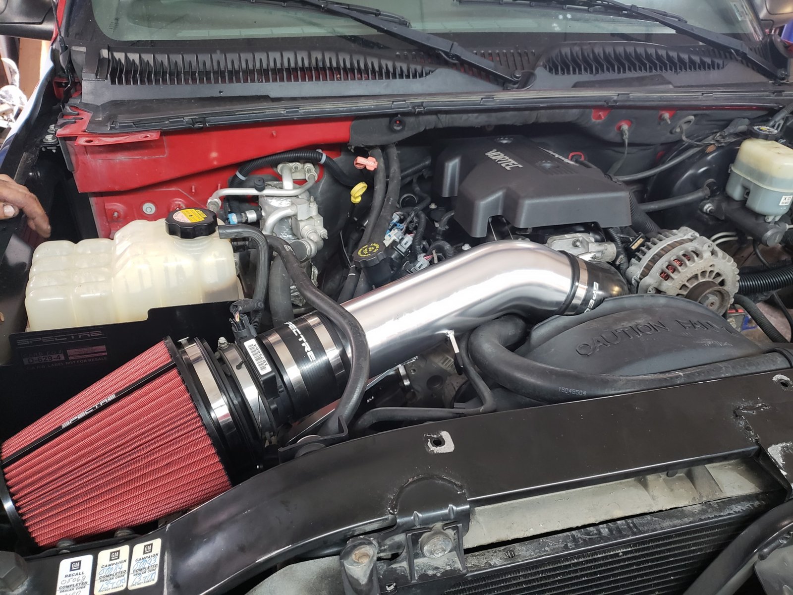

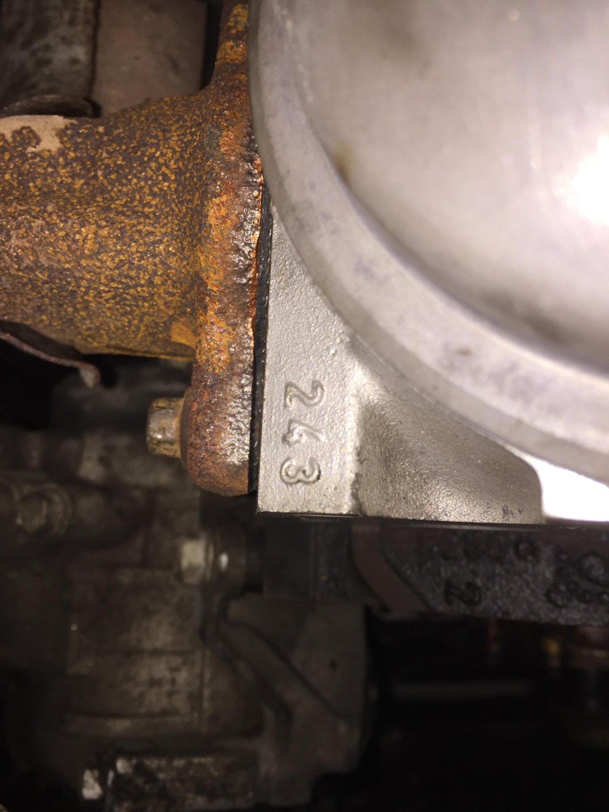

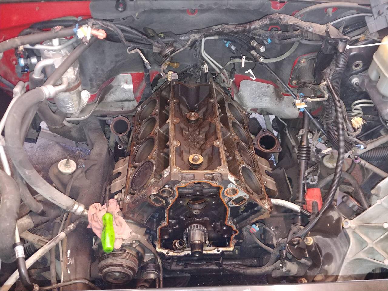

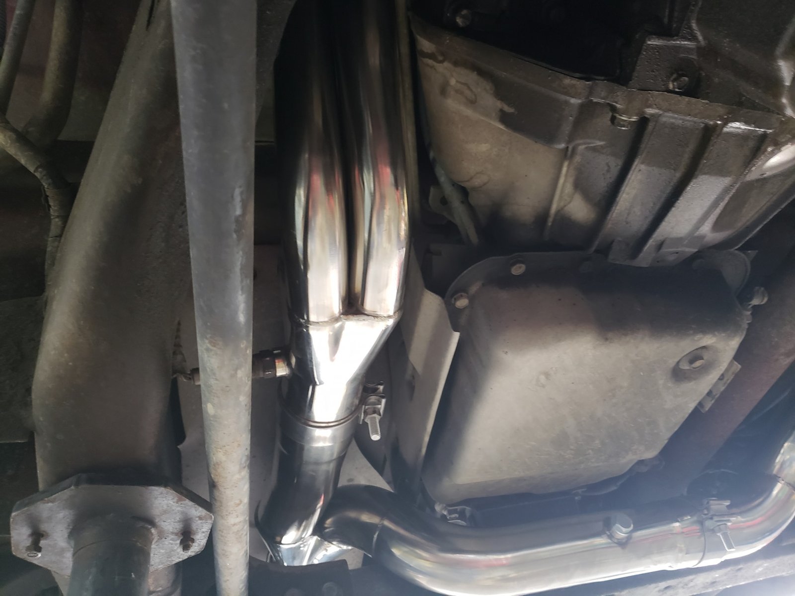

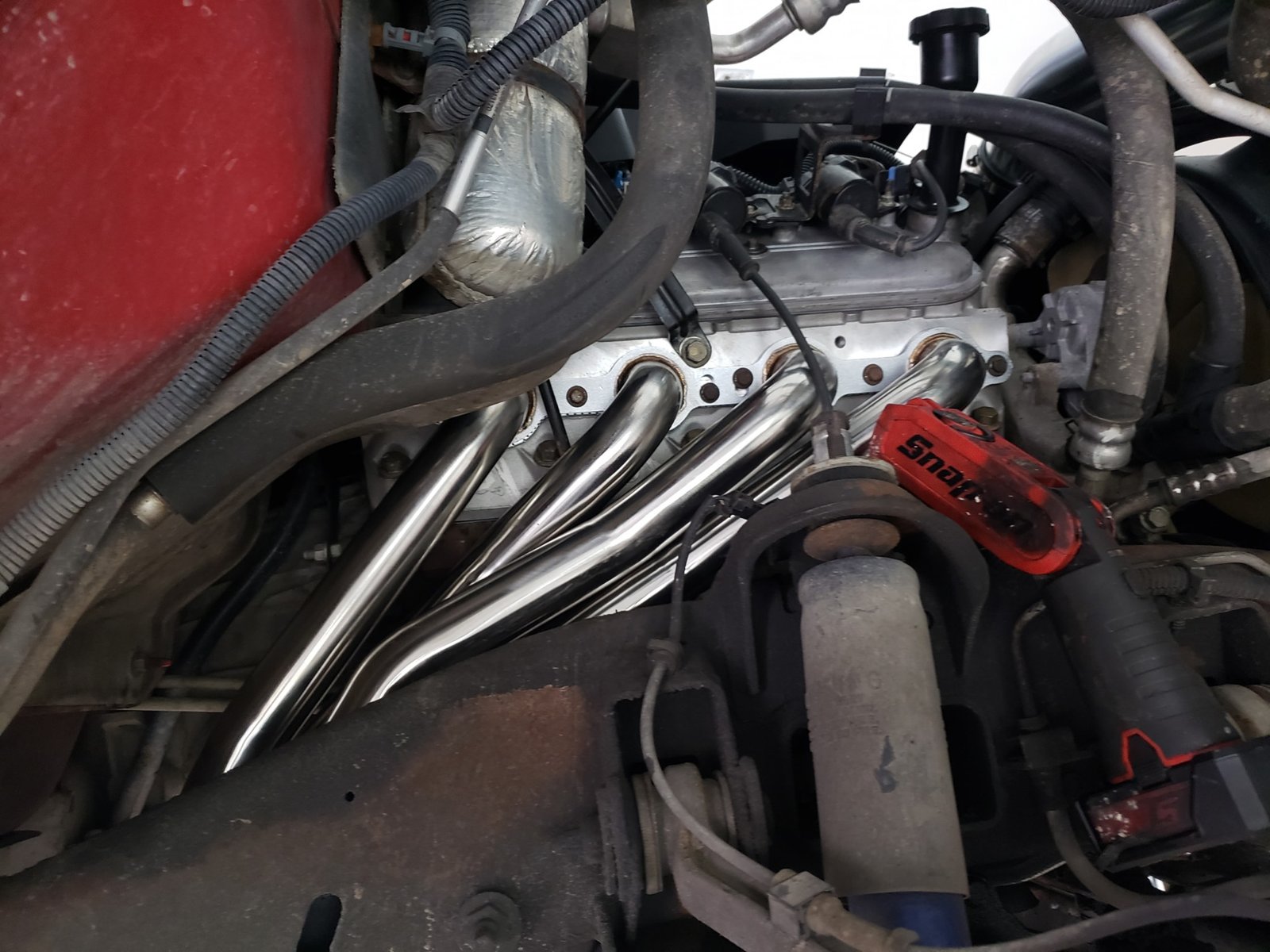

Then did some engine upgrades
LS6 243 Heads Pocket Ported
Trick Flow Beehive 600 Valve Springs
BTR Stage III Truck Cam

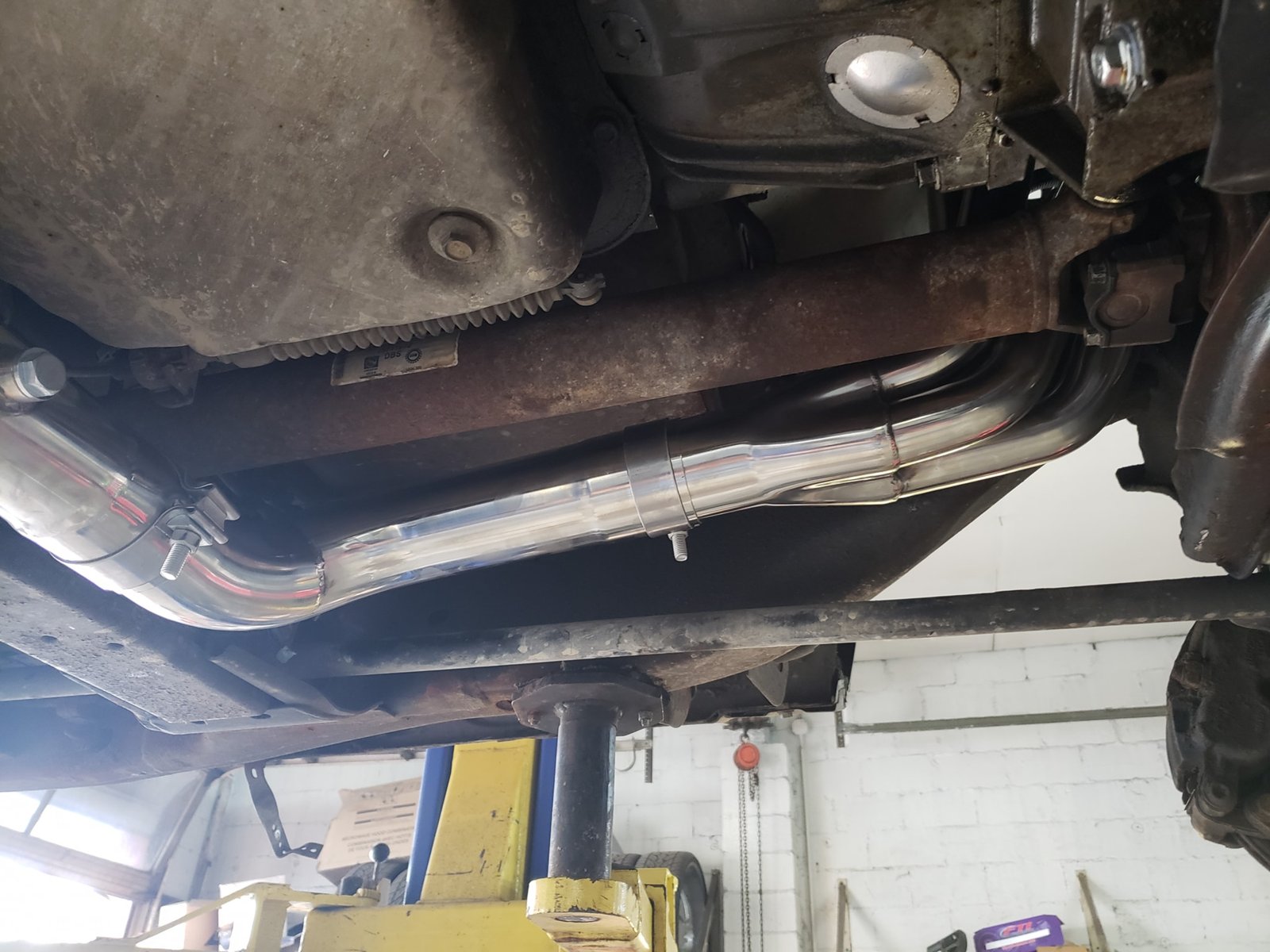

Speed Engineering Longtube Stainless Headers
Speed Engineering Catless Y Pipe
EGR Delete
Flowmaster Super 44
Street Tune
Spectre CAI
