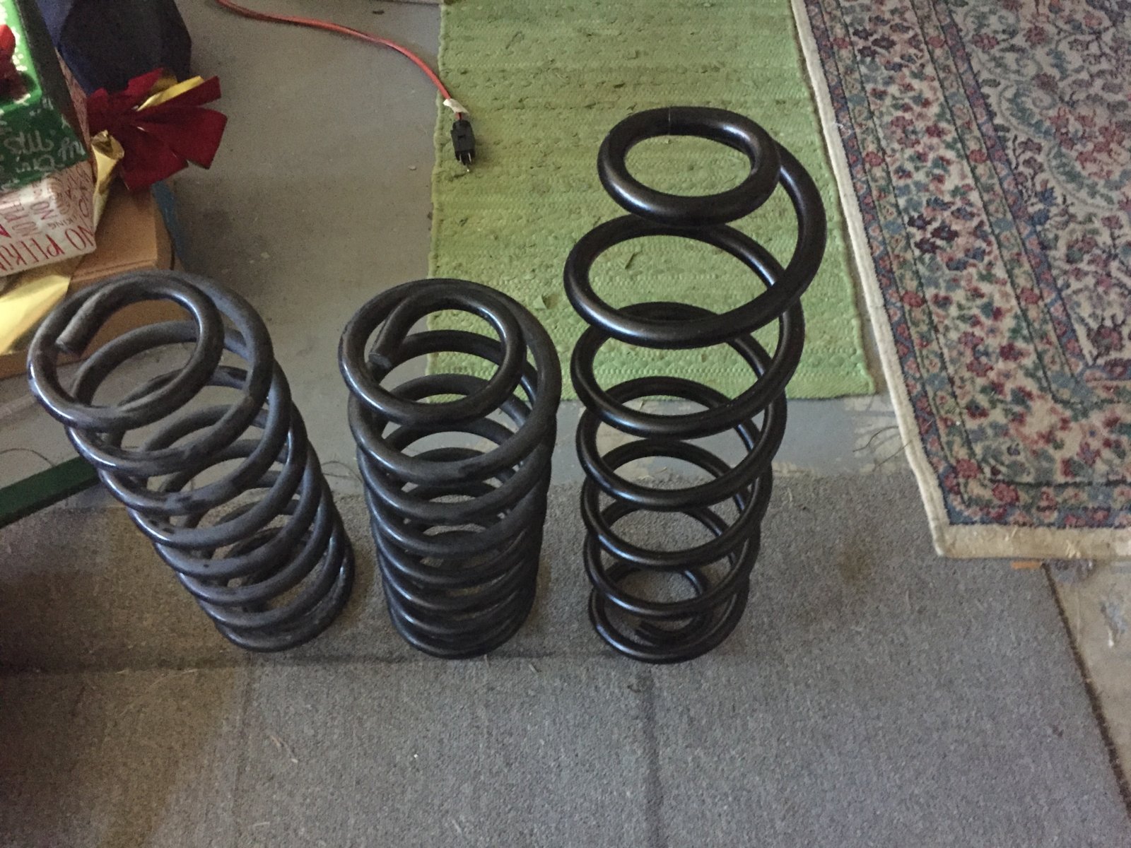

Got longer 5165 rear shocks, got the Skyjacker 4.5” C50R lift springs, and the BBP autocal. Now to just not be on the couch in a codeine coma - upper respiratory infections suck big time.....
Moog Z71 springs next to the new Skyjacker C50R

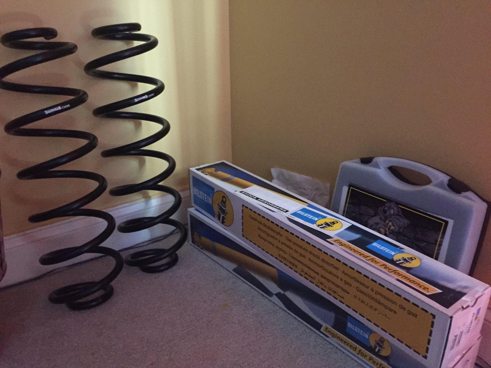

That should even rear out for lift and those 5165s will look great!
Nice should look good once on.
Thanks guys, I am really happy with how it’s turning out.
It feels like a brand new truck, which it almost is, but everything is so tight and it rides sooo dang smooth with the Bilstein 5165s. I got the longer shocks swapped out on the rear this weekend but need to start feeling better before I tackle the coil springs and what not, I was fading fast doing the shocks and was just laying there looking at the coil springs like there’s no way I am doing that today. Lol

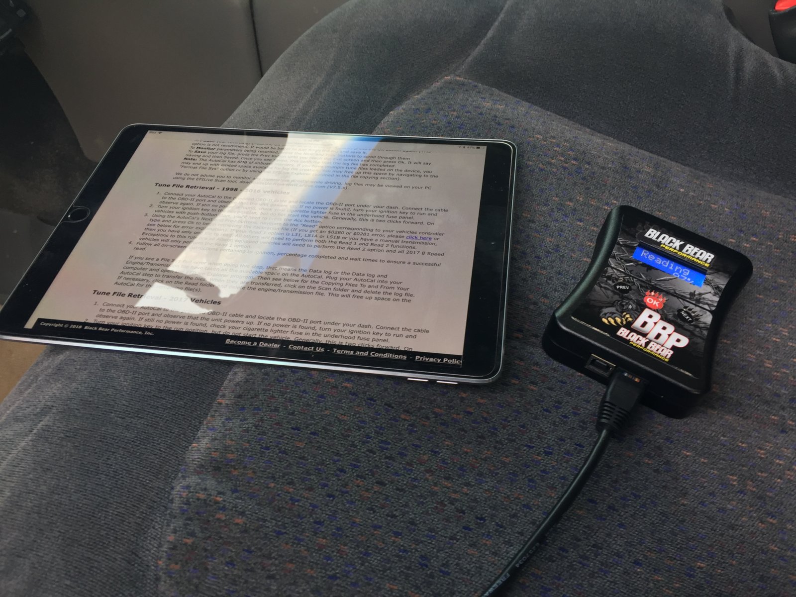

Just collecting data? You haven't installed a tune yet? Oboy.
Haha cut me some slack I had the black lung papa.

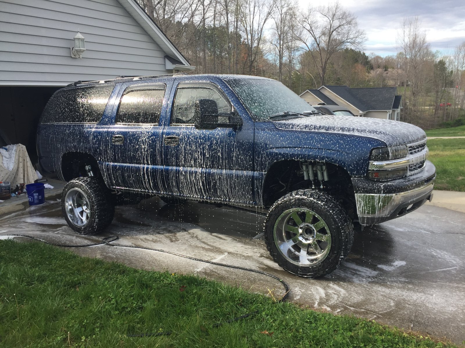

Did another thing that was a blast! This little cannons not bad for the money, I have other tips to make more foam but I wanted to see what this was like. Def made washing s truck this big easier. And the Adams detail spray and H2O Gaurd and Glass spray are amazing! Good deep shine and super easy to work with.

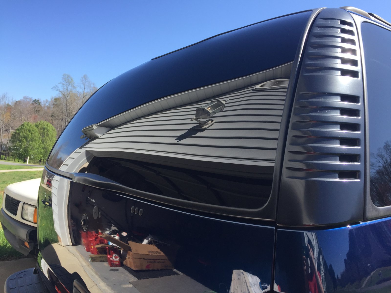

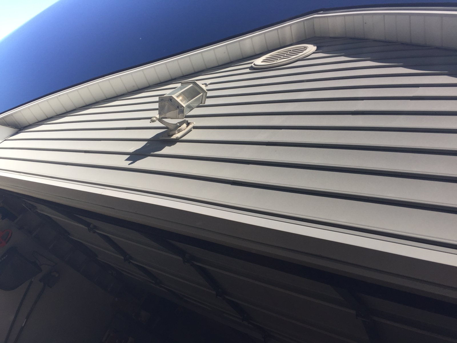

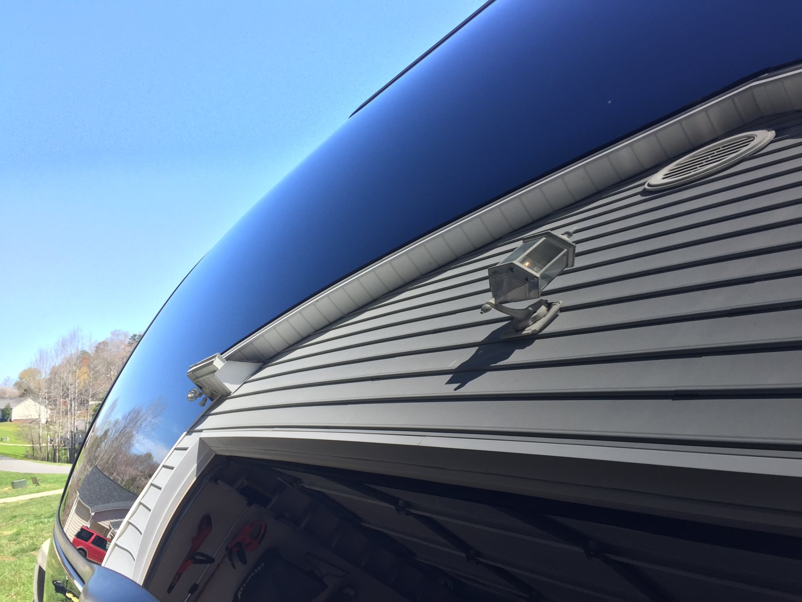

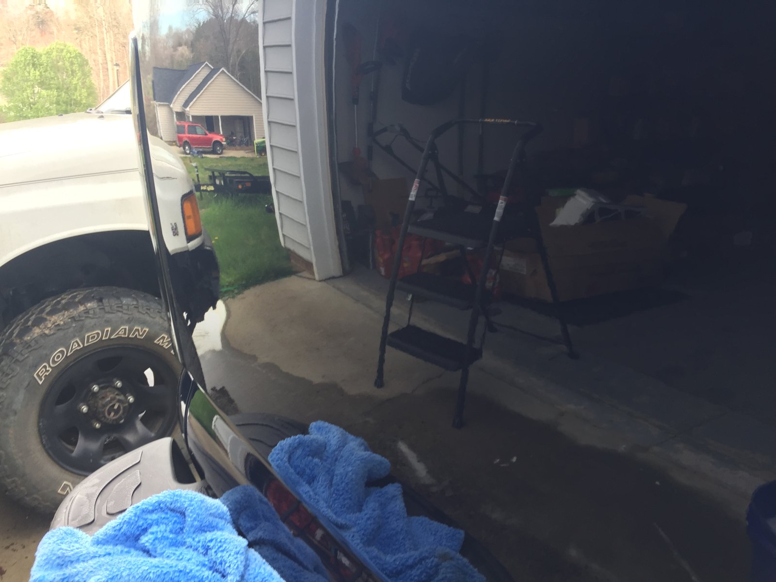

More boring driveway photos for record purposes.

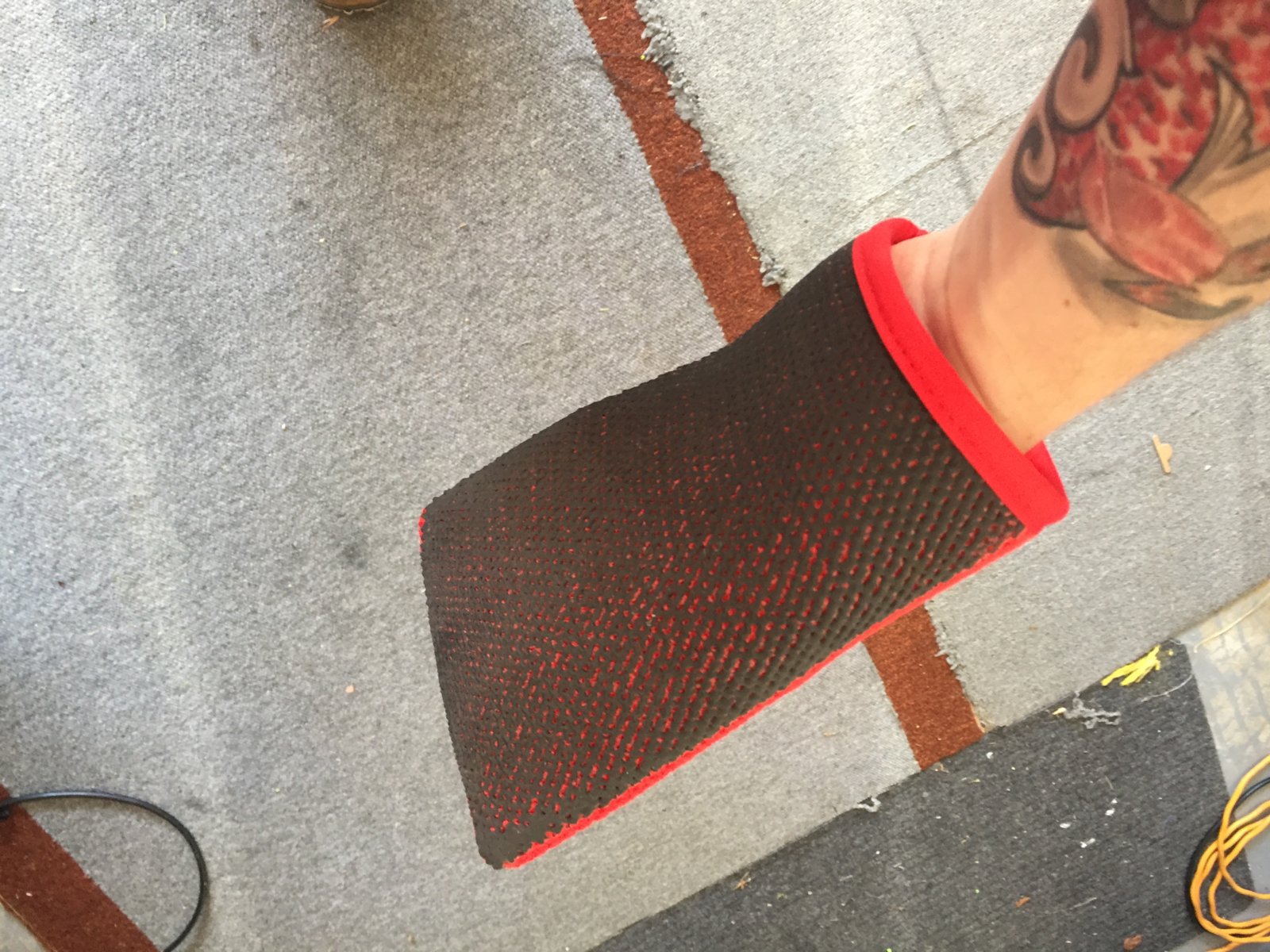

Going to do the rear springs after lunch today so I went out and did a dry wash to get all the pollen off. Then used the Adams clay bar mitt and mother’s detail spray to remove all the trash and water marks from our horrible well off the back windows and and put on a couple coats of RainX.
