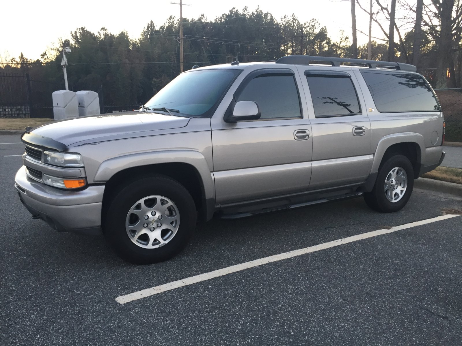

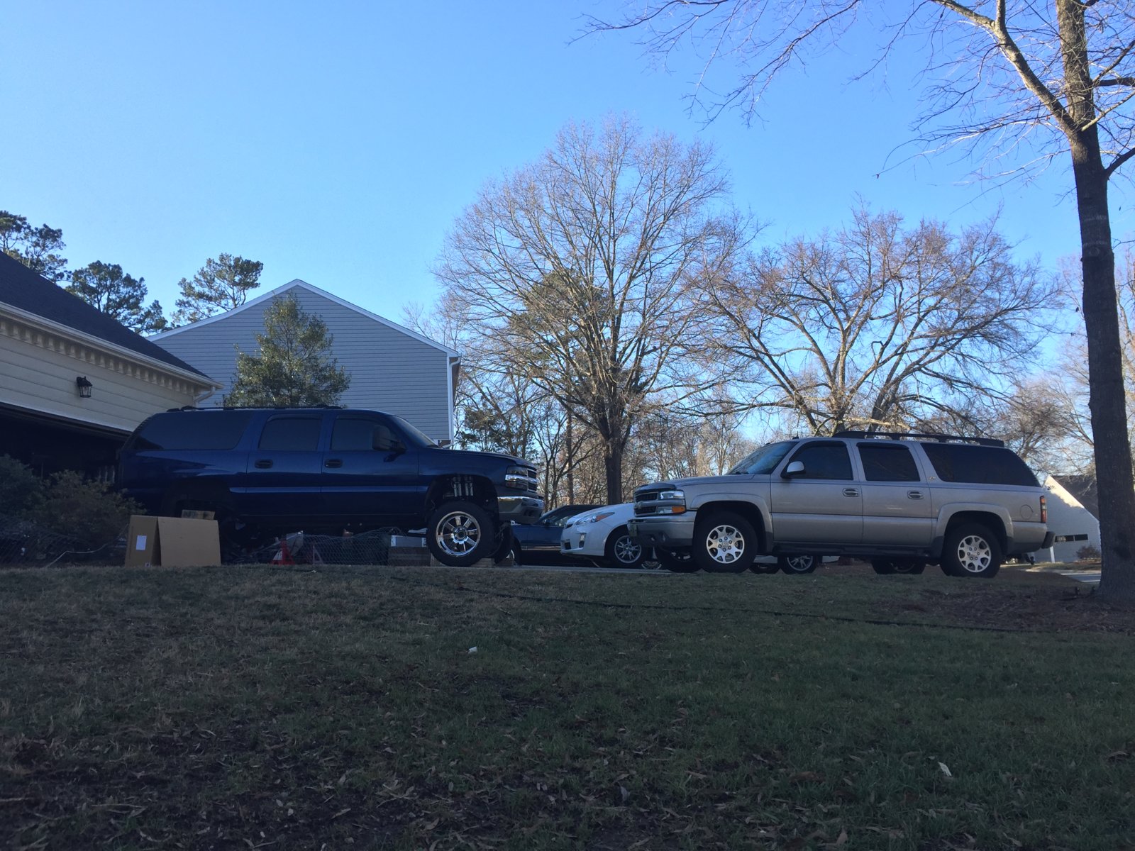

And yeah I should have the suburban back on its on legs in a week or 2, maybe 3. I got a loner 2004 suburban with all the bells and whistle which should be pretty fun to drive until then. Ill grab pics of it later, I’ll be doing 6 low/8hi and LEDs on it for the owner who let me borrow it while I finish mine.

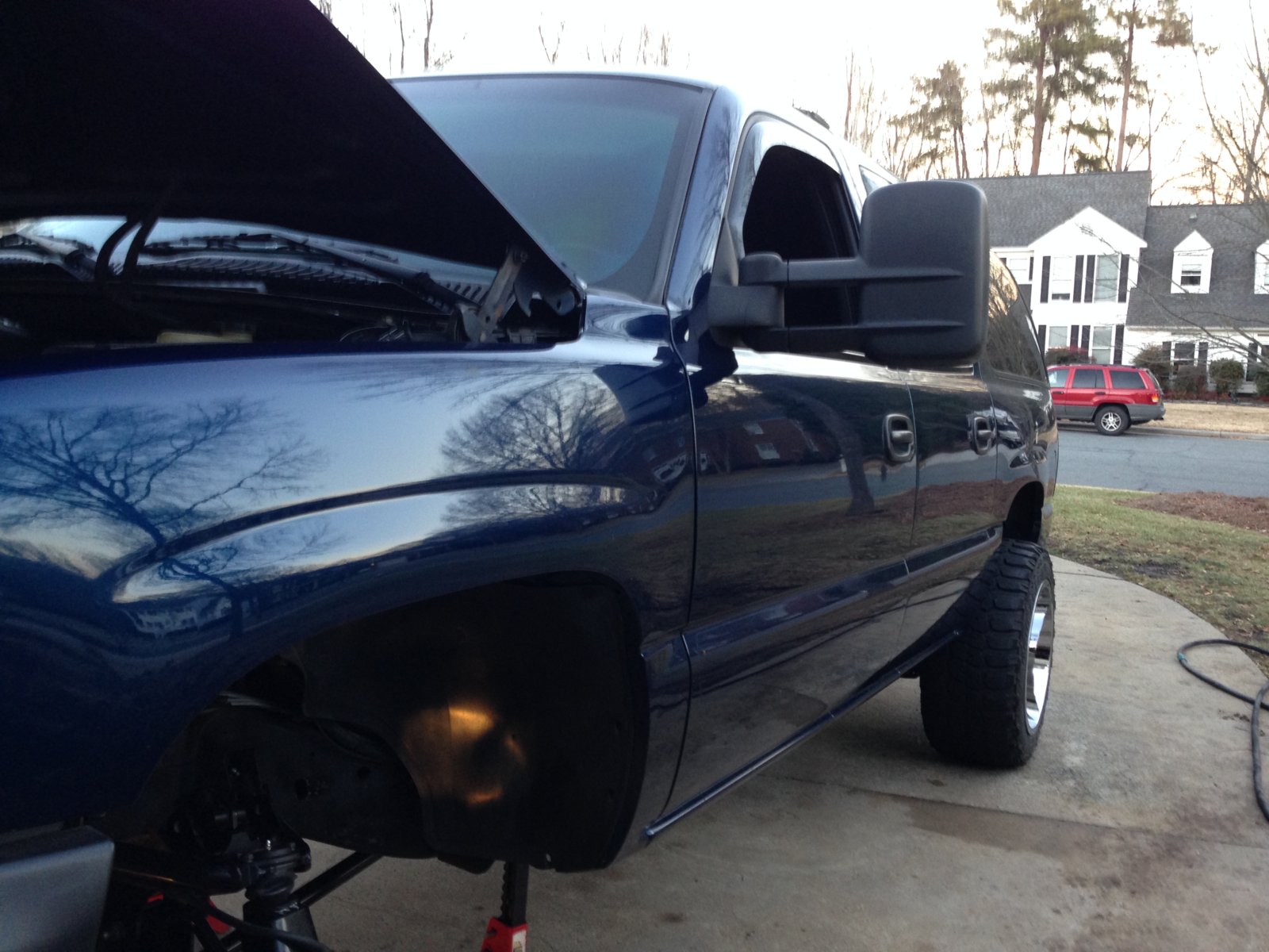

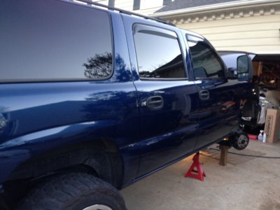

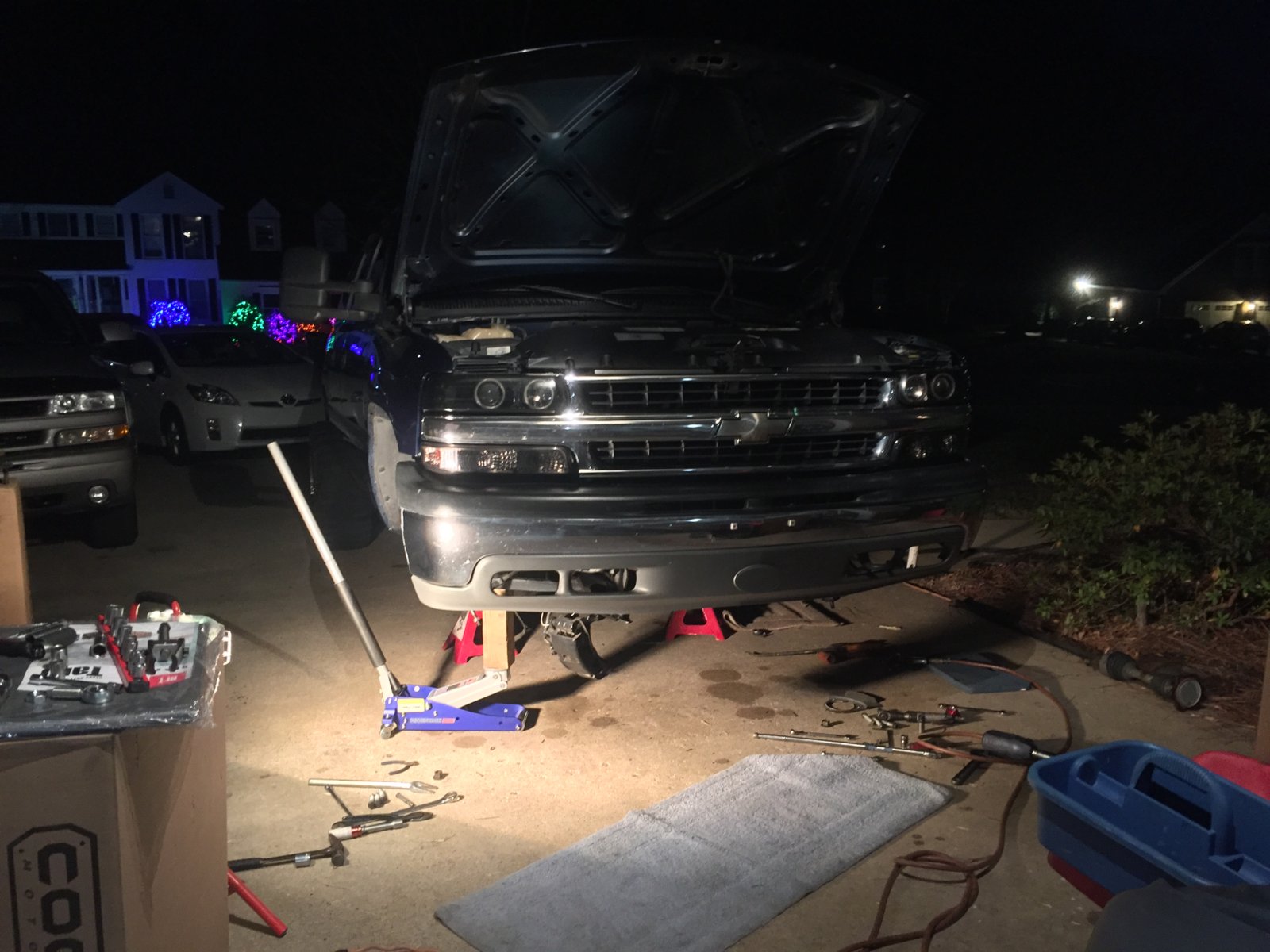

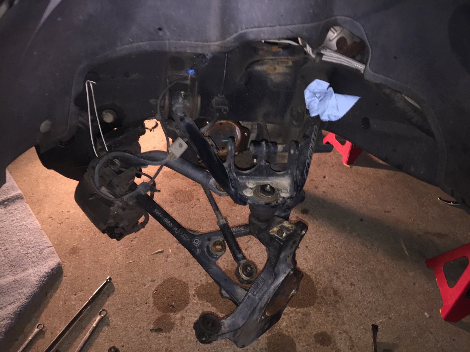

More pics of lift actually going on..
41CF8680-3CCD-4A8E-9134-F8958136E6FF.jpeg A5C959CE-DF77-4F41-BBF5-EA748E98A005.jpeg 7313A06F-2BA9-43F8-8BDC-20A3763B8AD8.jpeg 1666FE16-CD13-4311-A4F7-E5EEA213E4D5.jpeg
00'BlueSteel
00'BlueSteel
May 8, 2015
878
1,371
Carolina
That’s the point that shit hit the fan, lower ball joints would not come out of the knuckle even with heat and 20lb hammer, had to leave each one in the shop press over night with creep oil and then heat in the morning and rapid freeze the ball joint shaft to knock them out with out ruining the arms. Moog pitman arm didn’t fit all the way on the Redhead steering box and put the pitman arm in such a place that the Cognito braces hit the top of the new driver side diff mount. Then the cold came and the regulator on the compressor filled with water and froze, killed on 1/2” impact gun, broke 2 ratchet wrench’s due to the grease freezing inside them, and had to make a view runs to the parts store for new ball joints and new hubs.
At this point the most everything is new expect for the center link and the differential itself. Lol but hey good piece of mind once I get it back that steering, suspension, and trans are all new.
I will get more pics up tonight or the loner 04’ suburban and more steering and lift pics

Can you tell me how you like driving a z71 burb?
Honestly, I prefer my none Z71 2000 over this 2004 Z71. I don’t feel like there is anything I can point out and say because this is a Z71 it drives or rides any different. I think it’s more the difference from 2000-2004. I can say I am not a fan of fly by wire throttle, steering seems a bit touchy, seat controls are a little weird, not a fan of the center console, don’t like the steering wheel, love the color matched bumpers and grille, love the Z71 valance, back end is a little lofty in the corners and body roll is a little much. But the 2000 was like that before I put new sway bar links and keys in. The ride is ok, has 5100s in the front and the keys are set so it is just resting on the jounce stops. I would probably turn the keys up a bit if it was mine and put new sway bars/links on it asap.

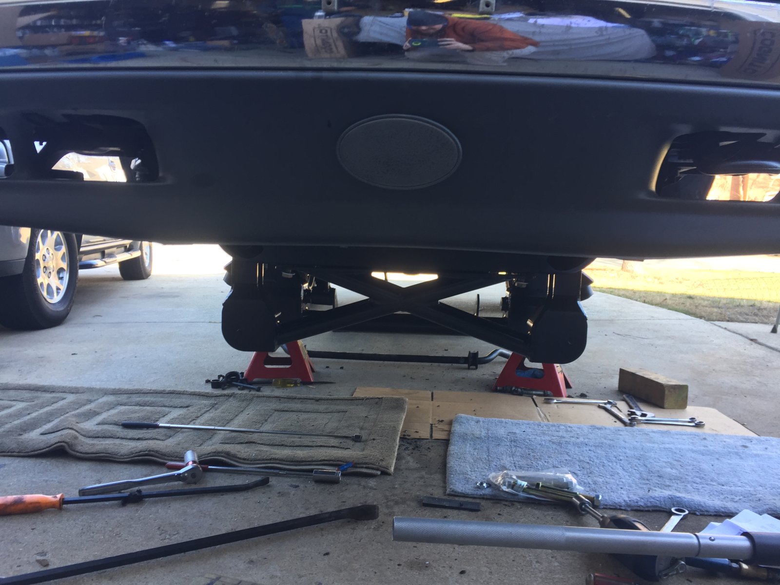

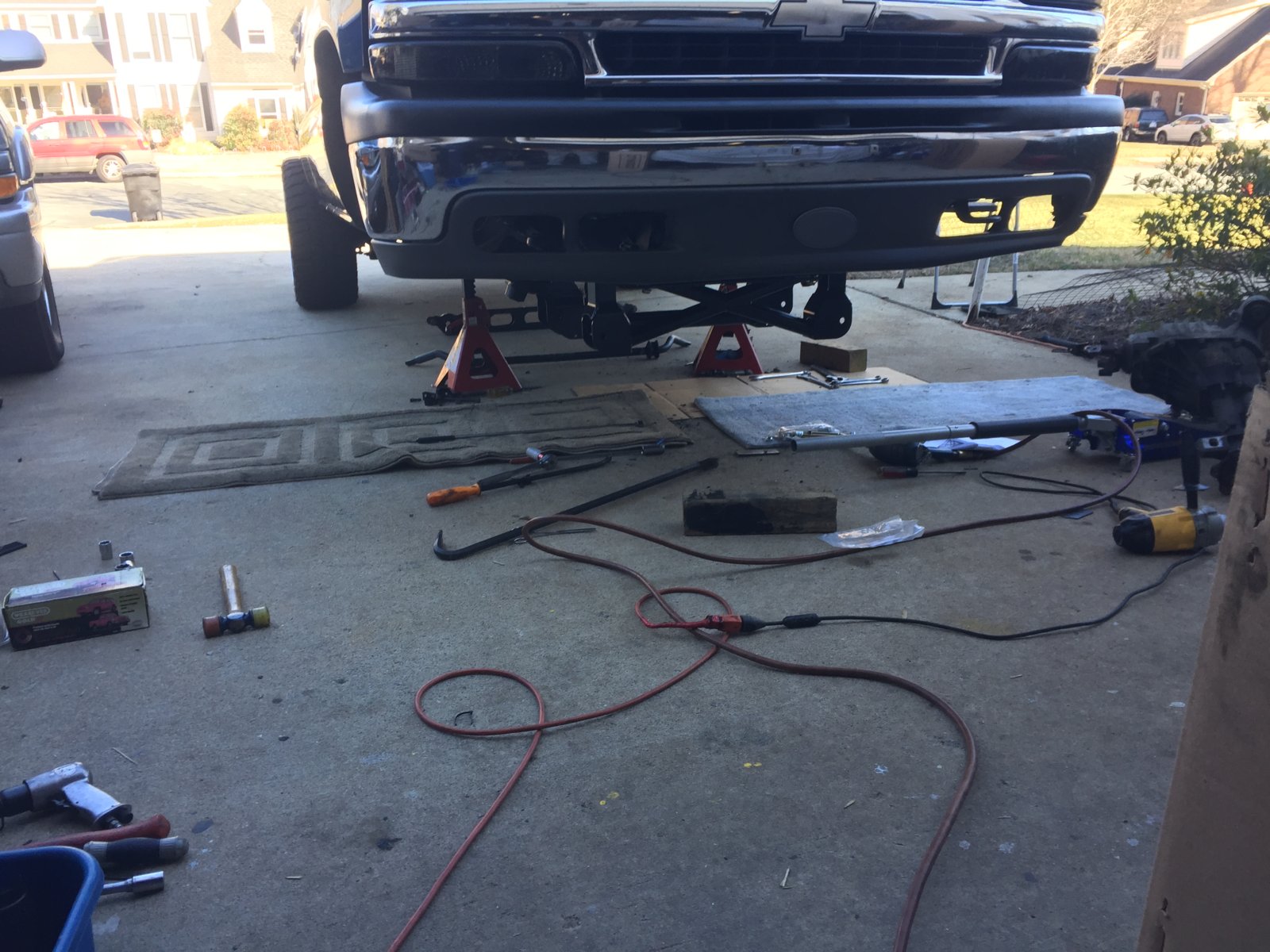

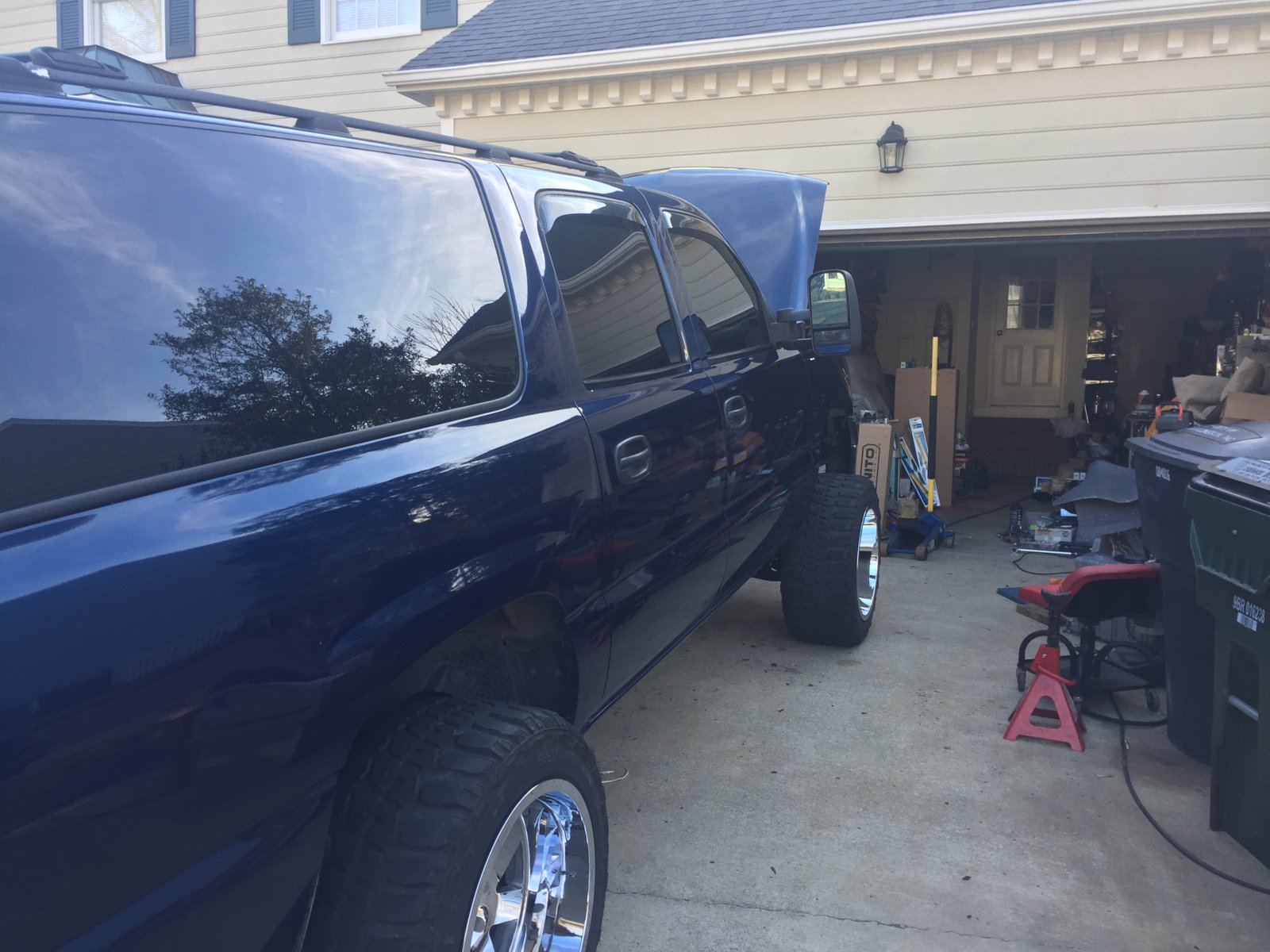

So the suburban is still sitting in my parents driveway, my dad hasn’t really been working on it too much, 1 its freezing, 2 he is in his late 60s and I don’t want him pushing himself too much. I think he has mostly been paint and cleaning stuff. I’m making the 3 hour drive to their place tomorrow when I get off work, hopefully I can finish the kit this weekend.
Got my mom to grab some photos yesterday and not much has changed from when I left it there 2 weeks ago lol. I should have done it at my house so I could be working on it durning the nights but I wanted to do it with my dad since I’m not sure how many more projects we will get to do together.
It’s gonna be big!
8367AB99-6F31-49DD-9C64-D243C65304D2.jpeg 66076BDB-C304-479A-B2C3-2C7A7CA5ABA0.jpeg
New lift knuckle, new hub, new bushings, new upper/lower ball joints, new sway bar links, new tie rods, new abs sensor, new brake lines, and soon the shock hoops and new dual Bilsteins will be in.

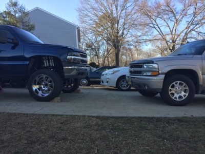

Ac Delco pitman arm fixed the steering, front end is all done. But we found the oil leak with dye and its the front main seal/timing chain gasket so the front of the motor is coming apart as soon as the rear is lifted. Going to do all new timing chain, seals, oil pump, oil sender unit, and spark plugs.
Squat Life!!!
D579602F-CC4A-420D-BCB2-799FB43128CB.jpeg 4DEC6085-A226-43FD-BCAB-C5A8E38739FD.jpeg
