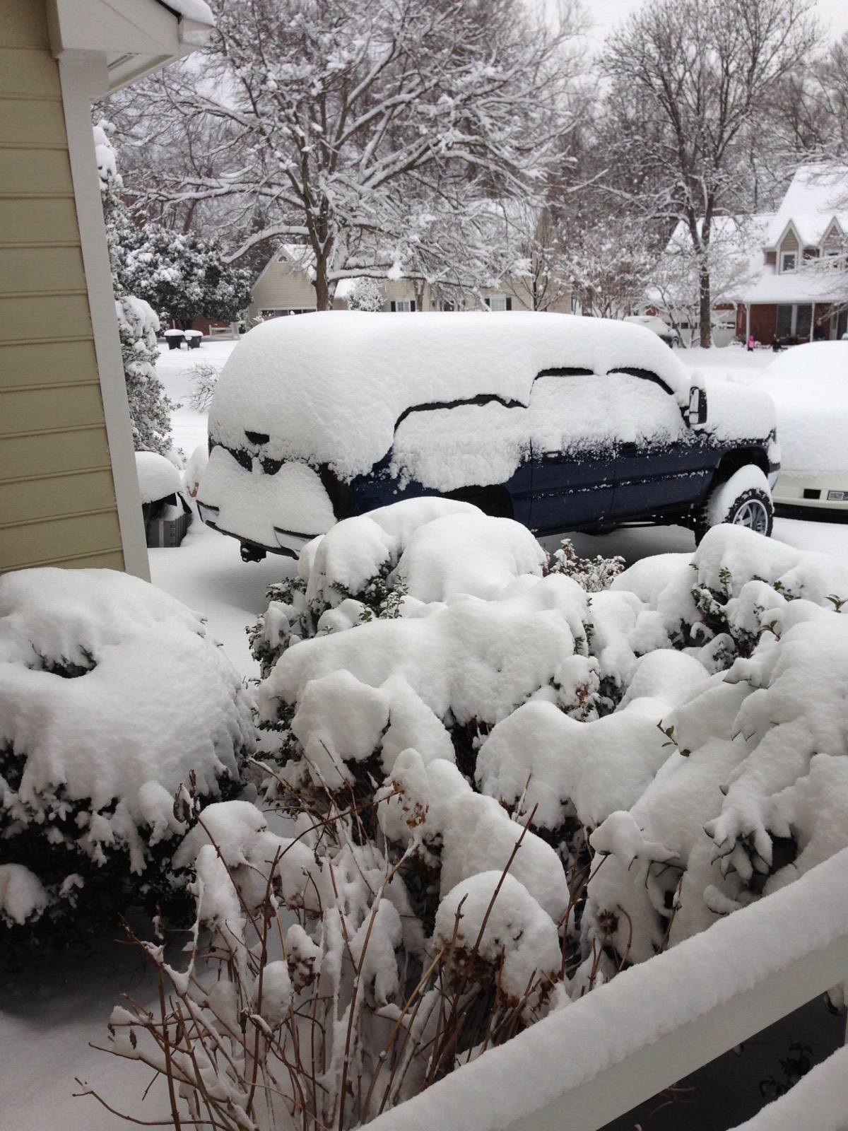

Where it will be until the snow clears! 578B75D9-334F-4783-B05F-F552665D4E29.jpeg

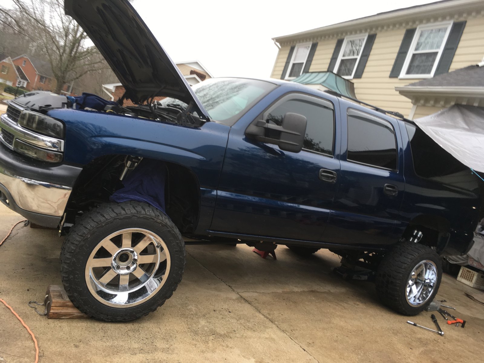

Not the best picture but she will finally be back on the street this weekend at which point I can get some better photos.
Things got a little crazy, going into this we were going to just replace some steering components and slap the lift on. Should have taken a weekend.....
2 months later here is what has been done:
Transmission rebuilt
Rear end rebuilt
All steering components replaced - linkage, gear box, pump, and hoses.
All bushings replaced - this took forever to get done
New hubs and ball joints
New parking brake shoes
New stainless steel brake lines
Got a new battery cause mine died from sitting in the driveway lol
Flushed and cleaned brake system and serviced master cyclinder
Cleaned and painted everything underneath I could find, there are still some minor touch ups but she is looking factory clean on the bottom
Oil leaks have been sourced and figured out. Oil pan gasket was leaking on driver side.
Installed the Cognito 7-9 to with all the bells and whistles
Now just needs an alignment and it’s good to go, and just in time for cruising weather.

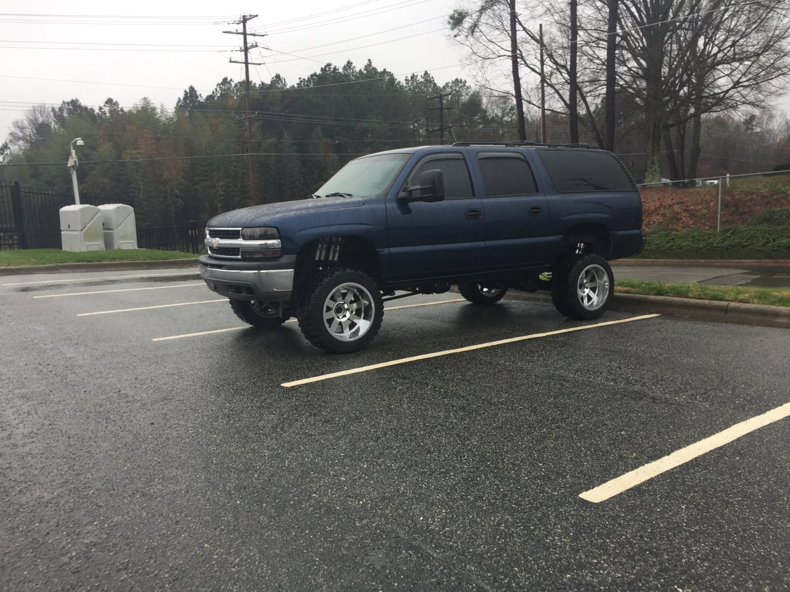

And she’s back, this was from today in the parking lot at work. Crap weather is preventing me from going and getting some good photos. I also want to get the back down a couple inches and finish up some little things before taking a bunch of photos.

Yeah the rear looks a little higher, but non the less looks great!
Yeah, I didn’t know this but the Cognito rear kit comes with a 7” spacer not a 5”. They expect you to run factory rake at 7” or crank the front end to match at 9”. I wanted 7-8” in the front and the back 1” lower.
