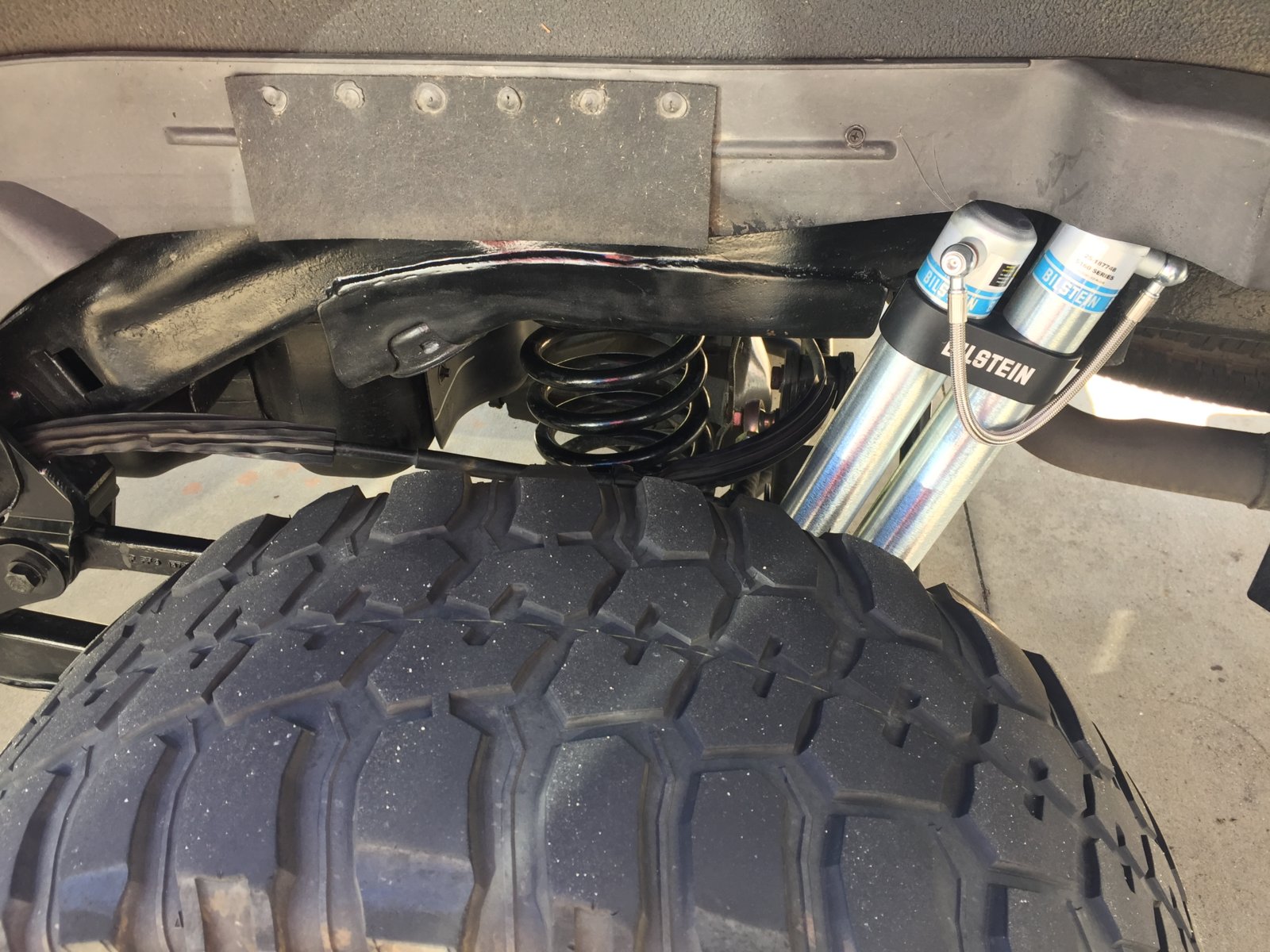

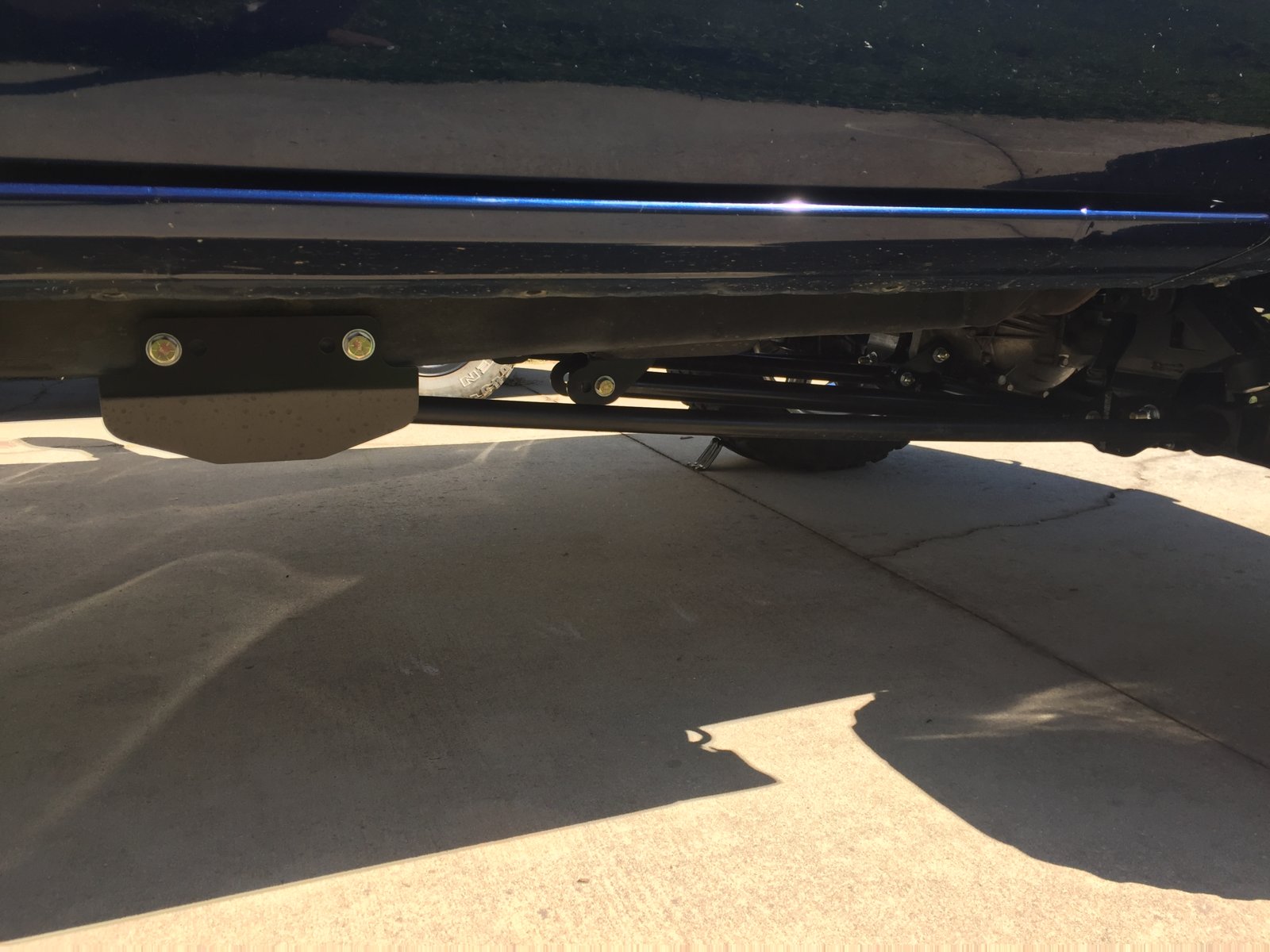

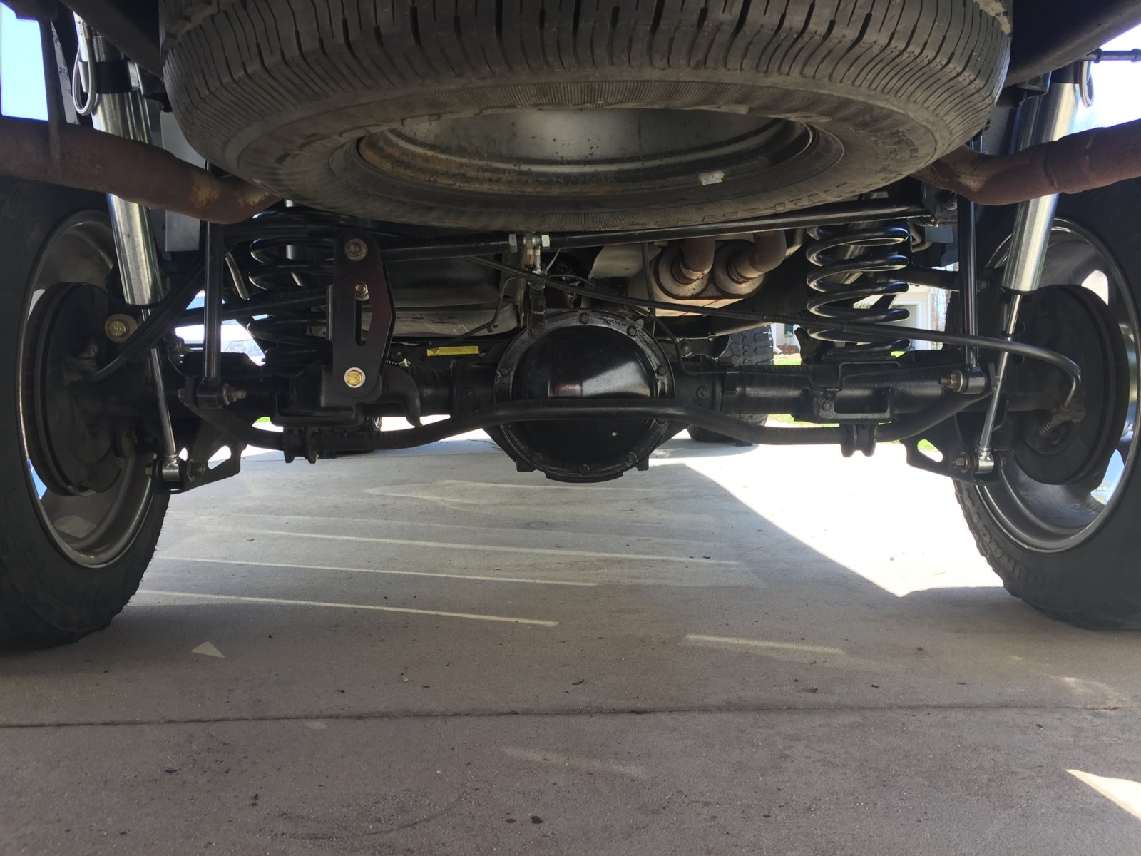

Got the skyjacker 5” lift springs in and the Cognito 7” spacer out. We are now at 43.5” in the back. So I actually got 4.5” lift from the springs. Exactly what I wanted!

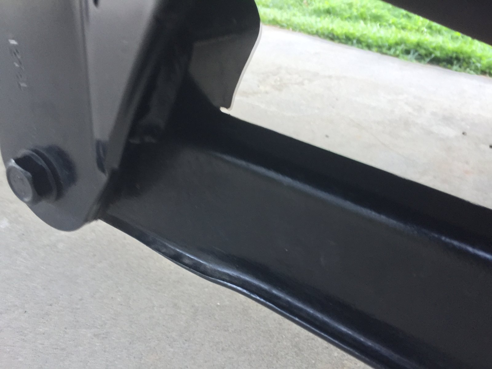

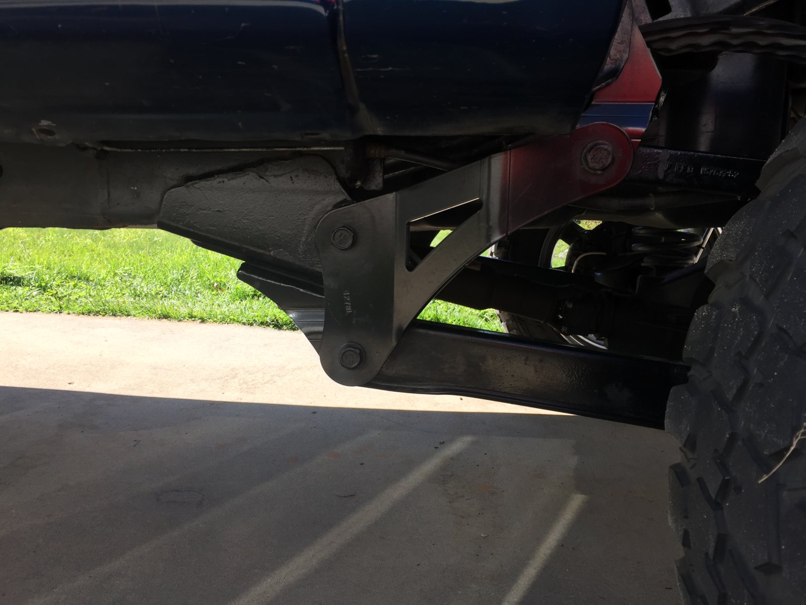

Gotta a little clearance problem here, the clearance for the lower trailing arms is not enough on up travel, since it’s for 7” of lift and I’m at 4.5” now I will have to open the brackets up a little bit to allow the lower trailing arm room to move upward during up travel. No biggie a little grinding will fix that.
