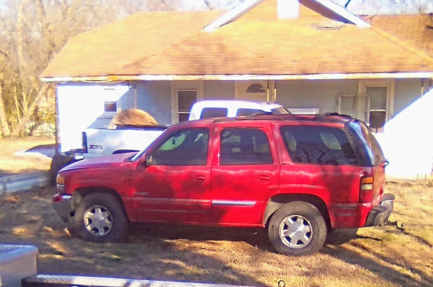

Wow, that's a nice ride. I definitely don't have all that. Mine is stock. Everything's same as it came in 2000 except starter, alternator, the basic fixes.

This is Bertha
