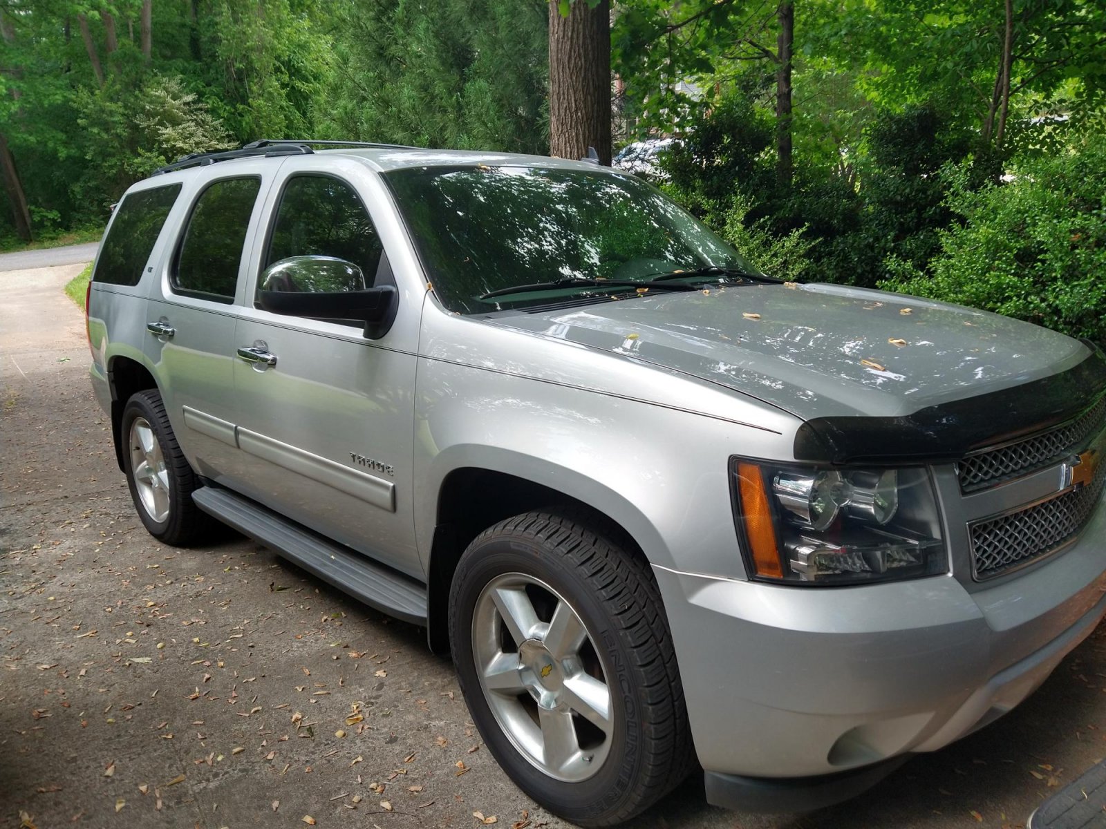

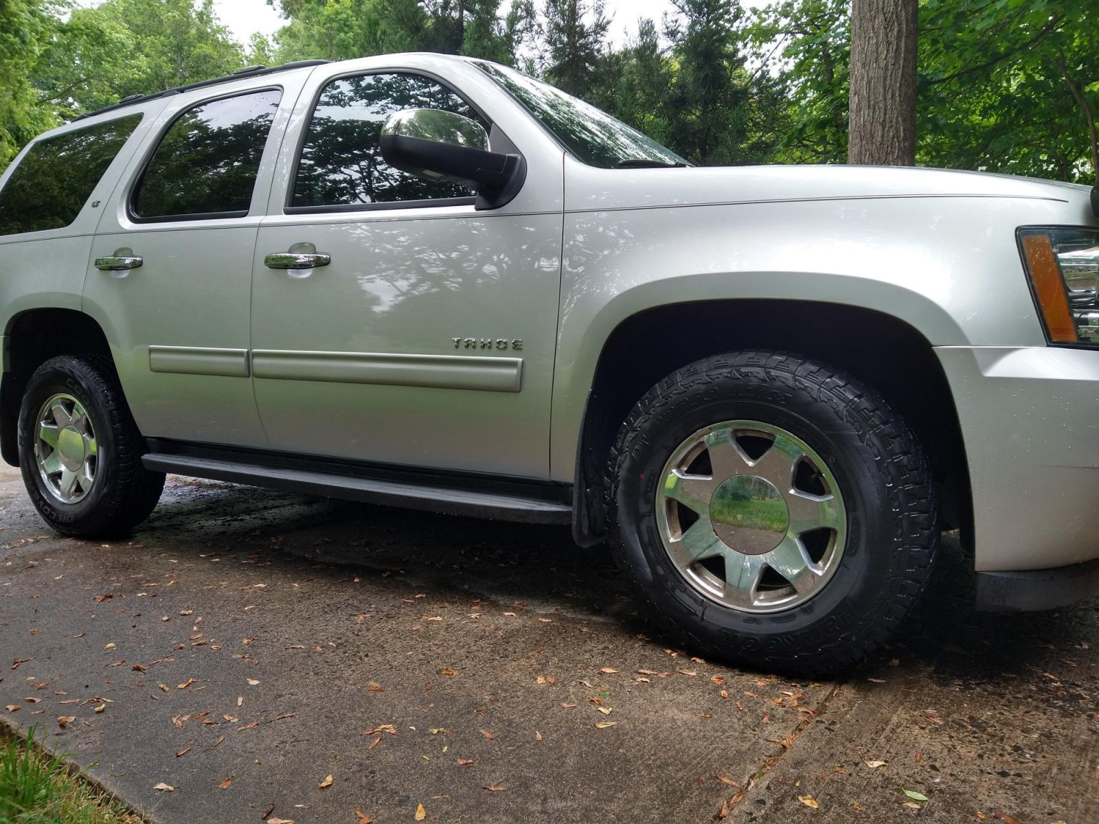

Finally got this deal wrapped up Thursday afternoon and got the truck home. Got the wheels swapped yesterday.
Yes, the 17" fit on a 2012 in place of the 20". The 17's have 255/75 and the 20's have 275/55. The rolling distance was exactly the same, so the speedo is good, not recal needed.
So right now, the only short term downside is ive temporarily given up my TPM's left on the 20's. When things slow up, ill get some TPM's and drop the rig off at the tire store to have them installed.
Honestly, I like the style of the 20's better, but im a function over looks kinda guy. This rig will go off road, so id rather have the taller sidewall. Overall, I think the rig looks better now. Heres a before and after.
Oh, if anyone wants a set of 20's with a fairly new set of tires, ill make you a sweet deal! Just note though, they come with a 2003 Tahoe attached to them, lol.
View attachment 369888View attachment 369889
looks good. I like the 17s for sure. I'm definitely itching to make the switch as soon as I can sell my 20s.

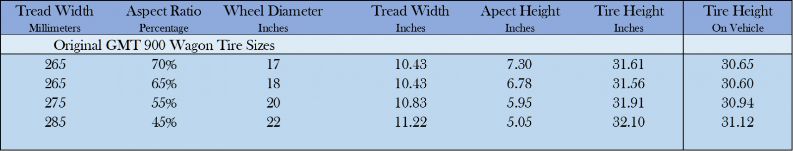

i just switched from 265/70/17- to 275/55/20 and the 20 is physically nearly 3" taller. so my rig is up 1.5". in my case the ride is way better. and the 17"s are the stock size. Curious....

GMT900s are equipped with a 265-70-17 spare tire.
This is in regards to an earlier reply in this thread:
A P265-70-17 and P275-55-20 are functionally the same size tire height wise. GM considers them the same.
