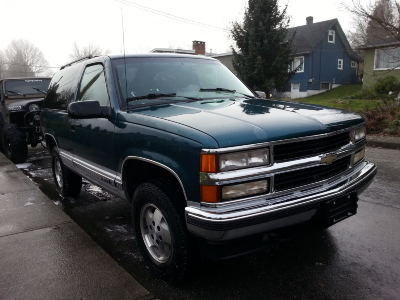

with 10 grand in hand from the jeep part out i bought this 1995 2 door tahoe
she was a little rough but i only paied 1000 bucks for her.

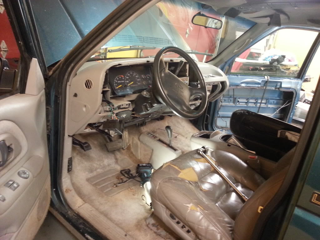

started with the interior . getting rid of the nasty
did the hippo liner thang

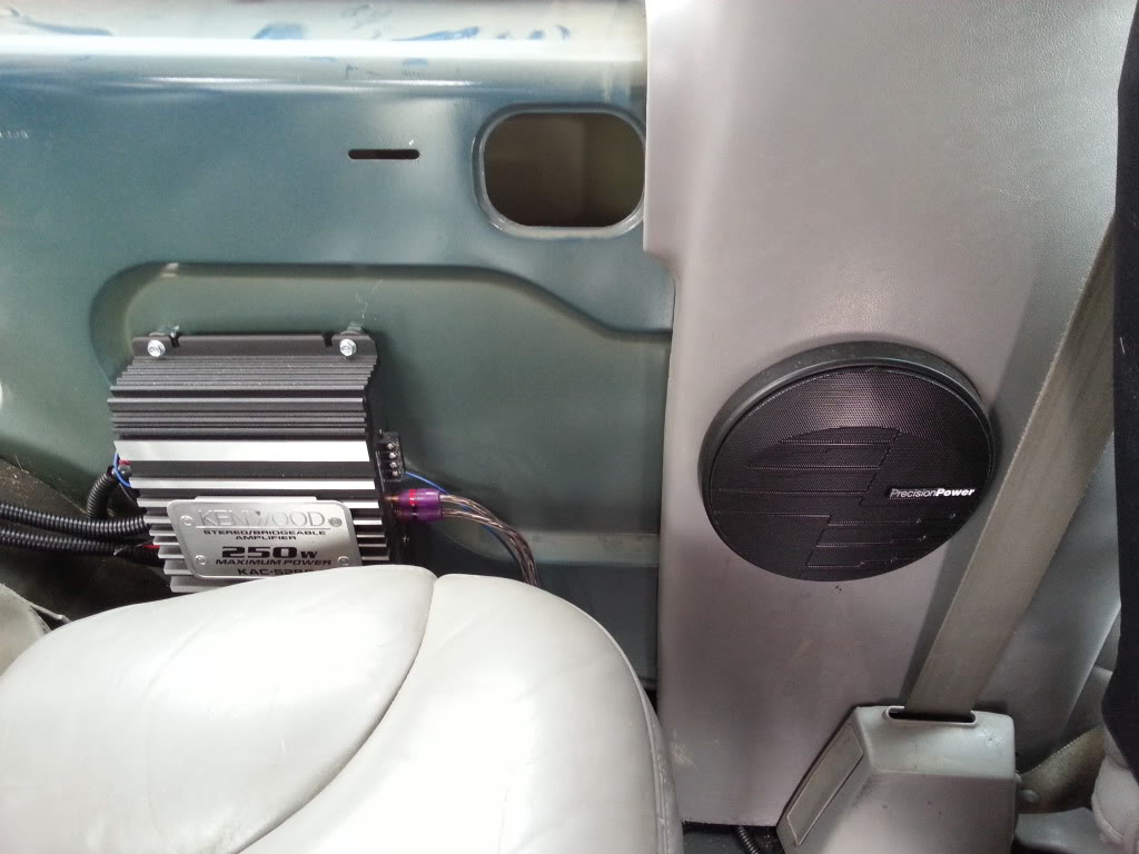

then went to work on the audio
did 4 6'' ppi speakers with remote tweets , upgraded the roof 4x10s with some pioneer 6x9s and couple of 12s for the bass. also added 3 amps behind the panels for a nice hidden and clean install

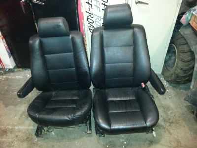

some bmw leather

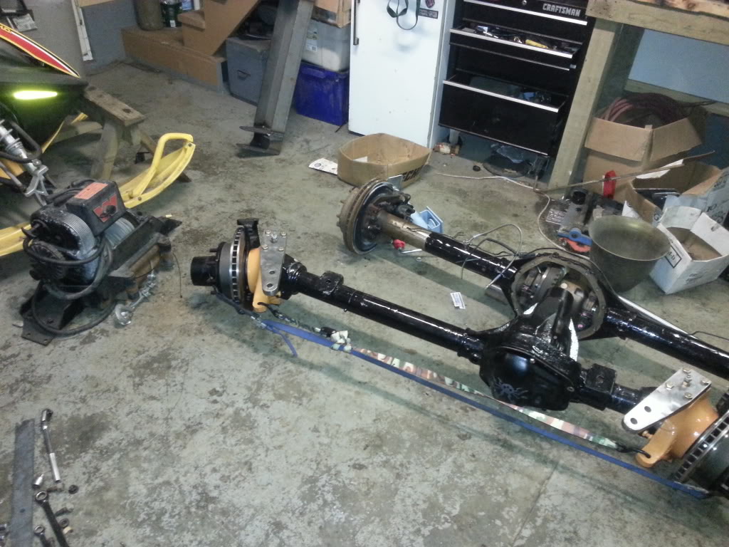

drivers high pinion king pin dana 60 for the front
hummer h2 rear end with nice disks and a e locker

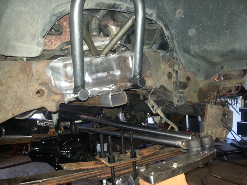

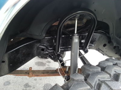

the front hanger that comes with the sky kit was pretty sissy looking so we beefed it up some
then went to work installing the h2 diff in the rear

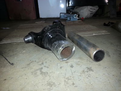

had to modify the 60 just a little bit
did a cut/turn and sleeve to move the spring perch in a little bit so i could have full range of steering
just like it never happened
installed and guset of the front hanger
shes getting there
shock hoops and high steer
abs delete
and way to big....the idea is low as possible for better cog
sooooo after messing around with the leaf packs front and rear and by moving the front axle forward 4'' and the rear back 2'' we were able to get her down a little lower and most important level too
total lift is 5'' and she rides nice and soft...
