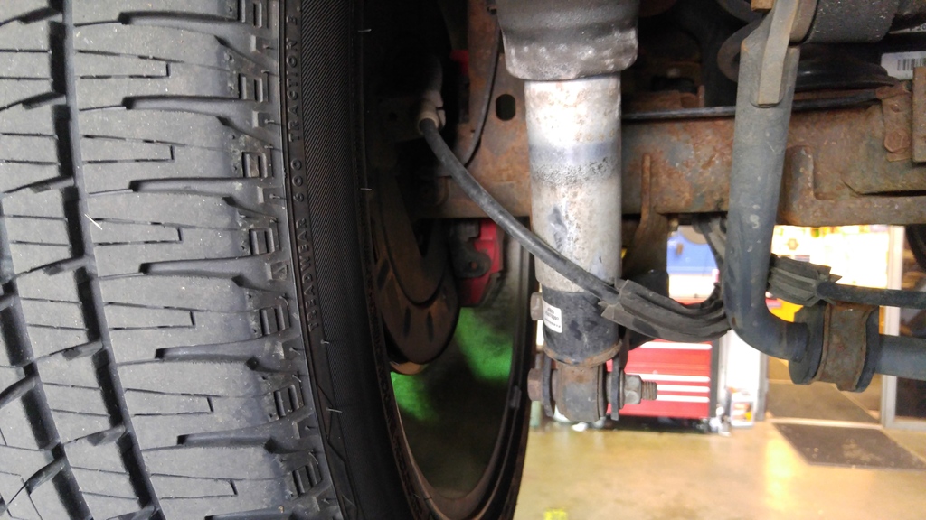

After 8000 miles my ebrake cable is rubbing on my shock. I assume I should route this differently. What did you all do to avoid this?
I also tossed a bushing as my sway bar came unbolted on one side. Any recommendations on where to get one to replace it?

Remove bracket holding line on axle and zip tie to extender bracket
On auto ride minor rub is normal and notjing will get damaged if you do what I said above

Beautiful, thanks Tony. I obviously should have done that from the get go.
