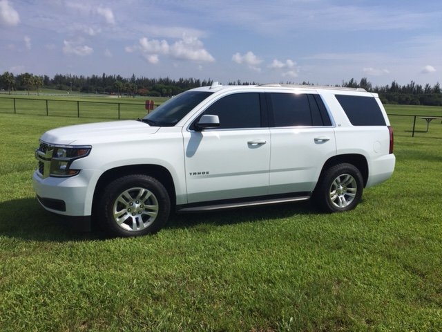

I have a 2016 LTZ and it appears to have the same stance with the rear lowered. How can I tell if a lowering kit was installed?
s_kavert
Oct 28, 2013
Thanks for the info! It doesn't look like I have the shock extensions. Just the factory shock mounts. Is there another way it could have been dropped? My Tahoe sits level and it's definitely not lifted in the front.

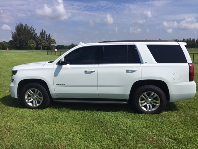

Mcgaughys 2" lower kit in the rear only. Rides way better than stock.

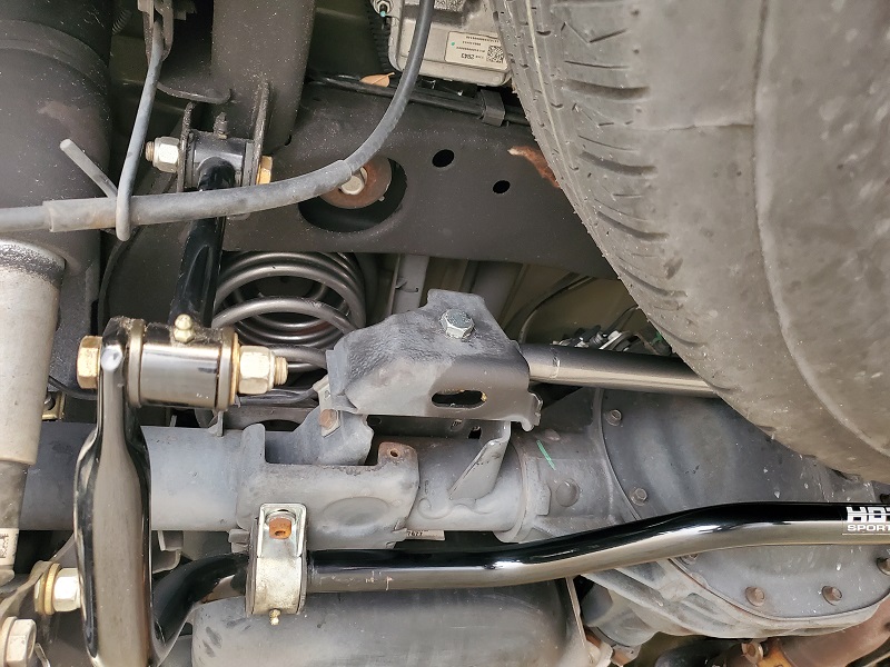

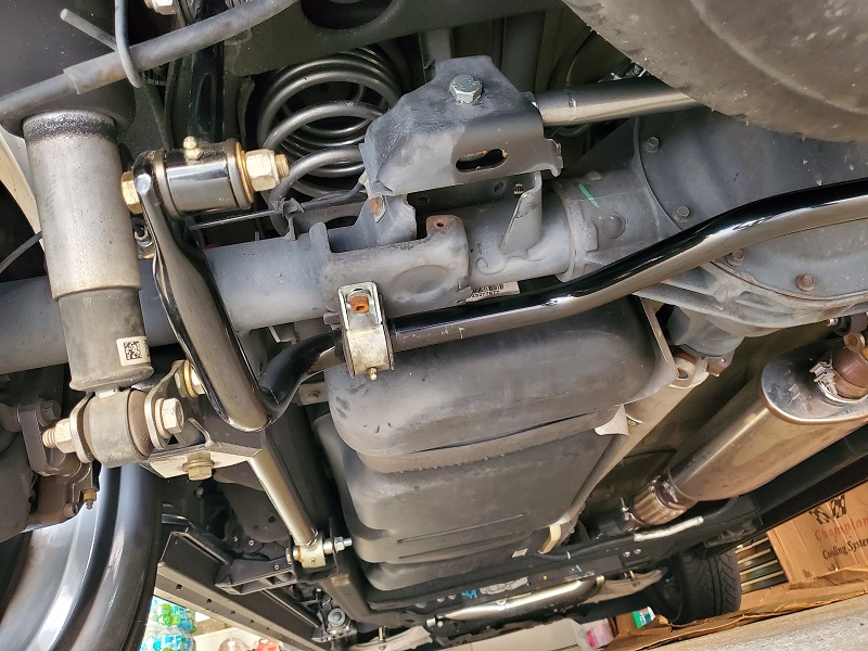

Looking good indeed. I dropped my rear using springs as well. Up front, I swapped the spindles.
Switching springs for a level ride is the way to go.
