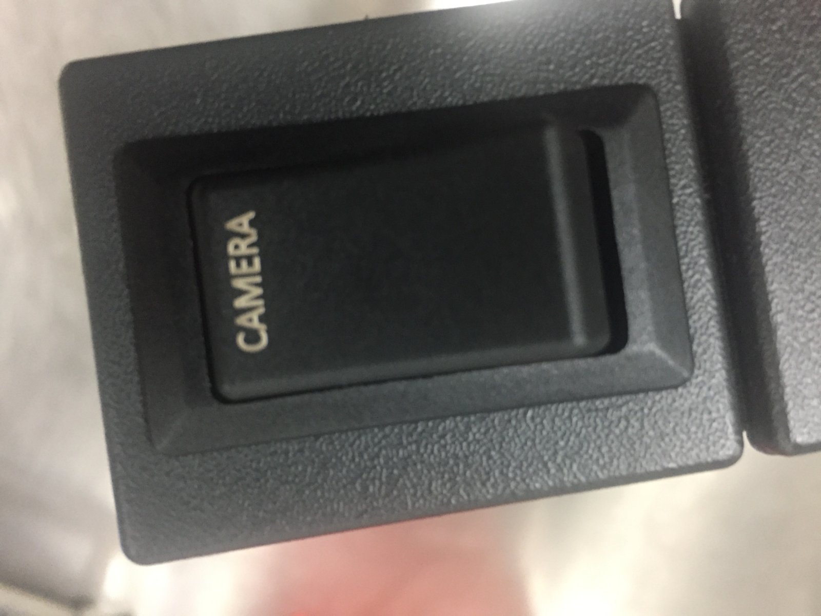

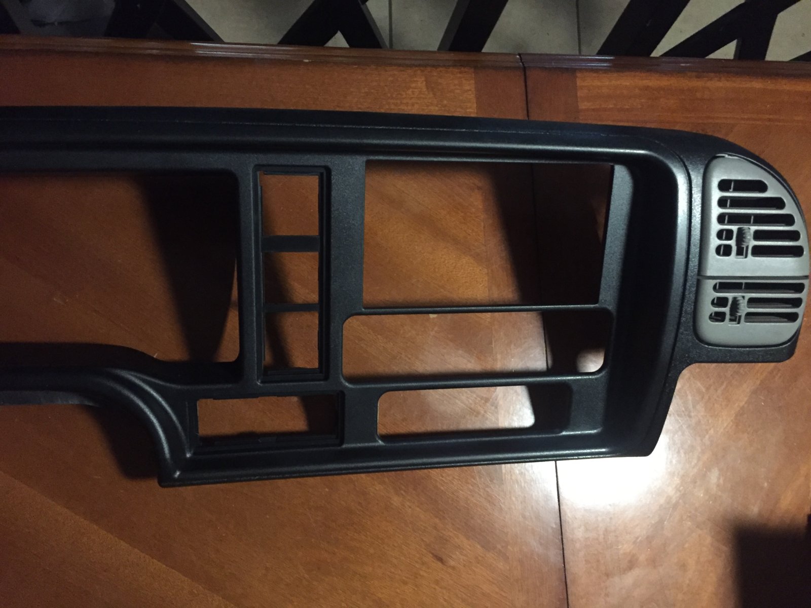

Since everyone likes pics. I used the mantra dash kit. I moved the climate controls down 3/8. Used a flush mount usb at the lighter location. (Made up an overly complicated piece on the lathe for the back side that no one will ever see.:) ) had a little fun with the laser marker on the switch to put in the dash

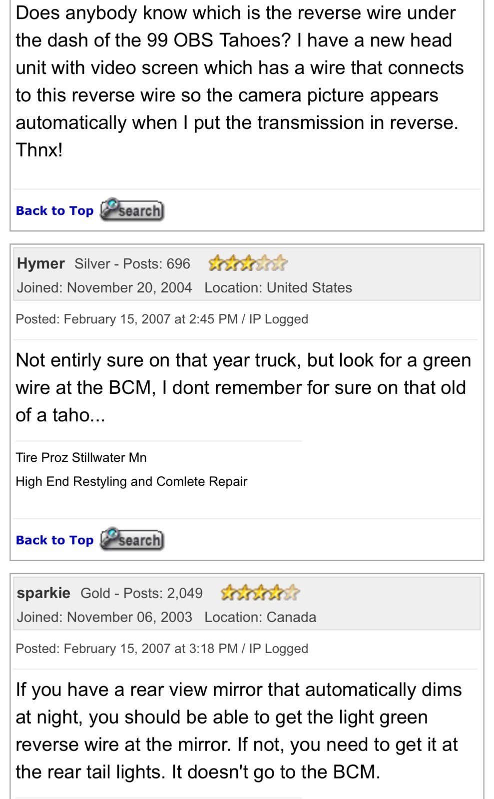

I know on the nnbs its a blue wire out of the bcm which is in cab on firewall to the left of brake pedal.... 99’s gotta be close to that. 2 diff scenarios here but maybe this will help you.

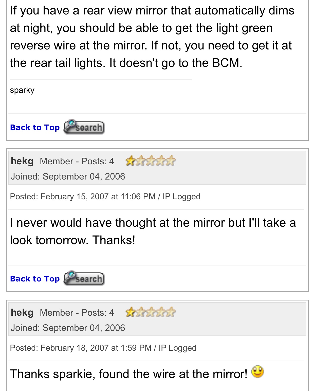

I think my 99 predates that. I ended up just running the wire all the way from the back clipping along with the camera wire. Works really well.
