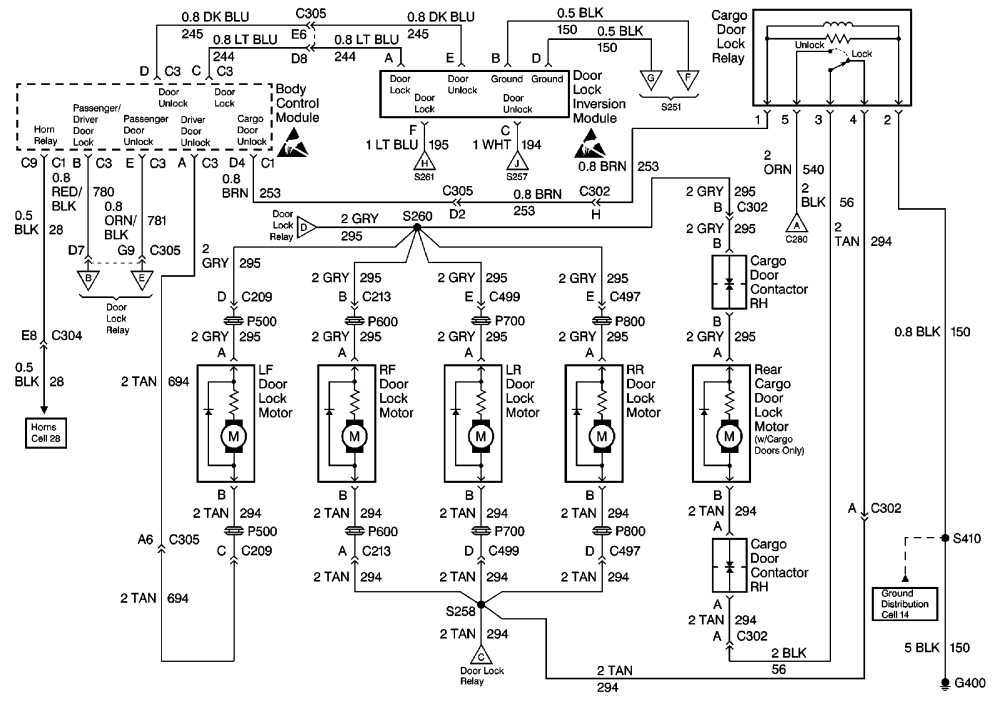

First verify your theft light isn't flashing. A Tech 2 or similar would really help you here also. Link-https://www.autozone.com/znetrgs/repair_guide_content/en_us/images/0996b43f/80/24/b8/74/large/0996b43f8024b874.gif
Thank you for your reply. As the title says 1999. Yes I have a manual. But the manual doesn't give this kind of information. sometimes the light flashes and when I open the door (locks didn't fully engage), the alarm sounds. Other times I expected the alarm to go off when I could open the door, and it didn't. I've yet to be able to reliably reproduce the identical combination.
And thank you for the wiring diagram. I will endeavor to read, study and try to figure it out. Perhaps you could explain how to read this? Or perhaps you could point me to the instruction sheet for the diagram. Or maybe someone could answer my question with more end-user friendly information??
