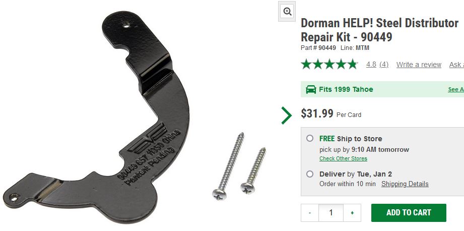

Hi everyone my 1999 4dr tahoe with 245854 miles on it is getting 17.5 miles to the gallon. Freeway of coarse. I was getting a p0307 code it would come and go. I pulled the 5&7 plug. 7 plug was black in color like it wasn't being used. 5 plug was normall tan color. Next I went to the distributor cap & rotor I got one screw out and the cap came out with it. The other screw wasn't working the hole was broken out in the distributor. The cap was tilted and not hitting the 7 post. Installed the fix it plate. I just did another gas milage check this one was 16.8 miles to the gallon. Before the fix I was getting 11 miles/gallon. Thanks for reading.

It attaches under the distributor with longer screws that go thru the cap. It's just a little metal plate I got it at orielys.
Something like this?
