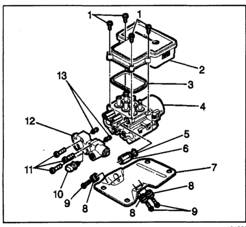

Old booster was turned in for core charge at the local NAPA. I think it was coincidental that my pedal went soft changing the booster. I didn't get a chance to swap the ABS module, but I tried something else. I'm not saying this is fix for every low/soft brake pedal either, but it made a big difference in how my brake pedal feels. I simply unplugged all 4 electrical connectors. I started the truck, and now have both ABS light and BRAKE light on, witch haven't been on at all. This made the biggest difference in pedal feel to me, I would say 75% of what it was before I started having any problems. No, this didn't fix anything, but it did make the brakes feel a lot better, and makes me more hopeful that changing the ABS module will fix my problem. Just a quick recap, I think I had the low speed ABS sensor problem. My brake pedal with the engine running will go to the floor. I've bled it with scan tool, sliding the tires on loose gravel, and bled again. Unplugging the ABS module made the biggest difference in my particular truck as far as brake pedal feel. Yes, both ABS and BRAKE lights came on, and yes you can lock the wheels up at will, but the brake pedal doesn't go to the floor like there's nothing there. I'm going to try and swap the module tomorrow night, and hopefully, that fixes my problem.
east302
Dec 21, 2016
1,686
1,681
Mississippi
Just curious - are you just swapping the module (black part with Kelsey Hayes on it) or the whole thing with the valve assembly and combination valve that the lines go into?
Since it is improved with the module unplugged, do you think the issue is with the controls rather than something mechanical in the valve portion?
