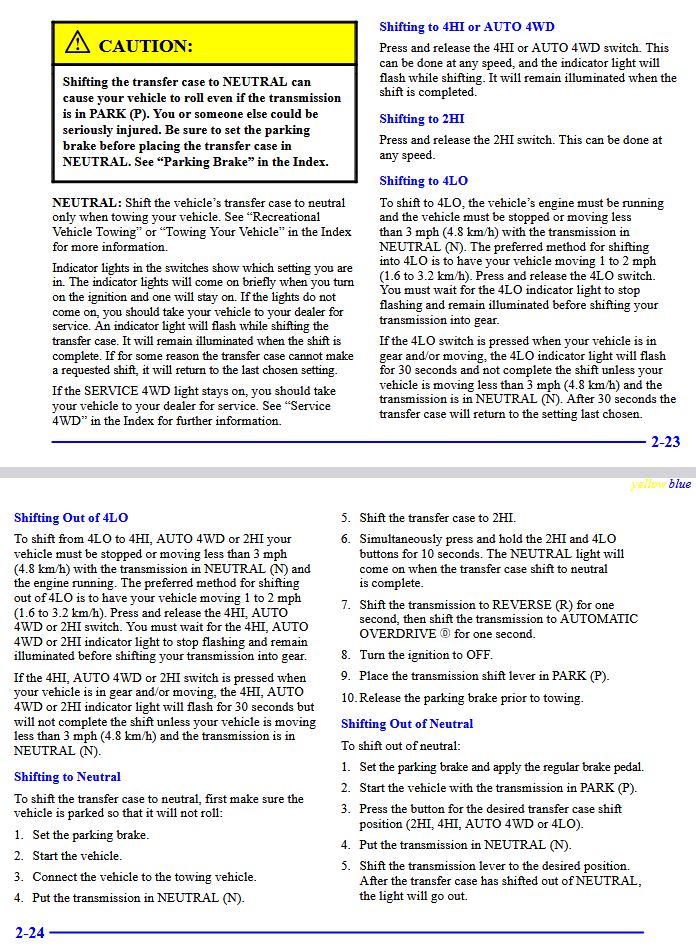

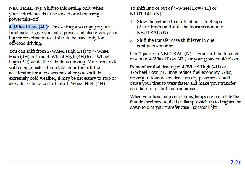

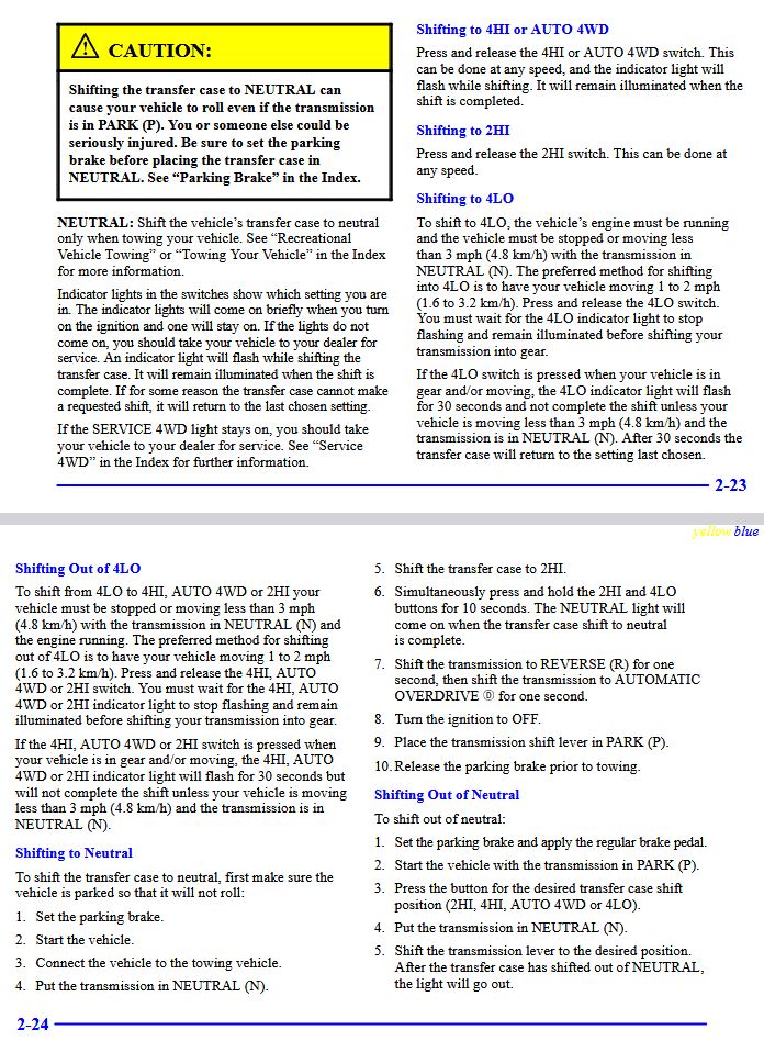

Here's where the procedures in the owner's manual might help, available online for free from the Chevrolet web site. Get yours today! If it doesn't engage properly using these steps (depending on Auto or Manual 4wd), seek help from a drivetrain specialist. ;)
Manual system procedure:
AUTO system procedure:
