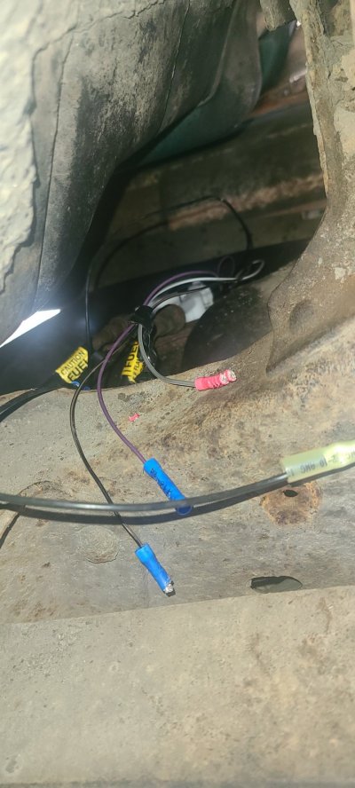

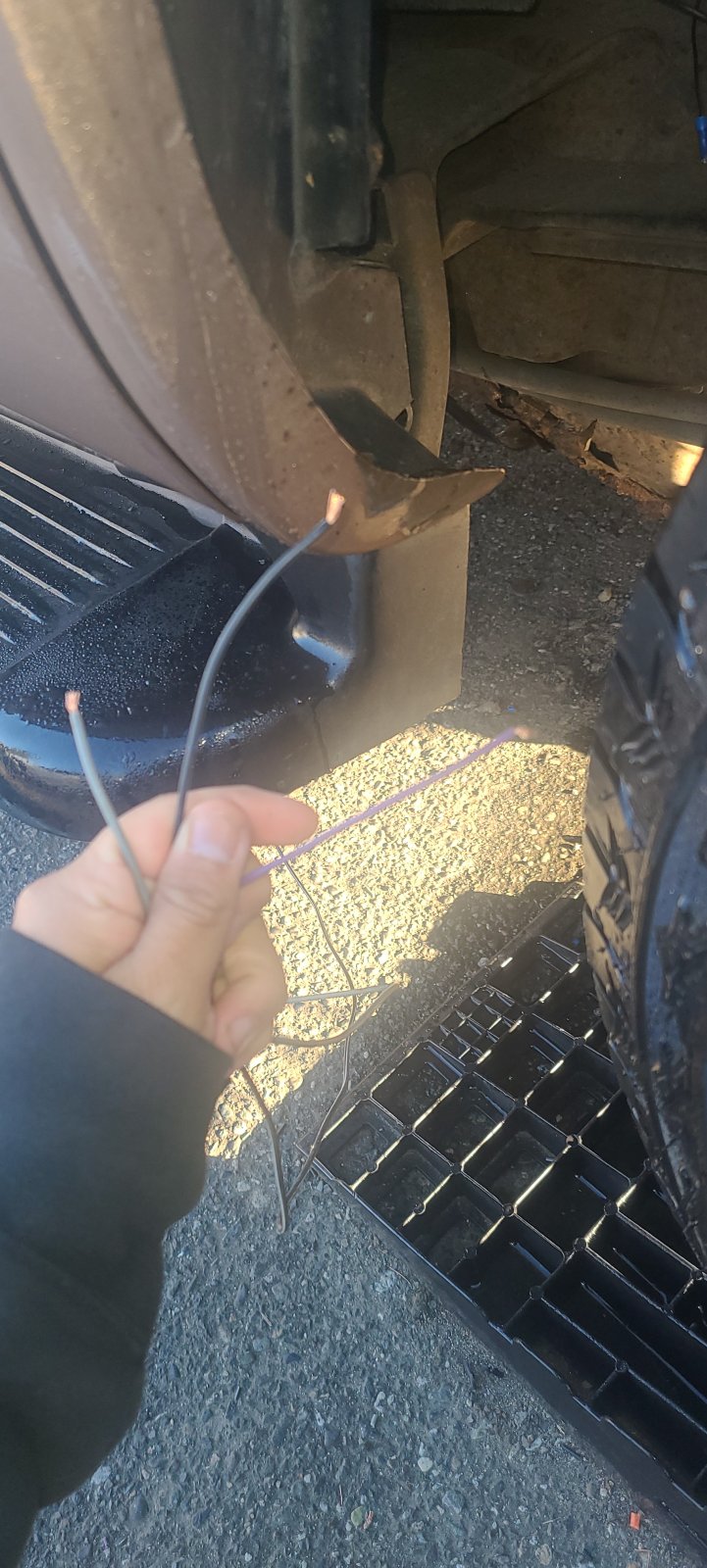

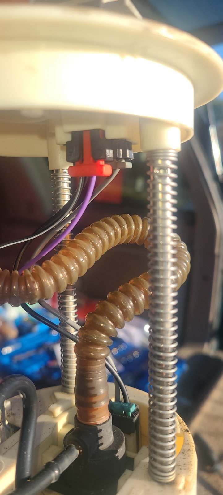

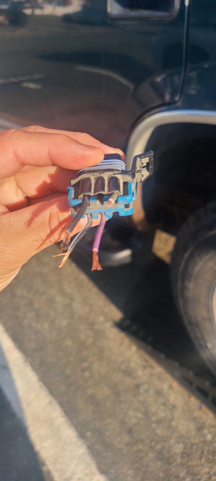

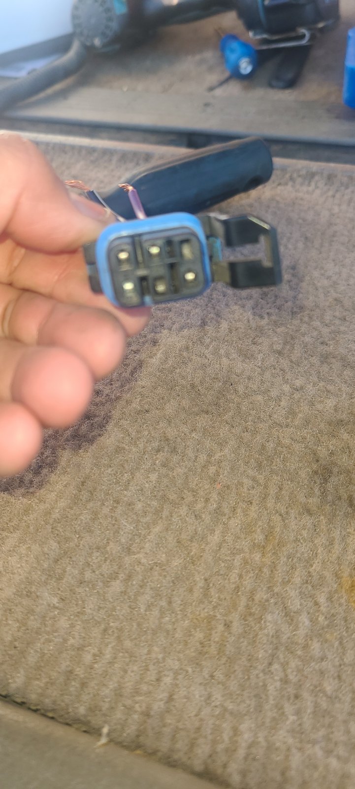

i have checked ground straps they r good replaced crankshaft sensor n fuel relay fuse when i connect wiring to new harness matching colors pump comes on n fuel sprays out the front under the hood and fuel gauge goes passed full on dash but there is not a full tank if gas and when i follow diagram on paper pump does not come on n fuel gauge works i need help with wiring n also figuring out what else could be the problem my truck is cranking but no start ? 3rd pic is wiring from front of truck n 4th one is wiring from pumps new harness thicker black wire is solid connected to thicker black wire on new pump grounded

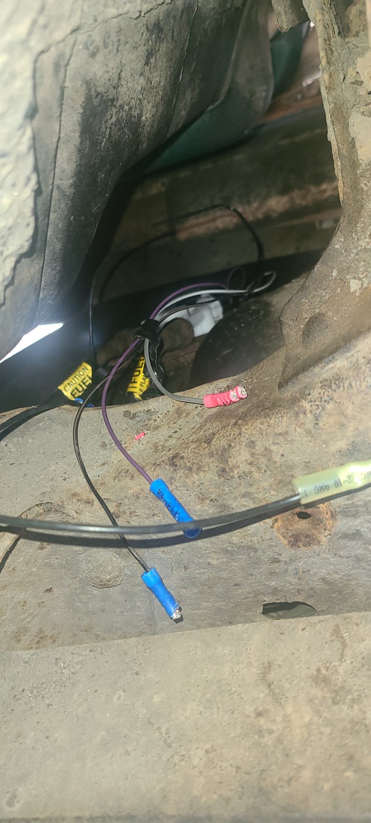

old pump worked hooked directly to battery n on old harness connector shows wiring a,c,e,f but on old pump itself shows a,c,f,d where wiring goes

Fuel pump relay and oil pressure switch in circuit. Wiring diagrams ars here-
