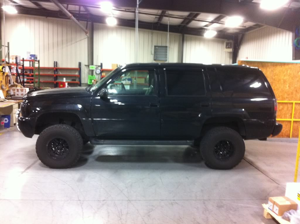

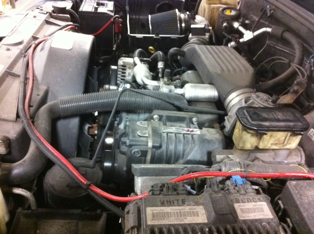

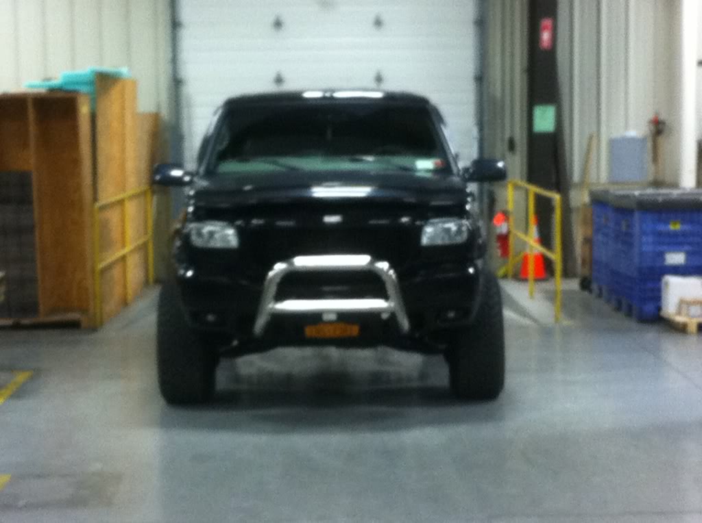

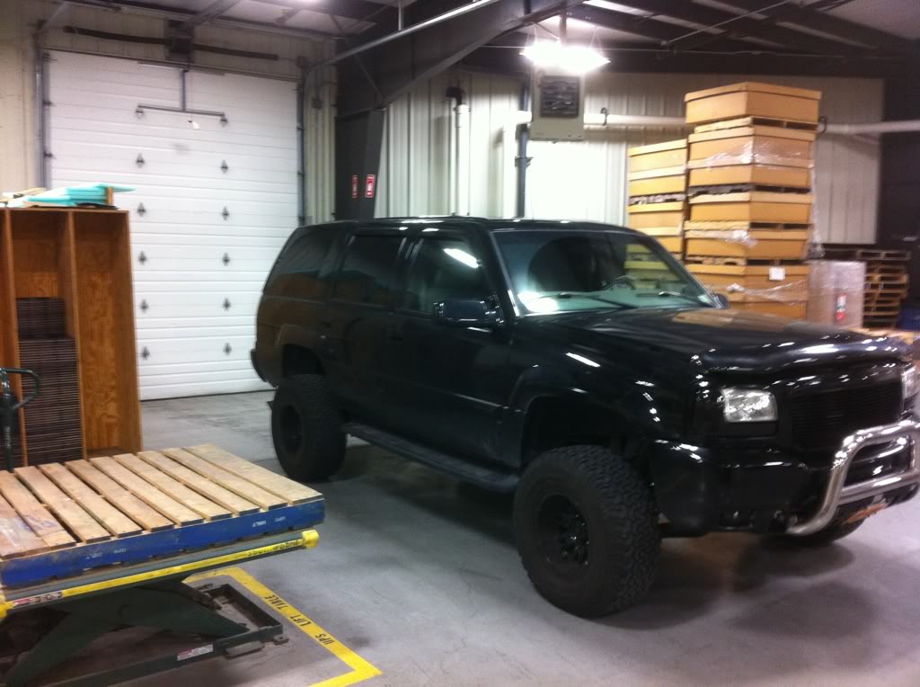

shes dirty but here she is

That is a nice looking truck. Obviously a lot of TLC went into that rig.
Only thing I might change is the color of that push bar, it sticks out like a sore thumb. Kinda looks abit like a beaver tooth. Might look better painted black? Just my $0.02.
However, you can't argue with forced air. That's king of the road stuff right thar.
I'm so green right now..... :drool:
I'll bet you can't wait to start modding that!
I'd do efans, UD pulleys and a BBtune asap!

Great looking rig! Looks like the front end has been converted.

I know what you mean about the chrome bash bar but its grown on me. I also have a set of low pro 26" chrome rims I throw on from time to time(or at least till I get another truck for them) the truck has the caddy front end and all the door and other body panels to finish the conversion. Once the weather here in NY clears up I'll wash her up and take some better pictures. As for the plans I'm more of a audio nut and am pretty happy with the performance of the truck. I just started on a new center console build for the truck to house some goodies.

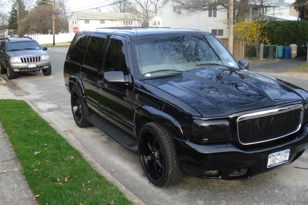

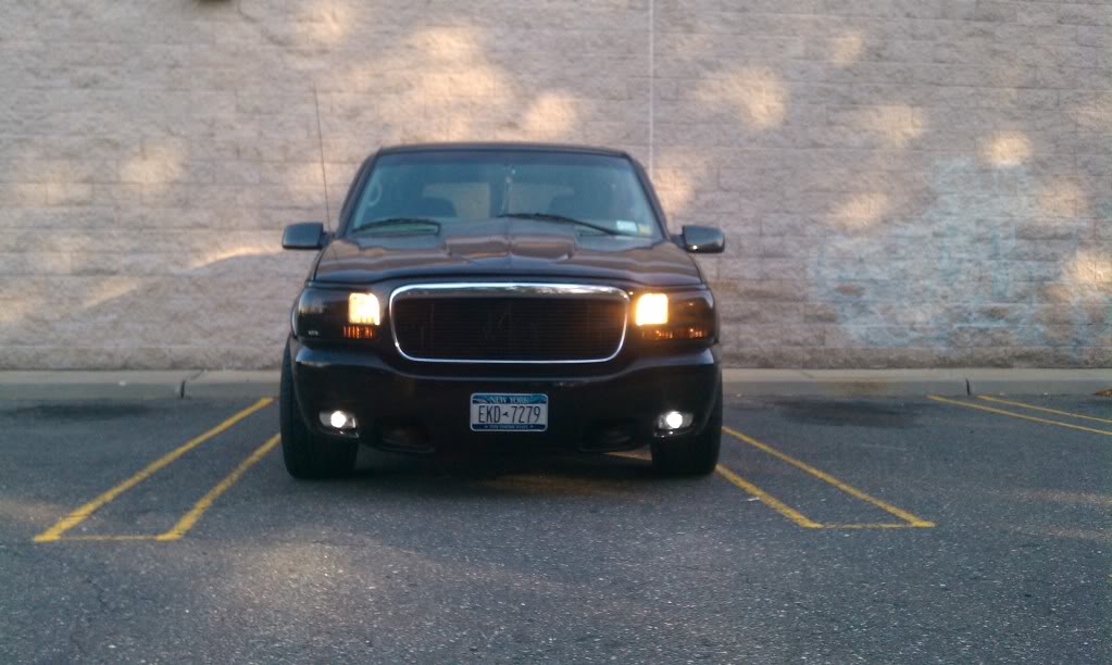

Just washed an waxed her a few days ago...took some snap shots today at my shop will post them tomorrow of the new set-up :)
foreverfalcon40
May 3, 2009
2,082

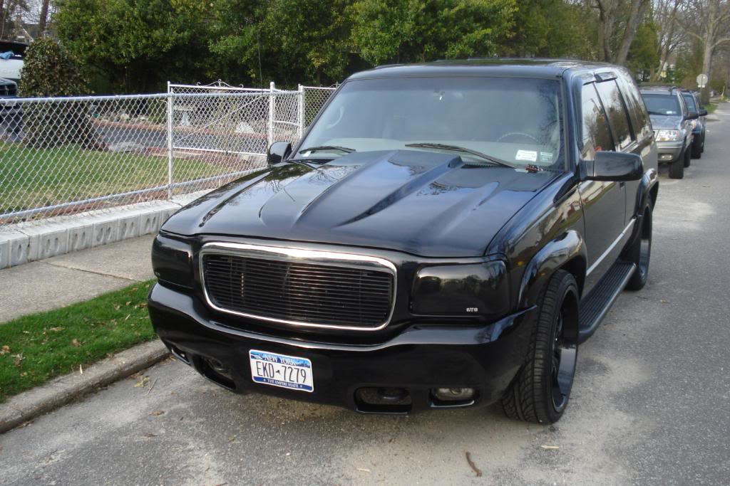

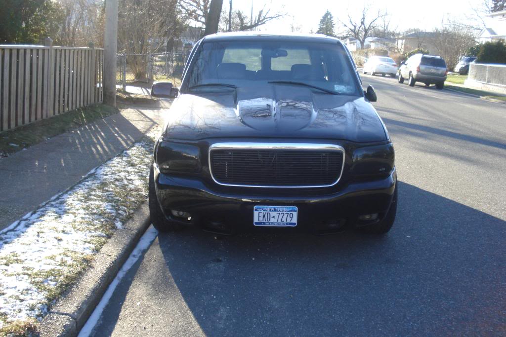

Some PICS!
---------- Post added at 08:42 PM ---------- Previous post was at 08:39 PM ----------
Old Set-up
was 35 profile tire in the front and blacked out headlights
