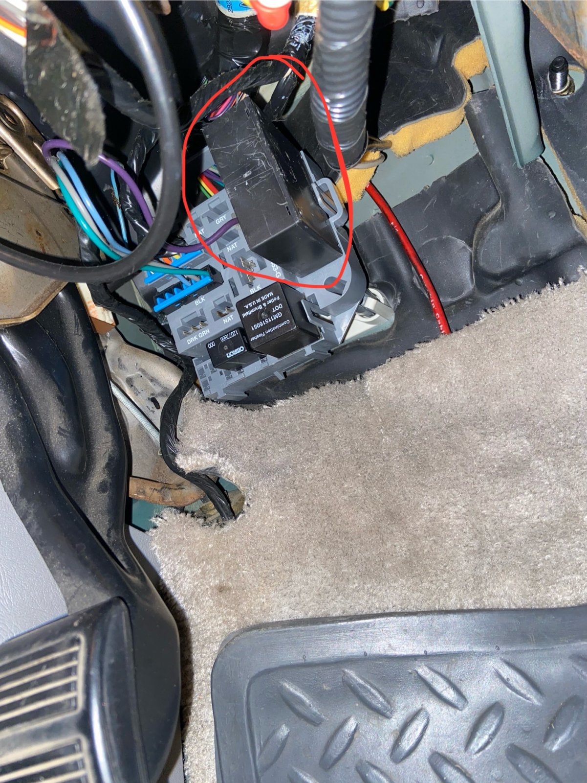

On the 96+, the buzzer is a box plugged into the convenience center (the panel at the firewall). Not sure about the TBI models. Someone may have just taken it out?

On mine (98), the box just plugs in so there isn’t a connector to it. The buzzer in some GM cars (maybe a Camaro or a Caprice, I forget which) has a “calmer” sound and can be used in these trucks. Some people swap them out - something to keep in mind if you look for another one.
How do you remove the buzzer box? I tried pulling it free but it won't come lose. Is there a tab to depress? Hard to see down there.
