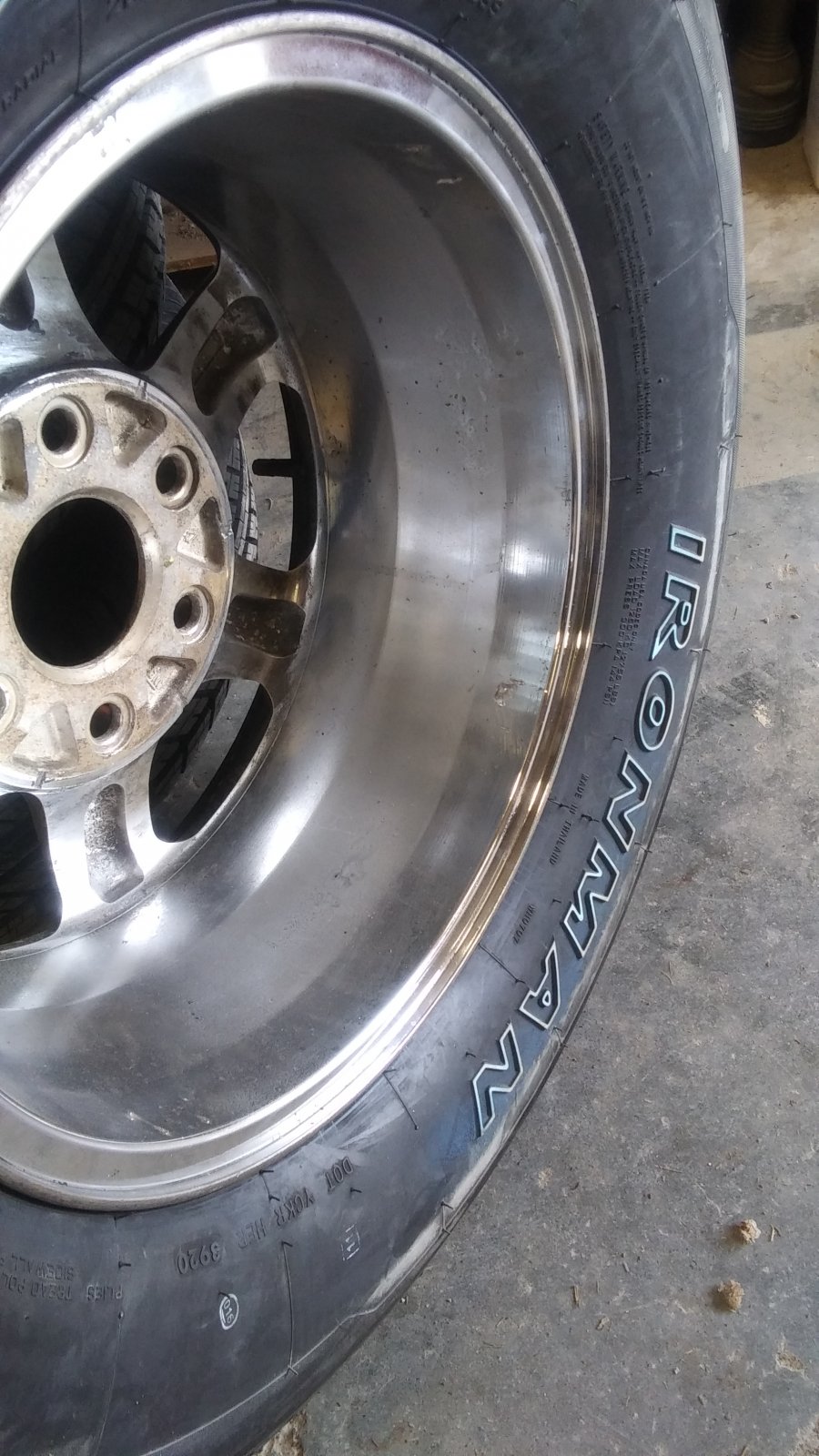

Never too old to learn something new... I really thought these wheels would fit, since they came as factory option
on Escalades (albeit earlier models). Today I compared them to my K2500 (16") wheels and saw that they tapered
into a narrower diameter the closer to the mounting plate you got. (see photo) It goes shiny, less shiny, shiny.
The less shiny area is the taper down area. Almost an inch difference than the K2500 wheel.
Will see if I can sell these (with brand new tires in them) for not too much of a loss and move on...

I think 2000 Escalade may have come with 11" drums on the back...
This is the first thing that pops up for parts:
That would explain the taper on the Esky wheels.
I also see mention of "disc brake conversion" articles for 2000 model.
